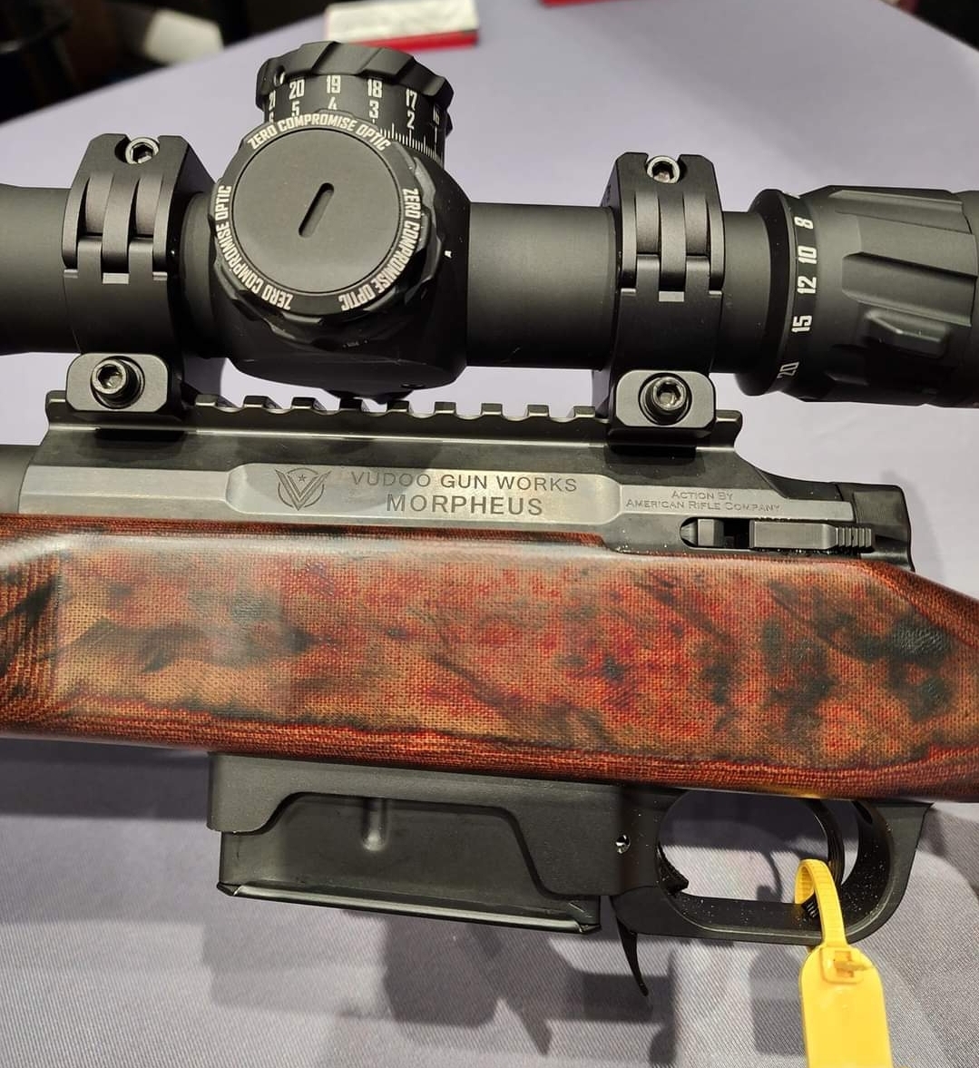

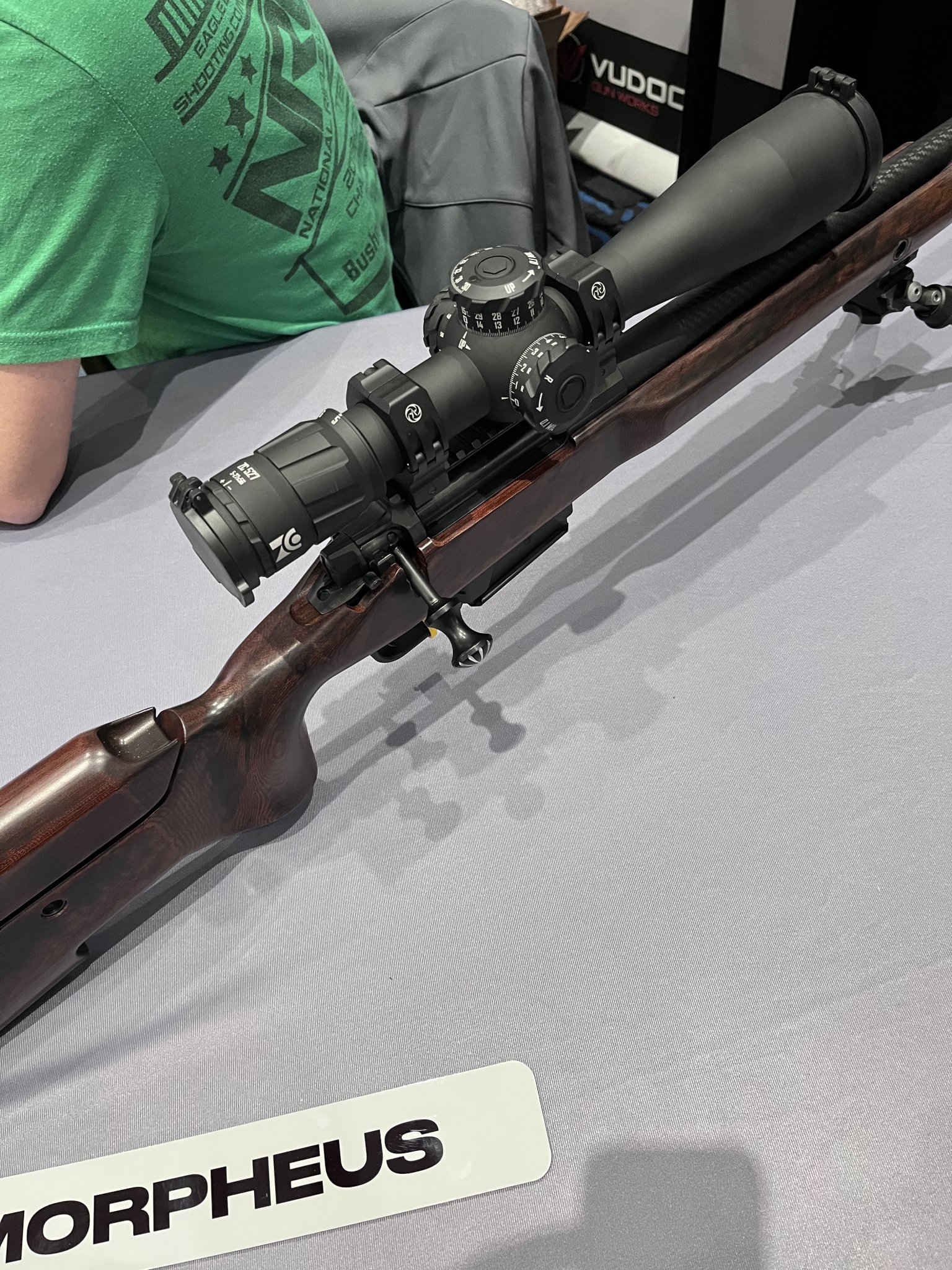

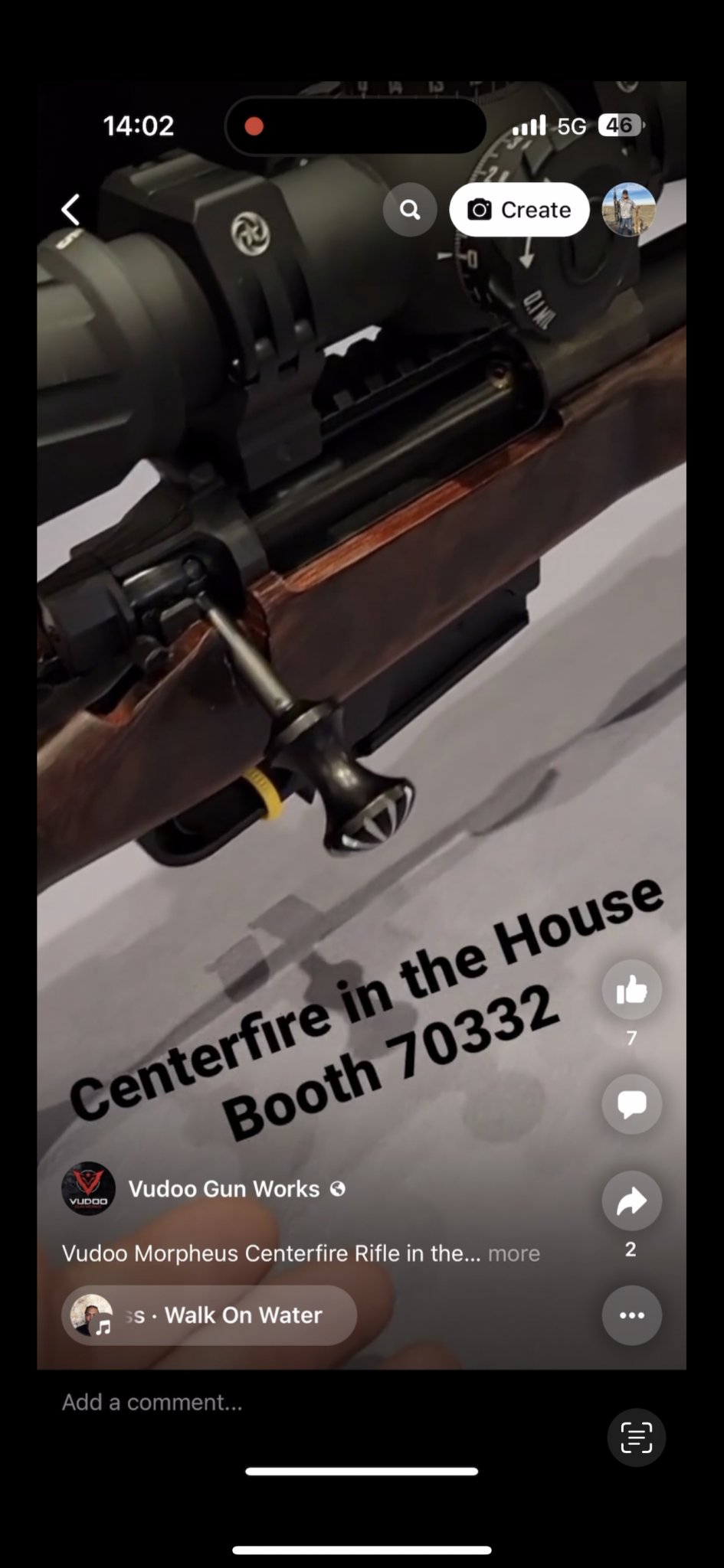

Shot Show
I'm flying to Shot Show as I type this. For those of you at the show, there will be a Coup De Grâce action branded Vudoo Gunworks, model Morphius in the Vudoo both just as soon as I can get it there, probably around noon today.
I promised Paul and Jill, owners of Vudoo, that I would deliver an action to them for the Show. Timing is a little weird, I know, because I was hoping to announce the action months ago but a promise is a promise and it wasn't until last night that I finally felt an action that I was satisfied with.
So come by and have a look if you're at Shot.
Ted
