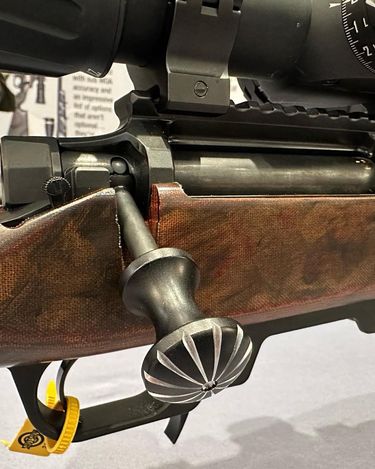

Have you considered short/rounded flutes like on an AI bolt? Would that decrease the issues when someone doesn’t run the bolt correctly?
Let’s be honest, looks is a big part of it for some consumers (and obviously flutes are functional as well).
I handled the action at the Vudoo booth and it’s a home run.
But, I would definitely like to see a fluted bolt.

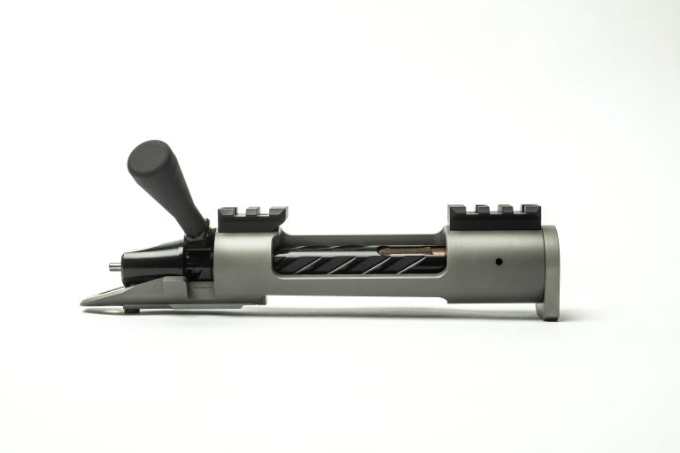

The archmedes can get away with a lighter bolt lift with a stiffer spring due to the way the primary extraction is happening. My Nuke 2.0 is 19lbs (default is 25lbs) and I think the Arch is 30lbs I believe and Arch has a slightly lighter bolt lift. I would believe the CDG would be similar idea.
