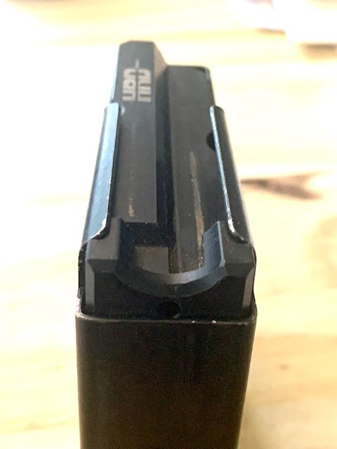

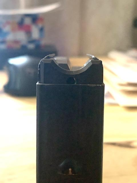

Easy fix if it does... Trim an angle on it. I had to do it for my Badger M2013I may have missed it if it's already been addressed, but any thoughts on the bottom lug making contact with the HRD spacer kit?

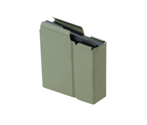

Ted already addressed this earlier - a round 1.35” receiver doesn’t allow for a double stack once you get above the .473” case head cartridges.How about a double-stack, CIP-length magazine?
This would be the tits.Accuracy International 6434GR: AXSR/AXMC .338 Lapua CIP Magazine - Sage Green (10 Round)
AI : 6434GR - Accuracy International 6434GR: AXMC .338 Lapua Magnum CIP - Green (10 Round)www.milehighshooting.com
Must've missed that. Thanks!Ted already addressed this earlier - a round 1.35” receiver doesn’t allow for a double stack once you get above the .473” case head cartridges.

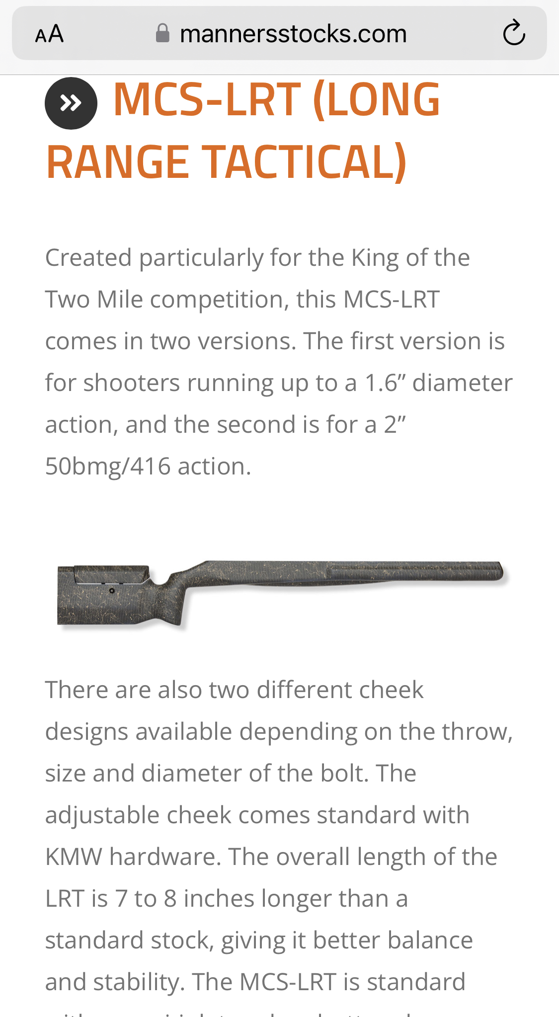

You mean like this?I'm leaning hard to a long action Cadex Competition since it will be 99% prone.
Wish manners or foundation made an option with like....+2 or +4 hand guard length for better bipod possition when using a 28-30" pipe
Call Manners and ask for a custom inlet once you know your action size. They do that all of the time or can provide the stock as a flat top for you or your smith to inlet.Kinda, but that action size...not sure

If you had seen my work with a Dremel, you'd rethink this bit of advice!Easy fix if it does... Trim an angle on it. I had to do it for my Badger M2013
