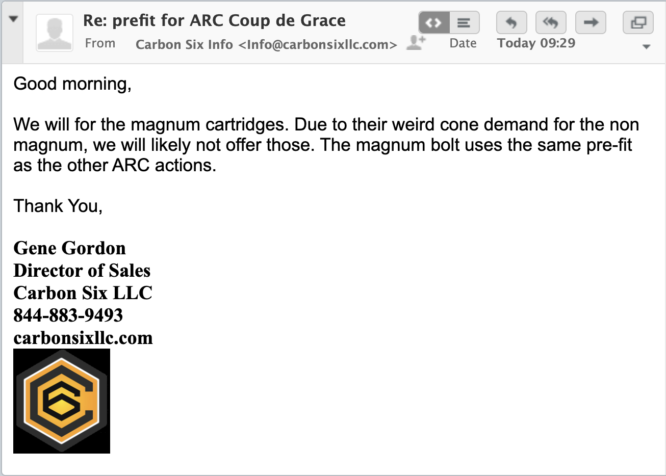

So I'm pretty interested in the CDG as it checks every box on my list (CRF, toolless bolt disassembly, interchangeable bolt head, 3 lug.) Never had a custom action/rifle though, but this one seems like a good introduction to the class.
That being said, how big of a PITA is it to get prefits for a conical breech? Is it going to be no different cost and availability wise than a standard flat breech?
There are already some online stores that have committed and they have released the tenon print so any ‘smith that can read and do math can make one for you. You’ll be fine

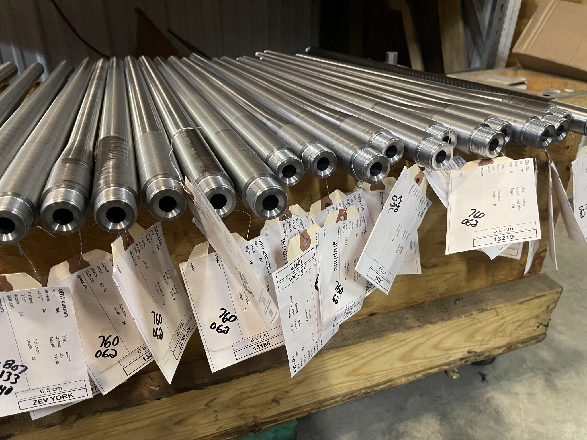

www.patriotvalleyarms.com
We have prefits in production right now.

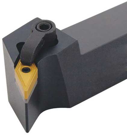

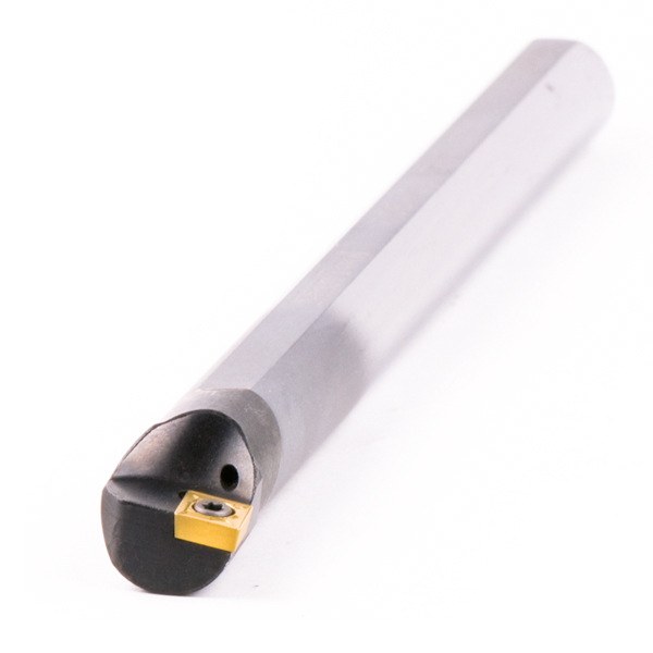

I bit my tongue for a while and kept quiet. When someone recently called and gave me a lecture about how incredible the new "6.5 SI" was I couldn't sit still any longer. Sherman Improved... 40 degree shoulder, less body taper.... the audacity to overload brass, tell people it's safe without any pressure testing to back it, and then call P. O. Ackley's idea your own was just too much. Now I've put it in writing and I'll be happy to eat crow when some pressure testing from a SAAMI or CIP certified pressure test barrel says so. Until then, I don't buy it and I'm done putting my insurance policy in the liability chain.

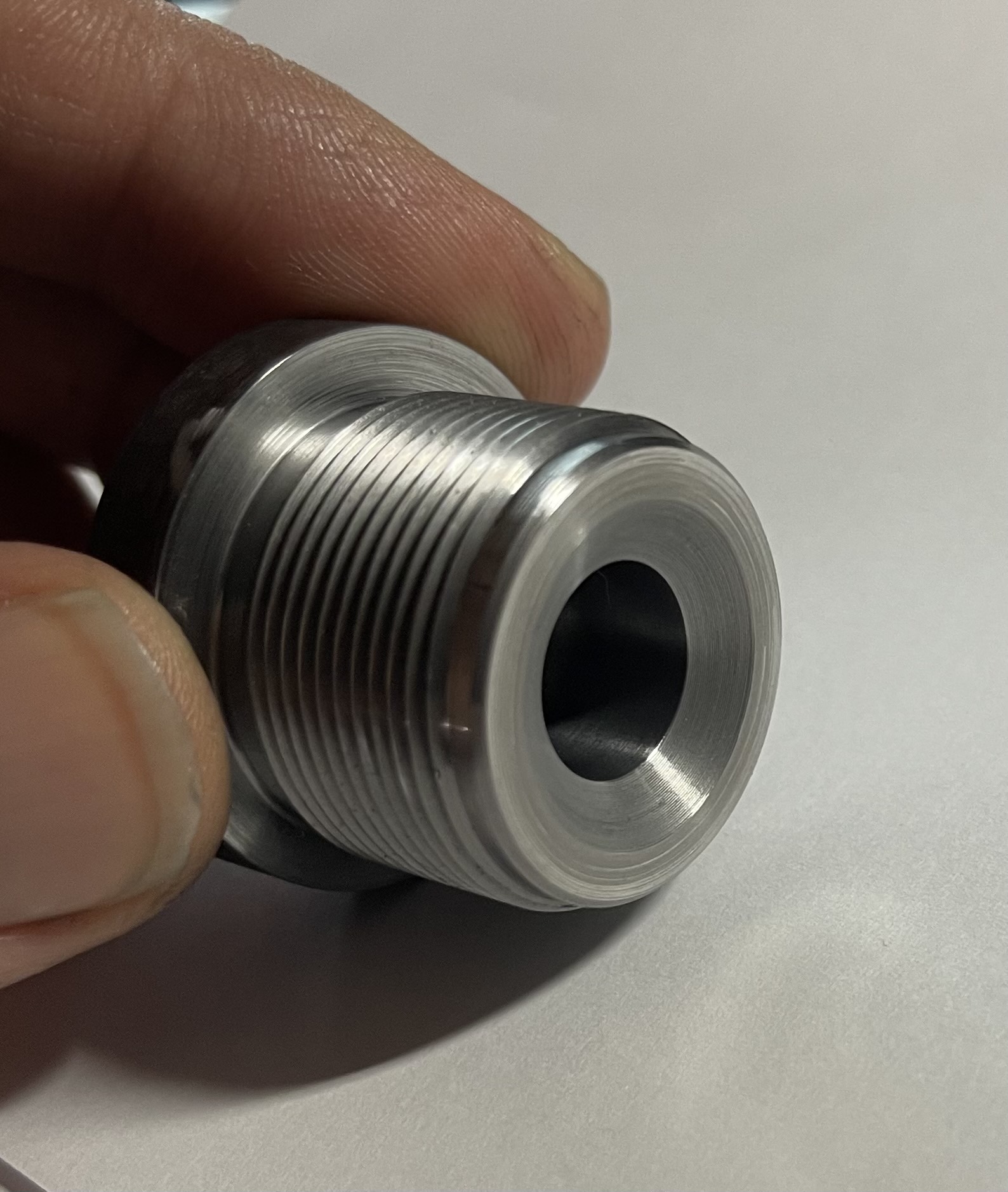

Here's the final qualified tenon against the ARC print. We made stubs of 223, Valkyrie, Grendel, and 308 case head tenons with the conical breech face. Production on the Group Buy barrels is in full swing, they will start shipping next week. All contours, lengths and muzzle threads are done. It's just down to tenon/chamber/polish.
(The machine work looks scruffy being that it's cut from a piece of scrap steel laying around, not a barrel blank)

Based on the comment up above with the stub gauge pic, are you still cutting a fair amount of Valkyrie chambers for bolt guns? I’m still loving the one I got from you.
Reactions: Simonsza1
Based on the comment up above with the stub gauge pic, are you still cutting a fair amount of Valkyrie chambers for bolt guns. I’m still loving the one I got from you.
Almost none TBH, however I did do the qualifying work for the odd one that comes in now and again. I'm glad to hear you're enjoying it. They're not very popular due to feeding issues typically. I had a barrel years ago on a Bighorn pre-TL series receiver that was essentially a 224V with an aggressive AI job on it. It was fun shooting 75 Amax at 3300 from a 20" bolt gun. Though I didn't have good luck getting it to feed all that well.

Coned breech would likely require an ID cutter of some sort. Od cutters don't have the clearance to do it.
This is somewhat an unusual od holder but it shows the area needed to get the point across. The area under the insert would need to be relieved. This is only an od or face tool.
Here is a boring bar. The size of the boring bar has to be matched to the size of the smallest hole it needs to fit in. Would be easiest to go into the chamber and come out and face up to not leave a possible burr in the chamber.
For a better explanation of clearances that is funny here's This Old Tony.
For more granular details on boring bars Blondihacks has a pretty good vid.

I ordered one early from Carbon 6. They said they would do them if they were a standard cone across the board and that they didn't want to do them if there were a bunch of different drawings for different calibers. I haven't looked at the drawing but I assume that's the case.
You ordered one? Specifically for what caliber? And they are doing it? Seems like the response I have says they are not.
I can't really speak for them and what they're going to do moving forward. When I originally called the said they do cone breaches for several barrels, so I dont think they're inept. They said that they weren't interested in making a bunch of different cuts for prefits. Sounded like it was too much pain for the amount they'd sell. They did say that they were going to do mine and a few others since it was pre tenon drawing. I have-not heard different from them so hopefully they honor it. I kinda hate to be ordering another barrel now, but it may not matter. I haven't tried their barrels yet and have heard good things so thought I'd give it a go this time. We'll find out if I'll be back or not. So far I am happy with the customer service in that they answered the phone, spent the time to answer my questions and said they would make the barrel even if they decided not to make prefits for the Coup.

Here’s the CDG prefits from 0800-1200 today just before I QA checked all of them.
End of day count: 31 chambered barrels ready for polishing room.
Guys will start seeing shipping notices tomorrow.
If Carbon 6 doesn’t want to make coned prefits you are welcome to call us. We have it qualified and they’re flowing well.
