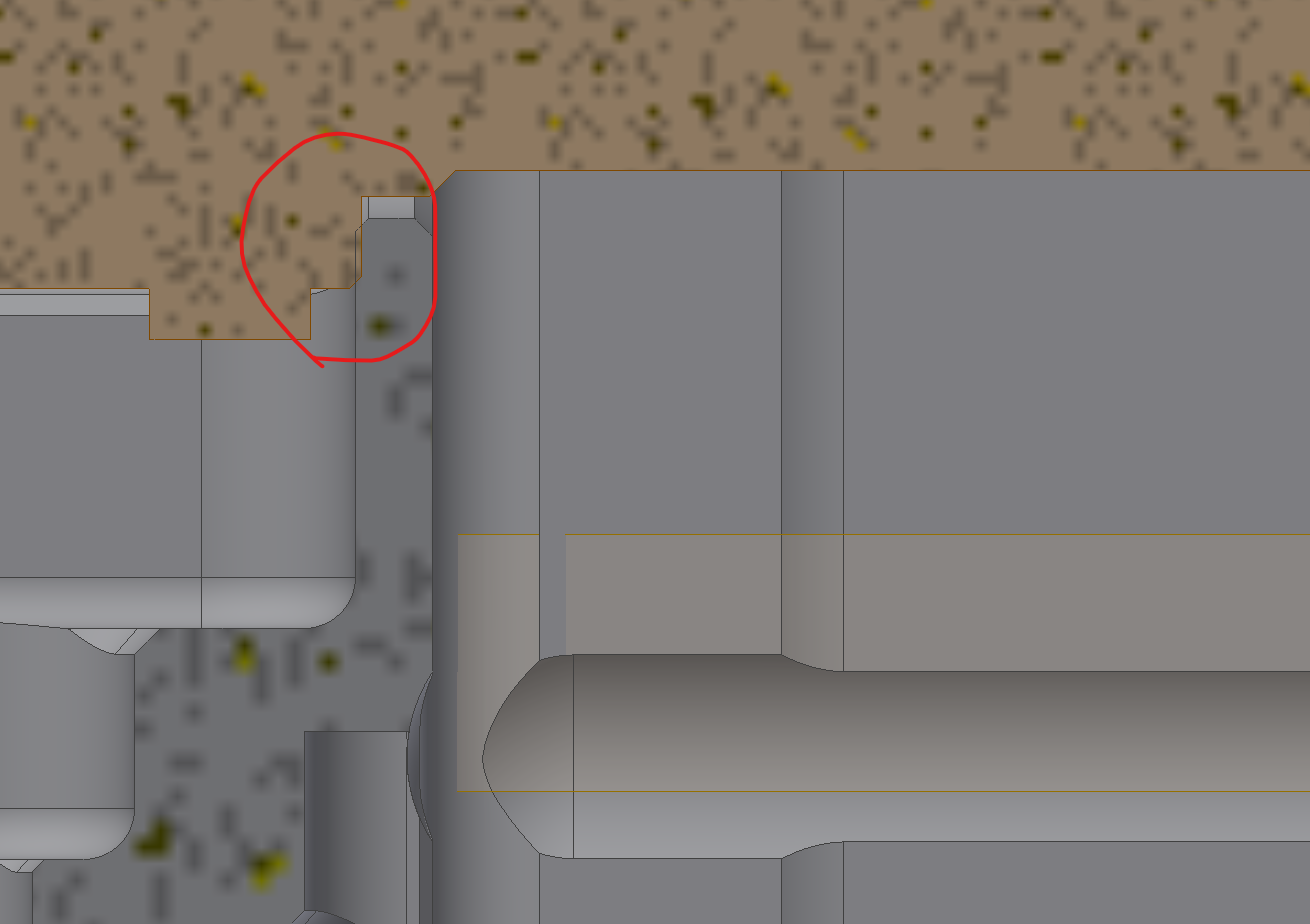

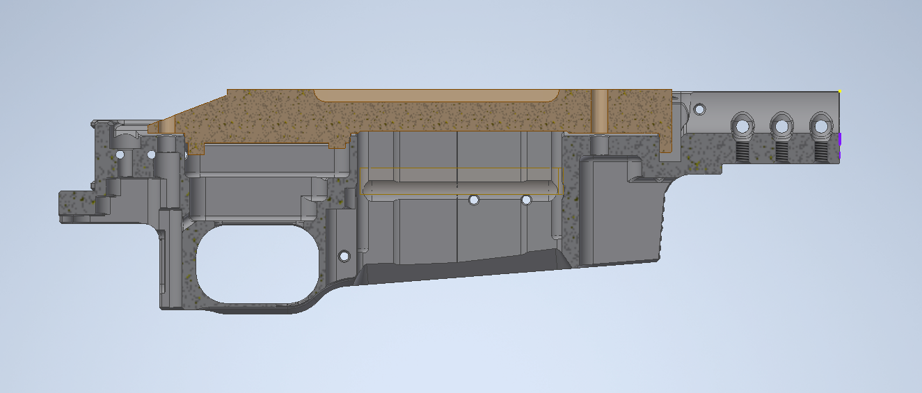

There was a CAD file on the ARC website a few days ago with a model of the inlet.
I sent that file to Spuhr to ask them about the fit of their SICS chassis. This was their reply:
"As the SICS is designed for use with the AICS magazines (not AIAW) you will have to use the ARC optional forward hard stop piece. Also, the trigger hanger of the action will collide with the front wall of the trigger guard pocket (see pictures below) but not more so than that it should be easy to remedy with a few file strokes on the trigger hanger and/or the front wall of the pocket:"
Awesome, you beat me to it!

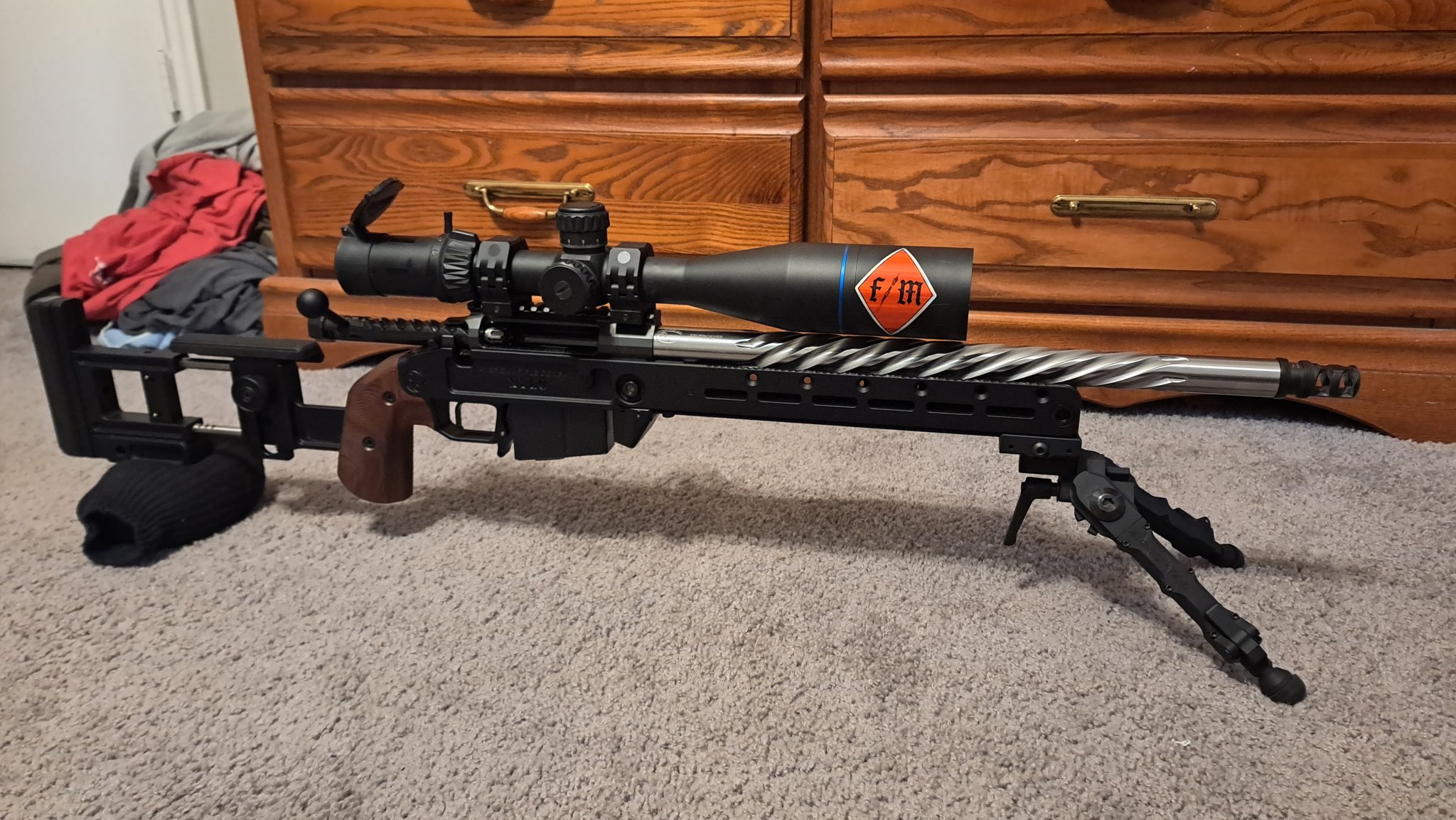

What kind of barrel/ caliber is that and how much room is left between the scope and the barrel?
Patriot Valley Arms Osprey
308win 18" Proof Competition contour.
There's about 0.030" of clearance between the barrel and the scope. A 0.025" gauge pin I have will fit with a tiny bit of wiggle.
Hi javemtr!
This is excellent info! I'm super glad you let us know a step model existed on the ARC website!!
I'm really looking for the LA version, but I could probably cut and stretch this model to match the length of a Rem 700 LA and would be 90% of the way there.
Thanks again for letting us all know (and especially thanks to Ted @karagias for providing the model)!!
(edited) BTW, the little interference shown in the images you provided may not actually be a problem for you. The trigger hanger has the ability to slide fore/aft and, I believe, the CAD model provided by ARC includes the maximum displacement in the size of the trigger hanger (which, I also believe, is why the front set screw (conical fastener) appears to be oval shaped). So, unless you have the trigger hanger positioned as far forward as it'll go you'll probably be ok.

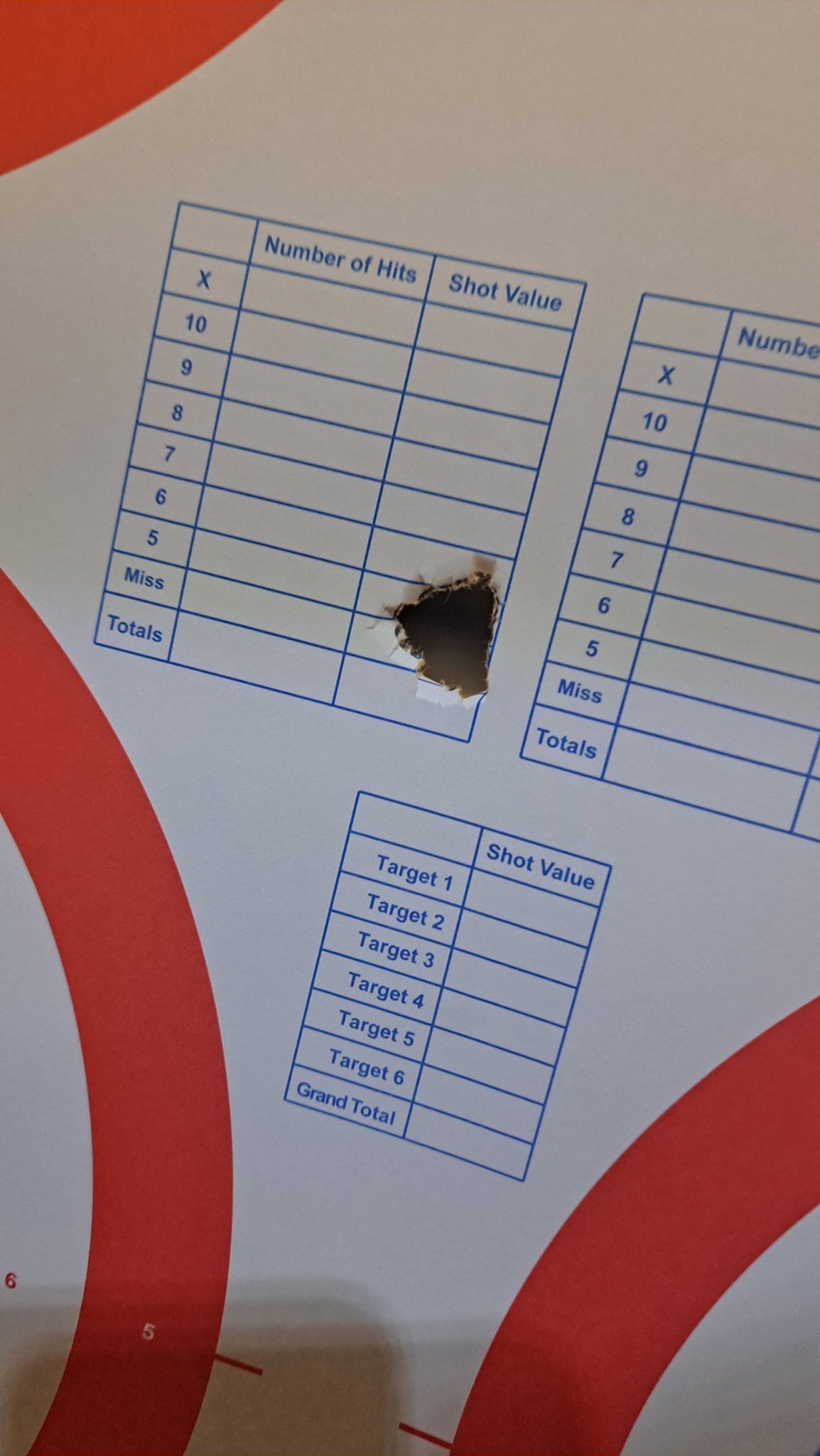

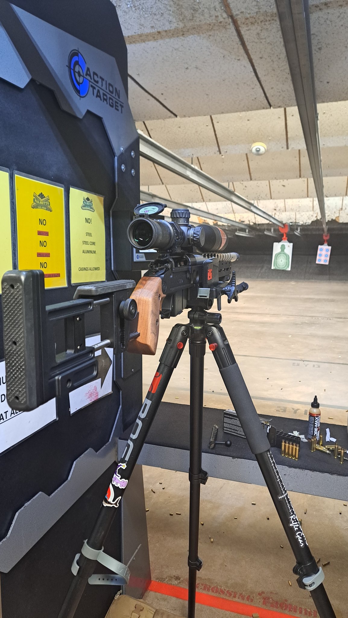

Range report: After break in at 25 yards (this is all I have available right now); 10 rounds absolutely mulched a 1/4" sticker off a tripod. Using Sig Marksman 168gr HPBT ammo. Ill soon stretch its legs out farther on my vacation.
one thing I did notice is sometimes the cases will have extractor marks on the case head from when the bolt is rotated up. Out of the 40 rounds I shot, about 12 casings had these extractor marks.

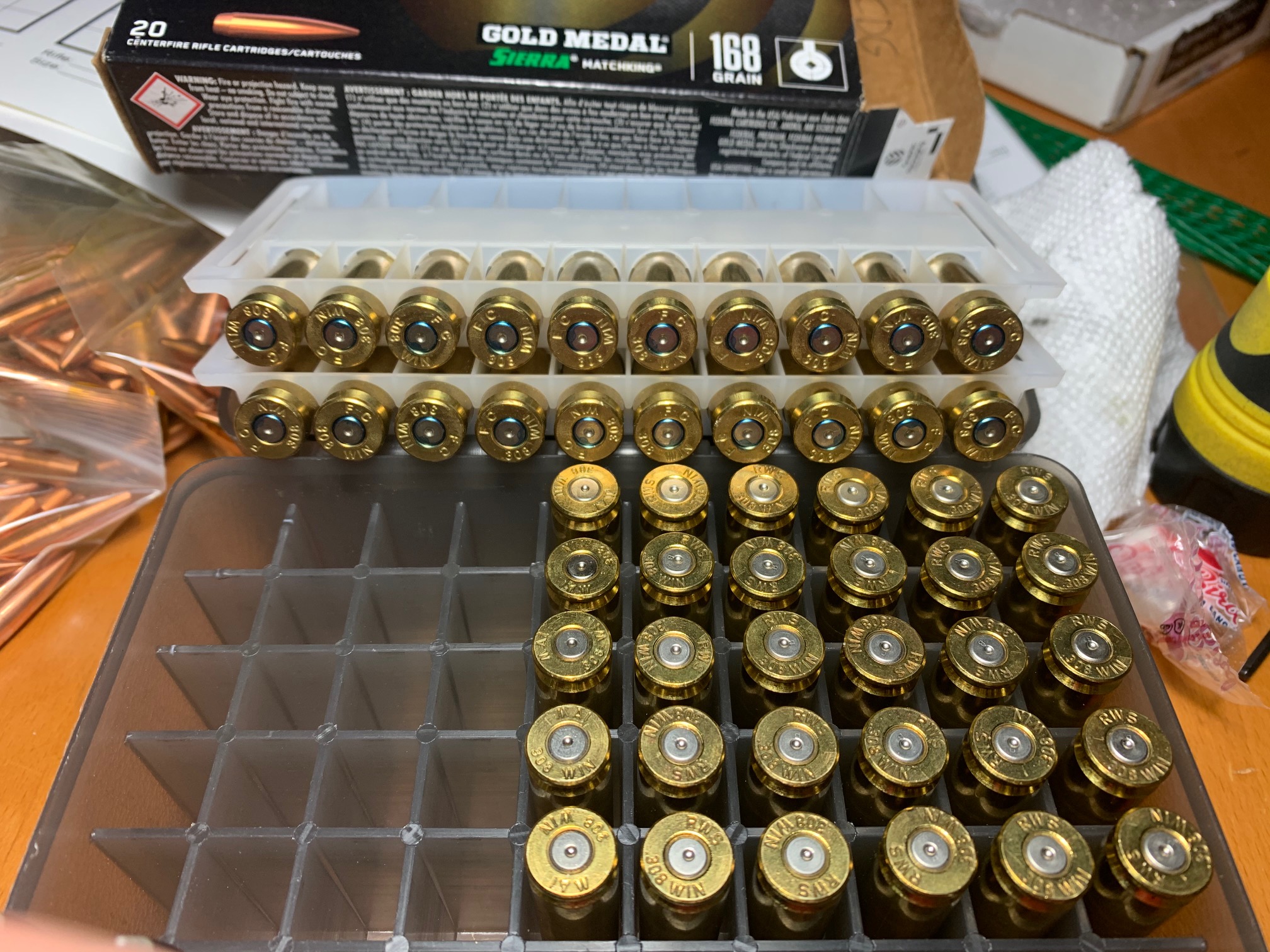

Here's my brass after first range trip. Not a mark on anything. All virgin brass.
FGMM 168 = 2659
44.0 - 44.8 Varget 169 smk in RWS brass with BR-4 = 2743 - 2767
44.4 Varget/168TMK RWS = 2761

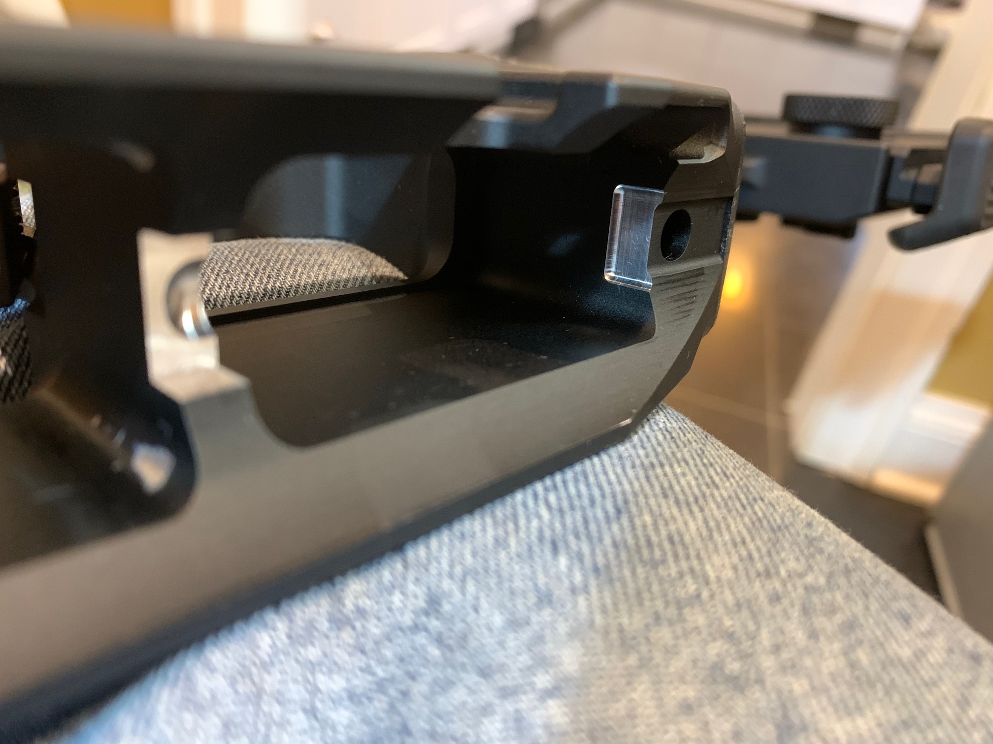

Edit: Just FYI the hanger cleared at the back of the pocket or so I thought. Apparently when I torqued the recoil lug wedge it was shifting the hanger forward .006
I’d set it for zero cock on close, torque it in and it had .006 decock on close. Took me a few minutes to figure out it was just barely touching at the back. Cut the little relief at back pictured above & now zero cock on close with a little extra room in case I change triggers.
