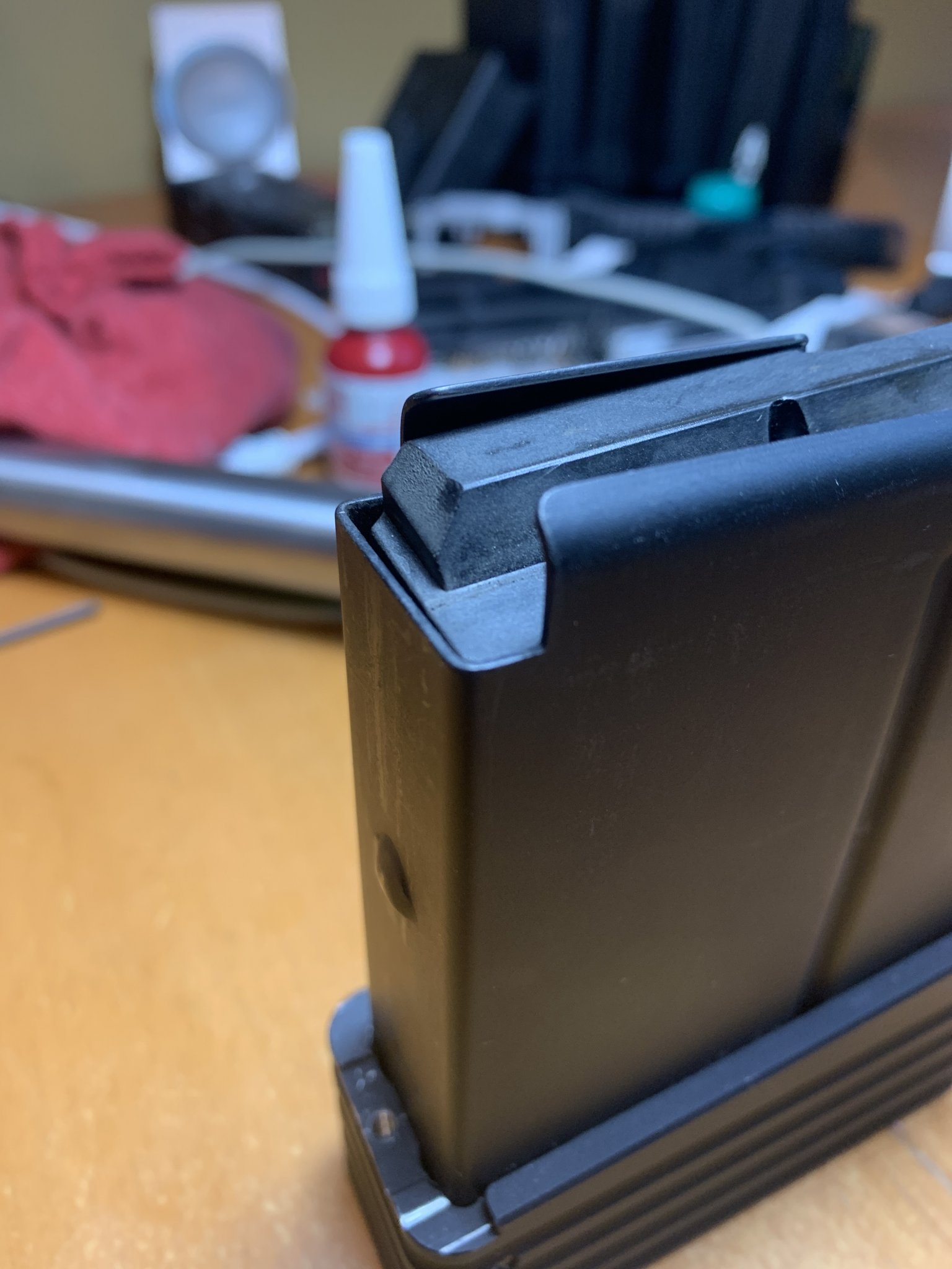

Receiver and bolt work well with AICS mags but are optimized for incredibly smooth and reliable feeding using AIAW mags and conical breech barrels.
The AIAW mag will hard stop against the bottom of the receiver thus preventing interference with the bolt.
The back of the AICS mag will hard stop against the receiver but if pushed upwards, the forward tips of the feed lips will interfere with the bolt. The mag will be driven down when pushing the bolt forward. An optional forward hard stop for the AICS mag can be placed between the receiver and the stock/chassis.

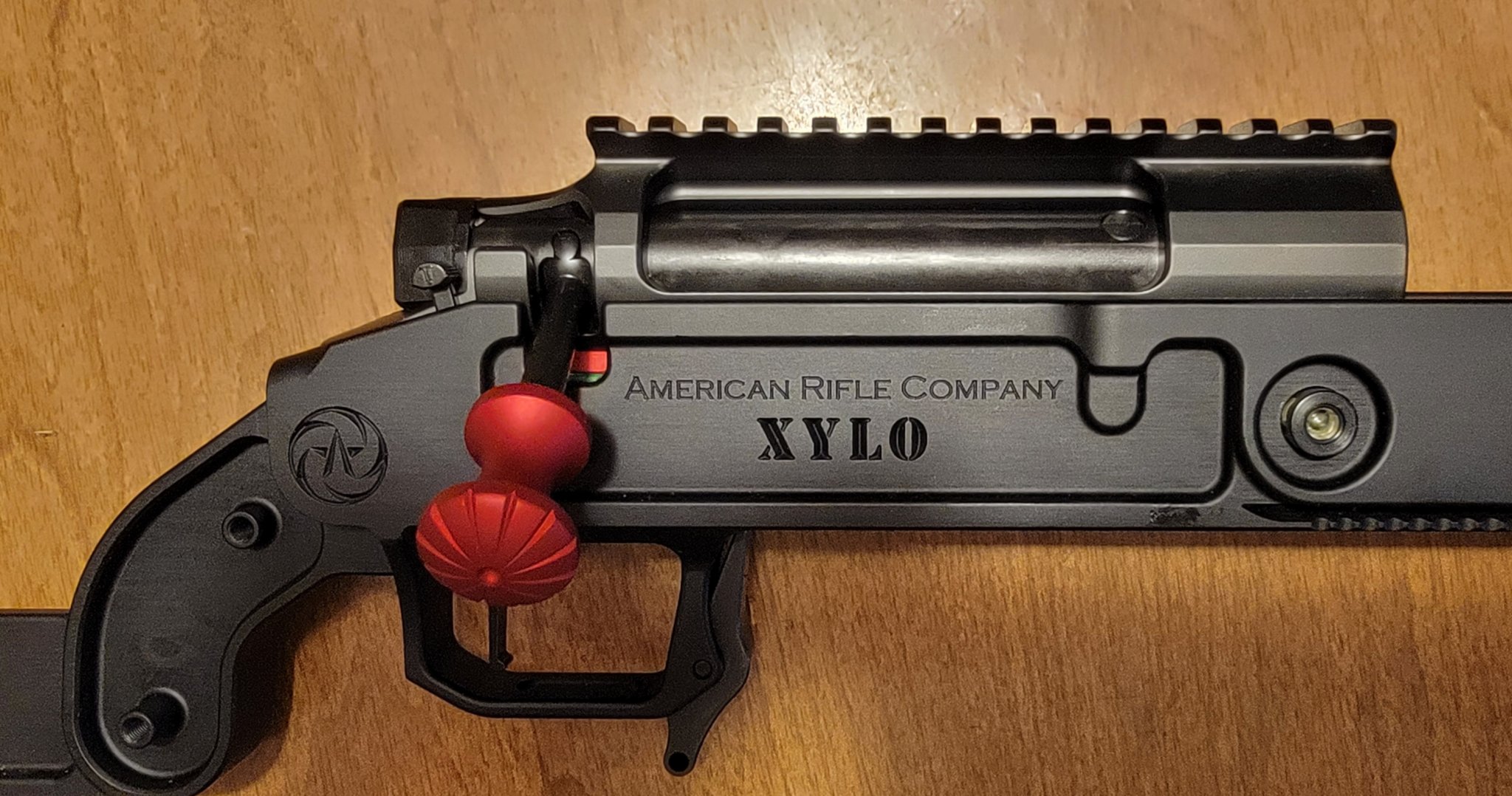

Well finally got the CDG torqued onto the barrel and the TT Diamond installed. I have to say, I love the action. This is my first ARC action and it is so unique compared to my deviants. The more I play with it the more I absolutely love it. I just need to get my chassis back from anodizing so I can get out and shoot. Thanks Ted for the killer action. I’ll be buying another soon
I ran 75 rounds of 308 yesterday. Handle didn’t pivot once.
IMO the CDG pivot spring is a little stiffer than the Archimedes, not a bad thing.

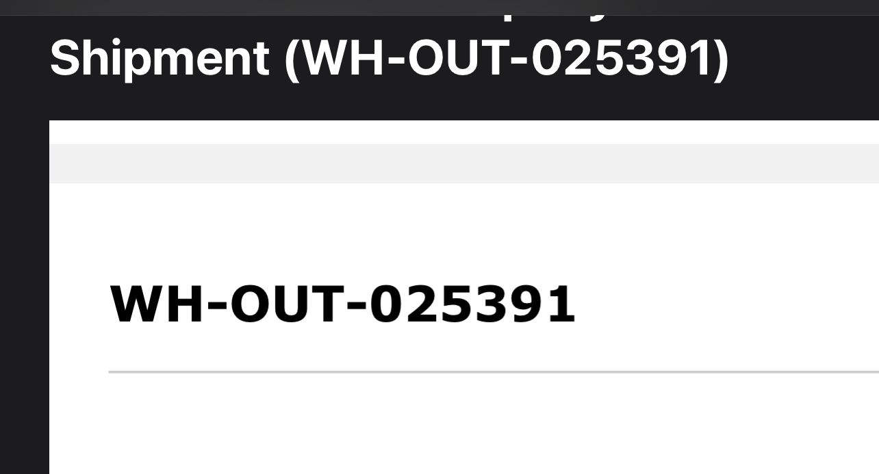

I'm SO-036931 ... maybe it's shipping soon!
Mine is SO-036909 and all it says is preparation. Funny because my higher numbered one was already delivered so don’t think the actual number has anything to do with shipping timelines… they’re both carbon copies of one another so that’s not the delay.. oh well, I just have to get home to actually pick up the one I actually already received
Reactions: PRSDietitian
I've come to peace with it all. gives me time for PVA to finish my barrel, and time for me to order my AT-X chassis from euro optic
