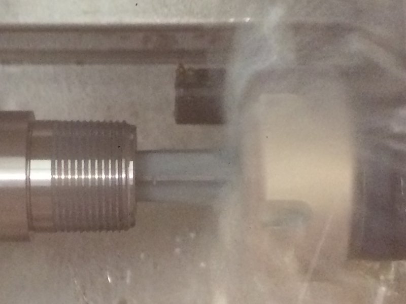

I use Re-Lion and Viper's Venom with equally good results. Viper's Venom has a smell while Re-Lion doesn't. Re-Lion does smoke quite a bit when cutting threads. I chamber between centers and don't have flush setup.
Are you using a flush system? That's what I wanna set up and figure I need at least 5 gallons of oil.
No, I'm not using a flush system. I'm running between centers on a bench lathe and would need one heckuva catch pan for that much coolant/oil! I'm going to look into it though. I'm tired of having to loosen the tailstock, pull it back and clean up so often.
