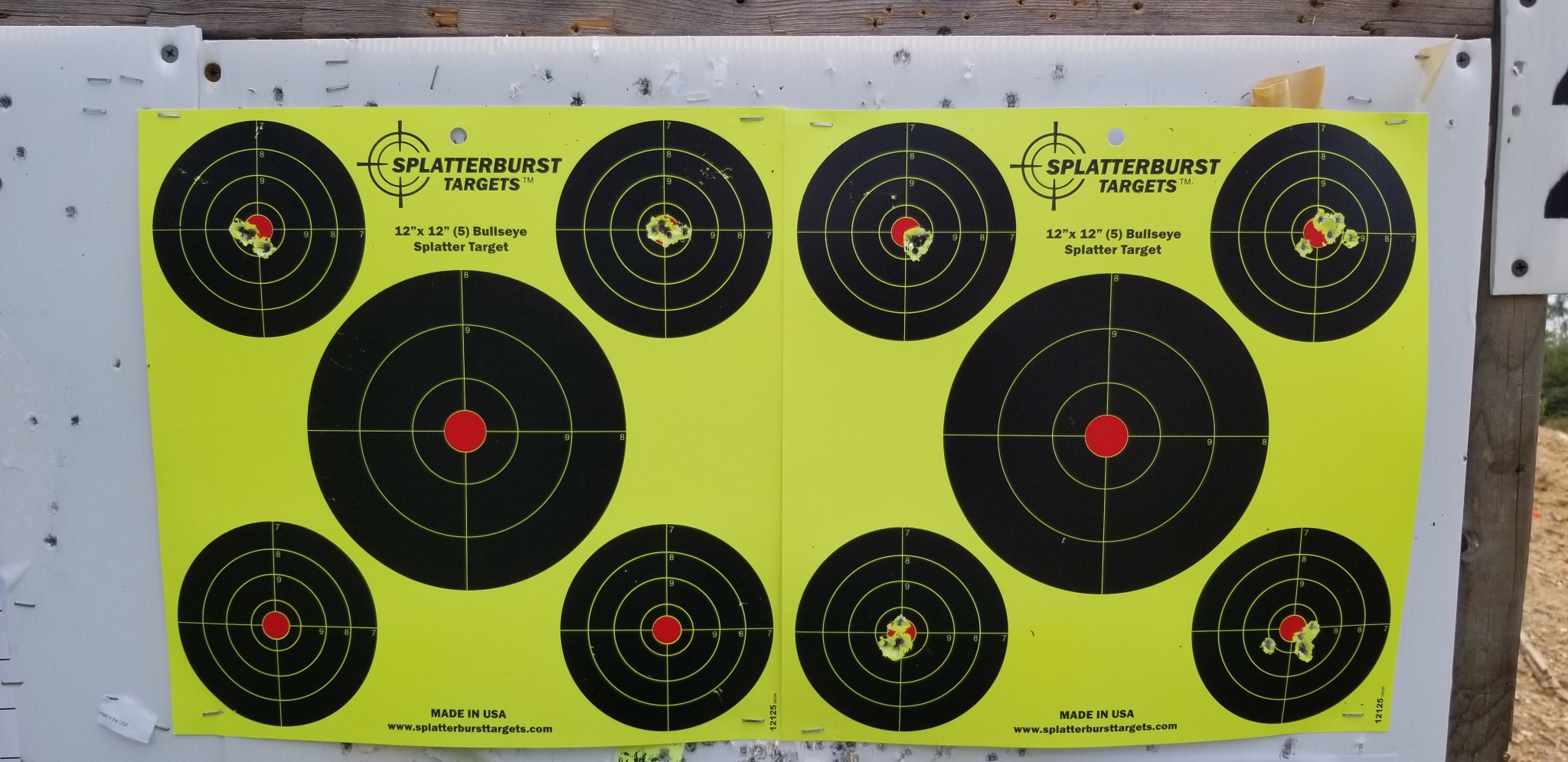

Finally got time to hit the range. For all intensive purposes, this is a stock CZ457 AT-ONE with a 16.5" barrel, shooting SK Long Range Match at 50 yards. All groups are 5 shots, shooting from a bench with a bipod and rear bag.
The two groups on the right edge were the first two groups, shots 6-15 through the barrel (shots 1-5 were on another target while zeroing the scope). I didnt get a chance to take a picture of the rest of my groups, but this thing shoots. I'll be interested to see if I can pull in the fliers after pillar bedding the action.
Does the AT-ONE not already have metal pillars? The MTR stock does. As well as a recoil lug at the rear of the action that's so loose I doubt it does much... But it's there.
The pillars in all the 457 stocks I've looked at are some sort of poly/plastic. I intend to drill them out and glue in aluminum pillars eventually, along with fully bedding the actions in both my American & Varmint MTR.

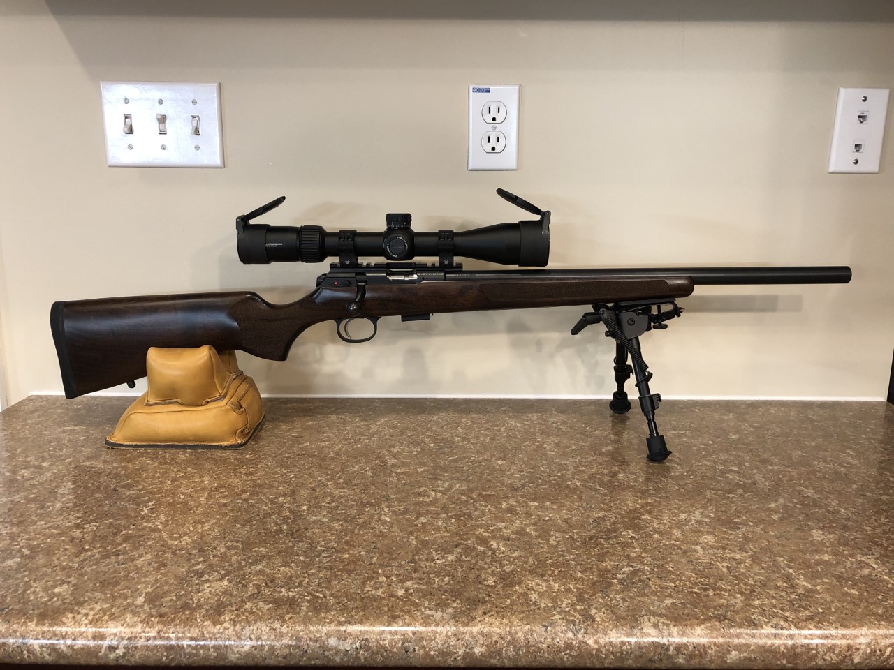

Just got my 457 Varmint assembled last night. I'm using a Bscar extended 25 moa scope rail, Vortex Pro series rings in low (.90 inch) rings and a Vortex Diamondback Tactical FFP 4-16x44 EBR-2C mrad scope. Hopefully I will have an opportunity to shoot it in the next few weeks. I've also installed the Yo Dave spring kit and it dropped the trigger pull weight from 3 lbs to about 1 lb measured with my Wheeler trigger gauge.

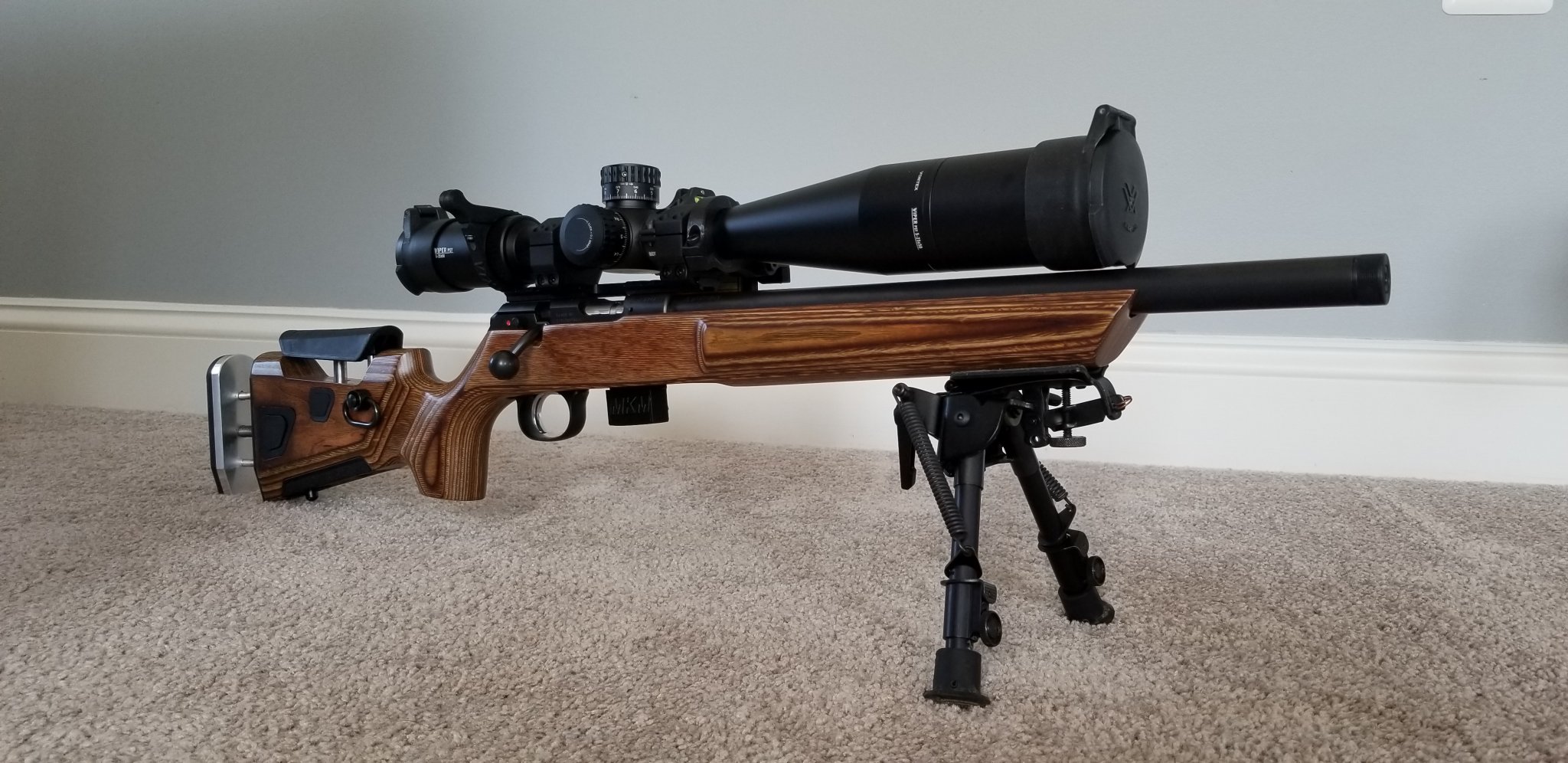

I have a 457 24" Boyds At One inbound. I May wish I had ordered a shorter barrel, but have been looking for a long time so I grabbed this when available.
Looks like I need to also order...
Tapered base/rail
bolt knob
rings - recommendations (?) probably mount an Athlon Ares BTR
Trigger spring
And ammo. Not a lot of high quality ammo in my AO to try out, but will see what happens/what i can find. Maybe I'll get lucky.
Will likely have to add length, maybe height to the comb, excited to get this out to the range.

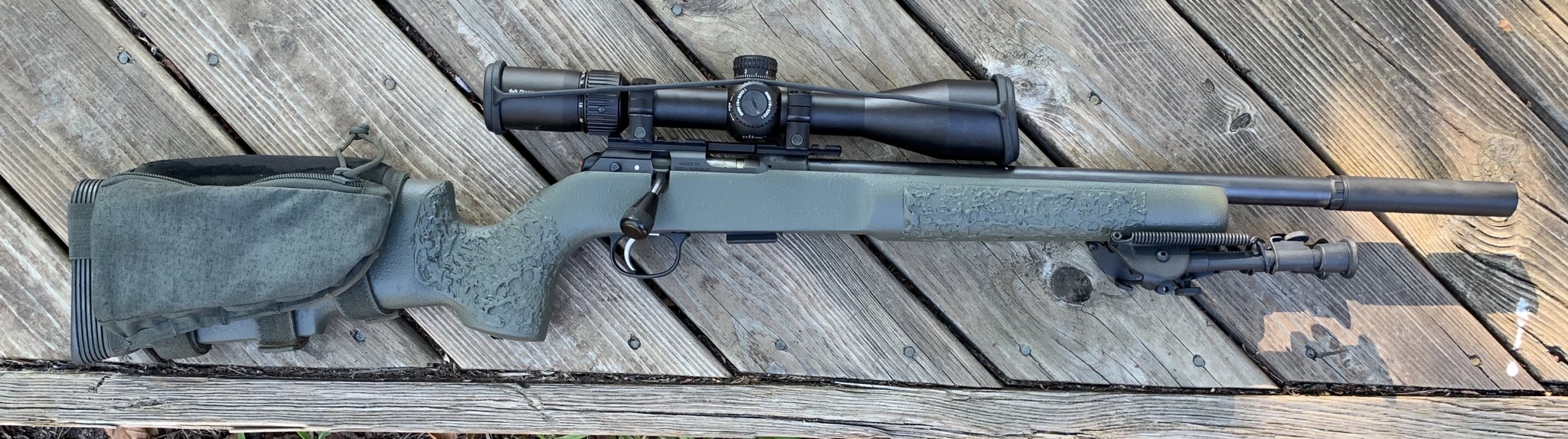

I mounted an Athlon Midas TAC 6-24x50 on my 457 American, on a BScar 25 MOA sloped rail, with TPS TSR low rings. Resulted in having about .140" clearance between bbl & obj bell of scope. After doing some shooting with this rifle to zero the new scope (had an older Vortex Viper PST MOA sfp 6-24x50 on it), I realized I was going to want a slightly longer bolt handle knob on it. I've got something like an Area 419 knob on my 457 MTR, and don't want anything that large on this sporter, so will probably have to make something for it on the lathe.

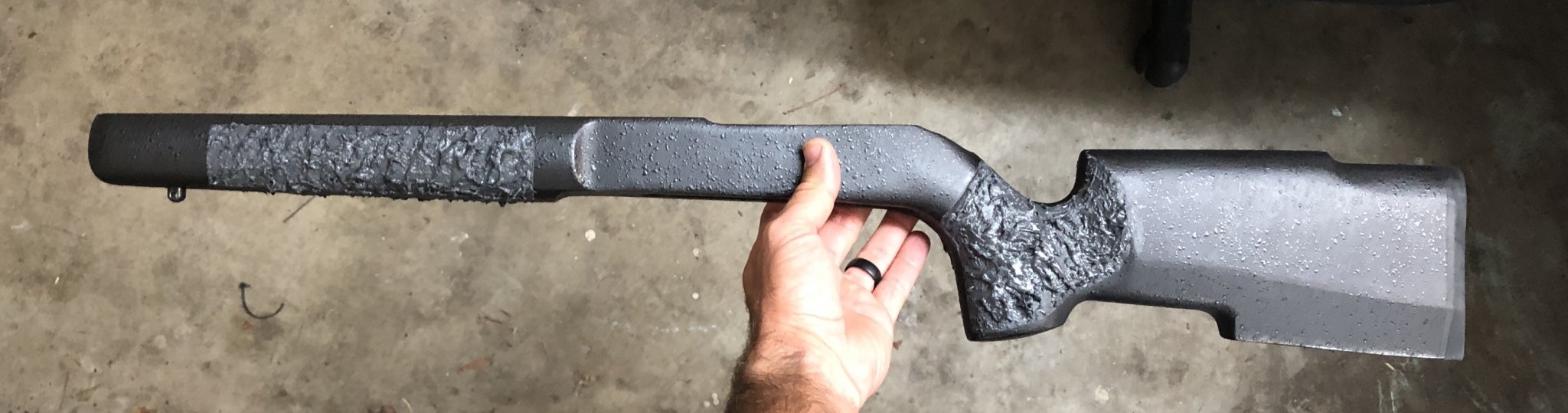

How’d you add the texturing? Nice work btw.
Lookin at the Pro Varmint for my sons first 22.
Tape off area. Add light coat of marine Tex, slap it with a tongue depressor a minute or so after applying. Let it harden. Sand it to desired grip. I used Pc-7 on this one. I don’t recommend it. It’s not as good as marine Tex. Peaks fell down and it was thicker than desired.

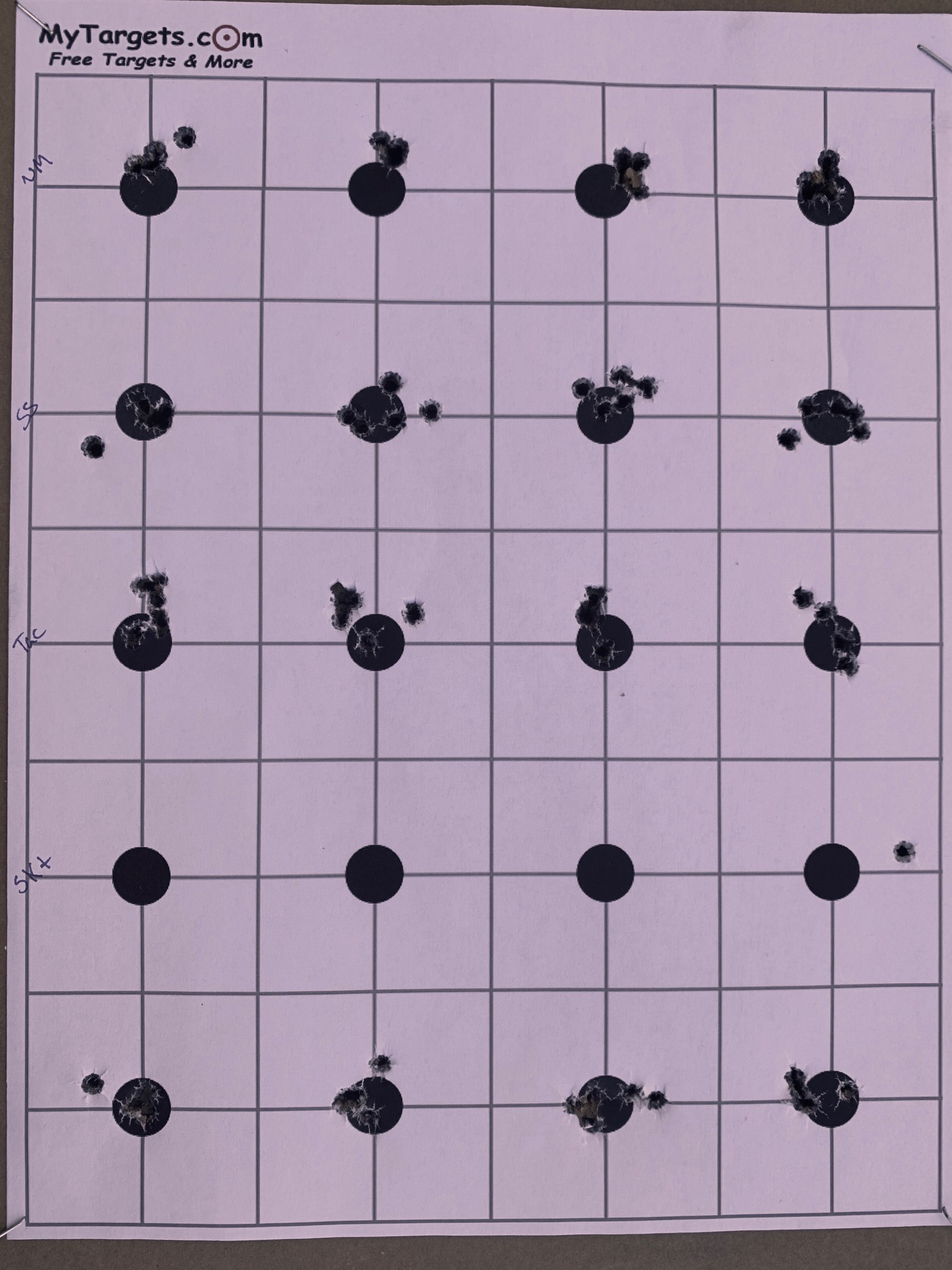

Took my new (bought last week from Mile High) 457 Pro Varmint Supressor Ready out to the range over the long weekend to do some ammo testing. Here is what I found:
I did 4, 5-shot groups of 4 different ammos.
Top row was Norma Match and averaged .62 moa
Row two was Norma Subsonic averaging 1.19 moa
Row three was Norma Tac-22 averaging 1.08 moa
Row five was SK Standard + averaging .90 moa

It will tighten up after 400-500 rounds. :)
Was going to ask if you had shot a few hundred rounds through it prior to shooting groups, and a general question would be , if a load shows promise during breakin, is it likely to continue to do well after say 500 rounds. I have a vested interest, as my 457 should be arriving this week- guess I should get a base ordered and see what i have available for rings .
That would be great, already happy with the performance of the Norma Match. That flier in group 1 is what kept that average from being really good. First group of the day too, so who knows.
