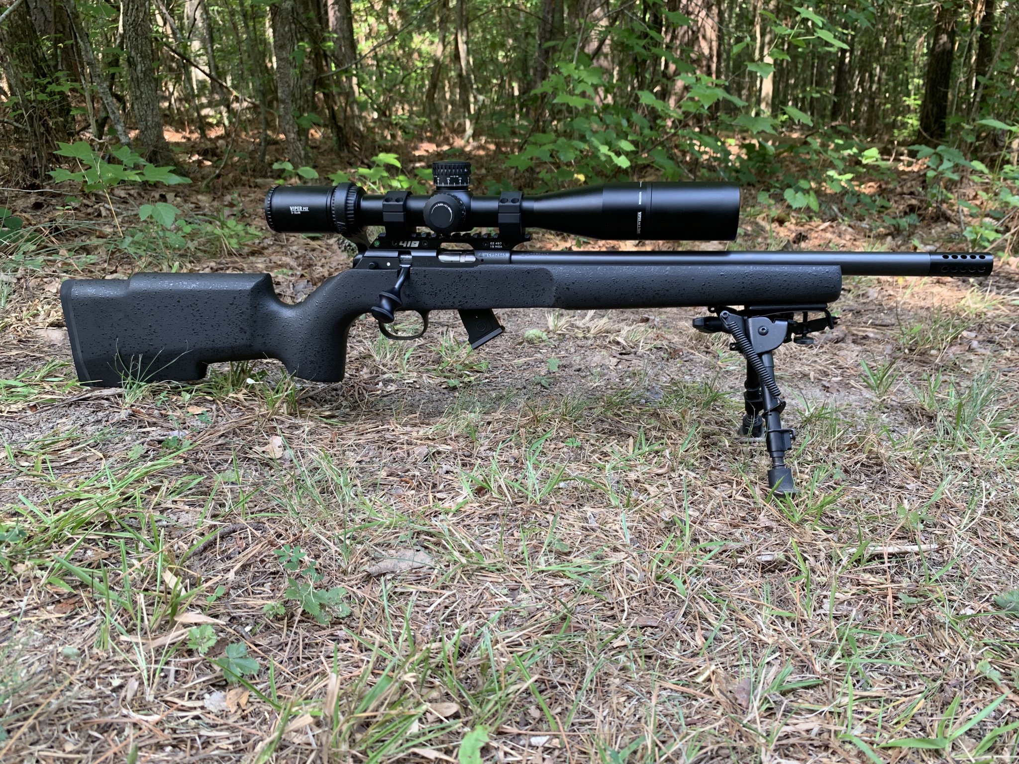

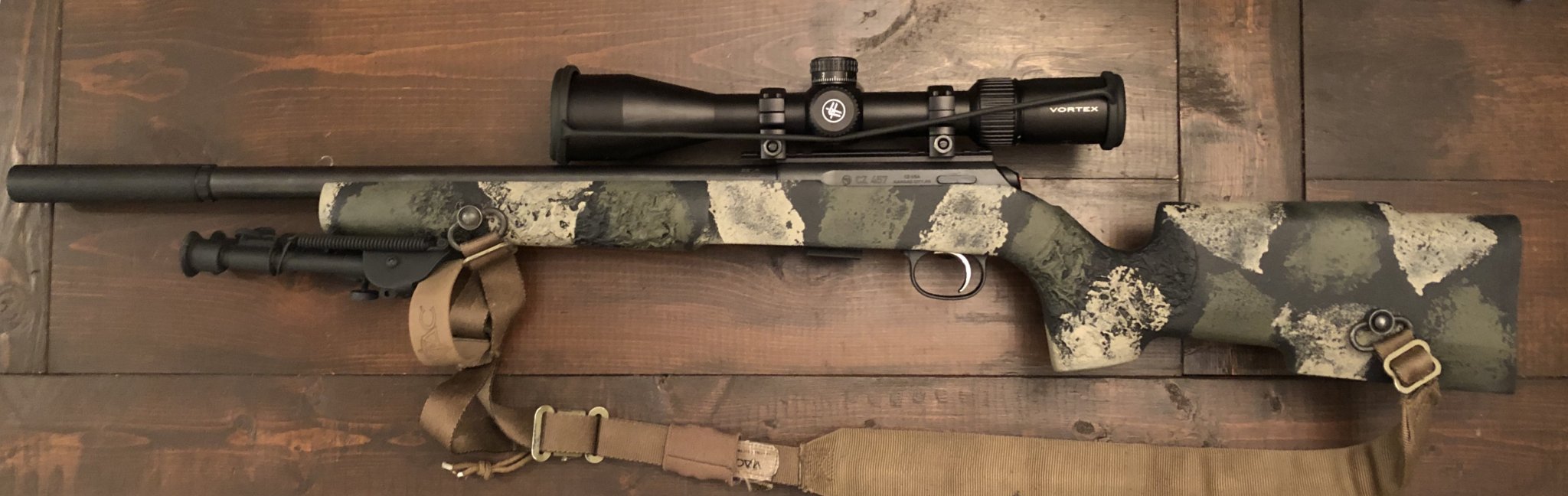

I went and did it. Never thought I would actually build up a .22, but I borrowed a 455 and shot a NRL22 match; now I have the bug. This is the start of something beautiful, or a rabbit hole leading to a Voodoo. Don’t know which yet.

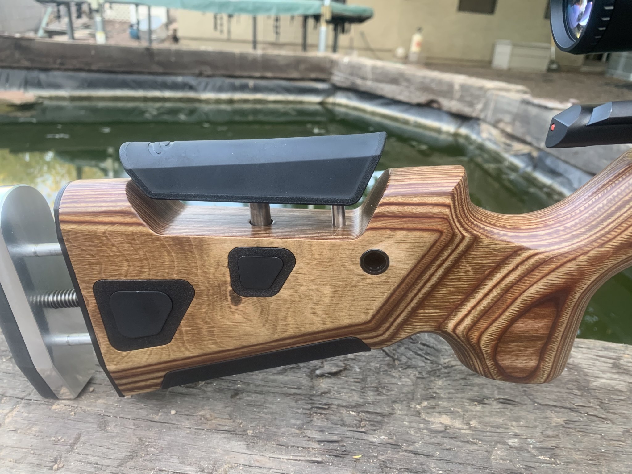

Parts are on the way to finish this out. Has anyone had cheek weld issues with the Tacticool stock, Area 419 base and low rings (.83")? Just wondering if I will need to build up the cheek piece.
Yes. I installed the Matthew's adjustable cheek riser on my Tacticool. Amazing.

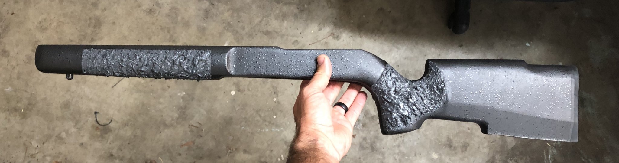

I bought a Boyds ProVarmint for one of my Howa Mini builds a year or so ago, with the adjustable CP and laser stippling to make it a little easier to hang onto the stock. I re-barreled a 222 Mini for 20 Tactical, and it's a sweet shooting rig. Bet you're going to really enjoy your 457 Varmint in that stock! Only downside as far as I'm concerned is that laminate stocks tend to be heavier than regular wood.

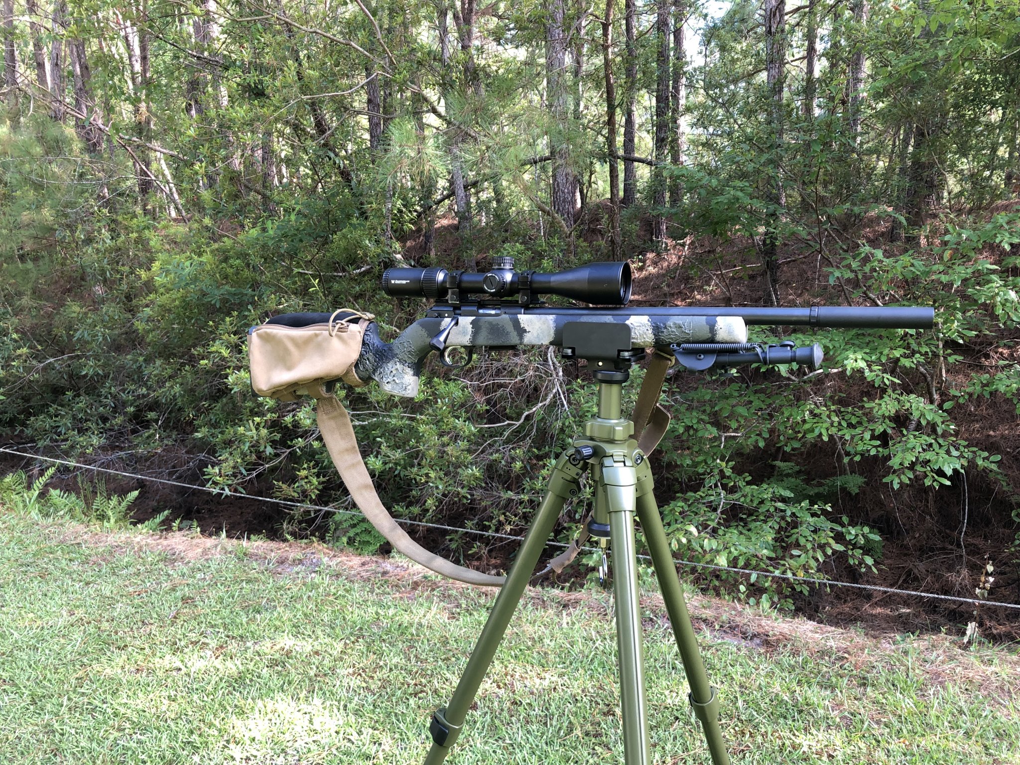

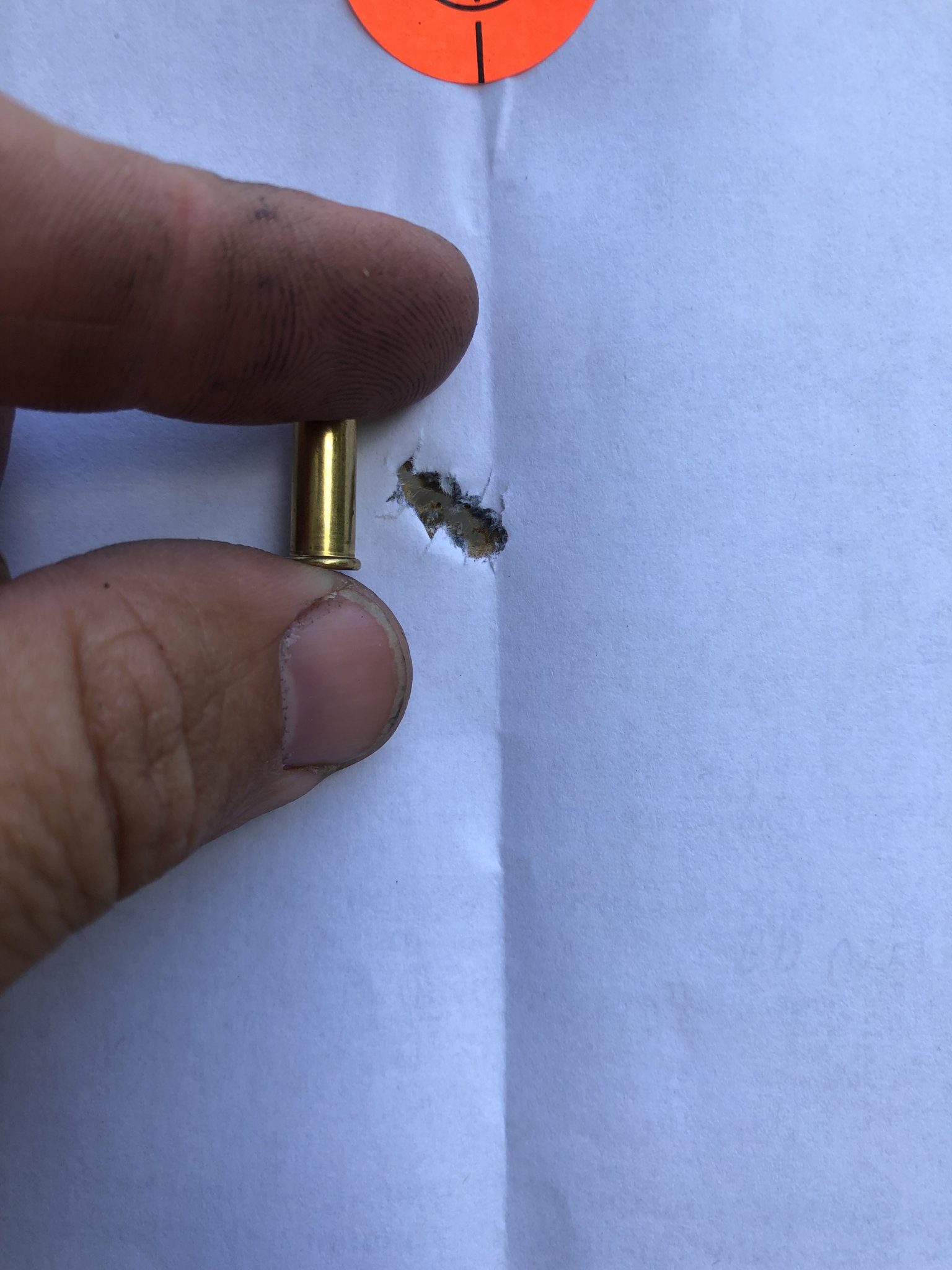

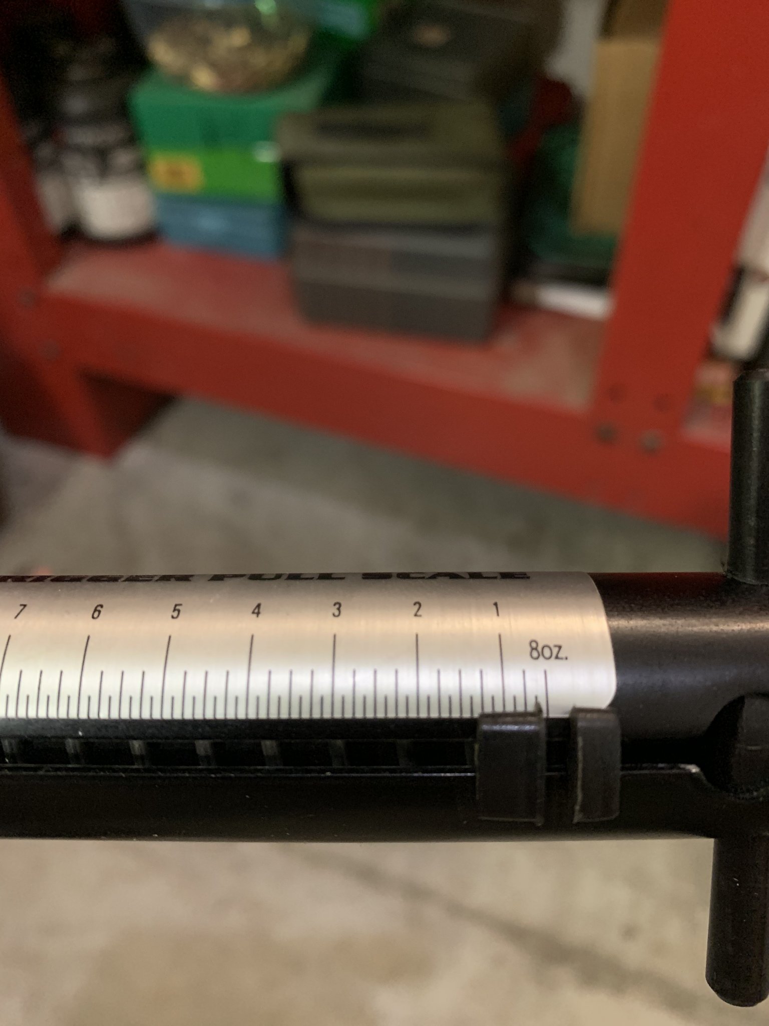

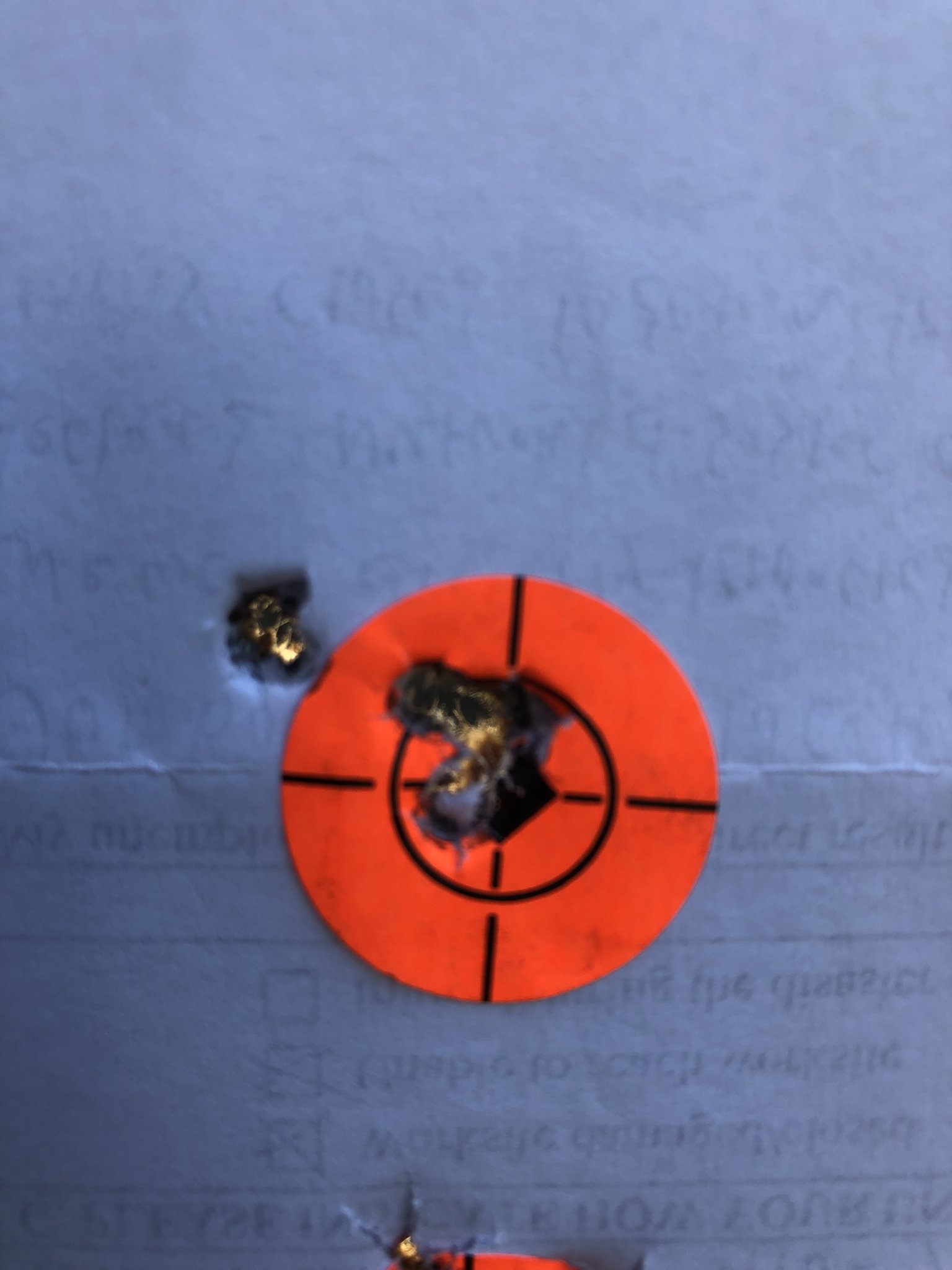

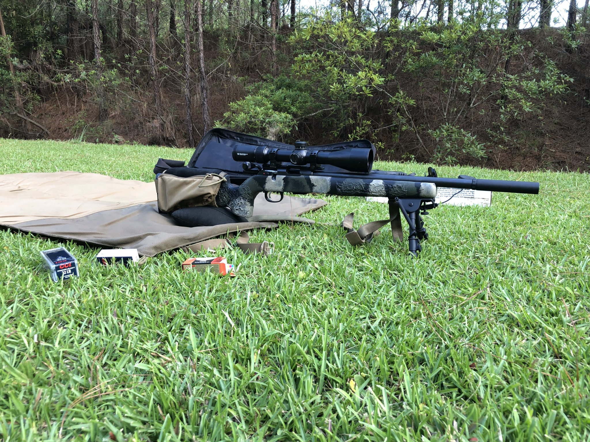

Put 150 though it this afternoon. Only had CCI SV and FGMM. It liked the CCI. Best group of the day below. Forgot calipers. Second best group just below. Pulled the last shot. Need to adjust the trigger.
LOP is way too short. Need to get some spacers or something. Thought about just getting the VPT but the LOP is only 1/4” longer. It might be the long eye relief in the scope too pushing my head back for a better sight picture.

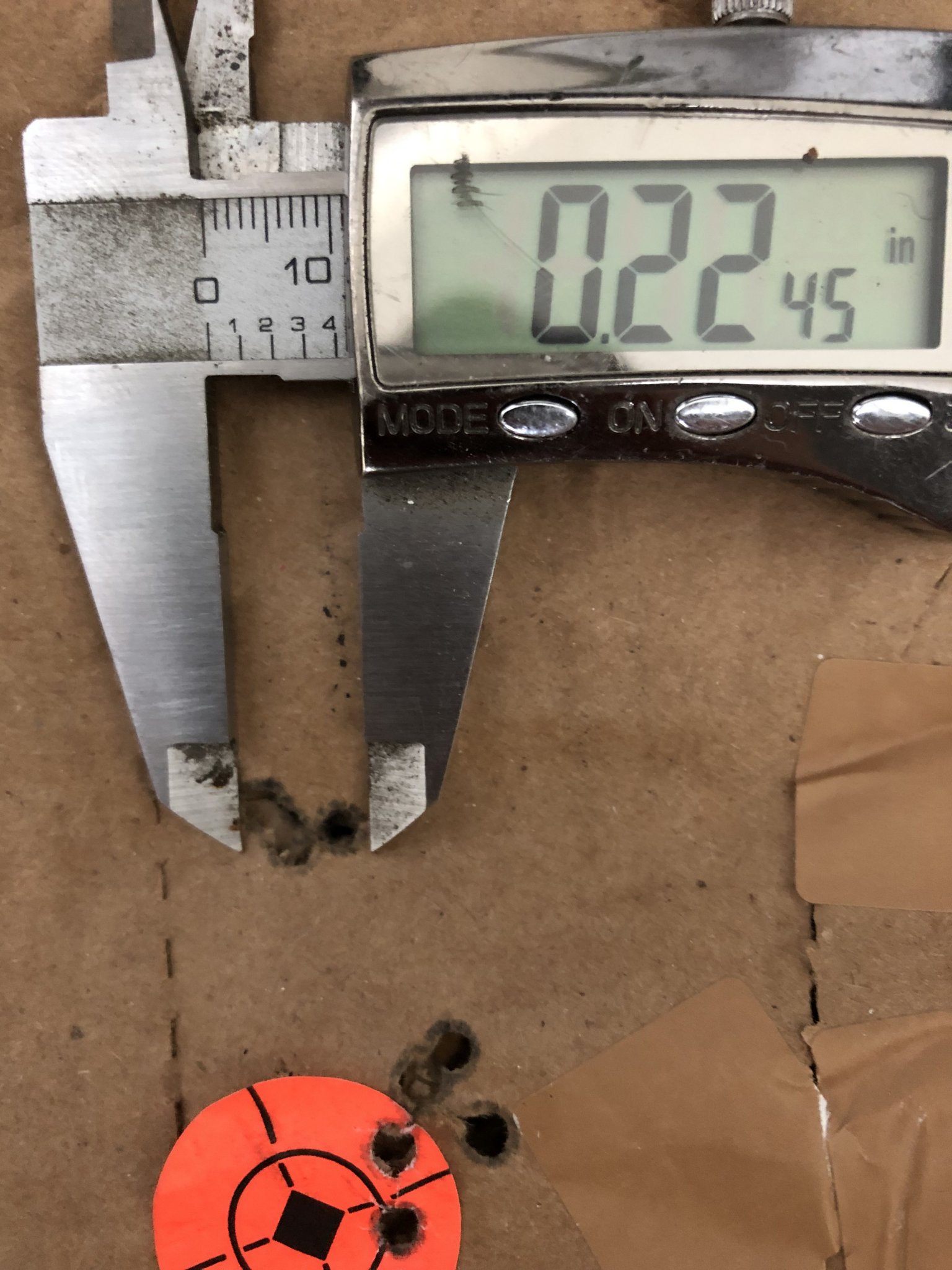

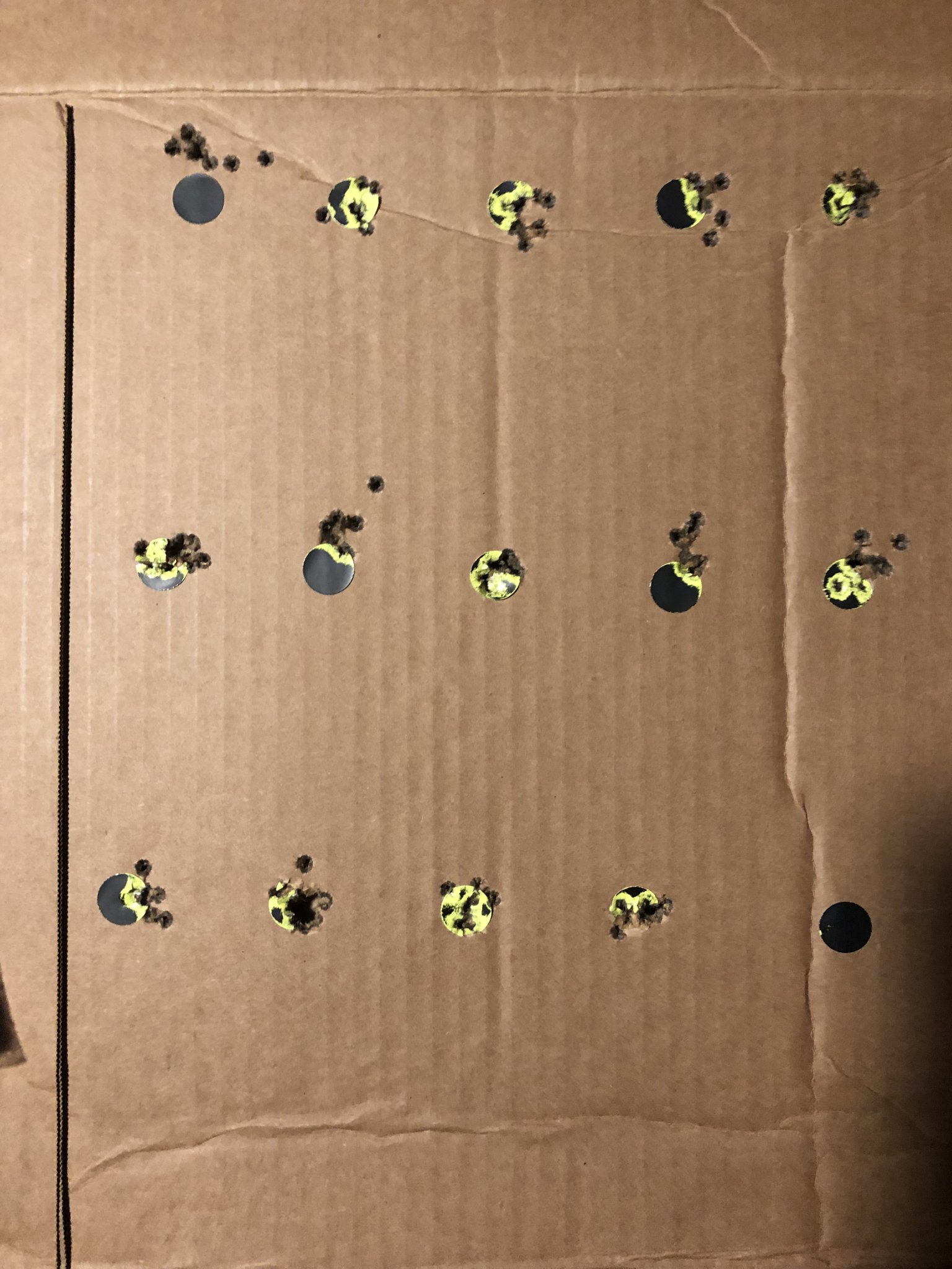

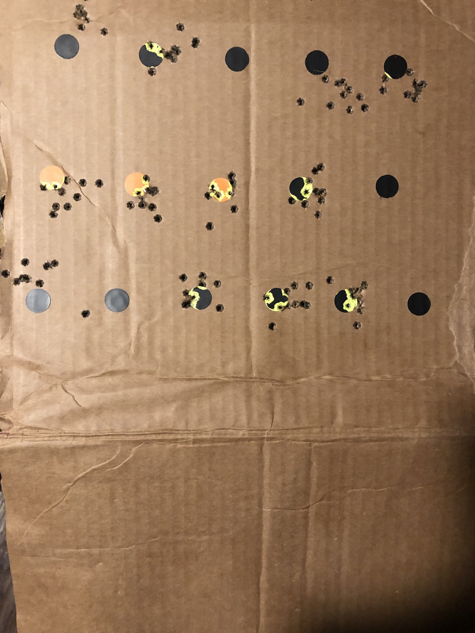

So she’s a hammer.
All 10 round groups at 50 and 100.
The elevation differences are from testing 4 different kinds of ammo.

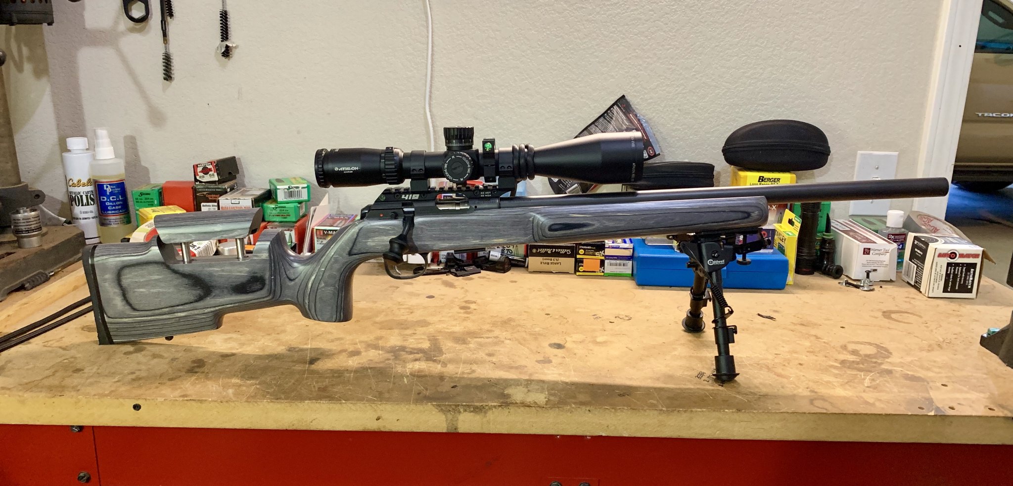

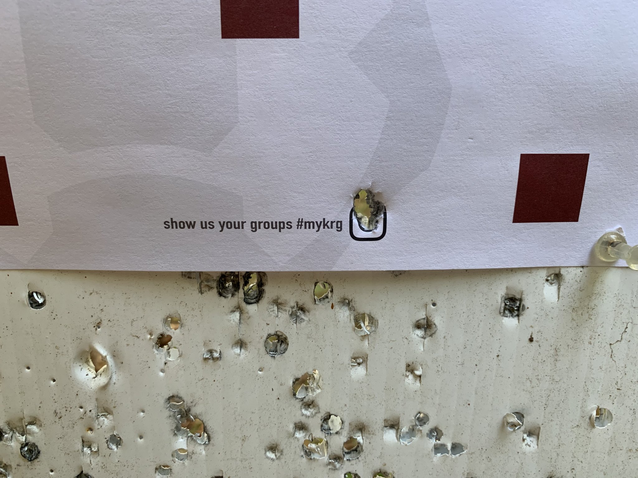

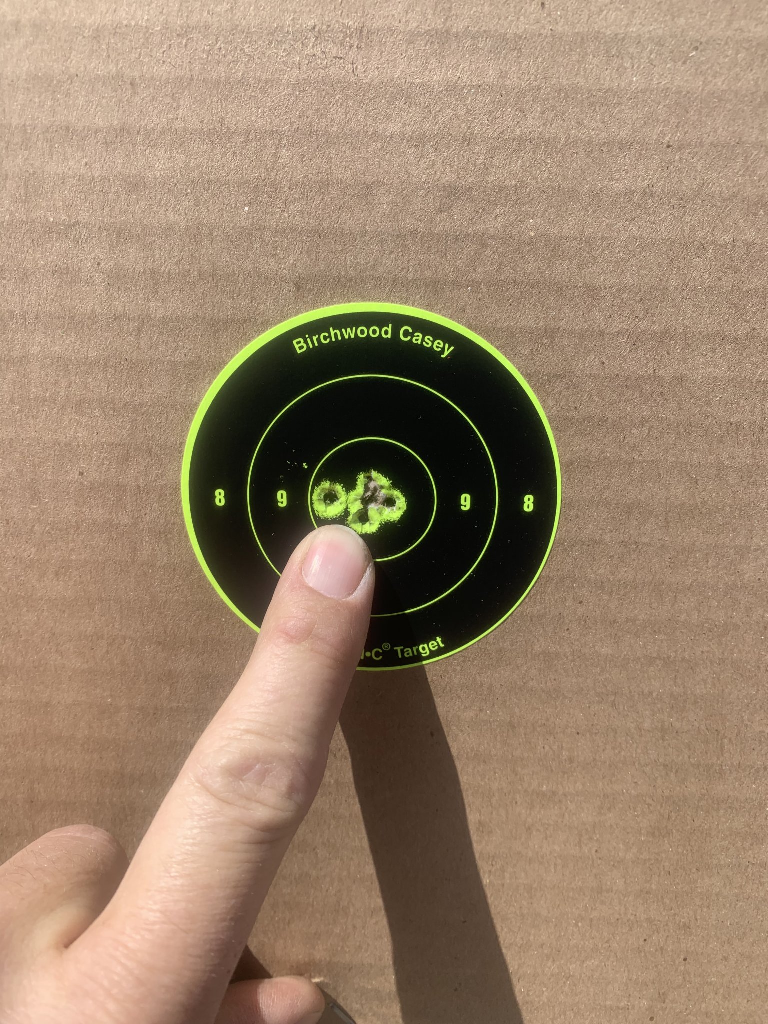

Stock Pro Varmint with W/ Element 2. Eley Match 5@50yd
Also, took it out to 300 on a 10in plate. 14 mil elevation and .5mil windage. Very calm day. Was hitting all day on it with the Eley Match.
Couldn’t connect at 400 on the 6in plate.

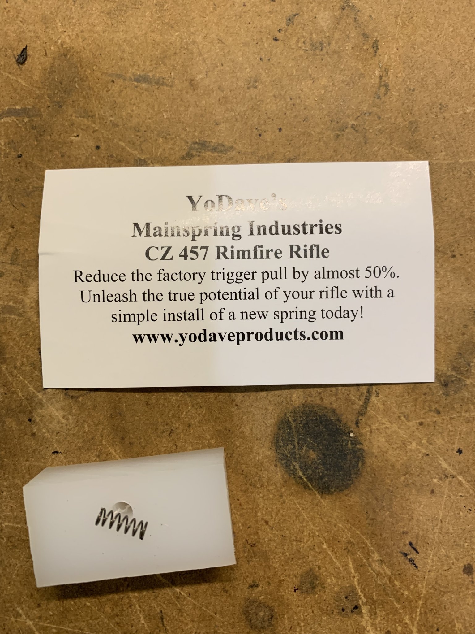

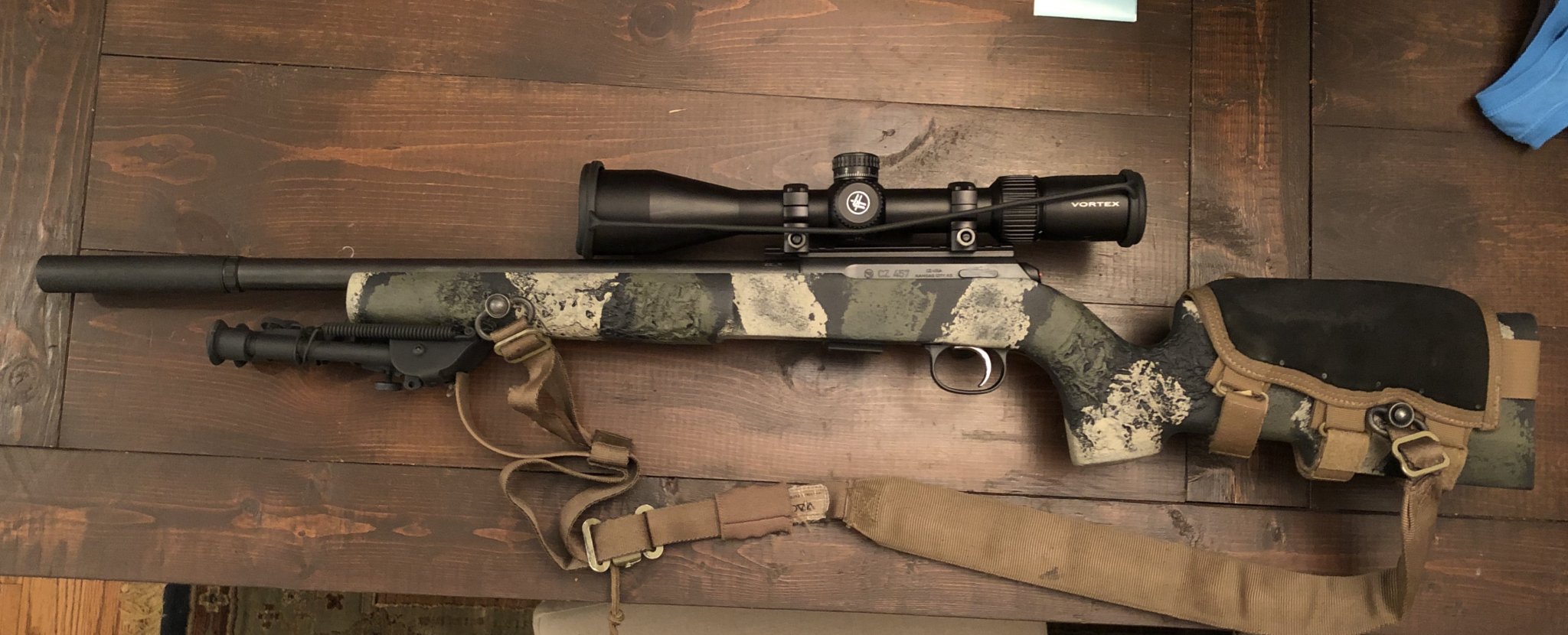

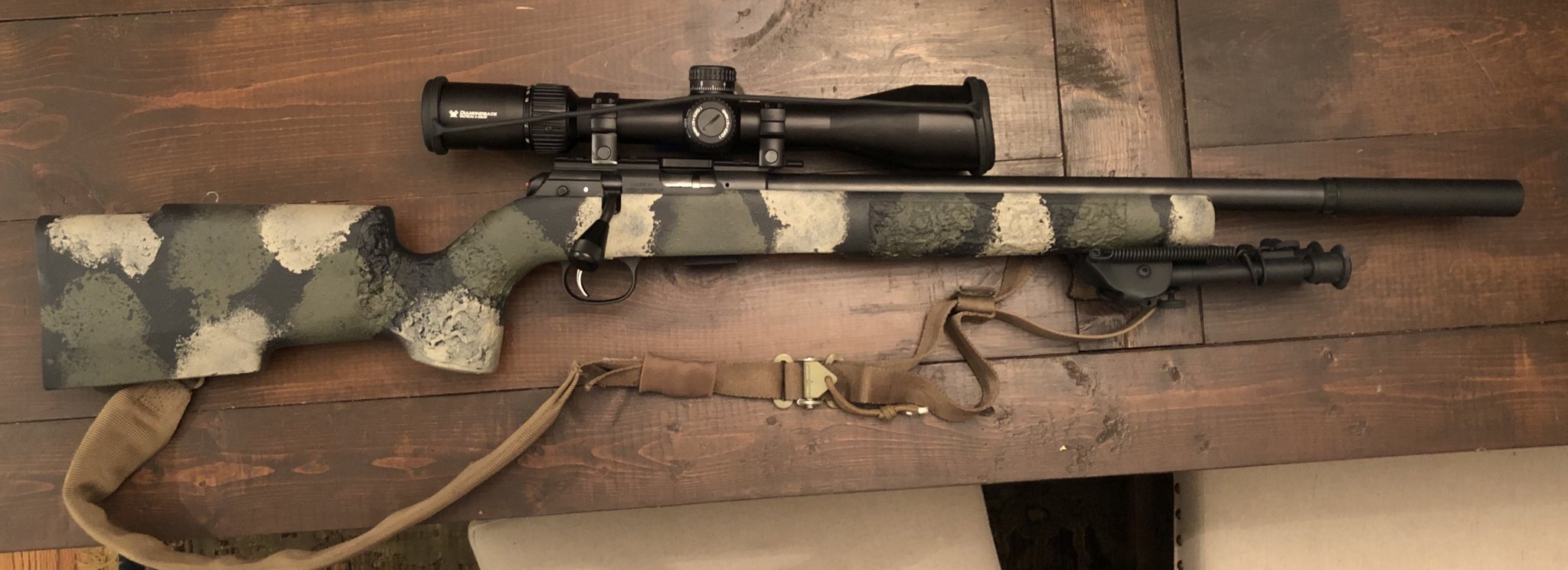

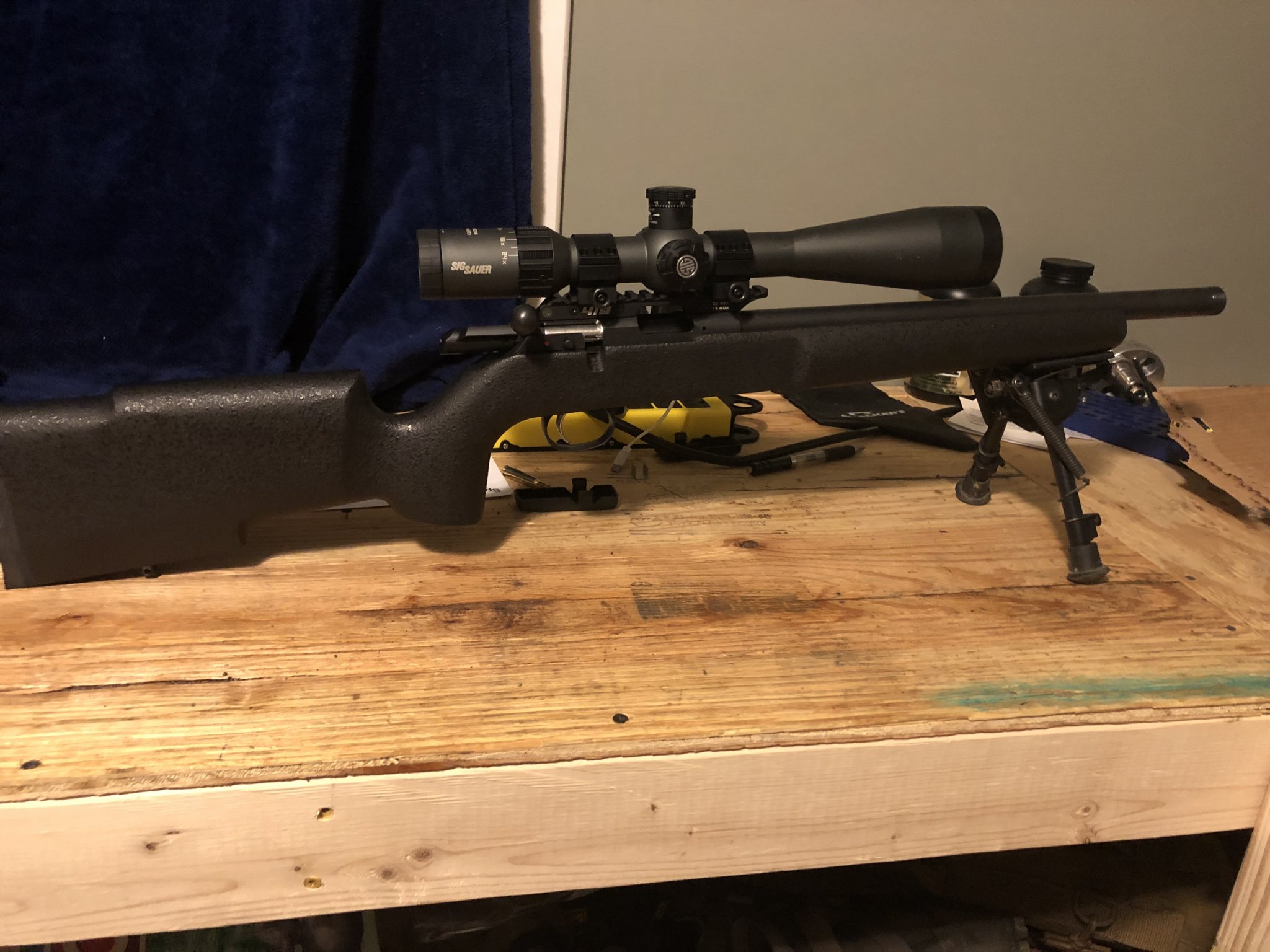

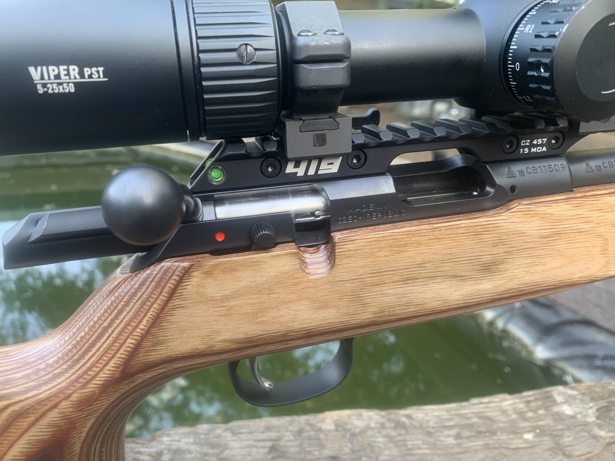

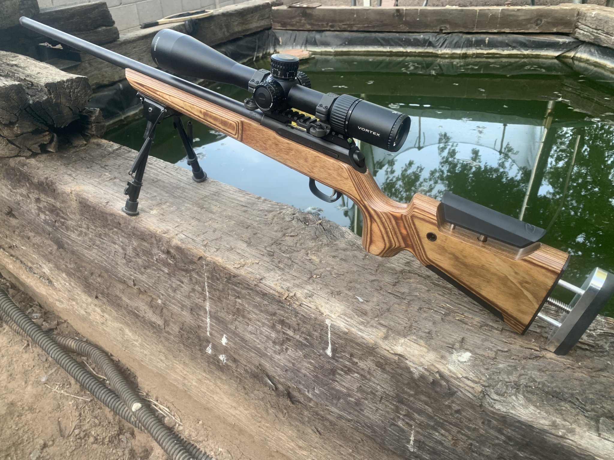

I bought a cz457 “at-one” in 24” flavor. Put some area 419 goodies on it and my pos gen2 pst ebr2c and some rings I couldn’t seem to give away. In gusting wind i could put a decent group at 50 yards with a bipod missing a nut on the leg. Wind played the biggest role.
After this I adjusted down the trigger and have killed about 200 prairie dogs, some in az some in Colorado on my buddy's ranch.
Using wolf target match with all this and tried extra match with no real change. Its the only ammo i have tried, but its stupid quiet with an ti-rant 45 can with fixed barrel adapter.
I’ve made more people jealous with a $600 dollar gun than all my 3-5k dollar rifles. It has won my heart and here to stay!

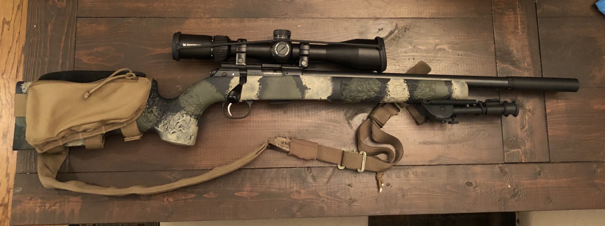

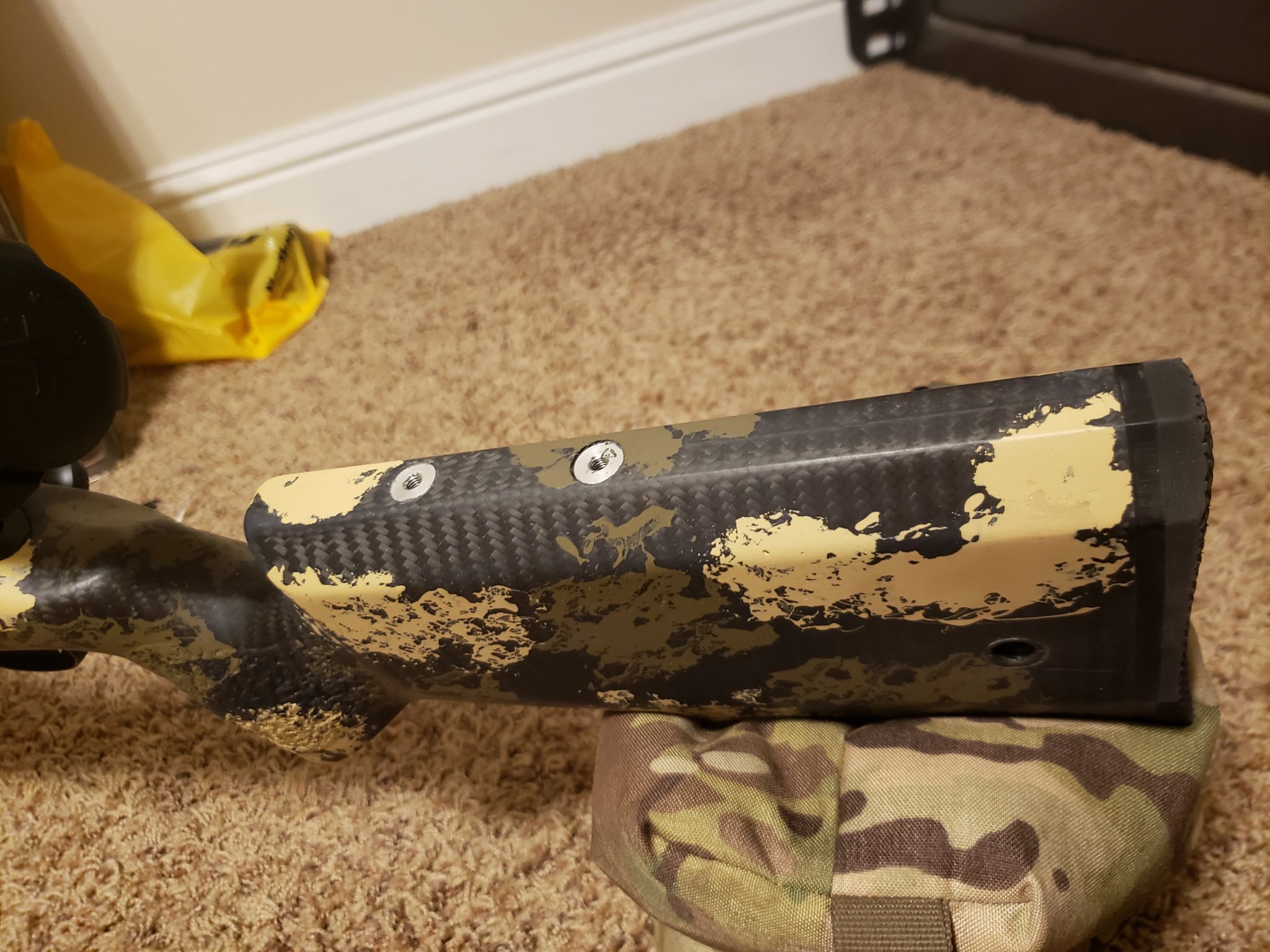

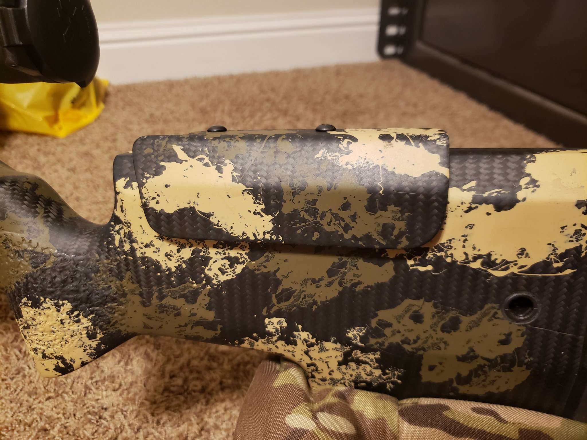

It's the lightweight cheek that Manners offers on their compact stocks. Pretty straight forward install, if you're comfortable drilling 2 1/2" holes in a brand new CF Manners. It comes with 2 1/8" spacers and 1 1/4" spacer for a max height of 1/2". I have the 1/4" in it and its perfect.
I was contemplating having StockDoc do a full Loggerhead job, but I HATE sending stuff out for work. After speaking with Jim at Manners, I went with this option and did the install myself with a drill and a little MarineTex. I am in no way disappointed. It looked like it might have too much flex in the pictures online, but it is solid as a rock.
I cant seem to find this part on the website. can you link me to it please?
