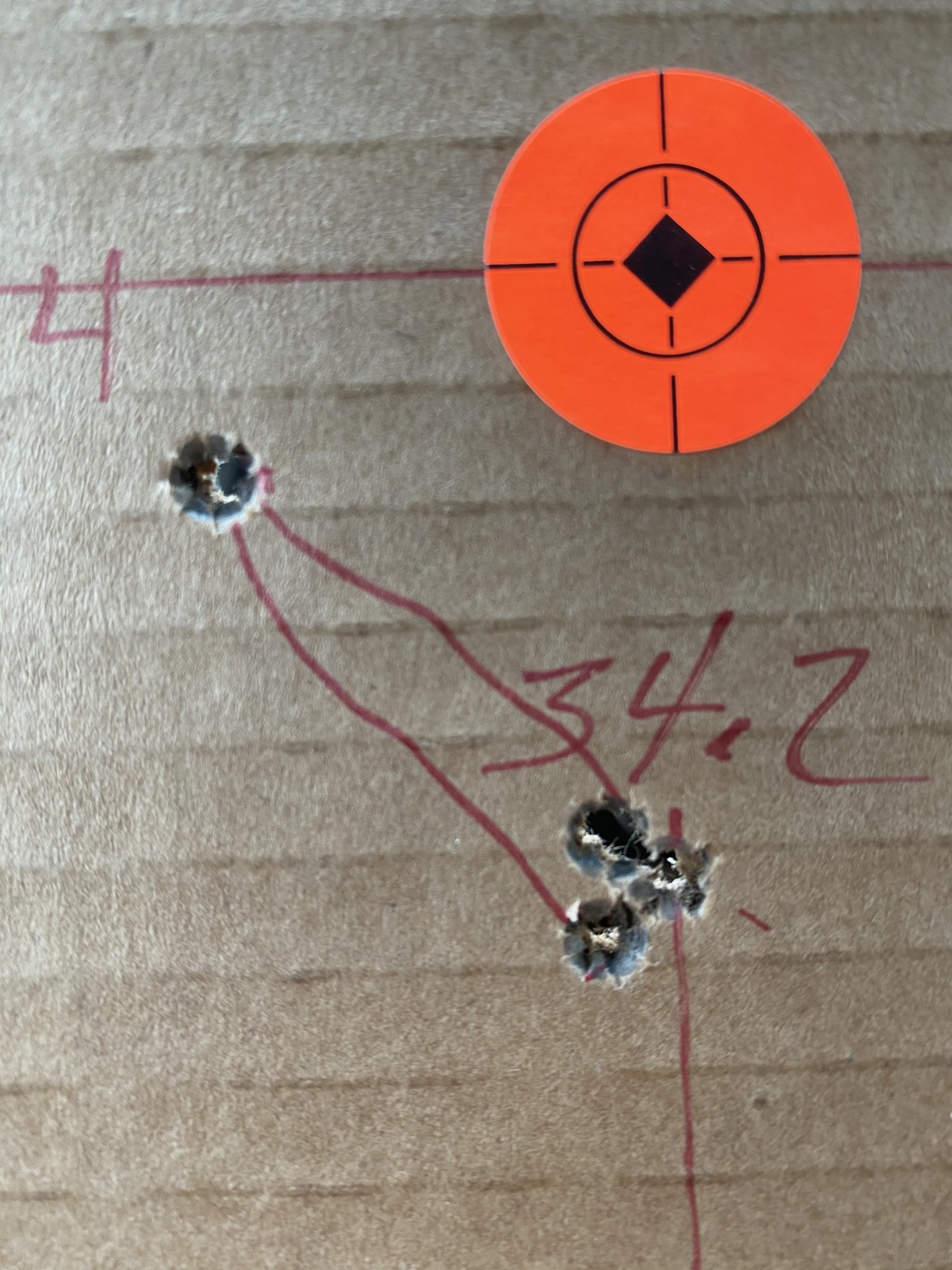

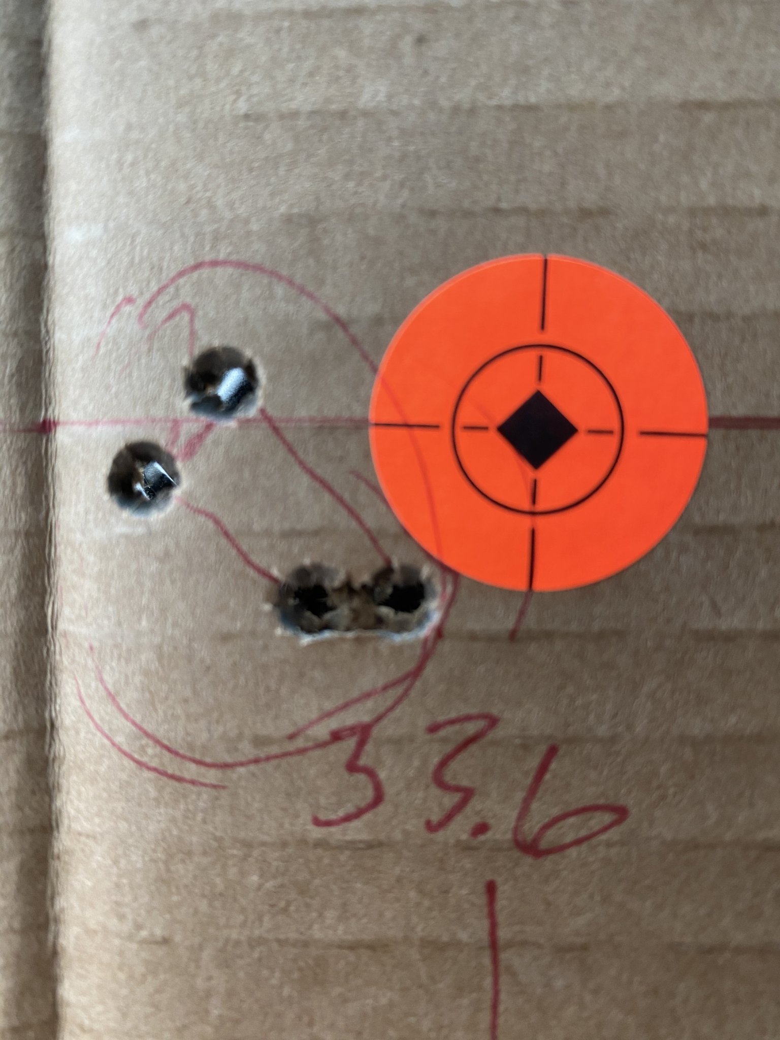

I had considered a straight BR. But decided to go with the GT instead. My barrel seems extremely fast, and I've had trouble trying to slow the 105's down. At one point I was running near 3045 with a 105 and 34.2 grains of Varget. I dropped my load to 33.6 and got down to 2960's. But, would still like to get it running slower.
It has proven to be an extremely accurate rifle.
This is 4 rounds a 300 yards at 33.6 and 4 rounds at 34.2 (yeah, I ganked one shot).
My next barrel for this action will probably be a 6BRA. I don't see the need for GT speeds. The GT feeds great though.
