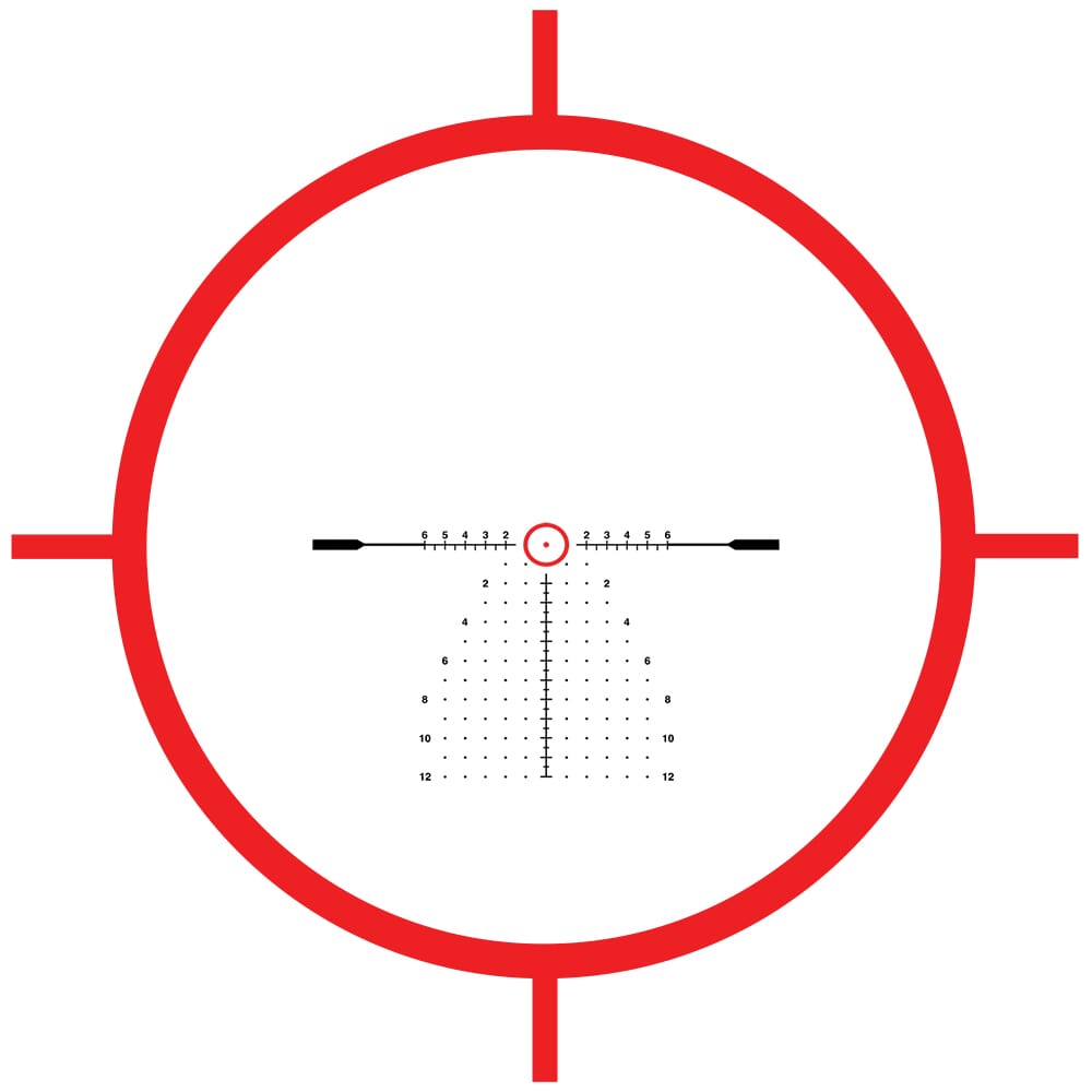

I am still recovering from SHOT. It is a proper modern tree reticle called STR-Mil. I have a picture here somewhere. I'll find it some time this weekend.
ILya
I'm surprised they went with a tree reticle on a 2-12 hunting scope whereas the 2.5-15 tactical scope (t6xi) has the SCR reticle (which I'd prefer). Hopefully it's a very simple tree. 12x isn't much magnification for something like .2mil hash marks. I always liked .5 mil marks like on the EBR-2C.
Edit - found it.
2nd/3rd Edit... I think the pic in the article is not the STR-MIL reticle. Looks like the one described in the article as the HMR (bdc crap)
Edit - found it.
2nd Edit...

I think that image is wrong, that looks like the MOA reticle.
Yeah thank goodness. I just caught that too. Edited my prior post to remove my mistake.
I saw the STR MIL reticle somewhere I thought, maybe in the SHOT 2024 thread??? It has an illuminated center cross, ILya says he likes it so I have hope it will work well at 2x though I'm not holding my breath as Steiner's illumination in their long range scopes is good but not great.
Just to be clear: "ILya likes it" means that finally someone put a modern tree reticle into an MPVO. They also have the same reticle in the 3-18x50 and it is probably better for that mag range. However, they way it is sized, while it is a little too much for the 2-12x, I think it will be usable. I still have not gone over all of my stuff (busy at home), but found this online:

I don't imagine that'll be very useful at 2x...
Reactions: beetroot
Right which is why I’ve avoided it, but that is my fear with the STR Mil as well.
I'm a bit confused by this - are you saying that you want to be able to use the tree and finer subtensions at 2x on an FFP optic, or are you saying that you want to be able to use the finer subtensions at lower magnification that is not towards the upper magnification range?
Sometimes disapearing subtensions on the lowest magnification setting are a feature, not a bug...
Not about the subtensions... about whether you can make out the center of the reticle or if it's just a blurry gobblygook.
Thick duplex along the outer, bright illumination that draws your eye to the center, donut along the far outside, or something thick that disappears out of view at max magnification but points to the center while on the low end... those kinds of things. Look at Athlon and Vudu reticles

Don’t care about the tree or subtensions at low magnification but need to “easily” see center, just like many LPVO FFP reticles. The problem with putting a standard long range tree reticle in an MPVO or even many mid-range scopes (like 3-15’s) is they are completely useless at low mag.
Without seeing the subtensions or reticle in person it's impossible to know what it's like on 2x.
But based on every other scope on the market, I'm not holding my breath.
If I had to guess I'd predict the reticle is even too thin even on 3x.

I would agree based on the reticle itself; however, with proper illumination the center cross may be usable.
Reactions: lash
The problem is I don't want it to be "usable" it needs to be functional.
I can see why manufacturers have stayed away from this category as it seems to have very divided opinions on basically every aspect of the design.
The one and only thing people can agree on is the reticle must be properly functional on the lowest magnification.
If you have the choice of re-using a LPVO reticle or a 3-15/18 reticle I'd have thought it was obvious the LPVO reticle made more sense in a MPVO.
