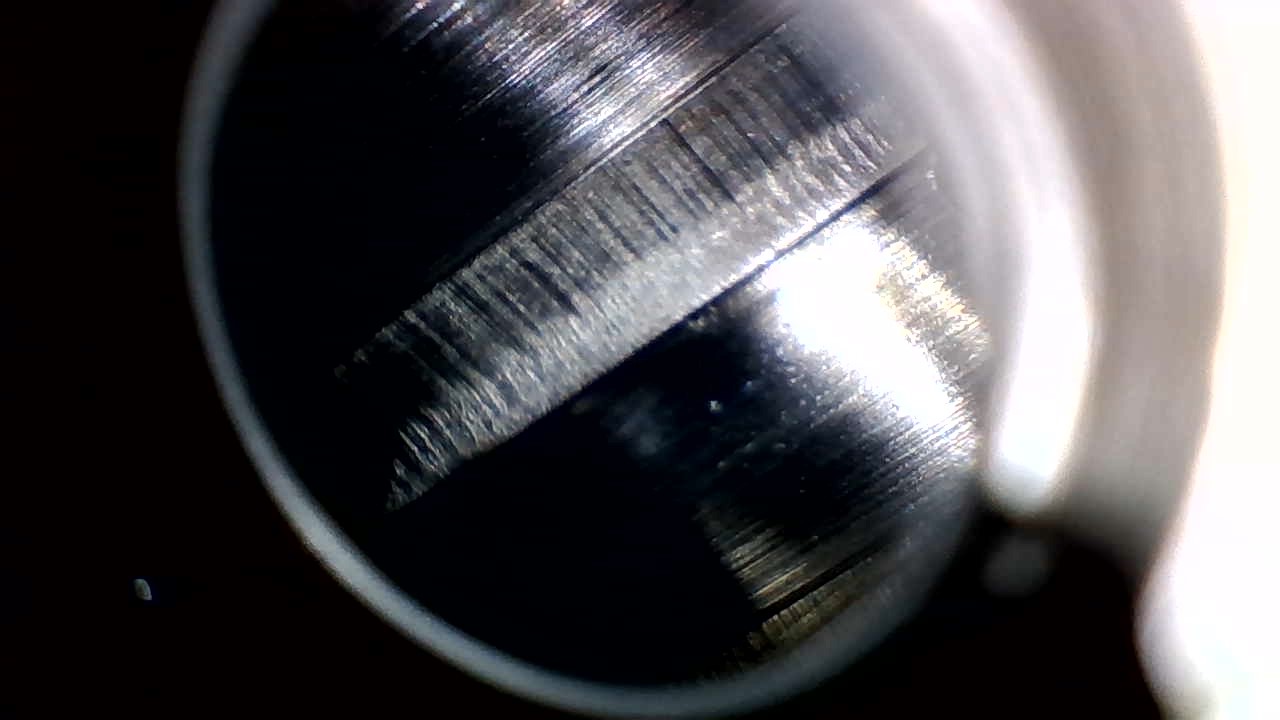

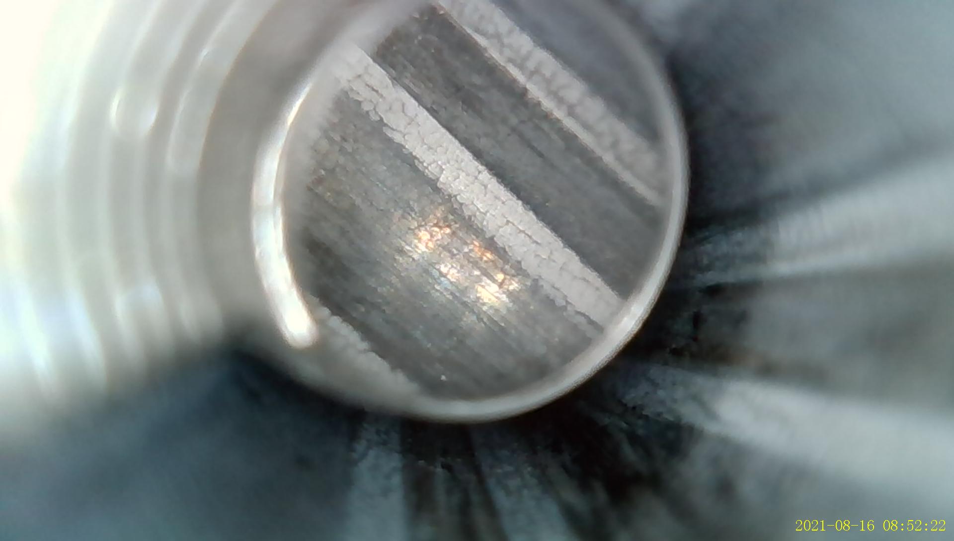

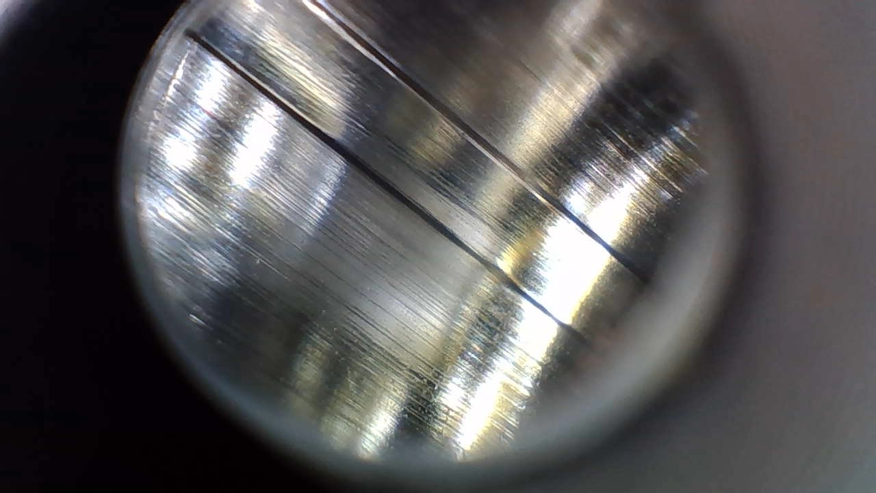

I just borescoped this barrel and it appears to be dirtier than I remember it being in the past with a lot of copper at the muzzle end. The brass isn't dirtier than normal though.
Reactions: MarkCO
Only 1670 rounds through this barrel. I wouldn't think it is time to rebarrel at this point. I really think it is related to the barrel cleaning, it seems to like being clean.
What does the chamber end look like? Lots of copper, fire-cracking, maybe a carbon ring? Copper at the muzzle is an easy problem to solve. Carbon rings and fire-cracking ... not so easy.
The chamber end has a good coating of carbon along with copper streaking. No carbon ring. Fire cracking is present but not extreme no missing pieces out of the rifling yet.
I guess I should have shot some pictures of it but didn't because the computer I have the borescope connected to is pretty slow. It's the garage computer lol.

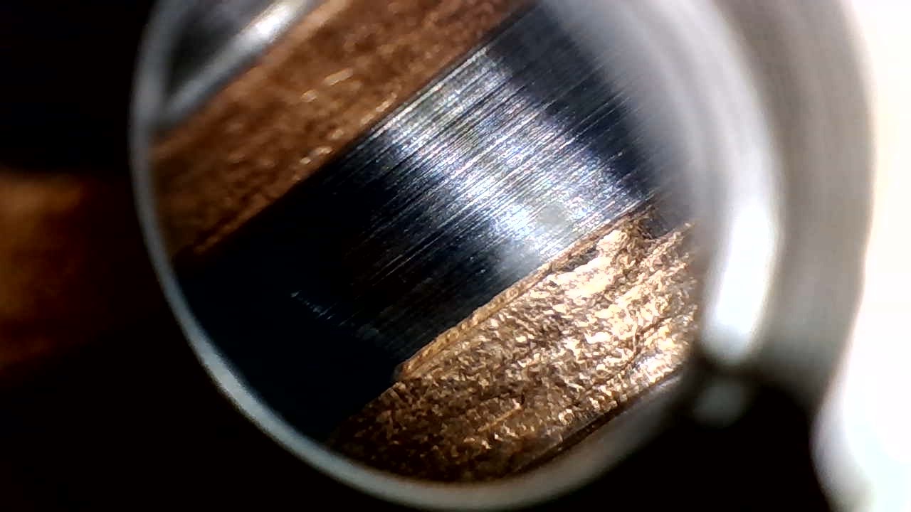

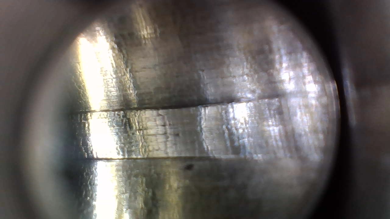

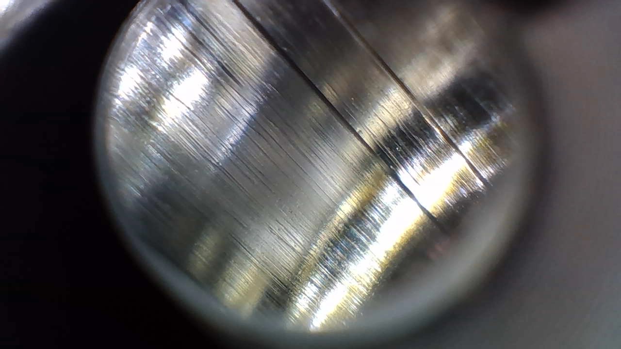

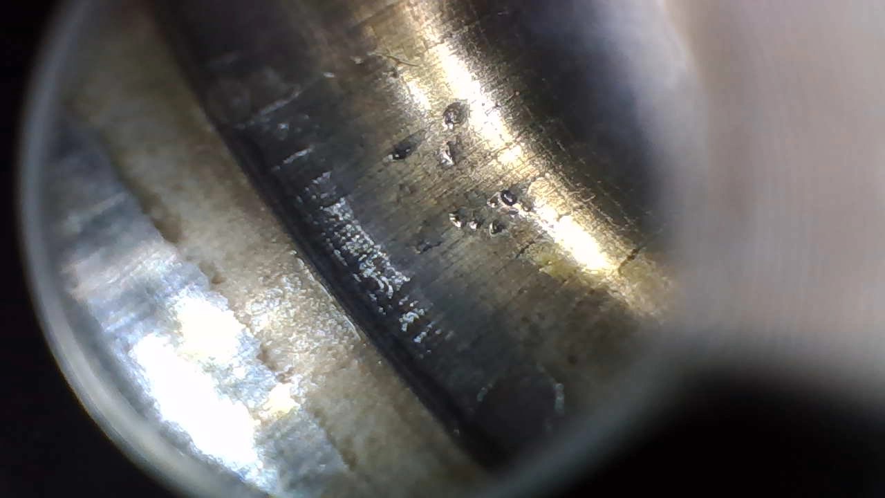

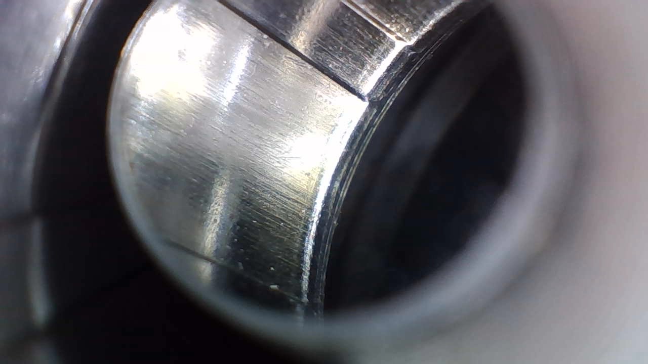

I didn't mean to mislead you on this, the muzzle end is not in worse condition than the chamber end by a long shot. What I was talking about was the heavier than normal layer of copper on the muzzle end. I just don't remember seeing that much copper build up but I don't always scope the barrel before I start cleaning. It does feel really smooth on those last patches just like you are saying.
Here are some pictures after cleaning working from the chamber to the crown. The spot on the chamber is the worst area and the only area that I see those divots.

I do use BoreTech products incl soaking a bore mop in their carbon remover and shoving it into the throat/first part of rifling.
Compared to your bore scope pics, mine would look like there is still carbon in the fire cracks (because there is) but I have a hard time seeing how this "below grade" carbon would impact my shots vice the potential to screw it up with too aggressive of cleaning. But...let's revisit that I'm an idiot and there are others on this board far more expert than I.

You nailed it. How clean is clean? Before the cheap borescopes came out I'm thinking clean wasn't nearly as clean as it is now. Good or Bad?

copper should not be a problem. Unless the leade looks like it's been cut with a drill bit. Like the one in the pic. Don't be
