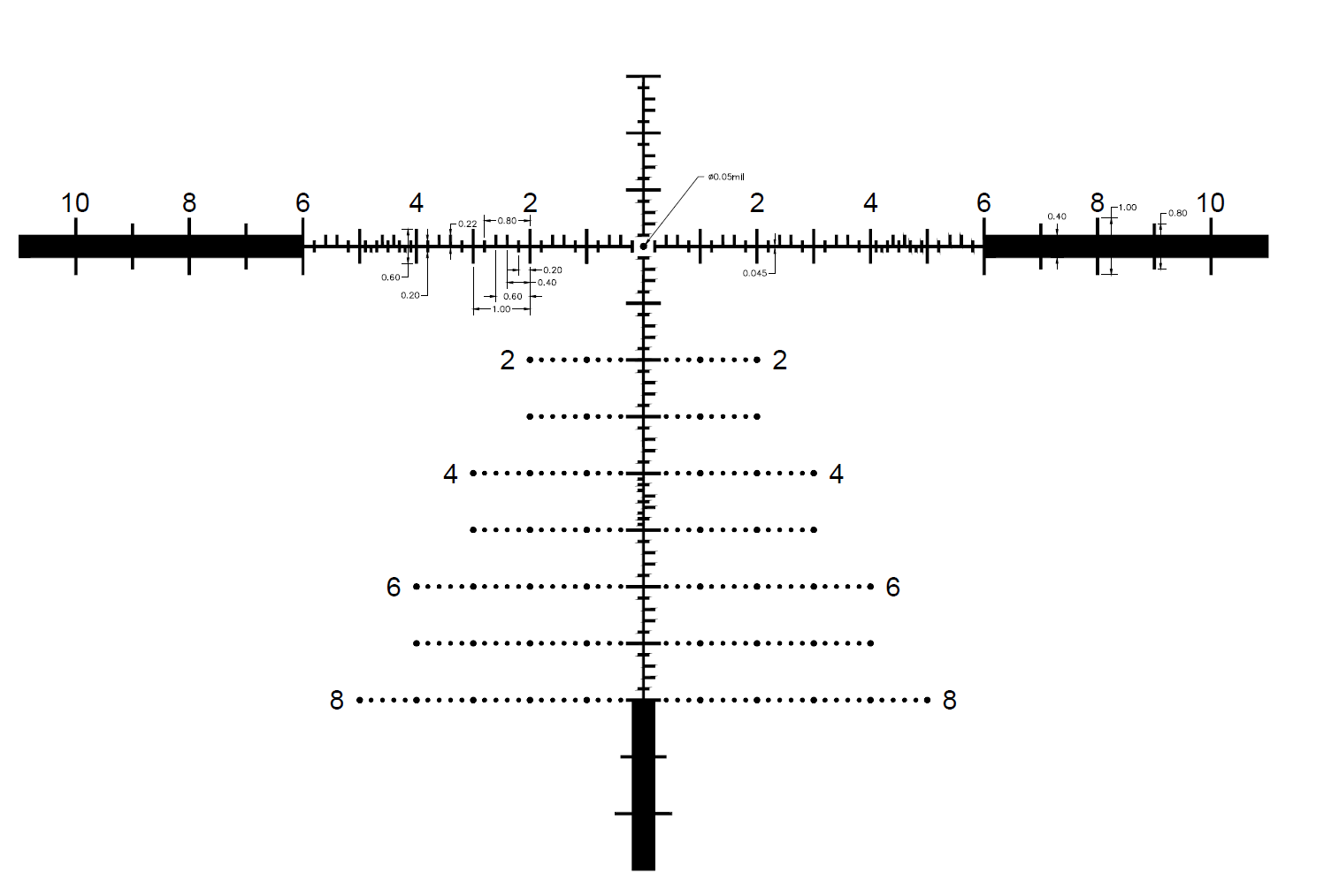

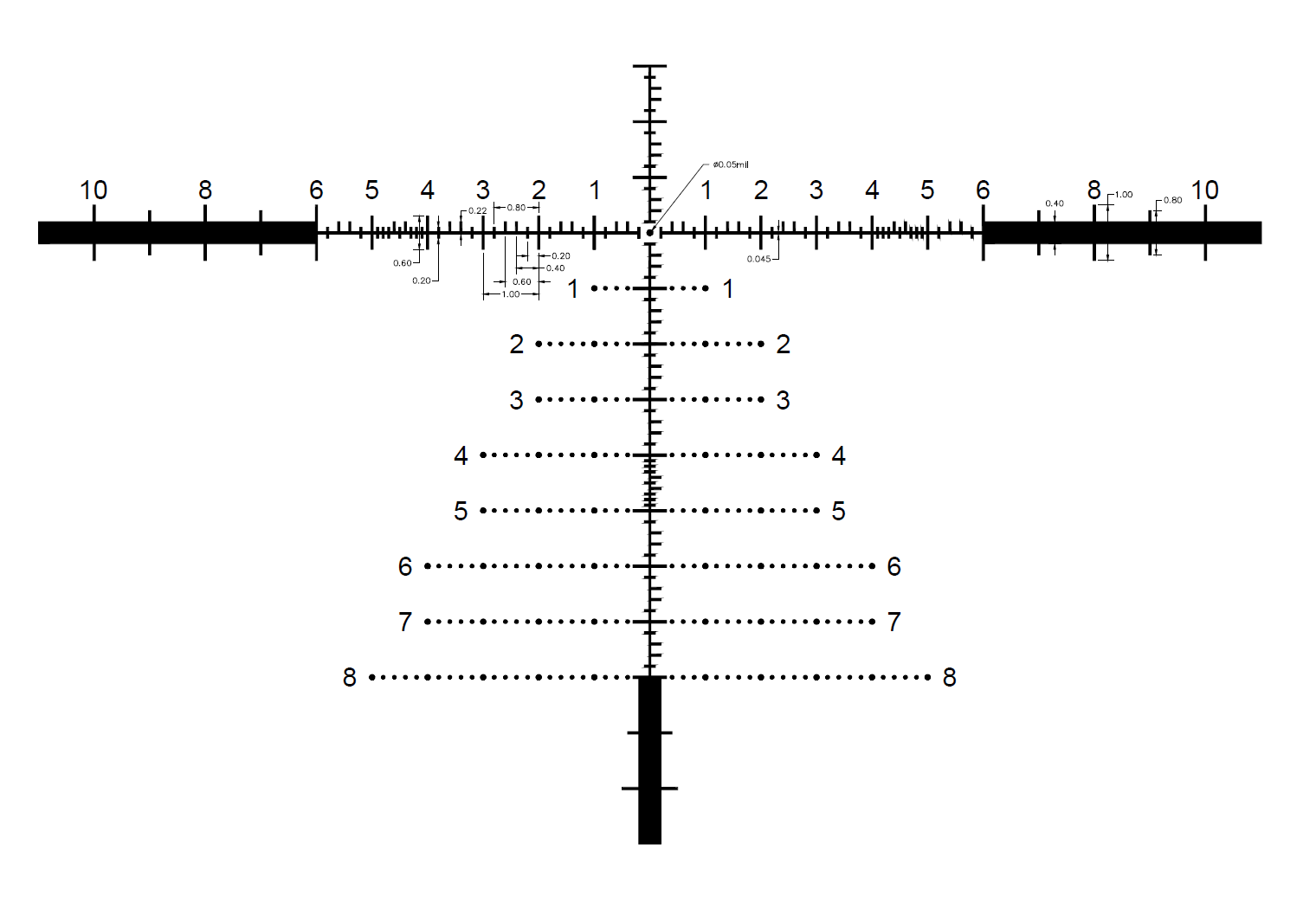

    Quick and dirty for a 3-18. A sort of mash-up between a mil-c, G2MD, and an EBR dot tree.
    I like the elevation numbers on both sides but I find that tree to be a bit wide near the base. The alternating 0.2 marks are awesome.
    For me I normally start my trees at the 2 Mil mark below the main crosshairs as I want a bit of a gap to see around and being that close, it's easy

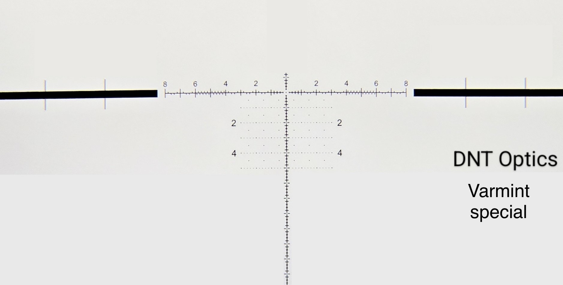

    No disagreement there. In the 5-25 or 7-35 versions, I'd make the inner reticle 0.035 mil thick, the center dot 0.03 mil dia., the inner reticle would extend 8 mils right & left, and probably 10 mils down, and the thicker outer lines would be reduced in size. Regardless of my little sketch, I think most manufacturers could make very minor tweaks to existing reticles to better accommodate varying magnification ranges. I'd hope the scope model gets accounted for in these discussions about reticles. Or not, chances of me purchasing a DNT are slim to none right now, haha.

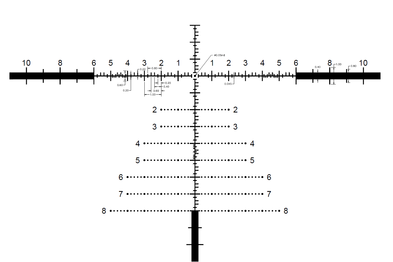

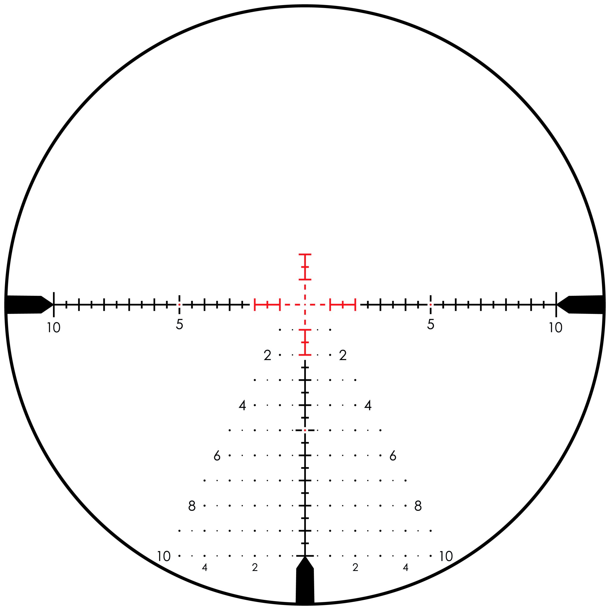

    Some drops, better view.
    I really like this. I'd go ahead and extend the tree down a few more Mils, it's not obstructive anyway.
    I like the vertical stadia with centered hash marks and open areas every Mil.
    The reticles that alternate sides on the vertical really make my head hurt. For some reason it doesn't bother me on the horizontal though.

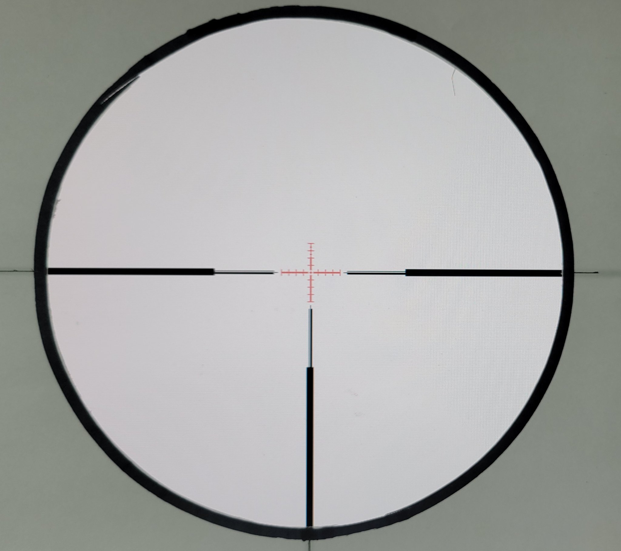

    For an option without the tree, an improved FFP of the old NF IHR reticle:
    That’s what illumination is for
    The desire for a 3-18 is mostly for hunting/crossover use, and many like me want a reticle to be usable without illum at low power if it’s going out in the field. You really don’t need 6-8 mils of holds in every direction for a scope like that. The heavy stadia can be brought in to provide a 3x aiming point if a donut is out.

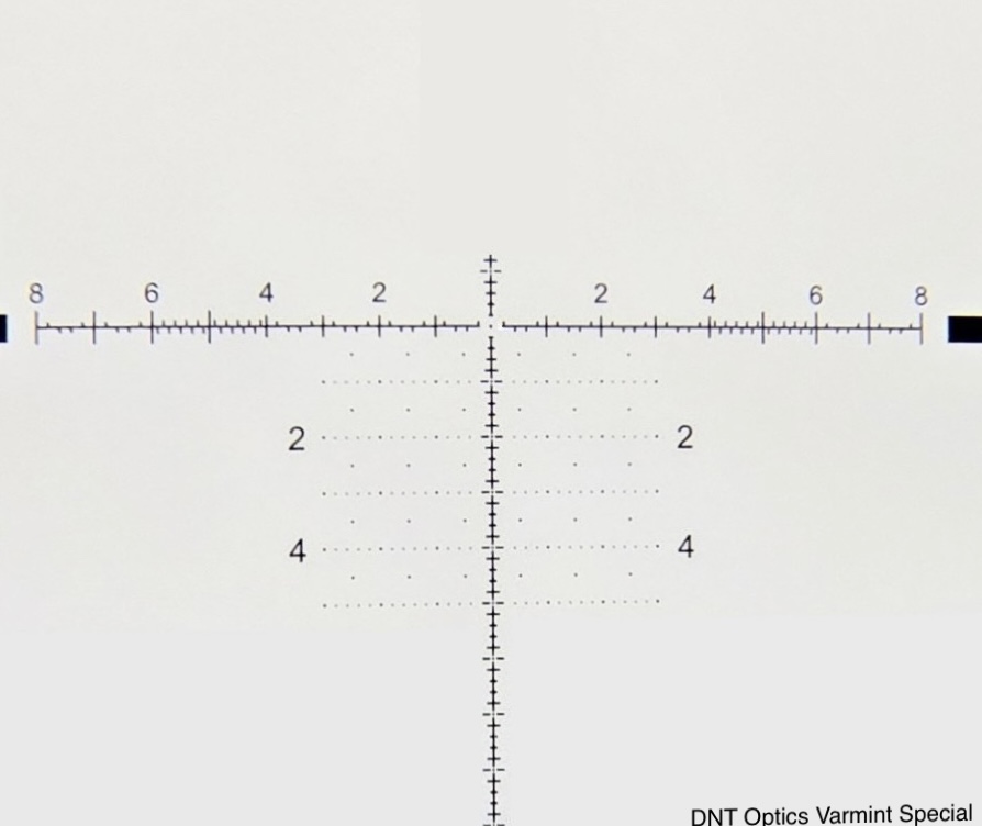

    Personally I really like the reticle the DNT I just bought already has in it. Which is very similar to the Mil XT already
