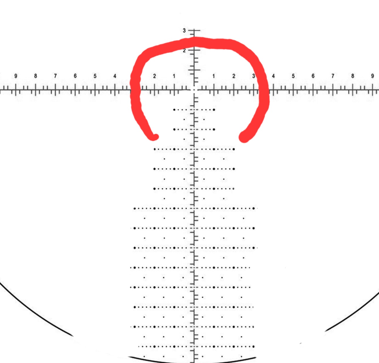

A work around would be a wider and thicker Circle Of Death in the 2-12 because it's somewhat assumed that COD will be used for closer engagement in which touching off a quick shot holding in the kill zone will result in a decent enough hit. This way the center dot can be reduced slightly, however now you've got some obscuring from the COD, and the dot is getting very small to see on 2x if one wants to use it.
Aside from that I think for many a 2.5-15 or 3-18 would be more appealing for precision and general duties with a slightly thicker reticle than what we normally see and mentioned more than once here. Those scope companies have been terrified to do this because of the Tiny DoT Tribalistic attitude, which is fine on those 5-25's and 6-36's where .025-.03 mil is more desirable.
No I completely get that it’s a compromise and I understand to offset aim with it. That I completely get. I do think a thicker circle and smaller dot might be better, and I don’t thinkI’m a 1/2 moa shooter all day long, but often enough I’m shooting targets that are small enough to get obscured by a 1 moa dot and that’s the issue I’ve been having with my Leupold mk3hd sfp 3-9x with the TMR reticle. That reticle covers about 3/4” at 100 yards. If I’m shooting smaller targets out to let’s say 200 to 300 yards, which I often do I don’t like that the majority of the target is obscured and I don’t want to have an offset aim. I want the benefit of that floating dot for what I like it for. Not because I think I’m a 1/2 moa shooter all day long but because I want a more refined aiming point. Not only that but I don’t like that the space between the crosshairs and the dot are a whole mil and I would rather have less of a gap, even if only by 1/2 a mil for the benefit of wind holds when I do dial.
Edit: I think this might be a good place to have the circle and dot a dual focal plane but there might be issues that I’m not seeing with that.

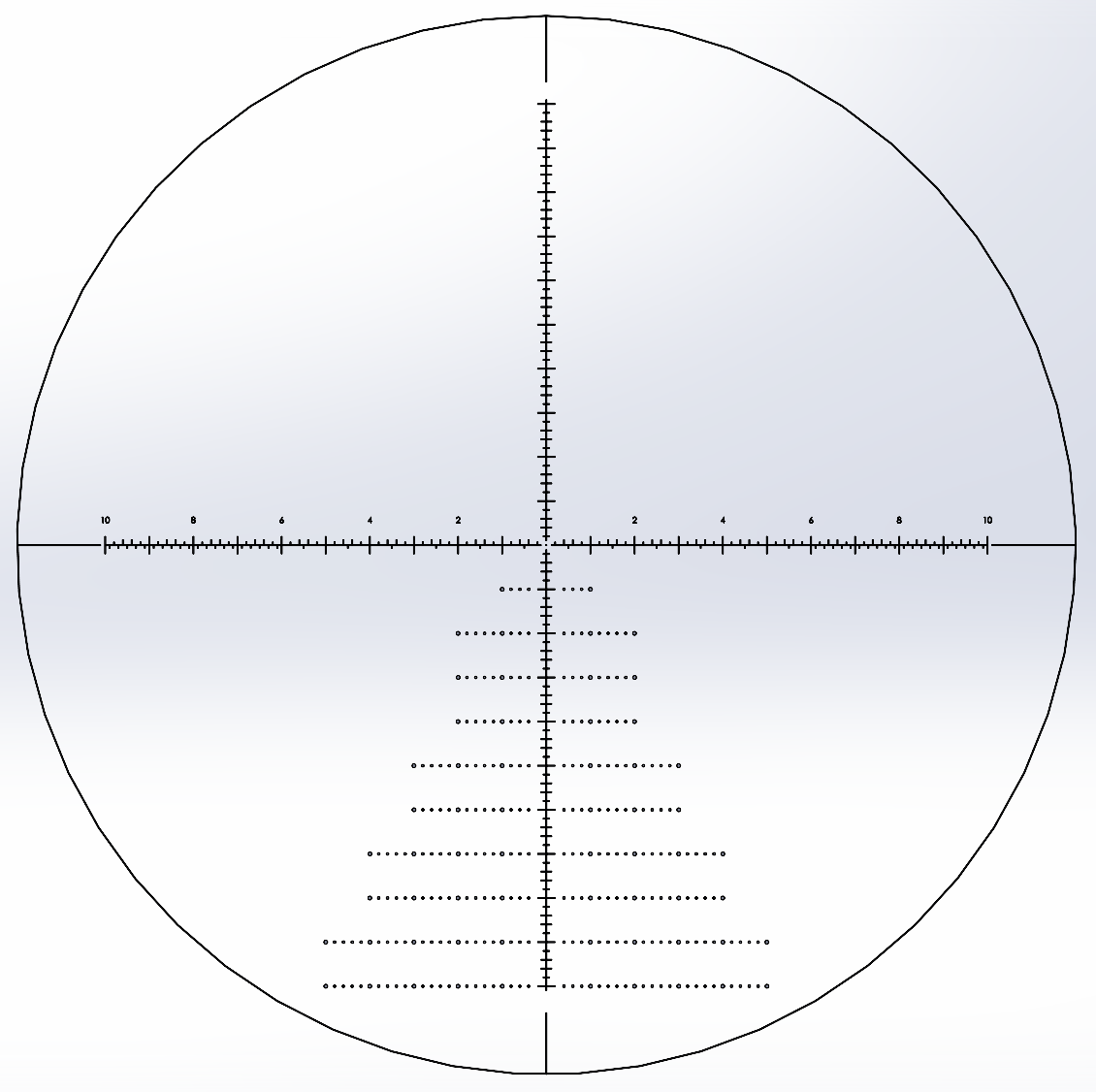

I was always a fan of the 1/2 mil hold dots that the H59 had, but hated the full grid.
The MilXT kept those 1/2 mil dots, and ditched the grid...but I wasn't ever really a fan of the full string of dots on the horizontals that the EBR-7D and MilXT used.
I think 10-12 mil of hold over is plenty, but I extended it down to 23 for giggles...it's easy to back it down.

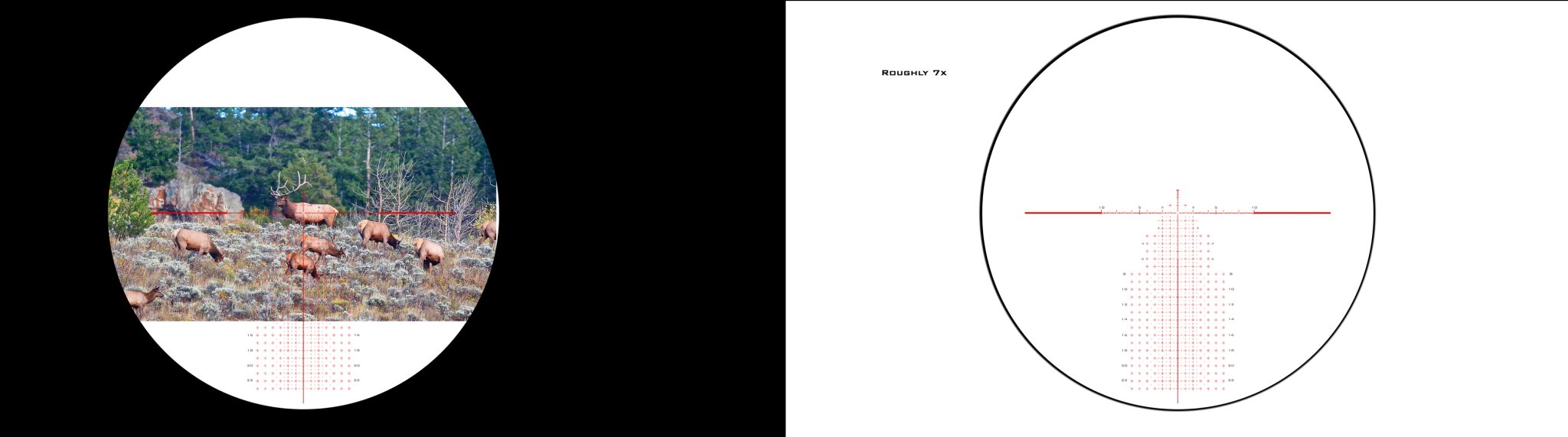

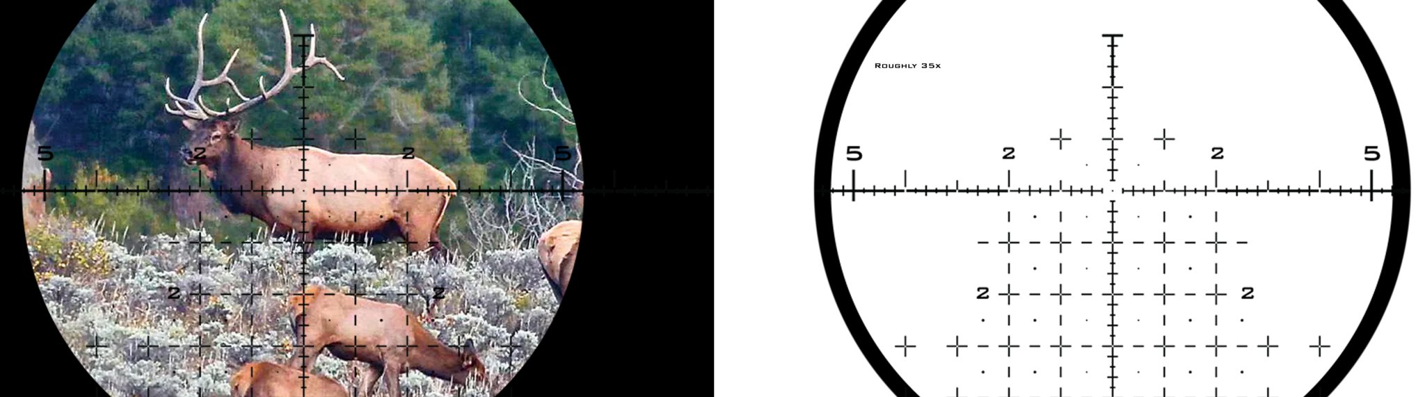

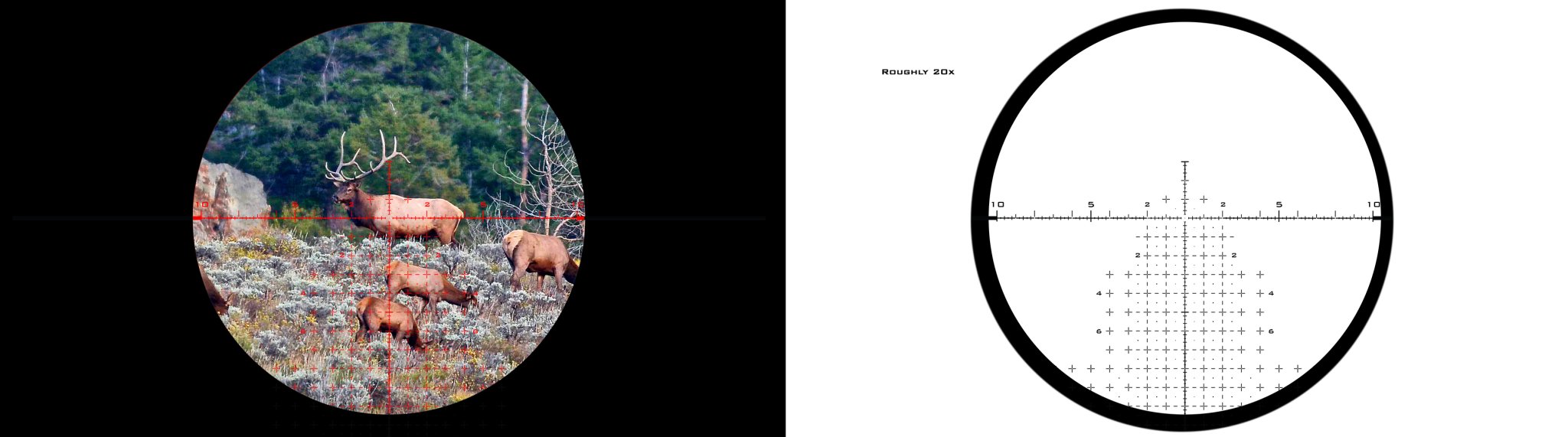

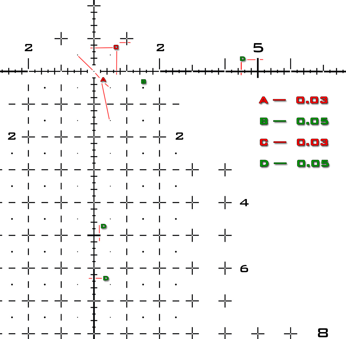

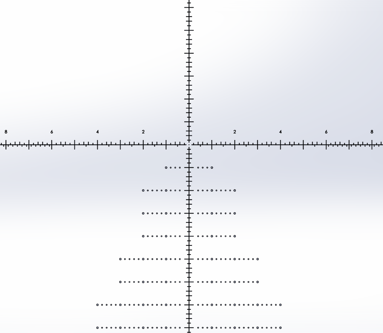

I designed a .03 center dot...I believe it's perfect for a 35x optic and I kept a .03 grid with the cross hair getting thicker to .05 the further out from the center point you go, so you get a little more weight when you're zoomed out. Could easily bump that to .06
I left the mil intersections open, similar to the Leupold CCH
Everything is done in a base 2 format. All the hashes are .1, .2, .4 and .5 instead of the (.115 etc)
I showed it fully illuminated for simplicity, but you could do just the main stadia, or a combination of hold dots and part of the grid)
FOR ME, on a 35x optic...this is what I'd be looking for.
Obviously all this needs adjusted if you're doing a 25x or an 18x

I think we have a solid 25x to 35x I would look at the 18x and the cross over options, less defined in the wild
For a good crossover, something like the stripped down Mil XT from @mj23polaris above would be good, with an illuminated Donut of Death. It's hard for me to envision how small it would be on 3x, but something around 4mil in total diameter and around .5 - .75 mil thick is probably in the right ballpark. That should be visible even at lowest magnification and possibly even disappear (like the Vudu scopes) if fully zoomed in.

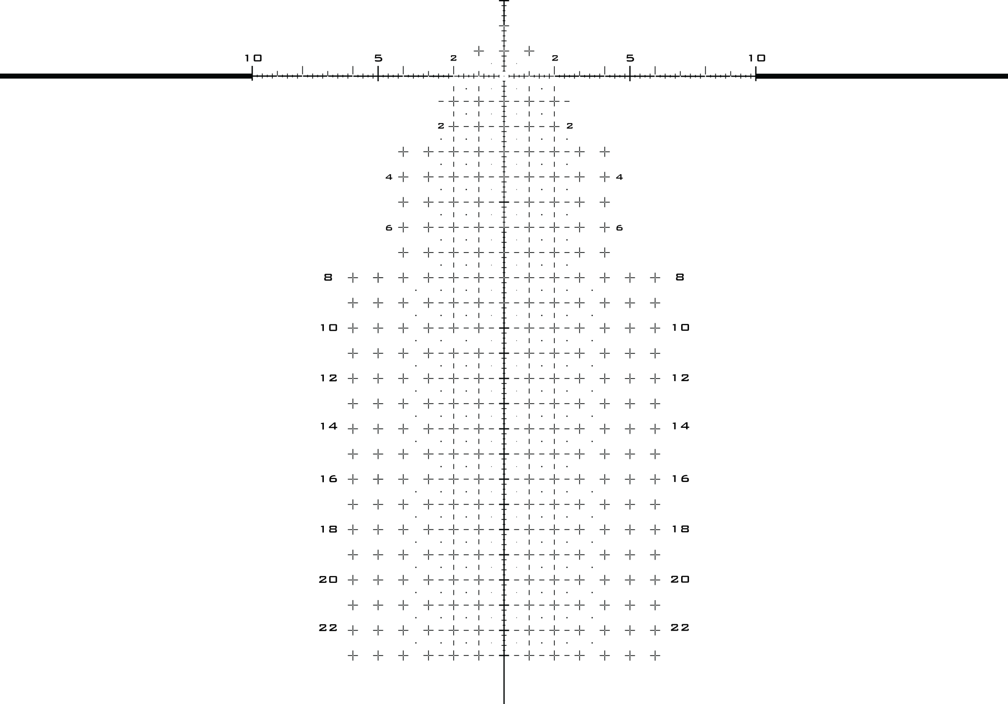

I think something along these lines would be great.
I’m also an advocate for shorter, locking turrets.
Reticles are so personal as many know, it seems hard to satisfy everyone.
I wonder if we have polling for tree vs non tree, center dot diameters for each model with different mag, reticle thickness, and reticle spacing is locked down before even really getting into the design.
I second the option for a floating +. It is easier for me to see and I actually feel that I am more precise with it. I enjoy shooting 100 yard smallbore matches. The NRA A-25 10-ring is 2" in diameter. A floating +, 2-moa wide and tall, is easier for me to center within the rings.
Floating + lovers are a minority here. But we still deserve love too.
Reactions: FuhQ

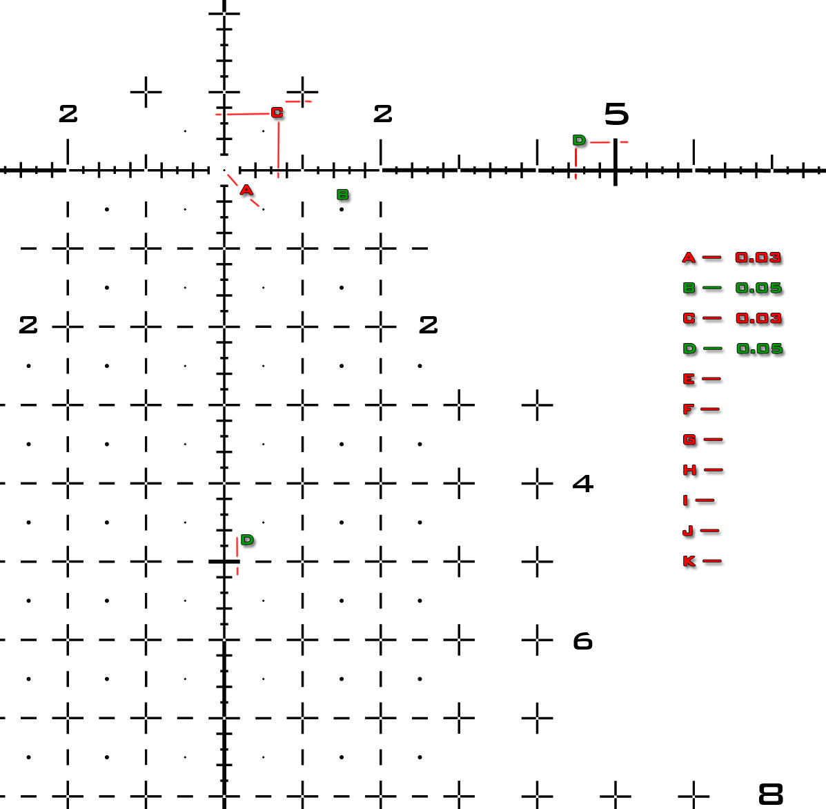

Here's my take. This reticle would be primarily for 15-25 power use, and probably wouldn't work for shit in a 3-18. It'd be damn close to my ideal for PRS. Can't think of anything else I'd want for ELR, tactical, or general long range but those aren't my strong suit.
I like the EBR-7D a lot, but my gripes are as follows:
- No differentiation between .2, .4, .6, & .8 on the vertical. It sucks ass.
- No differentiation of the same in the horizontal. Less shitty as there's at least a half mil mark in there
My favorite parts about it
- Dots in the tree make it significantly more see through
- .025 mil center dot. Super fine is great for punching paper
- .1 mil open per side is tits. I use a .1 hold all the time. I hate having to interpolate like that on tiny targets.
- .025 line thickness works great in the higher power range. Not so great at lower power but if the FOV is large enough, you get away with it.
Changes to EBR-7D:
- All .2 & .8 stadia are .075 mils tall on the horizontal, and .150 on the vertical
- All .4 & .6 stadia are .125 mils tall on the horizontal, and .250 on the vertical
- 1 mil worth on windage removed from either side of the 2 mil line in the tree. Could probably do without more, but it doesn't affect me much leaving it.
Additional notes:
I got lazy and didn't put the vertical numbers on or the .1 section past the 6 mil mark on the upper half of the vertical stadia.
I cannot see those floating dots without a struggle. But that's me. I'd like the dots you show at .2, , .4, .6 for wind on the tree as the center dot. Those I can see.

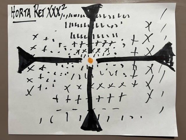

Maybe instead of hash marks we could use little skull outlines instead? :)
