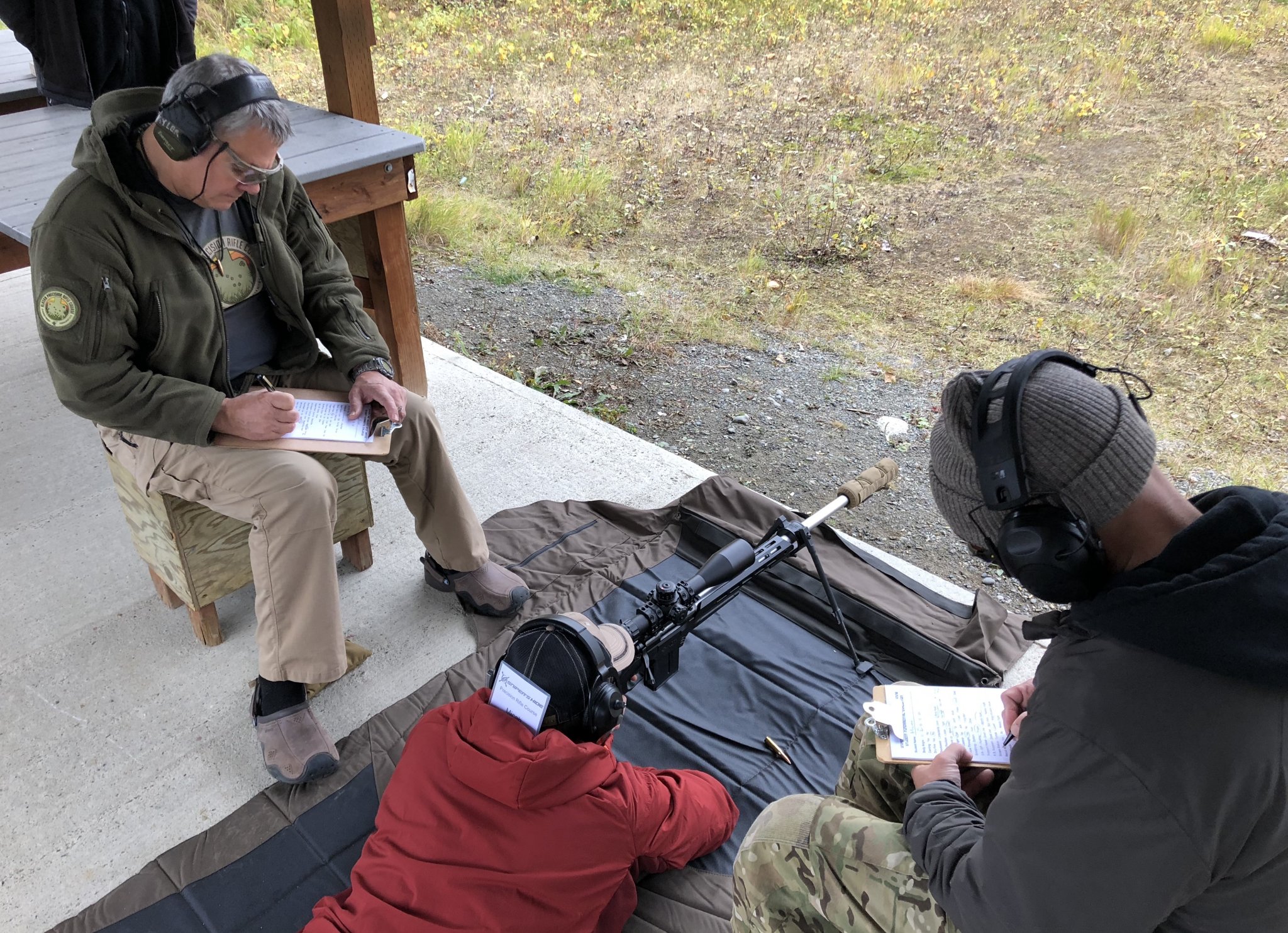

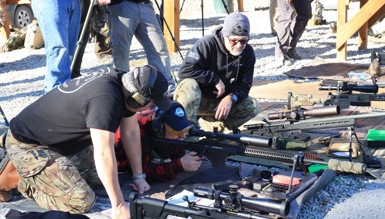

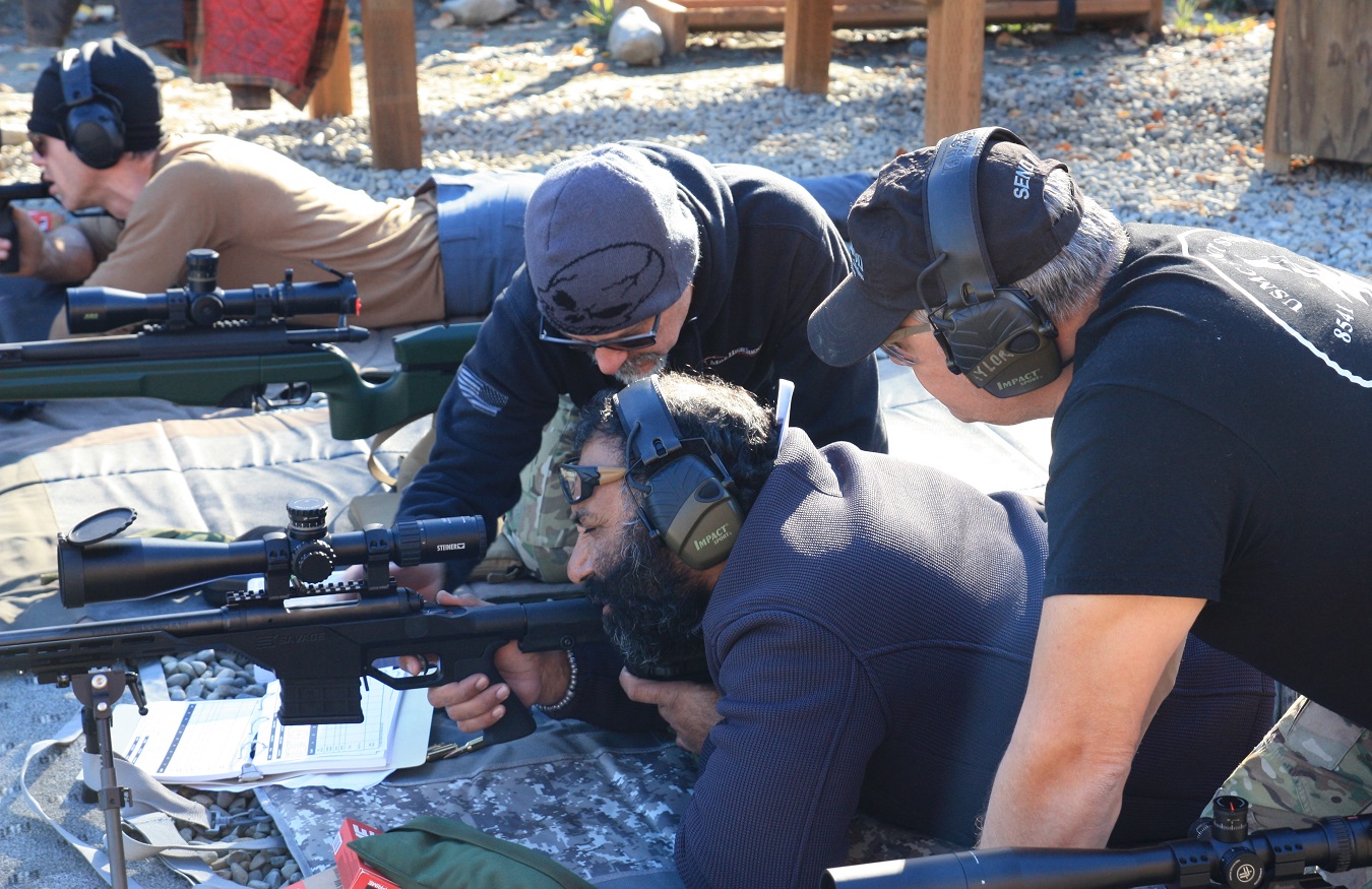

I love how the guys with no education want to dictate “cause it’s all the know” regurgitating the same shit over and over, meanwhile, not only do I take classes, even today, I teach, and in doing so I see things in vivid colors as well as understand how to correct the problems. I get paid to shoot, how about you.
We start classes before any instruction is given like this,
7057216
And end them like this,
7057217
7057220
