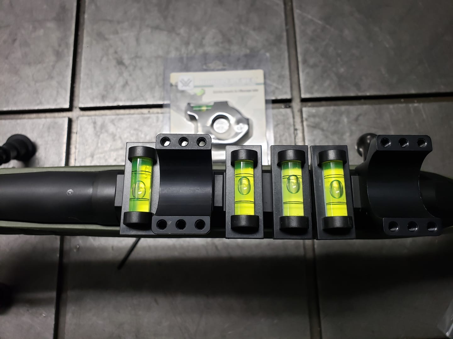

Your $6 levels in your $150 dollar wrapper,
Guy bought a level kit to mount his scope and was surprised by this.
Here are a few questions to ask, the how and why of a can’t, see if a level is the solution to why people can’t their rifles.
1. Improper rifle set up,
2. Improper body position
3. Heavy head, pushing on the stock
4. Loose bipod
5. Pulling it over with the bolt
6. Rolled over head position,
7. Sub par equipment
So I if explain the why and you fix those things, what good does a level do?
Most start off crooked behind the rifle, normally because their LOP is too long, it kicks you off to the side. Next their bipod is too low so they roll their head over. This pushes you even more forcing your your head to the right. When they start shooting the loose bipod makes it easy to start drifting right. The bolt manipulation magnifies this effect, so we see a gradual increase, more right.
Of all these are the most common factors, none of them are solved with a level.

I fully agree all these "consumer" levels are probably not really "level" or precise, and putting a precision level on a surface/rail/scope that isn't true to the bore defeats the purpose. At best they give someone a repeatable position that hopefully they take the time to level to the reticle/elevation adjustment travel. I also agree that ensuring everything on the rifle is "true" is a great idea, with likely tangible benefits, however unlike bedding, torquing bases/rings, lapping mounts, high end optics, ballistic computers etc. all of which can be done with commonly available tools and videos/instructions easily available to perform that work, correctly step by step, what you are suggesting is none of those things. If you want an entire rifle, rings/base, etc. trued to the thousandth of an inch that's not going to be cheap (I'm guessing harbor freight probably isn't going to get you that level of accuracy) and there's probably no resource/guide to walk someone through the process step by step correctly as it applies to truing a gun system from the ground up. Can you find a machinist/gunsmith somewhere and convince/pay them to take the time to train you do to the work, and buy all the tools, sure. Is it worth the expense, considering all the $ we throw at other stuff in shooting, possibly.
i grew up with a racing mechanic/electrician for a father, and work for a company that spends years and literally billions of taxpayer dollars to get one shot at putting something into space, so I can appreciate the right tool for the job, and that fact that if you want something precision done right, it's not easy, fast, or cheap. I'm more mechanically inclined than the average joe, and even I wouldn't attempt what you are suggesting, wouldn't even know where to start. I love learning that stuff, do all my own auto/dirt bike/mountain bike work, make my own compound bow strings, etc. So if I felt I could find a step by step resources/guide/video on how to do what you are proposing correctly and accurately as I have for those other things, I'd probably be the first to justify spending the $ on the tools just to tinker.
I don't think you are giving enough credit to the skill and knowledge to do such a job these days, and the rareness of the information to perform it. I work with a room full of 20-40 something engineers and not one of them can change a water pump or wheel bearing/hub. Neither of which are hard, but if you don't know where to start and can't find resources for how to correctly perform the work it's a daunting task.
And that too is the point most miss, it’s not about micron Precision, it’s about a subconscious comfort. The body will move what it does not like, so knowing “why” it happens works better than just seeing it from the outside.
