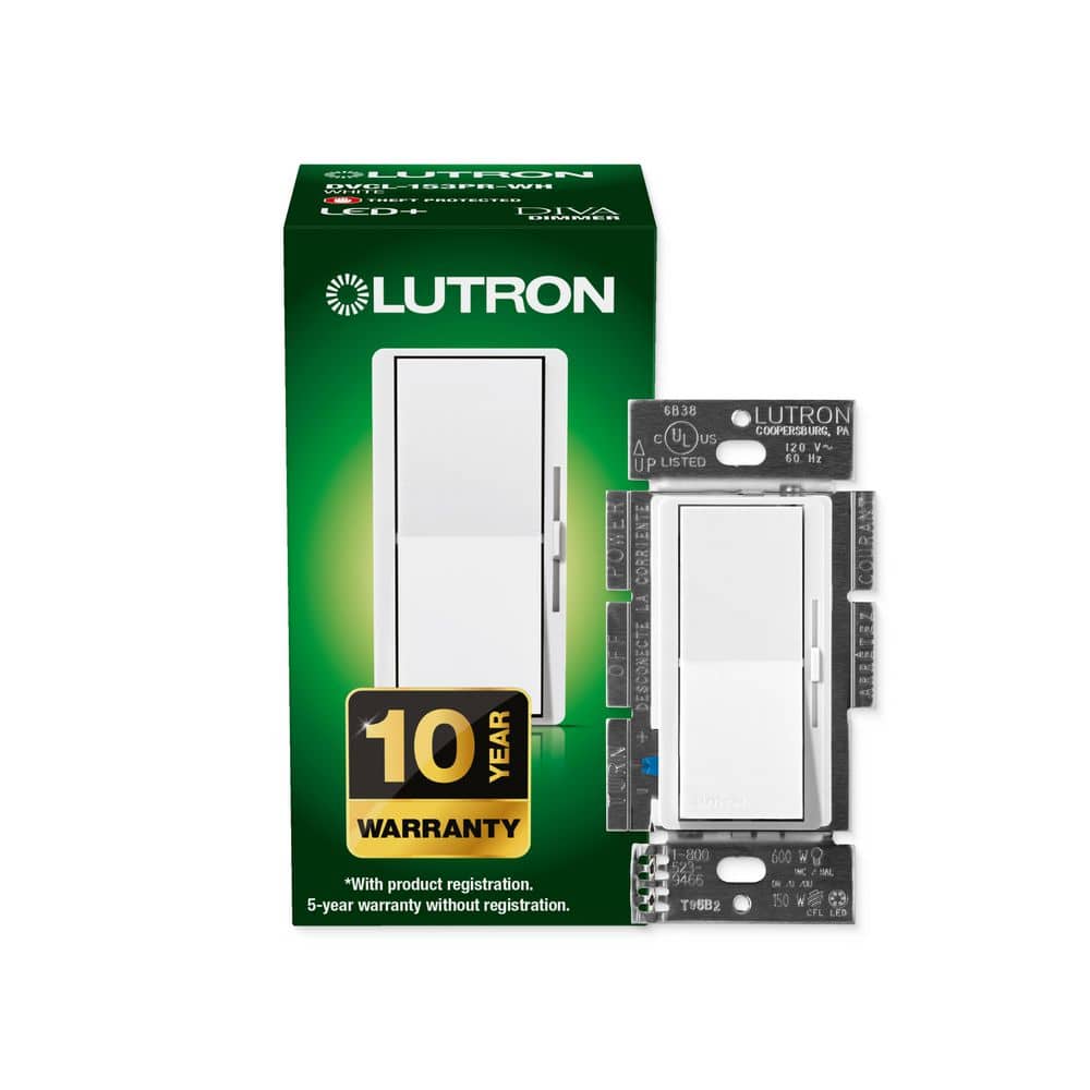

Pretty sure the actual LED light itself needs to be dimmer compatible. Not all are.
Note, this one says "for dimmable LEDs".
Yes it needs to be LED compatible. It also has to be 0-10v for my lights.
The question is about the wattage. Each light is 60 watts and there are four per switch for a total of 240 watts on each switch. That being said some places online said that the amount of watts is not relevant to an LED 0-10v dimmer.
Long story short there are a lot of 0-10v LED dimmers, but most of them are only up to 150watts. If a 150watt rated dimmer will work then I can just get some of those no problem.
The switch you linked is not a 0-10v. It also says it is good for 150watts of LED.

Those are the dual use ones. They still operate as a switch and do 0-10.
The one I linked above is a dimmer only, not a switch.
If you want to have dimming in the switch itself then you'll need to find one that does both and can handle the wattage.

Again, that dimmer I linked will dim the lights. It just isn't a switch. You could install it in a box next to the light switches.
