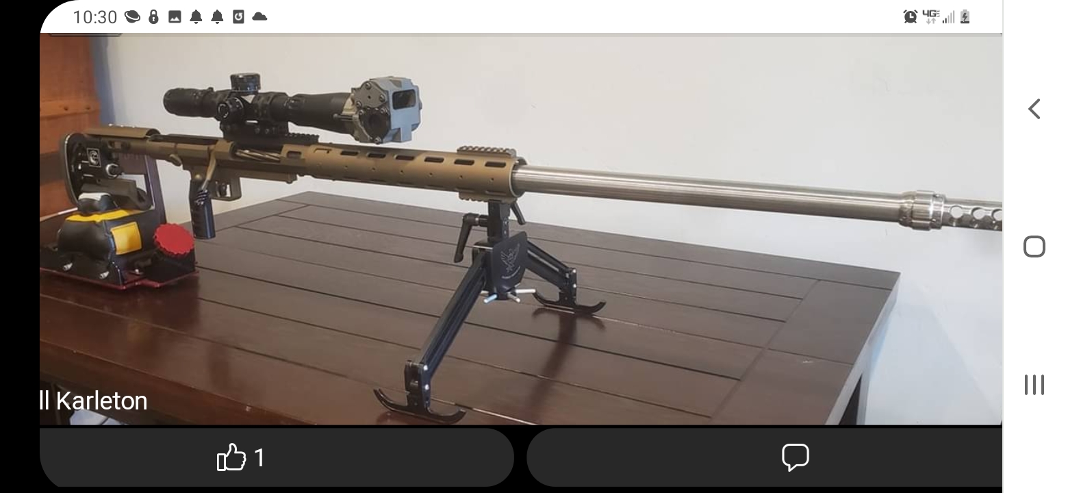

A few months ago one of the well known elr guys using one of my tuner brakes asked if i could solve a problem of the plex in his scope vibrating after each shot . I told him no. He was using a tall moa base and tall rings to see over his long barrel and was using a bipod extension. I told him the issues he was his chassis scope height and bi pod set up he wanted to argue with me. I told him it was a common issue with his set up and if he wanted proof to remove bipod extension and test it. He did and came back with a reply a few ways later and said half of it was gone i said great now get a better caliber that shoots flatter. drop your scope down and get a better stock that absorbs shock. And install hydrolics in recoil pad . If you look at the stock that was used by keith trapp that john pierce designed its lamanated basal wood wrapped with carbon fiber low center of gravity design with hydrolics. The rolex of platforms.
