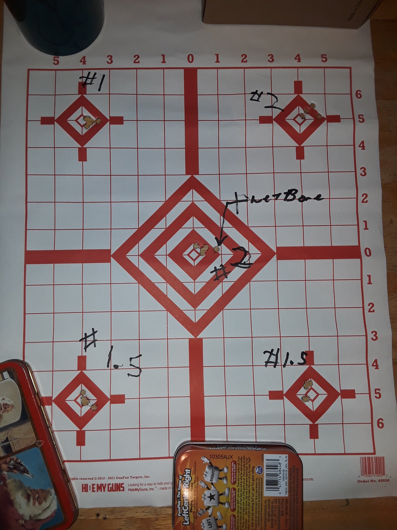

My last shoot with the EC tuner brake proved out what a couple of people here have said.
Harmonics "induced" changed and effected by the stock / chassis used. I belive @timintx And @badassgunworks both discussed this and simply changing from a moe to a prs lite changed the harmonics as they said it would.
Changed my tune and opened groups and I started re-tuneing the EC but stopped as soon as I got it shooting decent.
I had forgotten my tool kit and need to make buttpad adjustments to cant and height. May as well get that done before final tune.
Just another good reason to own one.
Reactions: timintx and kthomas

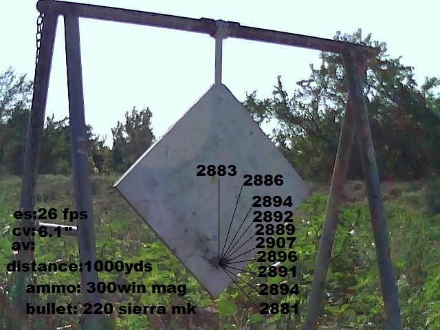

Next time you do a tuner test, try shooting the 2 shots, record the rough position & group size then fire another 8 on the same target with that same setting. See how much the 2 shots mean after that.
Barrelstroker you seem to be backing out on some of your statements , so for the benefit of the shooters I will show this. This picture is the sole property of Sellars Ballistic Technologies. First adjust the tuner at 100yds using the two shot test using two 73 grains of powder and 74 grains of powder. Once adjusted I went straight to 1000 yds fired ten shots with one powder charge of 74 grains at the plate with witnesses and cameras. This was the first actual group and the beginning of the statistics. Around .2 MOA to start.

Barelstroker you seem to be backing out on some of your statements , so for the benefit of the shooters I will show this. This picture is the sole property of Sellars Ballistic Technologies. First adjust the tuner at 100yds using the two shot test using two 73 grains of powder and 74 grains of powder. Once adjusted I went straight to 1000 yds fired ten shots with one powder charge of 74 grains at the plate with witnesses and cameras. This was the first actual group and the beginning of the statistics. Around .2 MOA to start.
Tim in Tx

I recently acquired a barrel tuner to test it’s effects on factory .223 ammunition.
I never realised how barrel tuners could be such a controversial / overthought topic .
I’m just going to happily and enthusiastically do my testing and not tell anyone my results .
Tim in Tx
That’s very good shooting.
Serious question, what are you showing here?
A 26fps extreme spread is sub .3 moa. So the ammo is performing as it should be without needing to be tuned.

My shooting went downhill but still show groups changing with the EC tuner brake in 1/2 settings as marked.
I pulled a shot in two groups and generally was having a bad time with ra so called it an early day.
As predicted by some earlier in the thread changes to a stock moved poi and changed the tuner setting.
Since I need to adjust the stock further I stopped till another better day.
These are 50 yard dungen test shots.
If the two loads hit at least level at 100yds then it will shoot good and is in tune. That is the message , this providing all else is good with rifle. By doing so you are putting a mechanism in place to compensate for errant velocities. And you know soon at 300 rds your .012 jump to the lands just went to .050 if you shoot it hot with them 20-30 shot groups so just because of excessive heating alone there will be some errant velocities with throat erosion even more is possible I can assure you. If they are level velocity wise it will shoot good , but how will your barrel handle a errant velocity? It will not handle a errant velocity very well beyond 1000yds of if you are using a rifle that is designed to be rigid such as a military rifle then you will most likely not see the stuff we as target shooters with standard stocked rifles that are flexible and light weight. Now stiff is good but my guns are designed to be flexible , for positive compensation I am promoting bending . The reality is most guns will not shoot inside of the calculated vertical much less at calculated vertical with the majority of that being due to velocity variance. The two shot test simply helps you get there with less shots and enables you to check it periodically during competition for absolute no doubt it is in tune. I have tried rigid at 1000 yds shot great but if the velocity was errant i suffered in my group with vertical stringing , grabbed the light gun with positive compensation and shot consistent and shot some of the smallest groups I had ever shot in competition.
Tim in Tx
