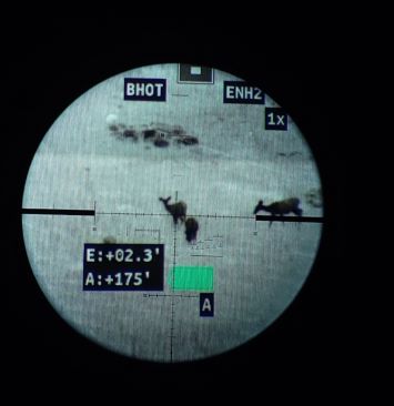

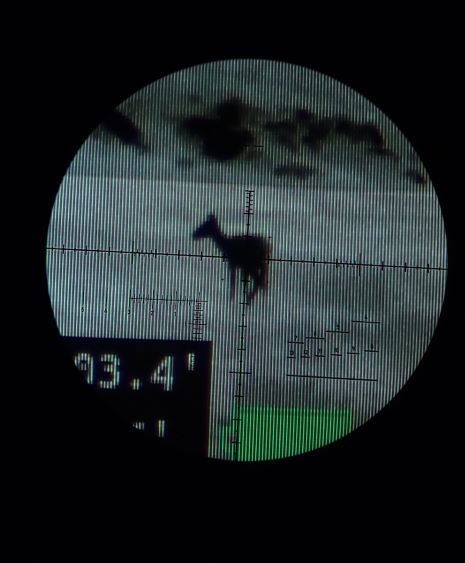

Had a chance to get some cell phone pics through the Xelr with a 2.9-20 steiner M7xi. My phone doesn't play well with the displays in these units. It always gets this diagonal noise/feedback. It may look like pixelation here but its not since it is not running vertical or horizontal. Only in the 20x image it is pixelated and, as I mentioned before, it pixelates on the vertical as you can see in 20x pic.
I'm sure there is a camera setting that can be more agreeable to the device but I haven't found it yet..... But these are a good reference. The deer in these pics were all at around 400 yds +- 50.
10x deer were moving in this shot so got a little blurry because of aperture setting on phone camera
12x
20x

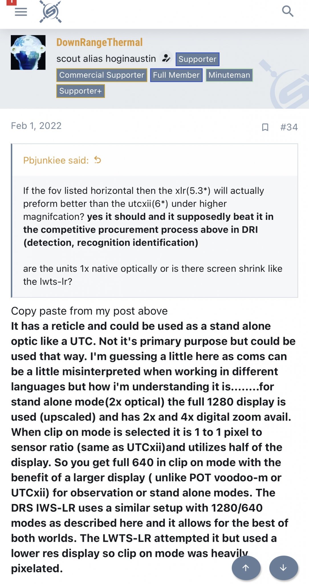

It has a reticle and could be used as a stand alone optic like a UTC. Not it's primary purpose but could be used that way. I'm guessing a little here as coms can be a little misinterpreted when working in different languages but how i'm understanding it is........for stand alone mode(2x optical) the full 1280 display is used (upscaled) and has 2x and 4x digital zoom avail. When clip on mode is selected it is 1 to 1 pixel to sensor ratio (same as UTCxii)and utilizes half of the display. So you get full 640 in clip on mode with the benefit of a larger display ( unlike POT voodoo-m or UTCxii) for observation or stand alone modes. The DRS IWS-LR uses a similar setup with 1280/640 modes as described here and it allows for the best of both worlds. The LWTS-LR attempted it but used a lower res display so clip on mode was heavily pixelated.
I’m trying to understand the mechanics of this.
Obviously this thing looks like a killer of a long range clip on.
So, in dedicated sight mode, it is a 2x base mag with a full screen (and I’m sure a gorgeous image given the low magnification and large lens).
In clip on mode it takes the same information and shows it in half the screen with a display of half the pixels for an image shown at net unity (appears further away). Apart from less pixles for the image, is anything else lost here? E.g. Is only half of the data from the sensor being used?
Why don’t more optics (Voodoo S for example) digitally demagogy so they can handle more scope magnification? It seems like they could process the image to make up for the 1x native magnification. Maybe you would have similar pixilation at 10x demagnified (less FOV) as you usually would at 5x at unity? What am I missing here because this seems like a no brainer…
For pure image/day scope magnification, you might be able to do that, but you’d lose the aspect of clip on capability where holds/dialing etc. work. If you take a 4x image and demagnify by 4, then your scope sees a 1X image and you can hold/dial longer shots.
If you start at 1X and demagnify by 4, your holds will be way off. Am I missing what you’re trying to accomplish?

Sorry, I thought I had updated the info. There is no large format stand alone mode on the xelr. It is purely a dedicated clip on with demag on back end like the utc. That info was misinterpreted from the comms with the Greeks prior to me having the demo unit in hand.
That is awesome to hear. I take back what I said about the design!
Isn’t that exactly what was explained on page 1?
Yes, Except he recently clarified that his information wasn’t accurate/complete when he said that.
Sorry, I thought I had updated the info. There is no large format stand alone mode on the xelr. It is purely a dedicated clip on with demag on back end like the utc. That info was misinterpreted from the comms with the Greeks prior to me having the demo unit in hand.”
So the question still remains, which screen resolution is on the back end of the eXLR. This hasn’t been answered yet to my knowledge.
I personally don’t care because the images we’ve all seen aren’t going to magically get better or worse based on the answer (we already know what the image looks like, so who cares how they got that image), but I understand that some want to know for curiosity/academic reasons.
Maybe you missed it in your rush to be snippy, but DRT clarified on this page of the thread that he was wrong, there is no stand-alone mode on the xELR. So that makes me wonder about the veracity of the very statement you just quoted.
Gotcha - a bit frustrating that specs/quotes aren’t corrected if the information was wrong. Was just over on pg1 looking for some pics and the full specs to pass along to someone and didn’t see the later correction. Mea culpa.
