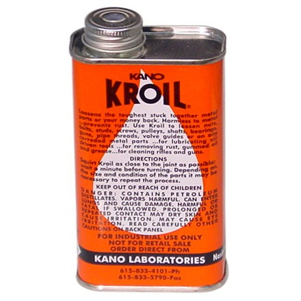

Yeah, problem is the bolts being counter sunk no penetrant reaches the threads. I’ve soaked them overnight with pb and threads are still dry the next day. Even heated the fasteners with mapp gas, no dice.

Ah, yes. "Kroil- the oil that creeps". I've had a can for 15 years and it's still over half-full. I also use a drop on my adjustable sights every time I clean my guns.
