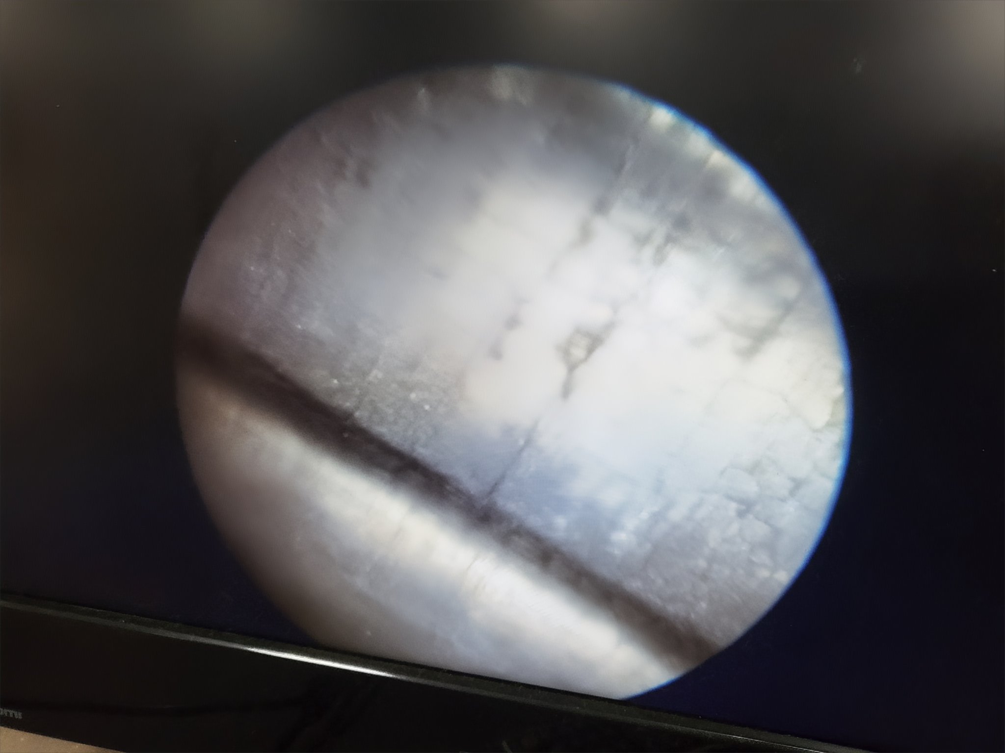

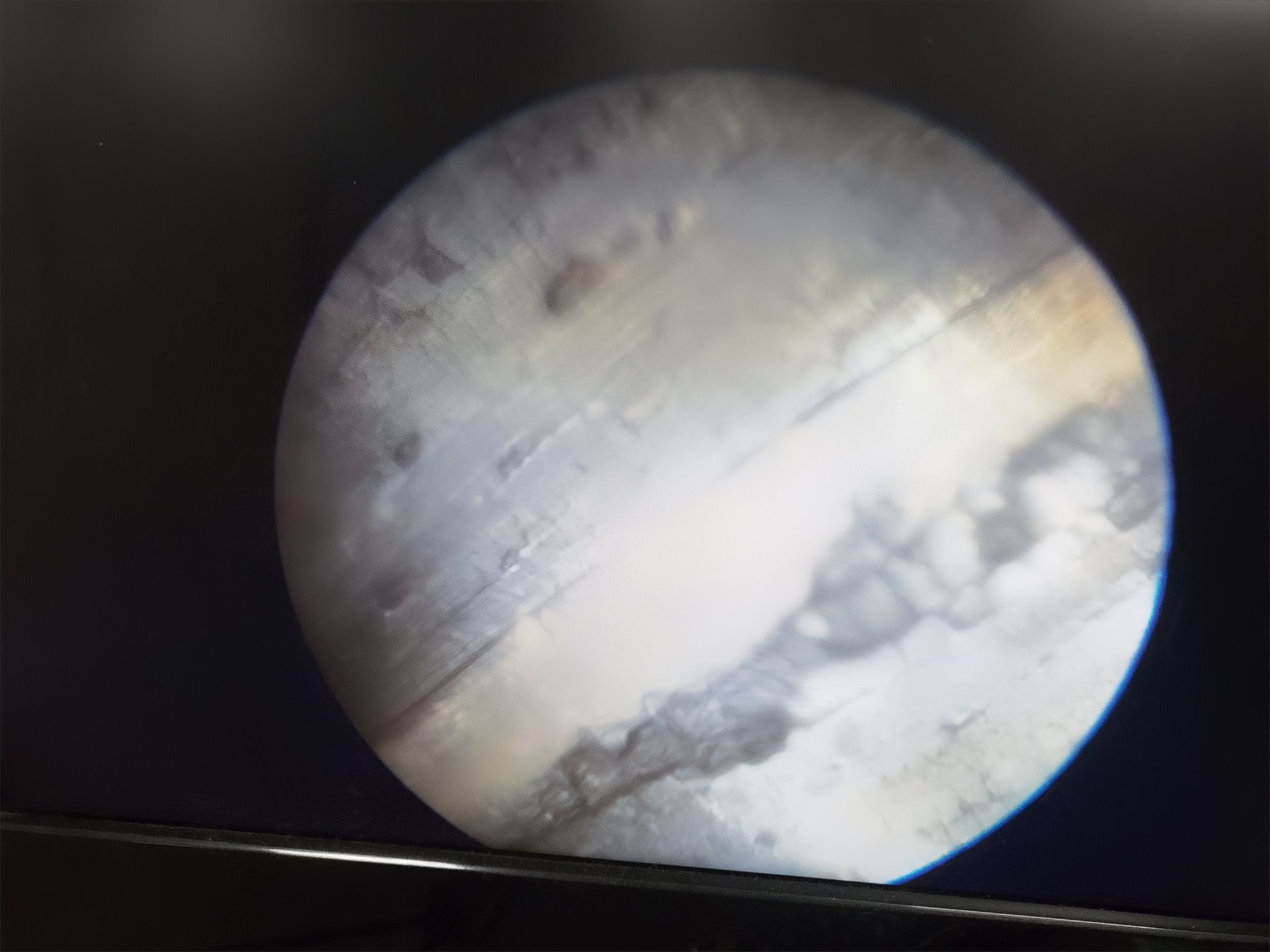

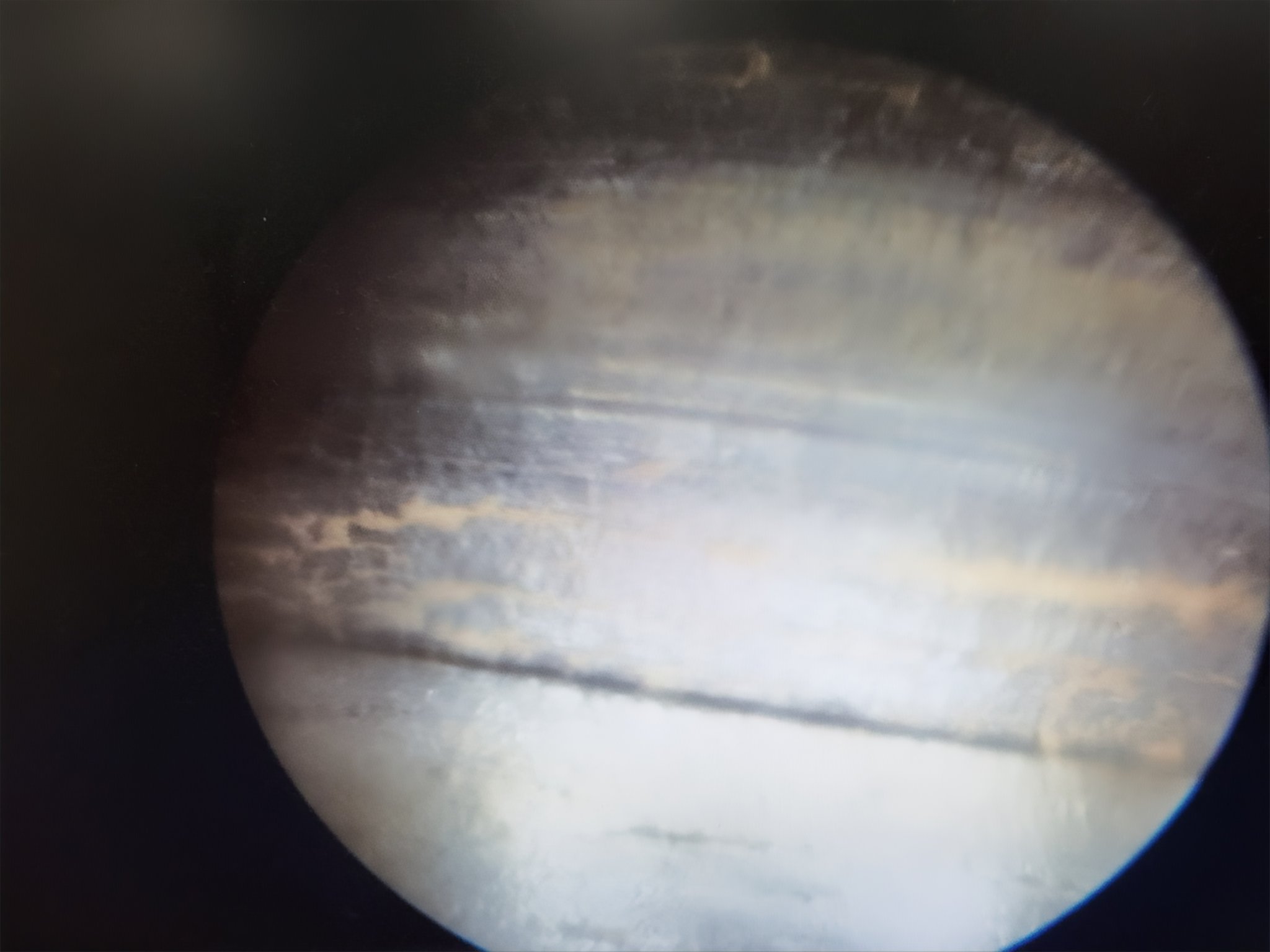

Question....where in the test barrel was that last pic taken? No fire cracking, no carbon, no copper wash (well, maybe a tiny bit). That sucker is clean.
May I assume that this is well down the barrel toward the muzzle?
Here are some other pics of the barrel with 14k rounds on it. Again it has not been cleaned. This is as I received it.
First picture is at the case mouth junction. Sorry the pic's are a little blurry....
Next picture is just past the throat area of the chamber....
Last picture is 3.5" up from the breech face.
As you go towards the muzzle like normal it gets better looking.
Later, Frank

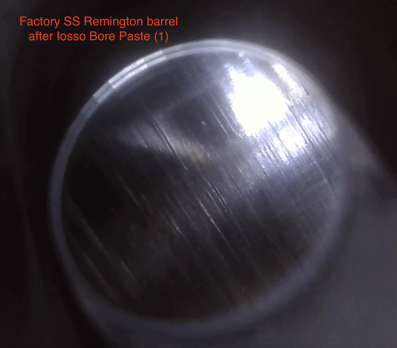

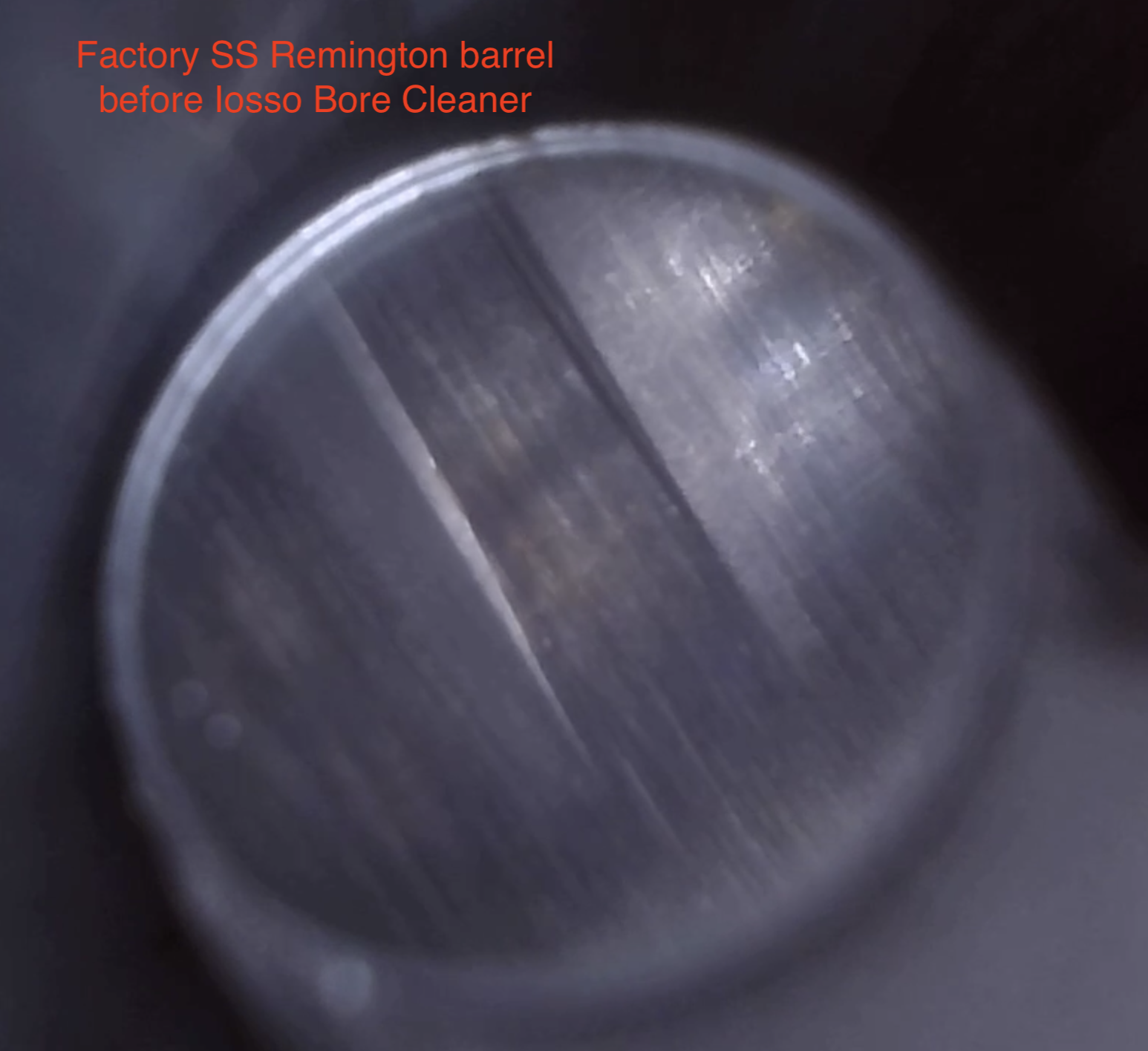

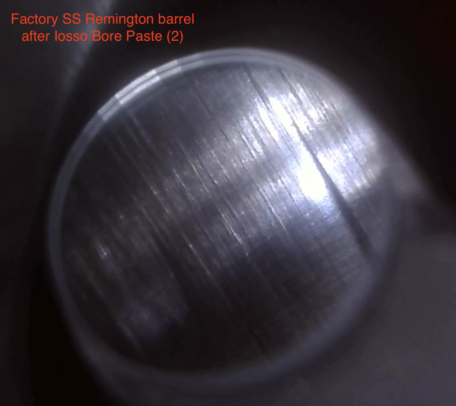

I'm pulling a factory 24” stainless 700 5R .308 barrel that wasn’t quite shot out for something much heavier. I actually wanted to try an abrasive after recently watching @Frank Green on Cortina’s podcast, then I saw this thread & thought “what the hell, why not.” So I bought some Iosso Bore Cleaner & went to town.
I wrapped an Outter's sythetic patch the full length of a .30cal nylon brush, so that the brush could not contact the bore directly. I soaked the patch in Slip 2000 Carbon Killer, applied a reasonable amount of Iosso Bore Cleaner, then ran it through the barrel 20 times. I did not allow the patch/brush to exit the barrel, I did not use a bore guide, & I did not let the solvents sit in the barrel for longer than 15 minutes.
1) I expected there to be more damage throughout the barrel & did not expect so much damage to be concentrated in the throat. There is much less damage after 2” & it is mostly lighter scoring on/to the lands. Not using a bore guide could have exacerbated the throat damage, but I don’t think that’s enough to fully explain it. I wonder if the steel nearer to the chamber has become slightly more brittle or fragile over 1,500 rounds of use & was more easily scored?
2) I didn’t expect the corrosion to be so defined or concentrated. It's possible the 2 cleaning agents reacted with one another, worsening the effects. I definitely didn’t expect the location @ 5” from the breech.
3) Prior to this, the only solvents used on this barrel are Hoppe’s No. 9, Shooter’s Choice MC #7 & Shooter’s Choice Copper Remover.
4) This is the first time I’ve ever used an abrasive cleaner. Unless I’m doing a similar test or demonstration for a friend, this is the last barrel I’ll ever use an abrasive cleaner on.
Clip of the throat damage
Clip of some new corrosion 5" from breech
Unfortunately, the pre-Iosso photo is the best one I have, which was taken 3 months ago without cleaning & ~500 rounds prior to the Iosso. If I have time, I might shoot some groups before the barrel swap & then use Iosso again with an unprotected copper brush to see how much worse I can make it. What’s the over/under on 1.5 MOA groups?

Cheap bore scopes are one of the worst things to ever happen to this discipline. Now people sit around and dont have to shoot to bitch and complain about looking at things they don't understand, that usually don't mean anything in relation to putting bullets on target.
If I compared what my chamber and bore looks like (just scoped an hour ago after cleaning for shits n gigles) it looks way worse than anything posted in here so far. Yet it shoots sub 3/8" and the random load I threw together for the match this weekend was about 6.5 SD/22 ES over a 20 shot group, with no tuning or anything. Just picked a random CBTO and loaded her up. But my borescope says I should be shooting 8 inch groups.
Upload a pic @DeathBeforeDismount
My barrel may still shoot great after this, I have no idea.
IMO, my barrel actually looked pretty great before the Iosso, but it is a .308 with only 1,500 rounds on it. 70-80% of that damage wasn’t there before this Iosso test. Although groups had opened up a slight bit, my decision to pull it is solely due to 1) how fast it heats up and 2) balance.
Depends which side of the equation you are on; consumer or barrel maker 😉. For sure, the worse looking barrels I have, a 42 year old 7 mag Ruger and a 1898 30-40 Krag, both shoot well within what I need them to. You wouldn’t know it by looking down the barrels with a Teslong though.
In numerous posts, @Frank Green has repeatedly stated that Rem 40X (very mild) and JB Bore Compound (blue label and somewhat mild) are the only two he recommends (to the best of my knowledge). And, he has stated over and over to not wrap your abrasive patch about a brush...pretty much of any kind. He has recommended a Parker Hale type jab with the patch wrapped around it.
But, perhaps you already knew all of this. I get experimenting with an old barrel...but, 308 and only 1,500 rounds isn't an old barrel to experiment on to me...but, its not my barrel. haha

Yep. At only 1,500 rounds, the barrel probably had another 2,000-3,000 on it. I decided to get rid of it a few months ago & new I'd never use it again. I also previously failed to mention this barrel has a stupid long throat, so I could only use SMKs. Nothing wrong with SMKs, but I'd like to use VLDs/Hybrids/ELDMs as well.
This wasn't supposed to be some scientific test, just the bored satisfying their curiosity. To be perfectly clear, I never doubted Frank's assertions re: abrasives.
