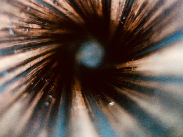

This is my 6ARC gas gun barrel with about 1000 rounds on it. It was cleaned after each range trip for the first 100 rounds then cleaned about every 200-300 rounds since then. It has numerous spots like this all between the gas port and muzzle, is it etching from cleaning, manufacturing defects, pitting from rust? The rifle shoots well so I was surprised to see this. What say the people?
View attachment 8206441View attachment 8206444
I have a CZ 527 in 6.5 Grendel that looks like that. It has never shot well from day one. It's never been treated badly or gotten wet.
The inside of the barrel reminds me of how a lot of Savage barrels look. The difference, is that Savages seem to shoot well regardless of the sewer pipe look.
I do have another 527 (among others) in 221 Fireball that got left in a soft case (for a month) after a rainy night of hog hunting.
It looks way worse than the 6.5, but it will still put out little tiny groups.

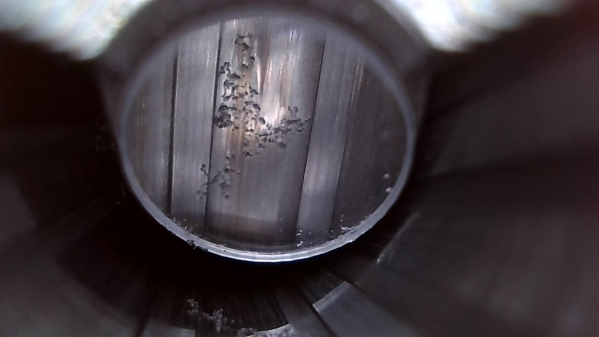

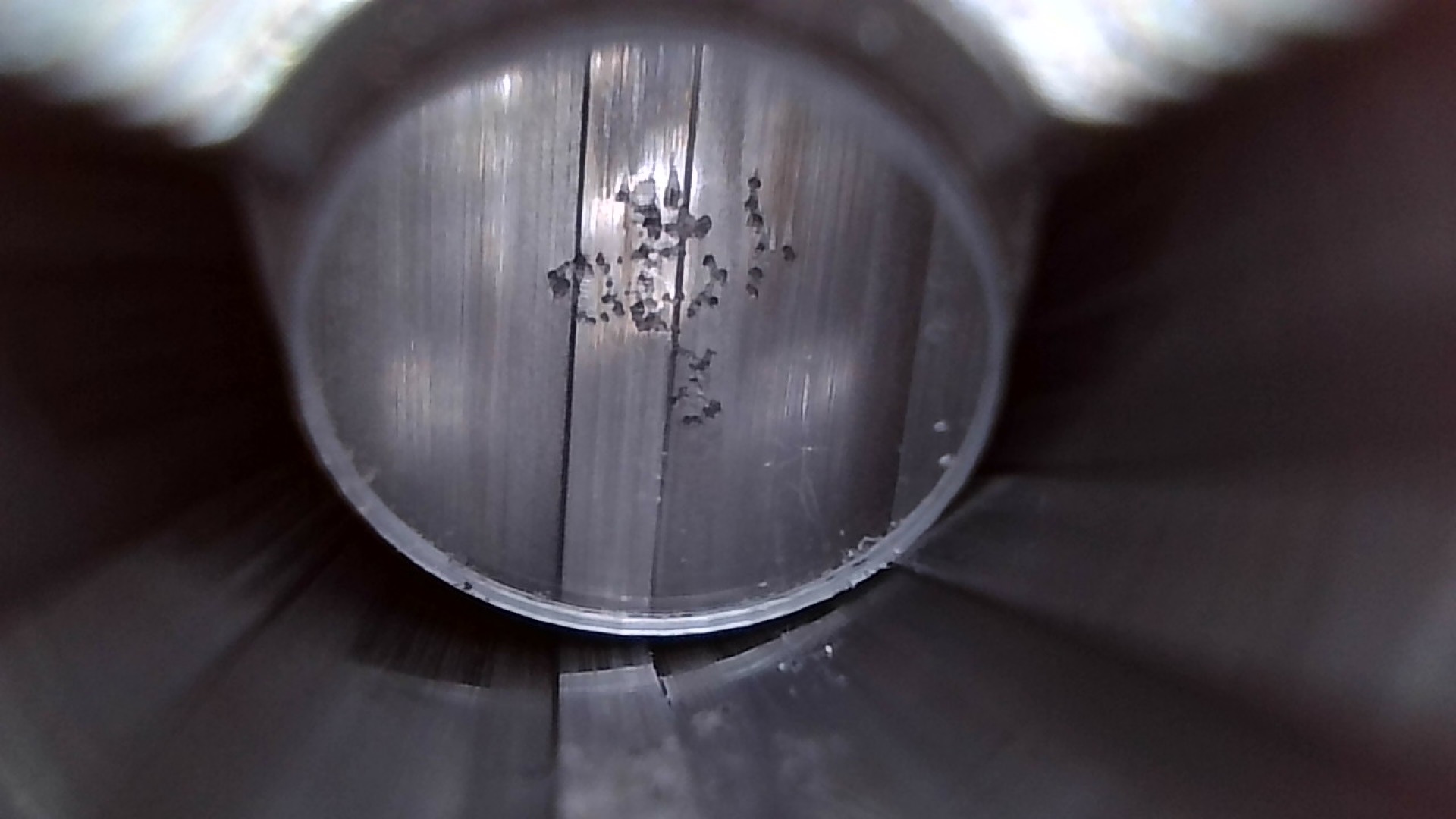

And no, he just put accelerator in there and left it for a while
I have only used the foam. Left it in an HTI barrel for 1 hour and patched it out and it worked fairly well to remove copper & carbon fouling.
If I remember correctly, the directions on the foam can mention leaving it overnight in some instances?

I use Patch Out....their product for applying with a patch vise foam. It calls for a 3 to 1 ratio of Patch Out to Accelerator....not just Accelerator.
I have left Patch Out/Accelerator in my barrel for overnight and perhaps even longer without a single problem at all. And yes, I have a bore scope and use it. Not a single issue.
Now, I can't prove that Gingerman's issue was just from Accelerator and not a problem with the steel of his barrel....but the later would surprise me.
Also surprising is the response he got from the owner.
Dunno...mostly I used Bore Tech products. Again, left in the barrel for extended periods of time without a single issue. But, as said above....I dry patch until every bit of solvent is out of the barrel. YMMV

You used the foam in conjunction with the accelerator and it caused that pitting correct?
I used the Accelerator with foam for over a year on all my barrels. One soaked patch of the accelerator and then a few hour sit with foam. Sometimes overnight. No problems.
Recently, when I did that same process to my CMV 308 rig, I got a lot of rust colored patches. It had been a while since I shot that particular rig, so I thought it collected rust. I read all the labels on the Accelerator bottle and between the bottle and website there are Then I decided to fill the bore with accelerator using the PVA muzzle Jimmy, and do some stuff around the shop. 45min later, I pulled the plug and red colored liquid poured out. Then I saw the pitting, eating, barnacles all throughout the bore. I saw a similar complaint from 2013: (Though not as severe and fast acting)

There was about 40 claims that accelerator won't harm barrel steels. The Wipeout owner said no matter what I did with accelerator, it won't harm barrel steel. That is absolute bullshit. What really sealed it was the owner claiming my barrel was fine after looking at the bore scope pictures. Then tells me to get a good attorney if I wanted anything more from him. That's just fucking great ain't it!
Yep, I'm with you, brother. No way it should have done that, no way they don't tell you its safe to leave in there, and no way that asshole should have responded to you in that manner.
Sorry about your barrel.
Doy you think it being CMV steel had anything to do with it? ....just curious.

To clarify the CMV barrel was 308 WIN
The ruined barrel is a 416R stainless
That was a serious dick move by the Wipe Out staff. And it was retarded as well, they had an opportunity to get a decent data point on product performance.
Sorry that shit happened to you. Does your barrel still shoot? Any effect on ES & Accuracy?
