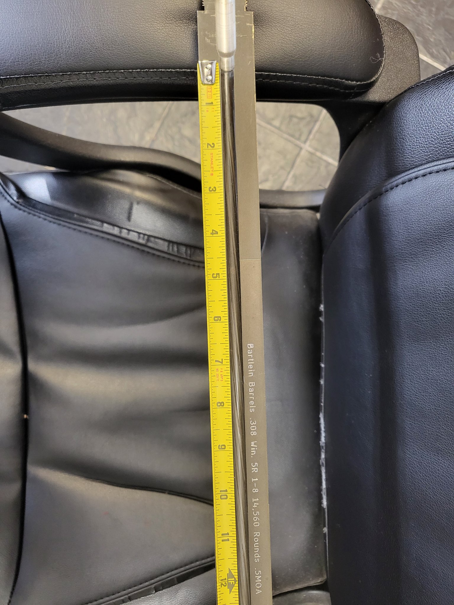

I don't necessarily agree. I can show you cut aways of barrels that where properly cleaned....and the powder fouling is baked/burnt in there.
Here is a accuracy test barrel I got back from Sierra. 308win. Quite shooting 1/2moa, 10 shot groups at 14,560 rounds. Look how black that first 1.5" of the barrel is in front of the chamber. That fouling is backed on.
They cleaned that barrel on average after every 50 rounds fired. Sometimes it did go 150 rounds in between cleanings. It's a 8 twist barrel. The first 5k rounds where all 175SMK and then the next 5k rounds was the 220gr bullet. Then it was a mix of those bullets after that if I recall correctly.

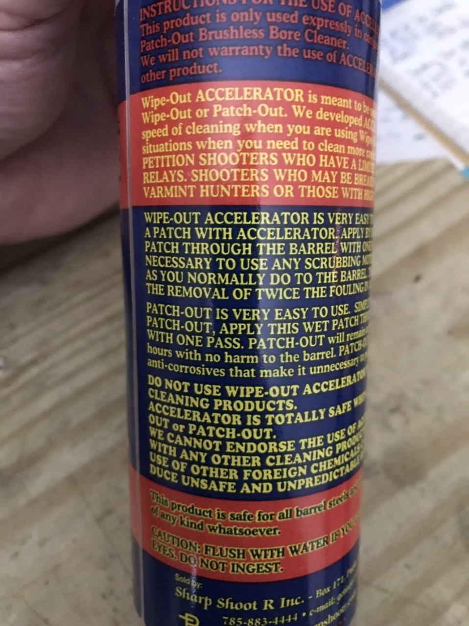

I know Wipe Out Accelerator has taken some abuse here so I finally took a look at the back of the bottle and it says to push a wet patch and then add the foam or Patch Out. That is how I have always used it without issue. Just figured people who never saw it might want to see the directions.

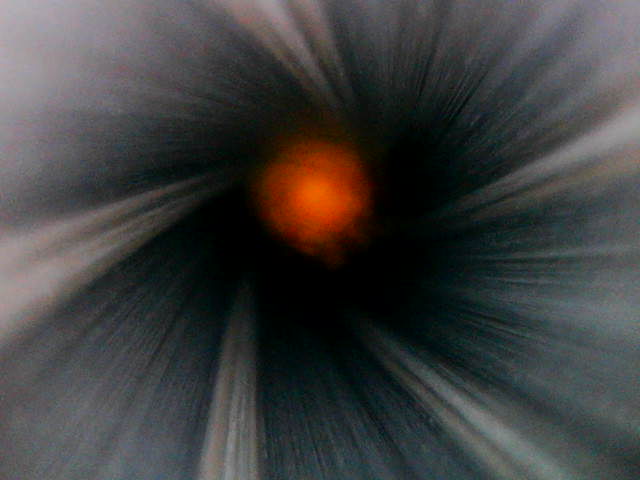

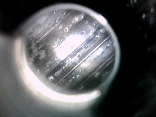

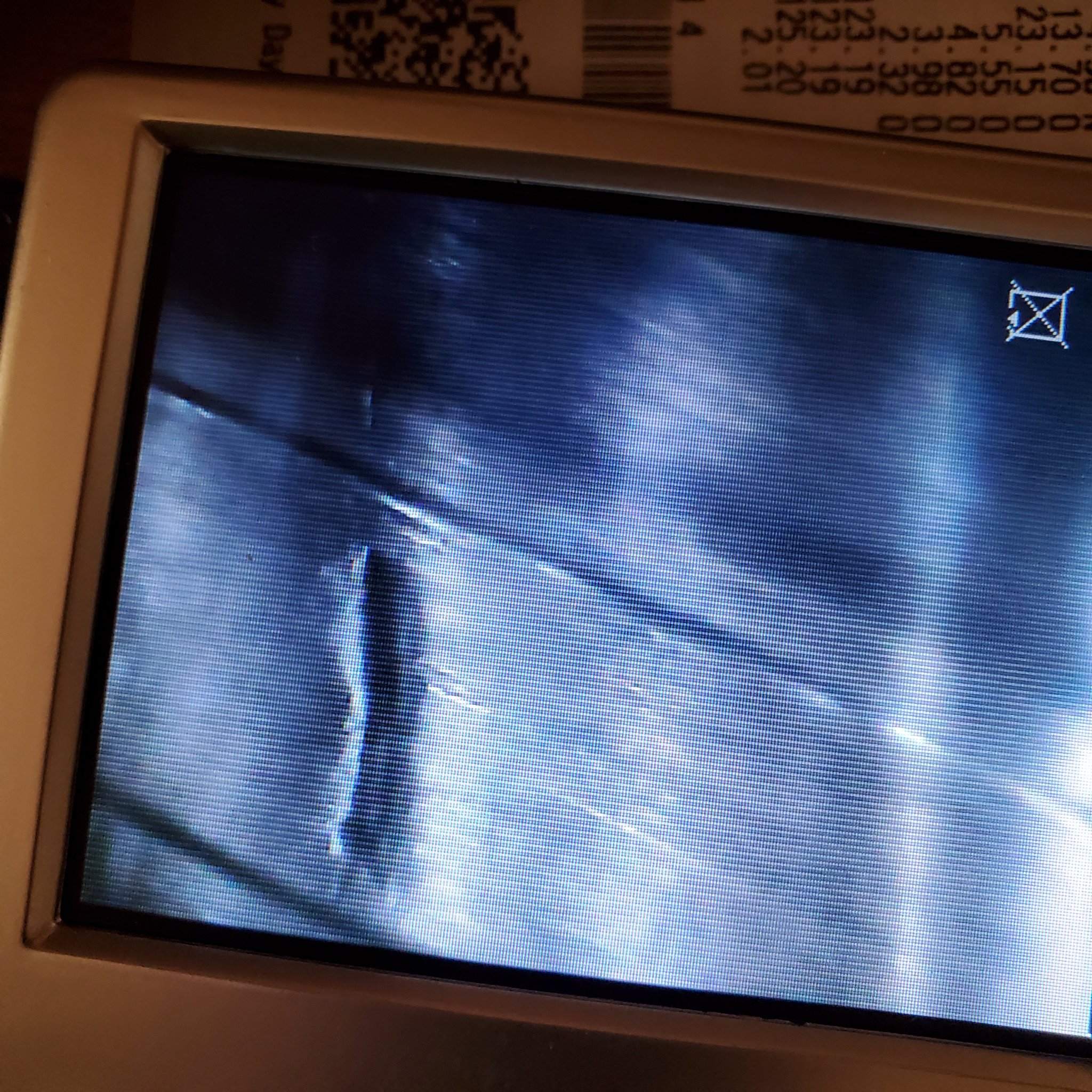

Brand new barrel, never fired... largest of many holes in the barrel steel. Getting an increasingly higher number of bad barrels from manufacturers, everyone is behind in production, hand lapping has less time spent, dull cutting tools, etc.
I use Iosso "sparingly" for years, no problem, but nowadays, let the scrubbing bubbles do all the work..I do not like to clean barrels, and quit "breaking them in". No problem getting barrel blanks to rechamber a rifle...all I want is quality rifled blank in good steel,...works for me.
I repurposed a factory 700 Police 26" 308 barrel for 30 RAR that had heavy firecracking from 8000 rds and still accurate. After profiling, chambering, barrel extension installed, etc..there was still a bit of decent firecracking for a short distance, but the rest looked great. And the repurposed barrel is an excellent AR shooter.
The above was kept and lapped as the rifling was better after the first third of the barrel.. and it shoots good for the intended purpose...with 2 loads, 300 gr Berger and 300 gr SMK. Cleaning is like politics, and everyone has different beliefs and procedures ...and does their own thing religiously, happy with the results right or wrong. The more barrels wore out with cleaning proceedures the more barrels sold. A "win-win" for the manufacturers of barrels and cleaning supplies...and the guy with a happy smile on his face, as he has the best barrel cleaning proceedures on the planet...

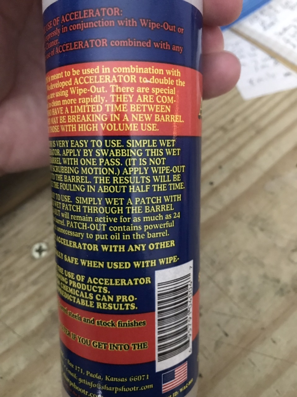

and that is just the bottle. Go to the website and there is one that says, "Won't leave harmful deposits". That's a fucking knee slapper right there Bubba!"
Reactions: AZLONGRIDER
Probably meant if used as instructed. It does say that it can react with other chemicals so could have been what happened when left in for 45 minutes versus a wet patch of it pushed through and then use of wipe out or patch out right after that.
Reactions: Ernest 5.56
Did you miss the part where the Wipeout owner said even the way I used it, it couldn't harm the barrel?
