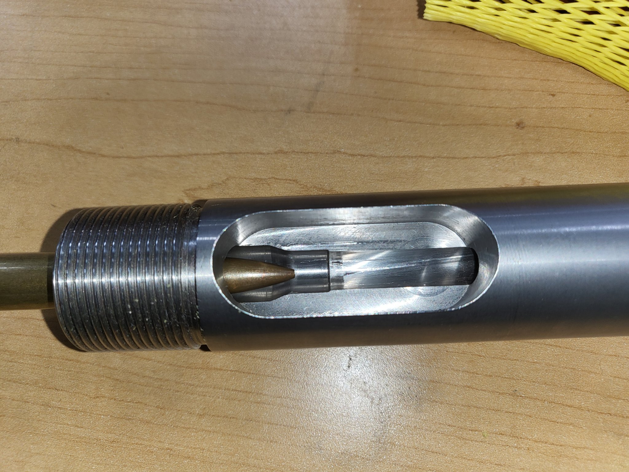

Don't know how else to say it. It's the burnt charcoal buddy!
Not a great picture but you can see the inside of a brand new barrel looks just like the outside. Nice and shiny and silver in color.
I took a hunk of scrap barrel and chambered it with a 308 Obermeyer reamer and made a dummy round so when I go an teach classes they can see what a new throat looks like and a worn out one. Think I have this piece kicking around now for about 10 years but it gets the point across.

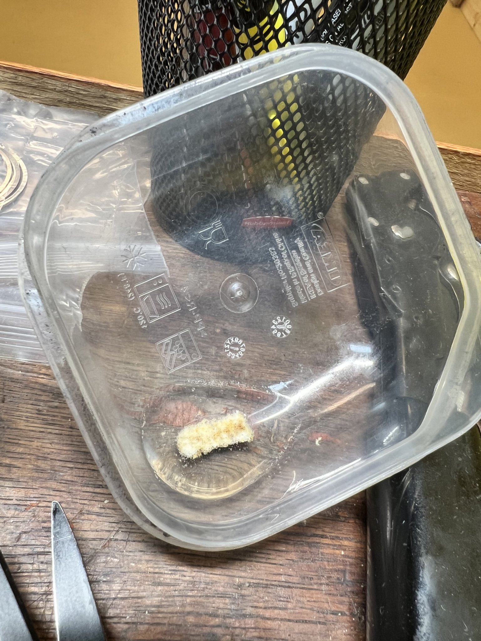

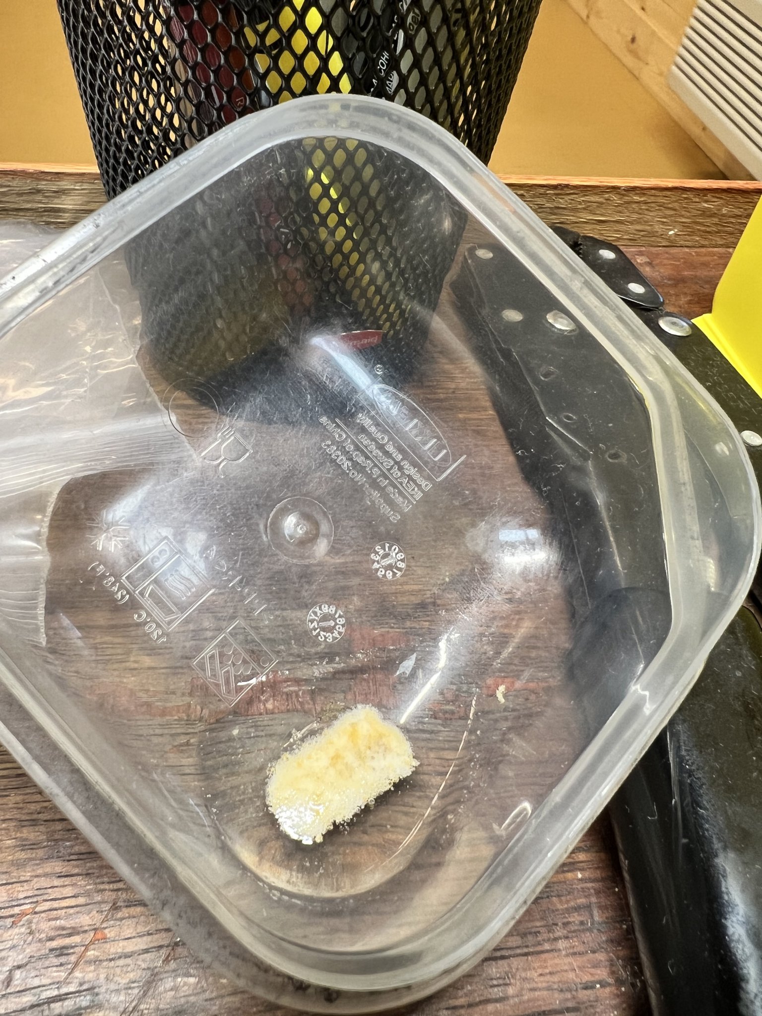

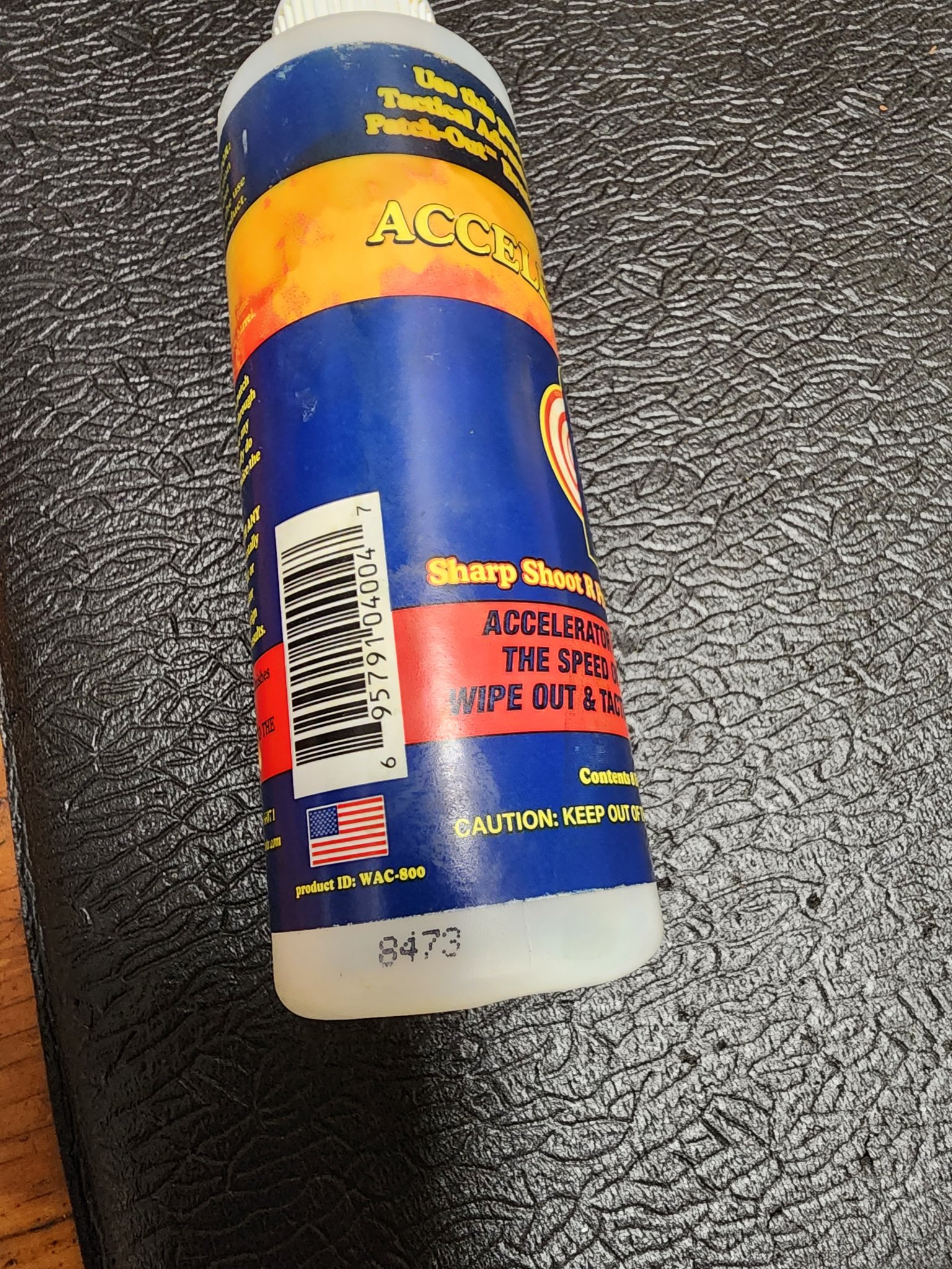

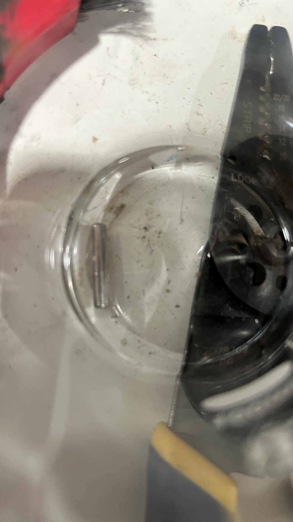

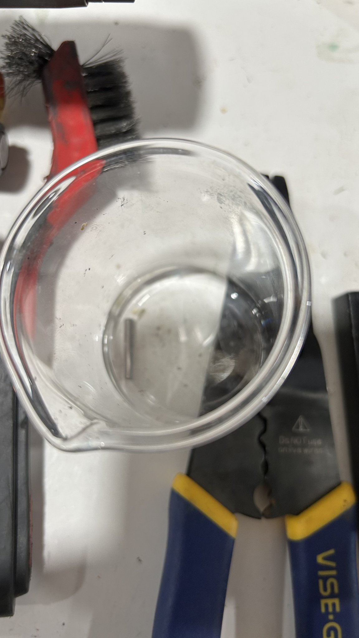

Here’s 6 minutes, same experiment. Cleaned the pin and beaker with denatured alcohol first and let it dry.
I wonder if your accelerator is a diffeeent product. Mine was bought off brownells about a year ago.

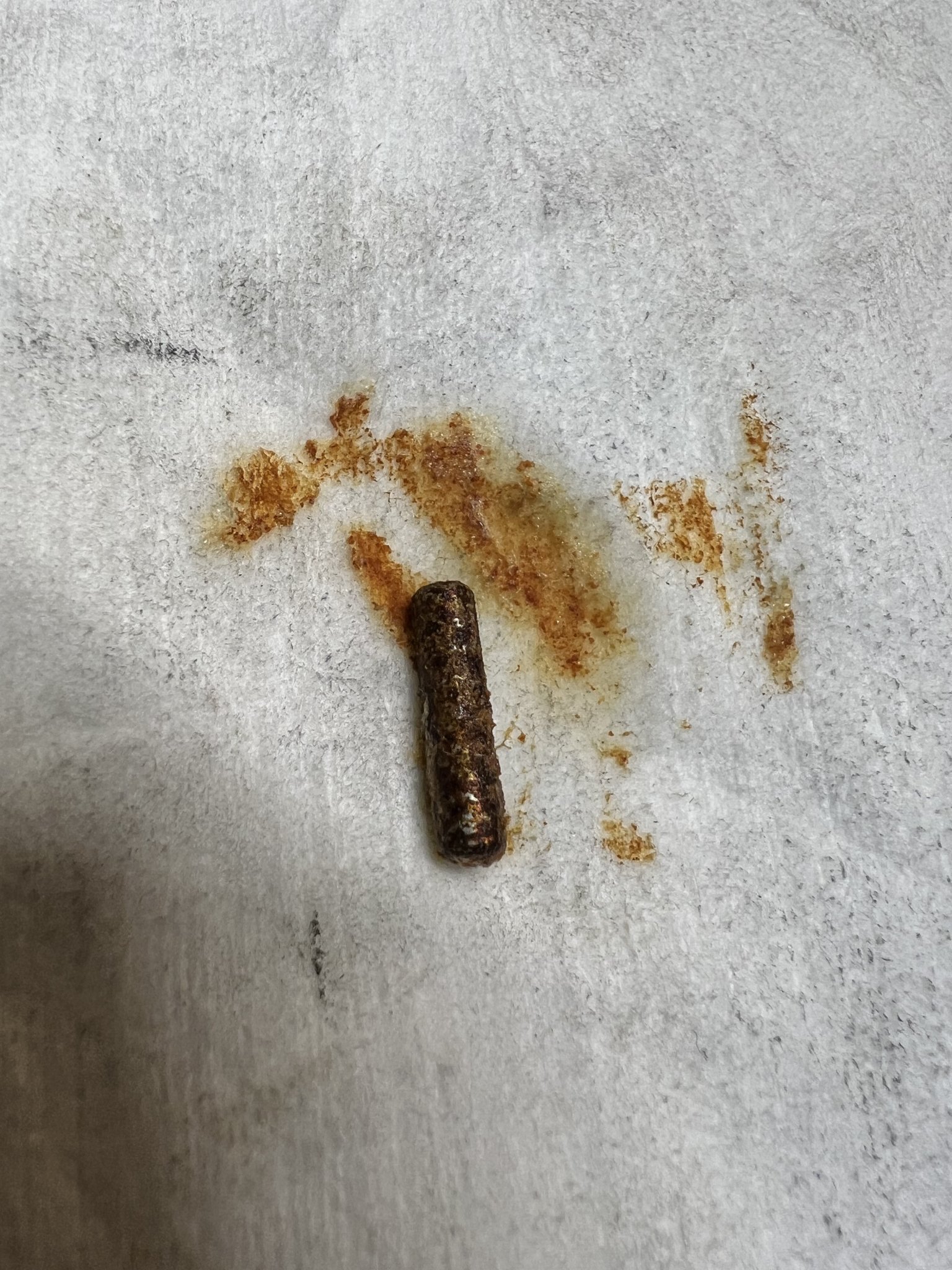

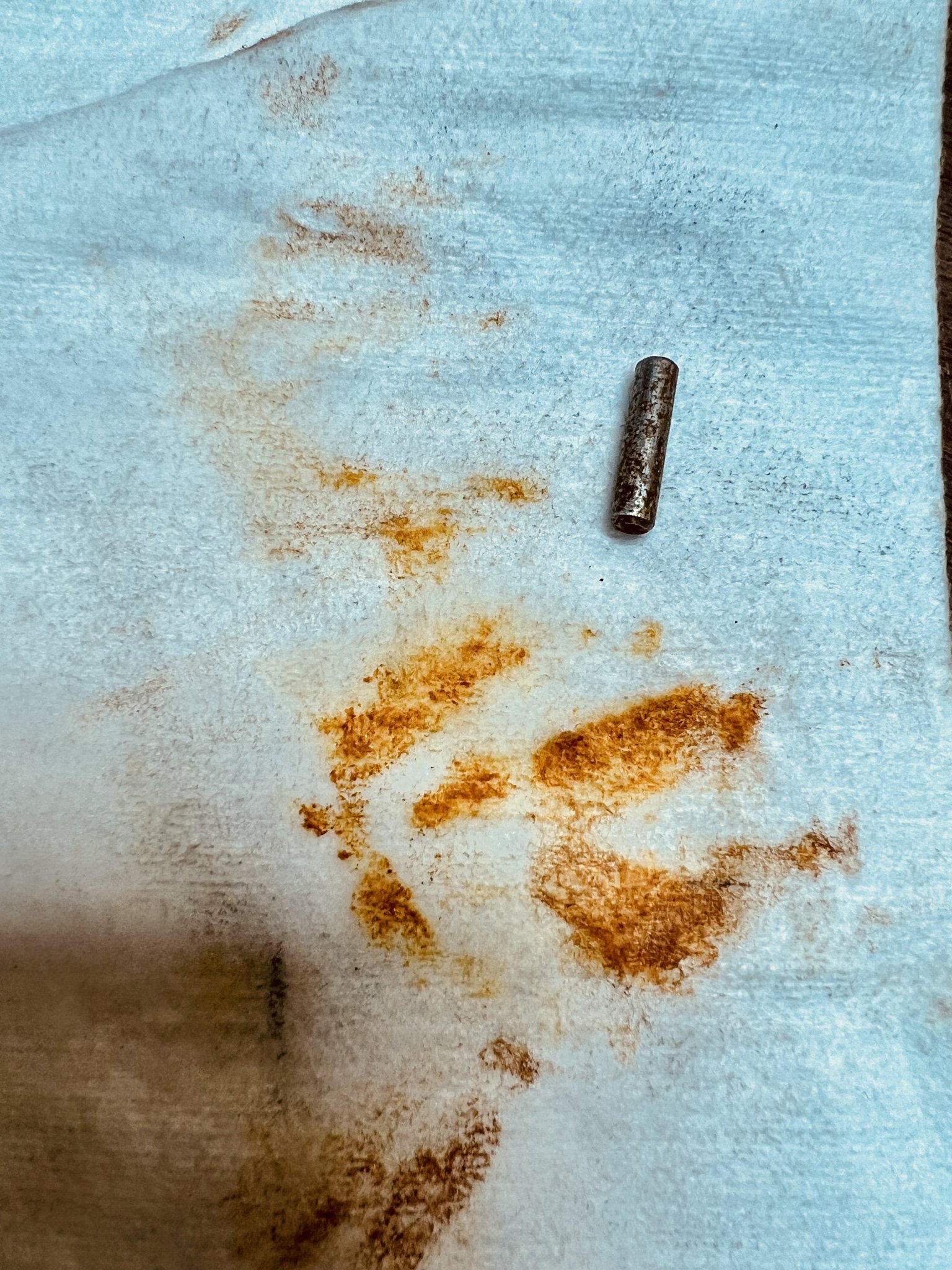

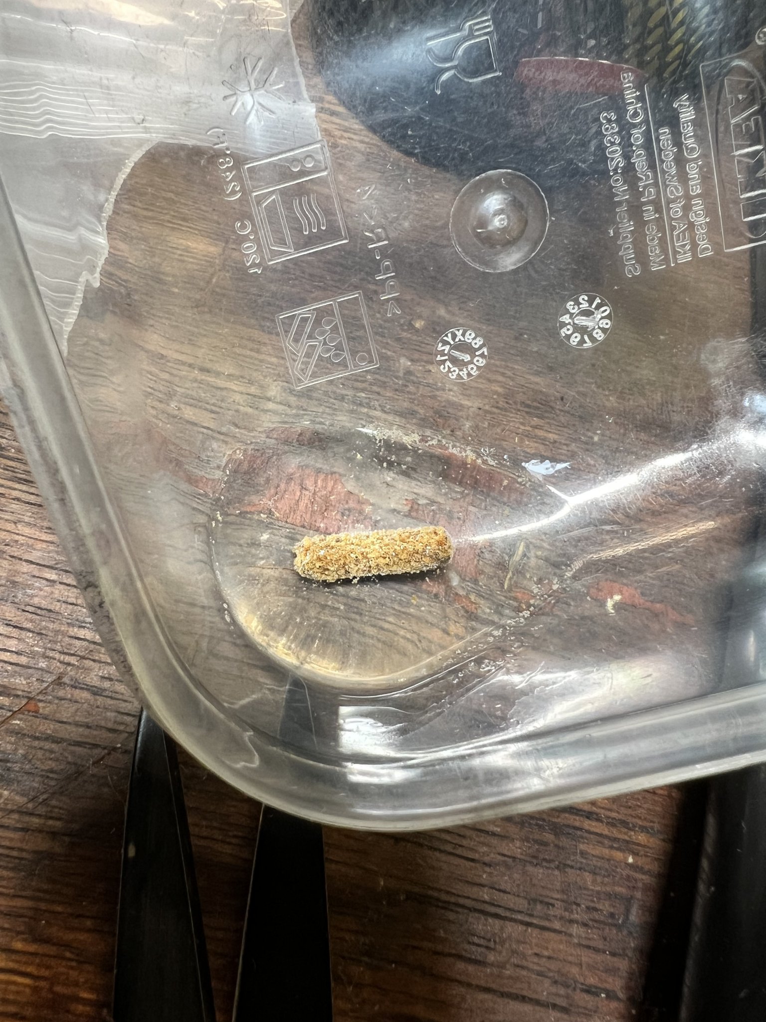

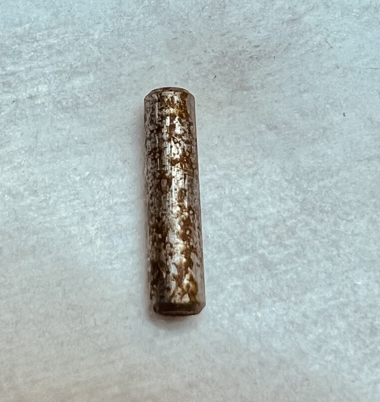

Experiment concluded:
Stainless steel pin was cleaned with alcohol and allowed to dry before placing into accelerator in dish.
Pulled from container after 45 mins:
Cleaned with alcohol:
Corrosion:
“Oh that reddish color isn’t rust…” WOW!
Reactions: 232593
I'll borescope my barrel that I left wipe out patch out in for over 24 hours. I usually let it sit over night without issue so we'll see how 24 treats the steel
Usually the first thing I do when I get home from a match(only shoot one day matches, 100ish rounds) is spray Wipe out patch out in my barrel and let it sit for about 3 hours and then patch it out. This normally cleans mine good enough, if not I repeat the next day. I’m on my second GT barrel and have had zero issues. Whatever is in that bottle that @FredHammer is using is almost acting like an acid.
