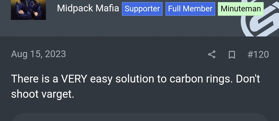

Post 120 in this thread.
So show me where I said "only Varget can cause carbon rings". Some of you have the reading comprehension of a dildo.
The vast majority of PRS/Match shooters who are having carbon rings, have them because the majority of them shoot varget. Its the go to powder from .223 to any 6 mm, to .308 and even some running in 6.5cm. I have found over the years, its notorious for carbon rings. There are so many other good powders that IMO, I don't even fuck with varget. H4350 while being a bit slower, is just as temp stable, gets better case fill due to energy/grain, is easier to find in 8 lb jugs, and is super forgiving when it comes to not cleaning all the time. Its a very clean burning powder. There are a few other powders that have similar properties like RL15-16, N140-N150 and even N540-N555, if you can deal with it being less temp stable and a bit more of a barrel burner due to it being a higher energy powder. Some powders are just more prone to carbon rings than others. I don't know if its the temps, how much residue they leave, the chemicals used or what. Just know there are patterns where some are bad and some are almost non existent.
