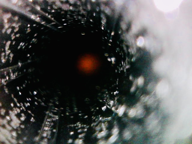

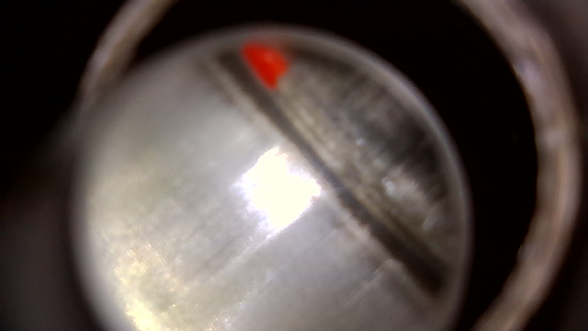

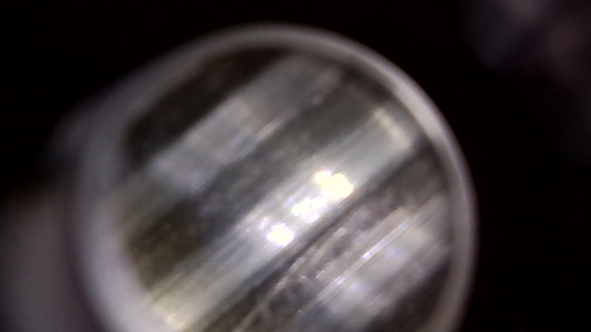

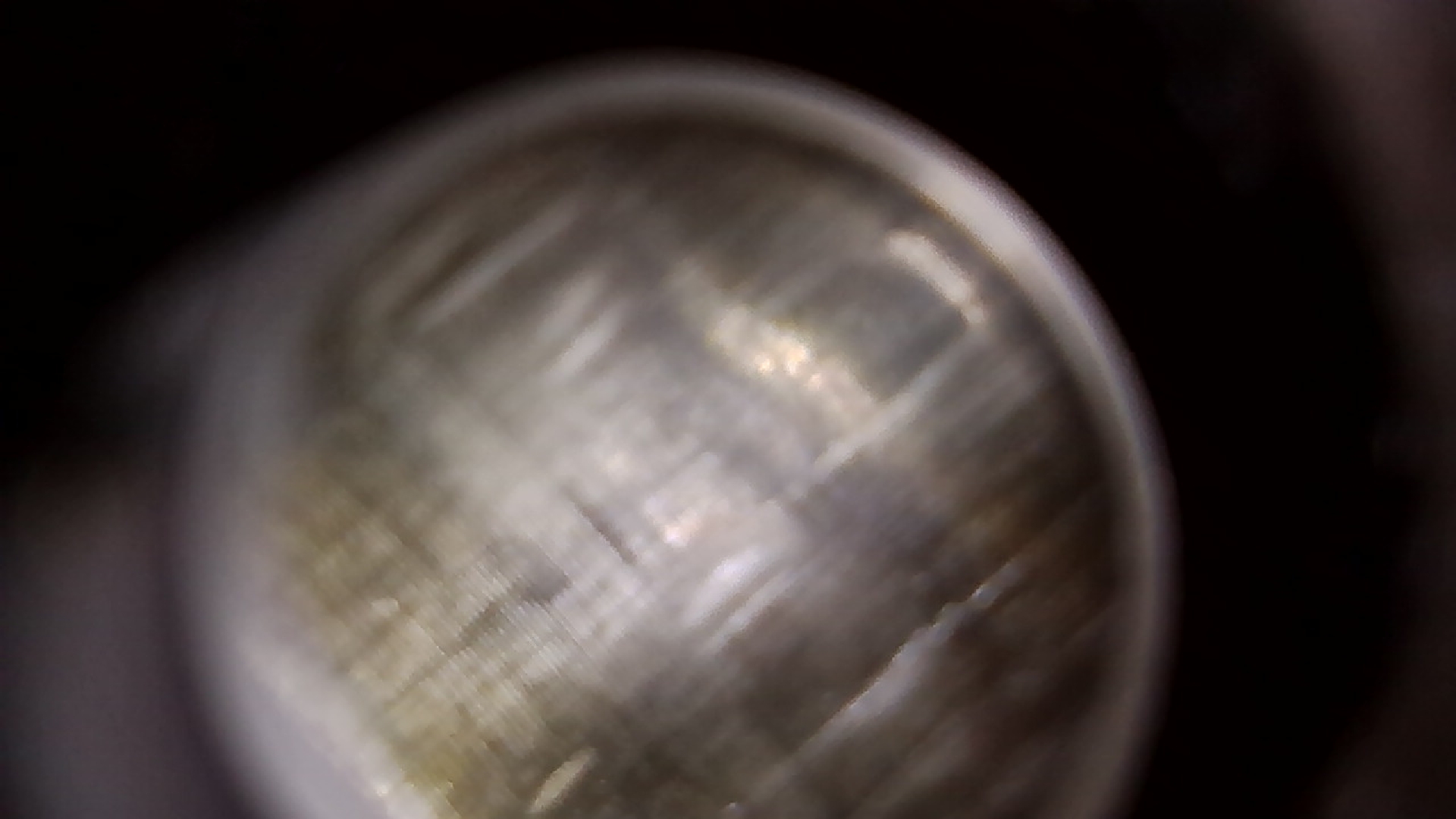

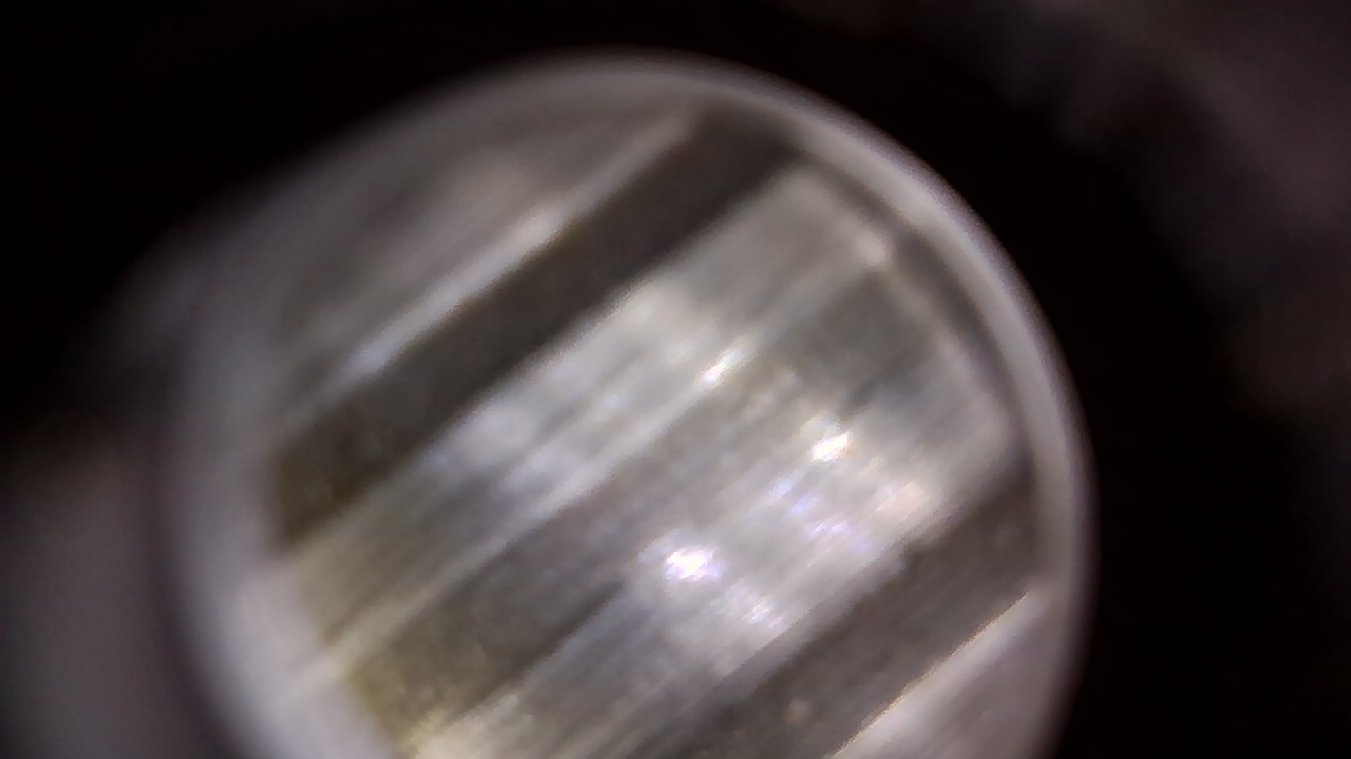

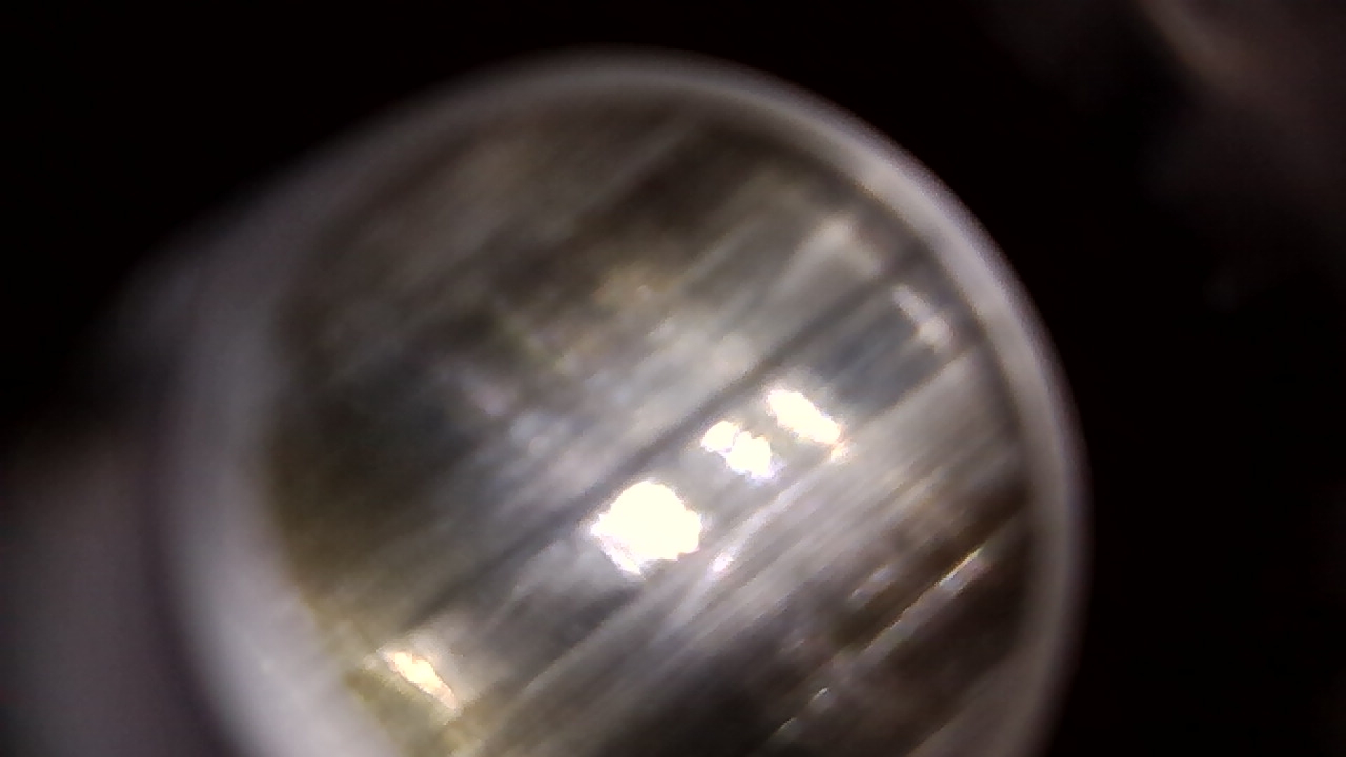

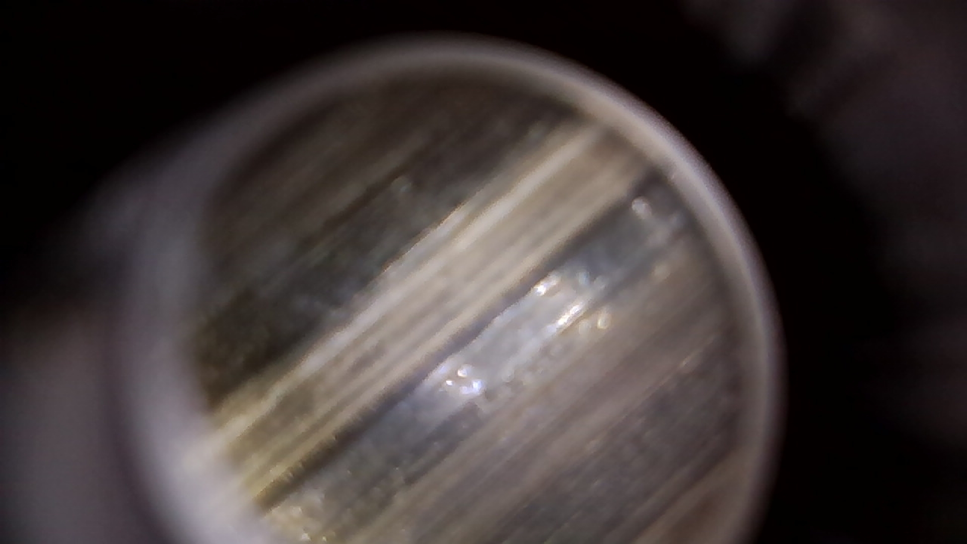

IMO, my barrel actually looked pretty great before the Iosso, but it is a .308 with only 1,500 rounds on it. 70-80% of that damage wasn’t there before this Iosso test. Although groups had opened up a slight bit, my decision to pull it is solely due to 1) how fast it heats up and 2) balance.
This is after a "good" cleaning. Tons of patches soaked with eliminator, 20 strokes or so with a nylon brush, more patches soaked then dry patches, which never really come out clean.

She shoots stupid little groups too. This is why i take all borescope pictures with a grain of salt.
View attachment 8204950View attachment 8204951View attachment 8204952View attachment 8204953View attachment 8204954View attachment 8204955View attachment 8204956
That's how mine looked after I cleaned it (accept the first pic, that's a little odd), too before I started using the foaming bore scrubber and nylon brush routine. I let the foaming bore scrubber sit in there and use plenty of it, for about 15 min, then do about 20 strokes with the nylon brush. Then jag it out with hoppes 9 several wet then several dry. Then light coat it with oil and put it up. That's what finally truly worked for me.
That said, if you clean it regularly, you don't have to get it stupid clean and as you said, it shoots great so.

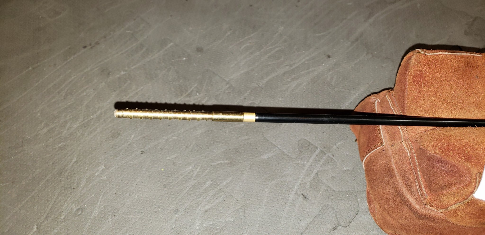

I just received my first "Parker Hale" jag today -- Made by Dewey
It does not have a point at the tip -- More rounded at the tip
There are several pretty sharp "jags" all around the sides -- Sharp enough that I am concerned about putting it down the bore.
It appears to be designed to just wrap a patch around the sides of the jag -- But not attached to the tip
Is this the type of jag you all recommend?

You wrap the patch around it like you’re rolling a cigarette….or whatever you roll. Lol
I only use them for applying abrasive. Got that from Mr Green.
For solvent patches, I use Bore Tech no-copper pointed jags.

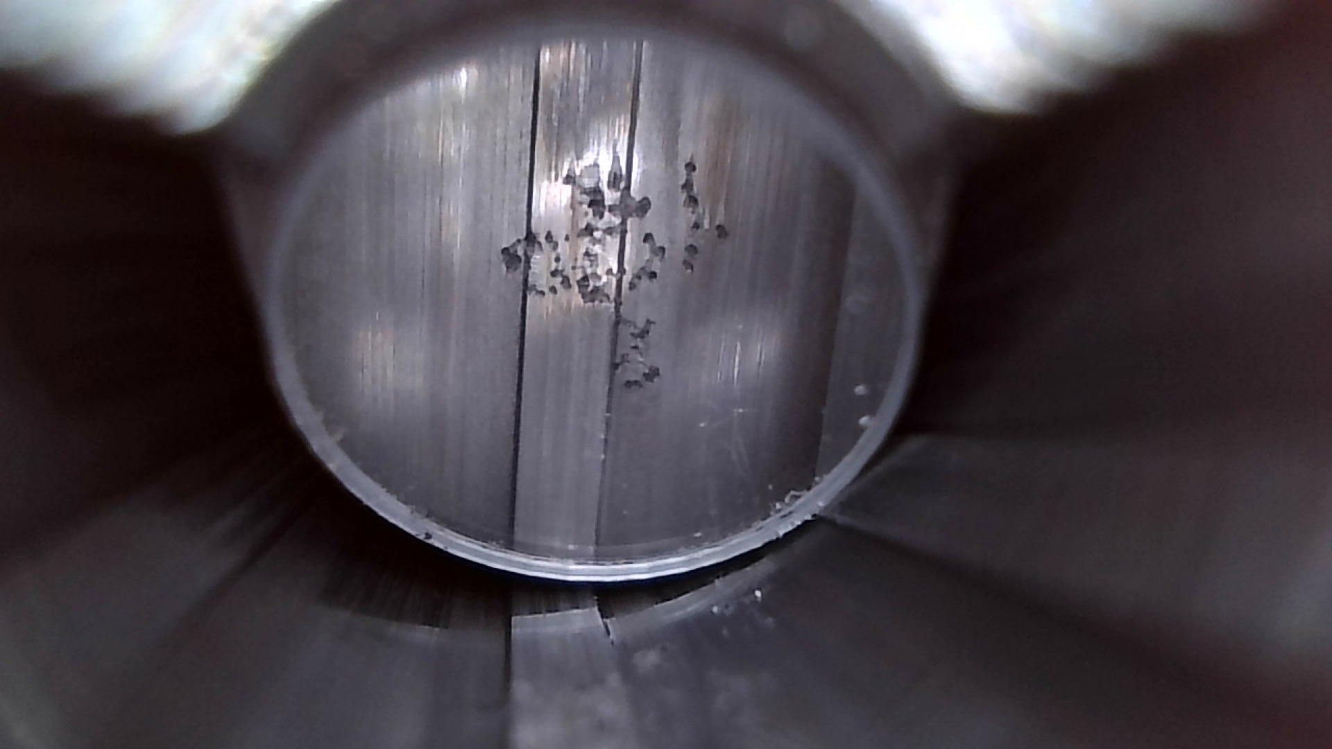

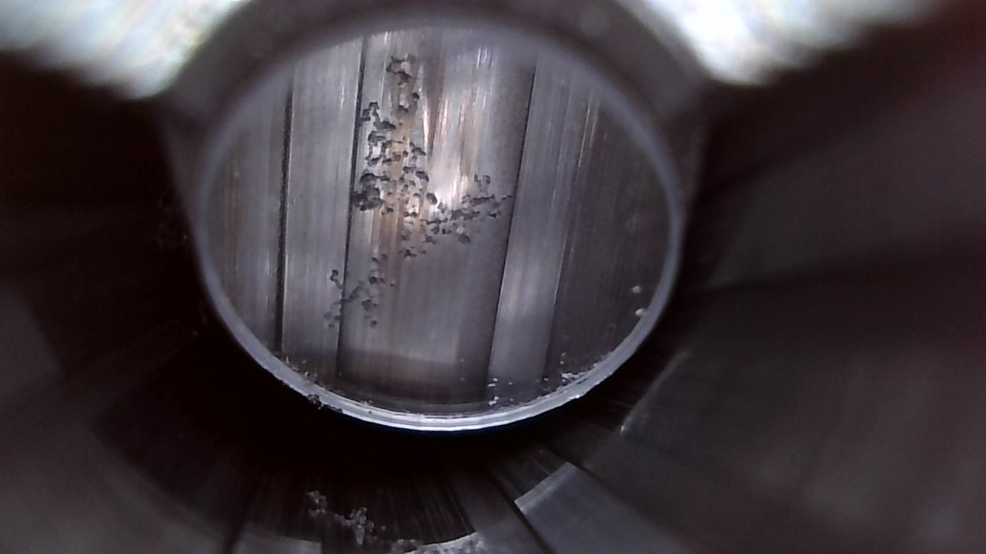

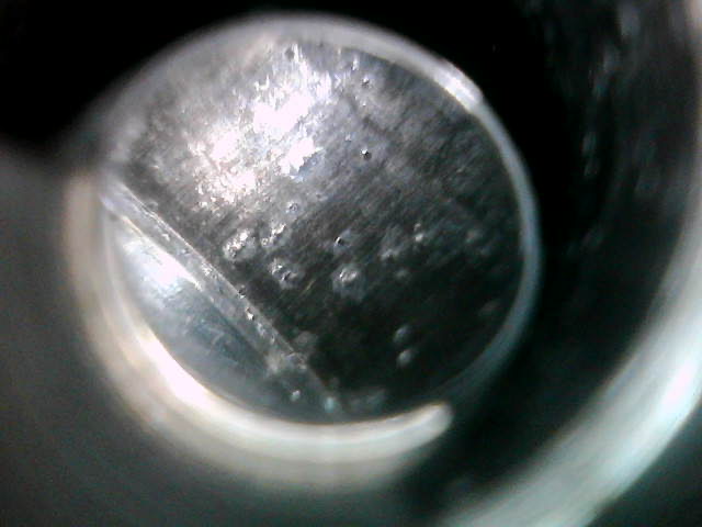

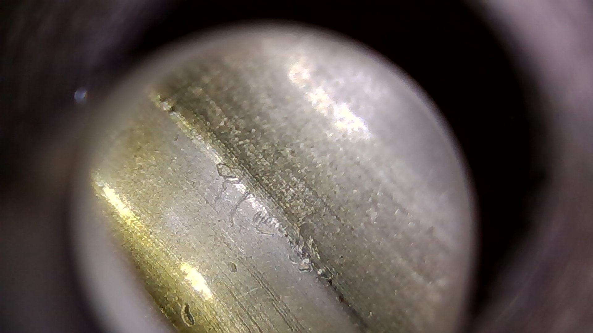

This is my 6ARC gas gun barrel with about 1000 rounds on it. It was cleaned after each range trip for the first 100 rounds then cleaned about every 200-300 rounds since then. It has numerous spots like this all between the gas port and muzzle, is it etching from cleaning, manufacturing defects, pitting from rust? The rifle shoots well so I was surprised to see this. What say the people?
View attachment 8206441View attachment 8206444
Wow, I’m no metallurgist by any stretch and often bore scope images can be misleading, but that definitely looks like some definite pitting to me. And you say is spread throughout the barrel downstream of the gas port. That is, this is not all of it, right?
If I had to speculate, I’d say it was Butch’s that was not thoroughly removed after cleaning. But that’s just a guess based on my observation that most people don’t dry patch enough to really remove all traces of solvent (yeah, I go thru a lot of patches. Lol).
If it still shoot well, keep shooting it IMO. But if it was me, I’d go to another solvent or be very diligent about getting ALL the Butch’s out.
@Frank Green - Frank, if you have a moment, got any opinions or insight on this?
A chemist will have to chime in, I'm not of much use from here out.

Hmmm? Looks like pitting. Could also be a void in the material. If the pitting that is shown in that picture is just in one area of the barrel and not thru out the barrel randomly etc.... then it could be a void in the material. Not to say it wasn't caused by a cleaner but if it was caused by a cleaner/cleaning procedure then there should be more thru out the barrel.
If it shoots good.... don't look down the bore. LOL! Shoot it till it pukes then.
I've never seen Butch's cause a pitting problem by itself. Like other cleaners.... I tell guys don't mix the solvents. Either in the jar or in the bore. Your asking for problems.
Later, Frank

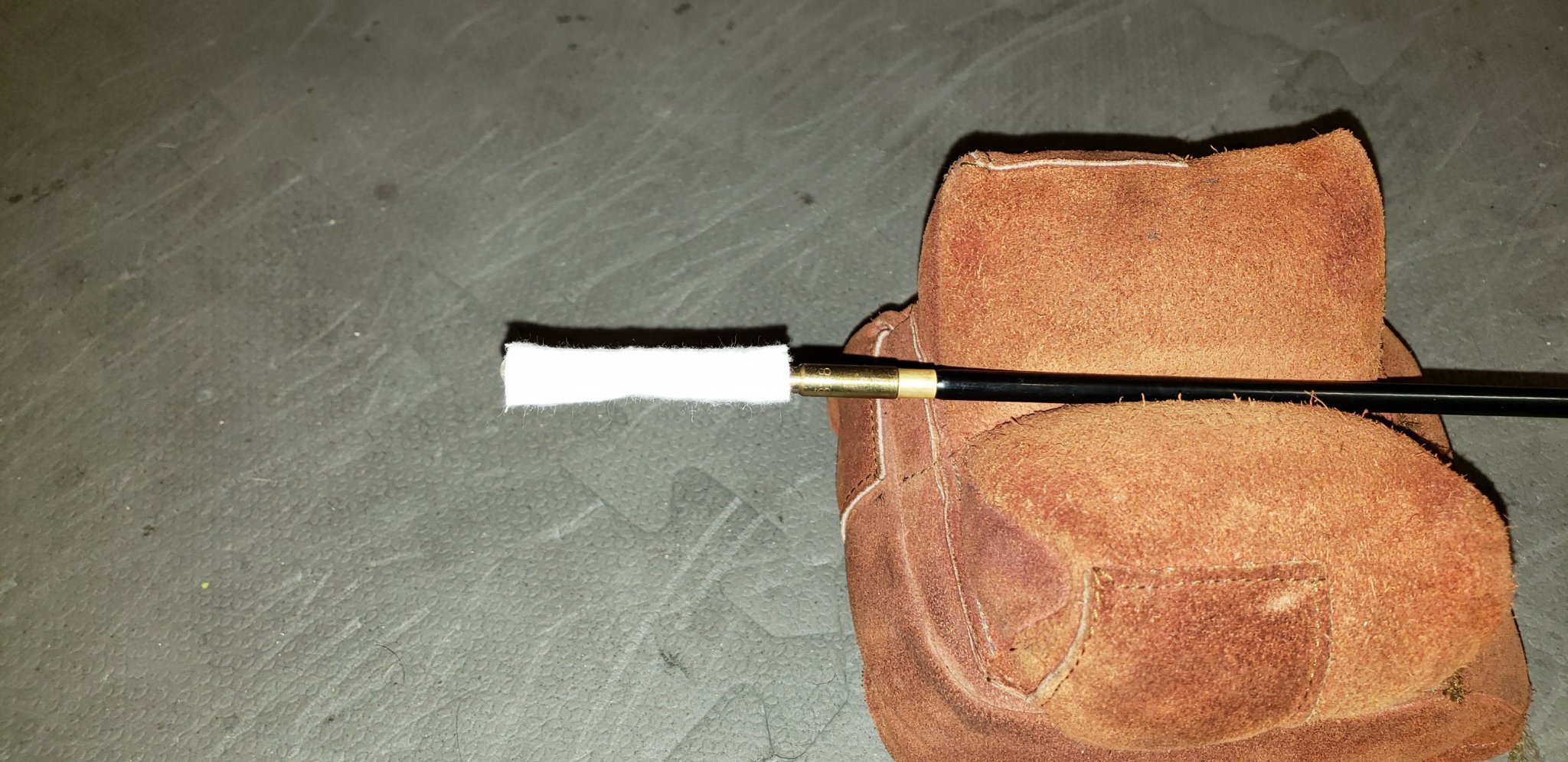

Correct... you don't spear the patch.
You roll the patch like you roll a cigarette. This give you a lot of surface area for patch to do the cleaning and will also keep the tip of your cleaning rod centered going down the bore. If your using a good rod guide as well you get minimal cleaning rod touching the bore at all.
For a 30cal barrel and PH jag use 2.25" square patches. For a 6.5mm use a 1.75" square patch etc...
You want a snug fitting patch but it shouldn't be so tight as to squeal or cause the cleaning rod to flex as it goes down the bore of the barrel.
Put the patch on and give it a twist with your fingers. Add your solvent etc....
