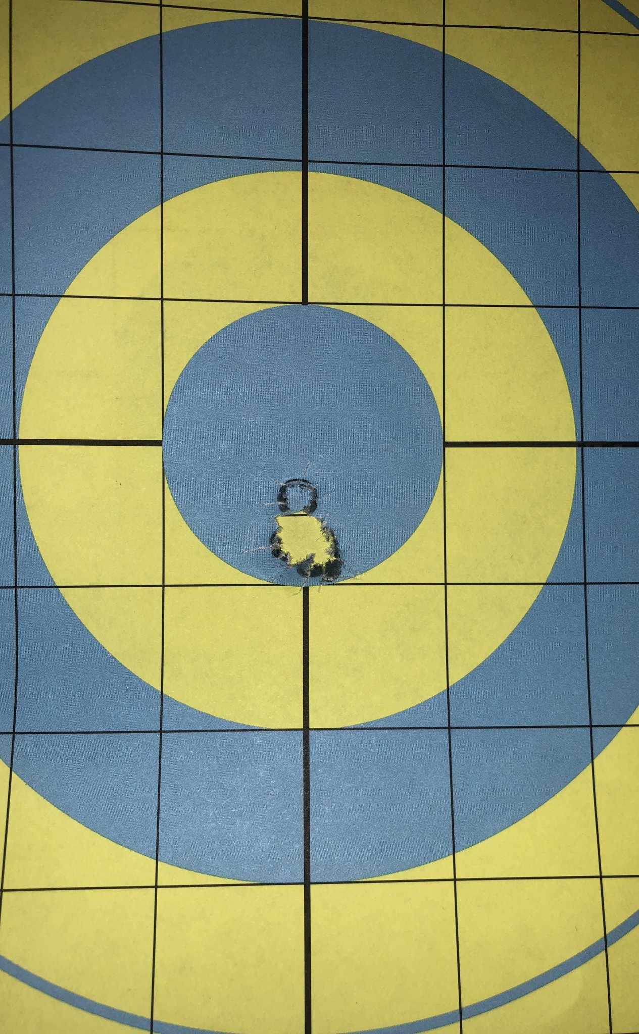

First let me get this out of the way. After reading about AI’s here for years I finally was able to buy one. I’m a fan boi. I only own one centerfire bolt gun. It’s an AI AT with AX stock and I shoot .308.
I wouldn't say they’re more accurate than others mentioned here. With an AI I would expect a sub MOA rifle. I would label mine as a 1/2 MOA rifle with factory ammo. I’ve shot a 1/4 MOA 3 shot group with a barrel I bought used with 1K rds through it. I’m not a 1/2 MOA shooter. My 10 shot groups tend to hover right at or just under MOA. But when I miss I have confidence it was me. Not my rifle throwing a weird flier.
AI’s are a system. The action is epoxied to the chassis. They are designed as a war worthy target rifle. They’re consistent.
Post ‘14 rifles have a quick change barrel system that is rock solid. Barrel swaps take under a minute and return zero if torqued properly.
Short action AX’s and AT’s use AW mags which are arguably the best bolt action mag made. And they allow for a a COAL of up to 2.94” or so.
They are 6 lug 60 degree actions. They’re very smooth but the bolt lift is heavy. Their safety is a bolt shroud mounted 3 position that blocks the firing pin.
They’re easy to maintain in the field with minimal tools. I can strip my rifle down to the bare chassis and action with a 2mm and 4mm hex wrench. Bolts, barrels, and triggers can be swapped in the field. Easily.
Now to the downsides. They’re heavy. I think a bare AT is about 13-14lbs. You’re stuck with the factory pistol grip. Factory spare parts like bolts, firing pins, and triggers are expensive. And can be hard to come by.
ETA: pic is the first 5rd group from my rifle. The 14th-19th rds fired while sighting it in with no special break in.
Thx luvman- those are the details I need to know about the AI
-And your 5 round group in the early stages of shooing is impressive. A little low of the bullseye, but it is CONSISTENT!

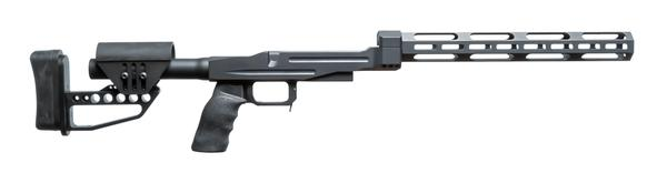

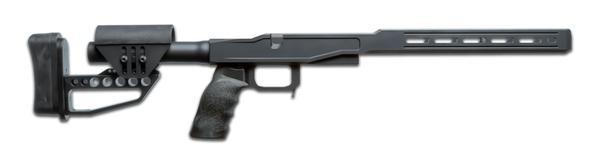

Widely easily, adjustable LoP, both thru sliding the stock body up the AR style buffer tube, and even a shorter buffer tube being available. I like super short LoP.
Mlok rail system, options as far as the handguard (open vs. closed) Carbon chassis options, front spigot rail etc.
Tho lots of chassis can do much of that. But not for the reasonable XLR prices.
