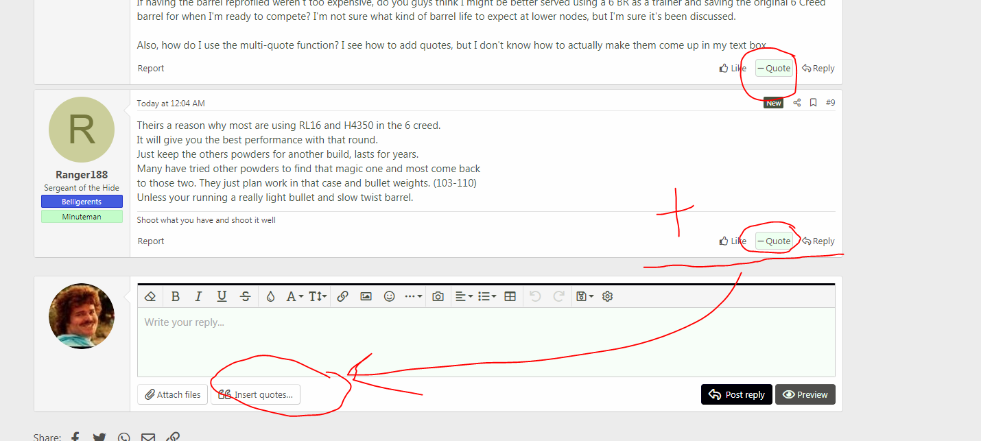

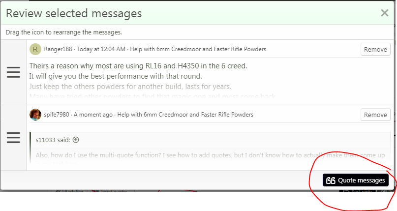

Also, how do I use the multi-quote function? I see how to add quotes, but I don't know how to actually make them come up in my text box.
I find it easier just to insert with the reply button one at a time.

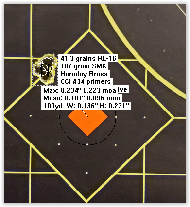

I have that same rifle. The load I've had the best luck with, .223 inch group, is 41.3 grains of RL-16. Also 41.3 grains of H4350. RL-16 gives higher velocities. I chrono'd the H4350 at an average of 3017 with an ES of 14 and SD of 5. I loaded BTO at 2.181" No idea how I arrived at that number...could be a COAL of 2.750 or there abouts. Bullets were 107 Sierra matchkings.
I also just picked up the Savage 110 Tactical in 6mm CM. Hope that shoots as well.
Good luck!
