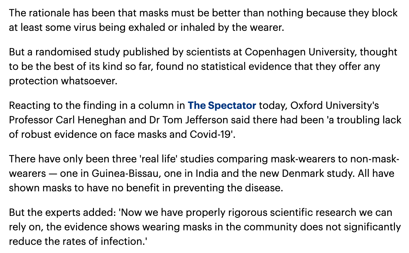

Amazing how that suit got dismissed too...
But to what end? He is so far to the end of his life very little of that windfall will matter. I fail to understand the scoreboard logic that makes the alegebra work out for people like Fauci in their advanced years. It’s foolishness.
A n95 will not filter out those chemicals either. Large droplets sure, but you will absolutely smell it.
