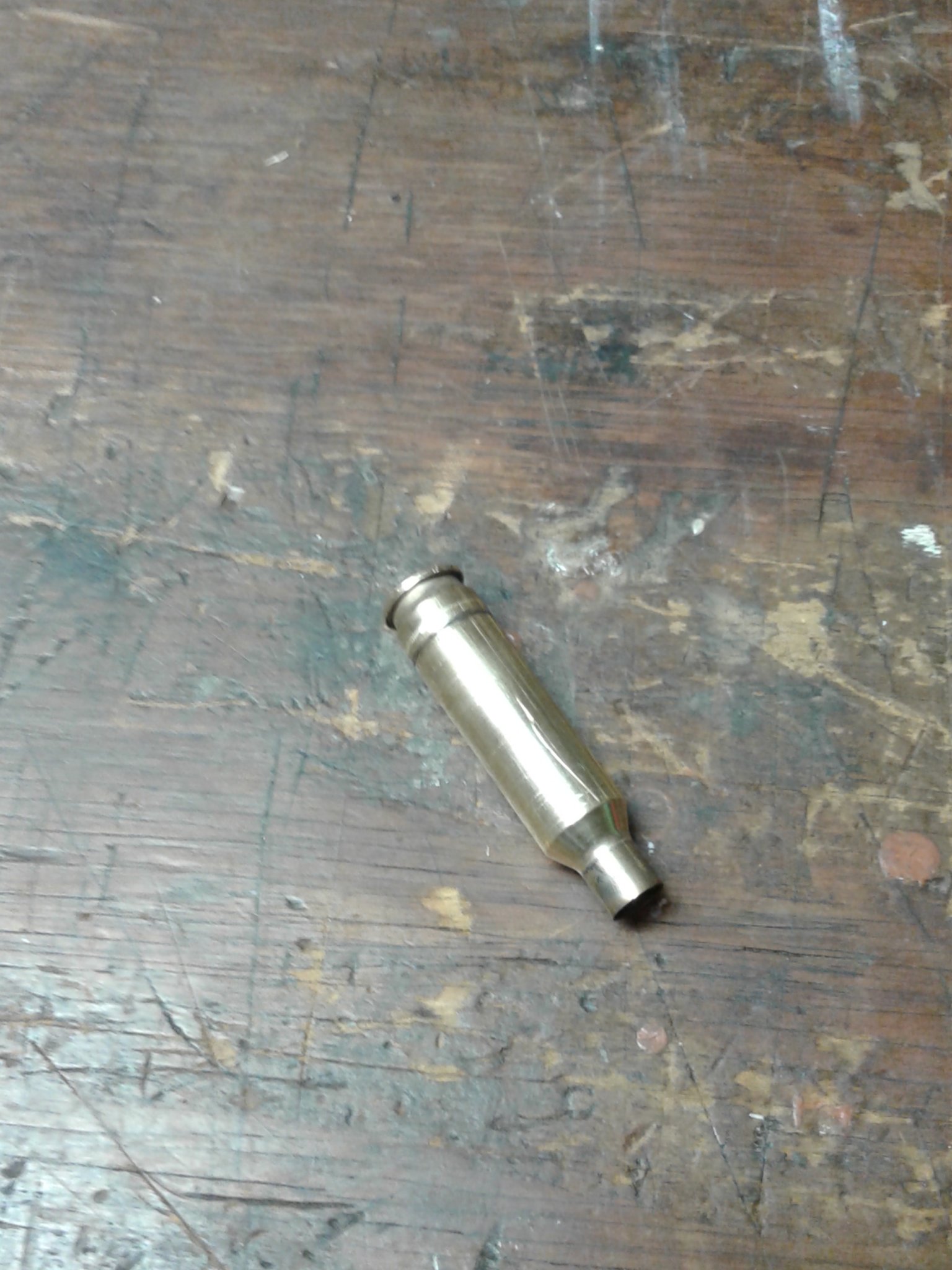

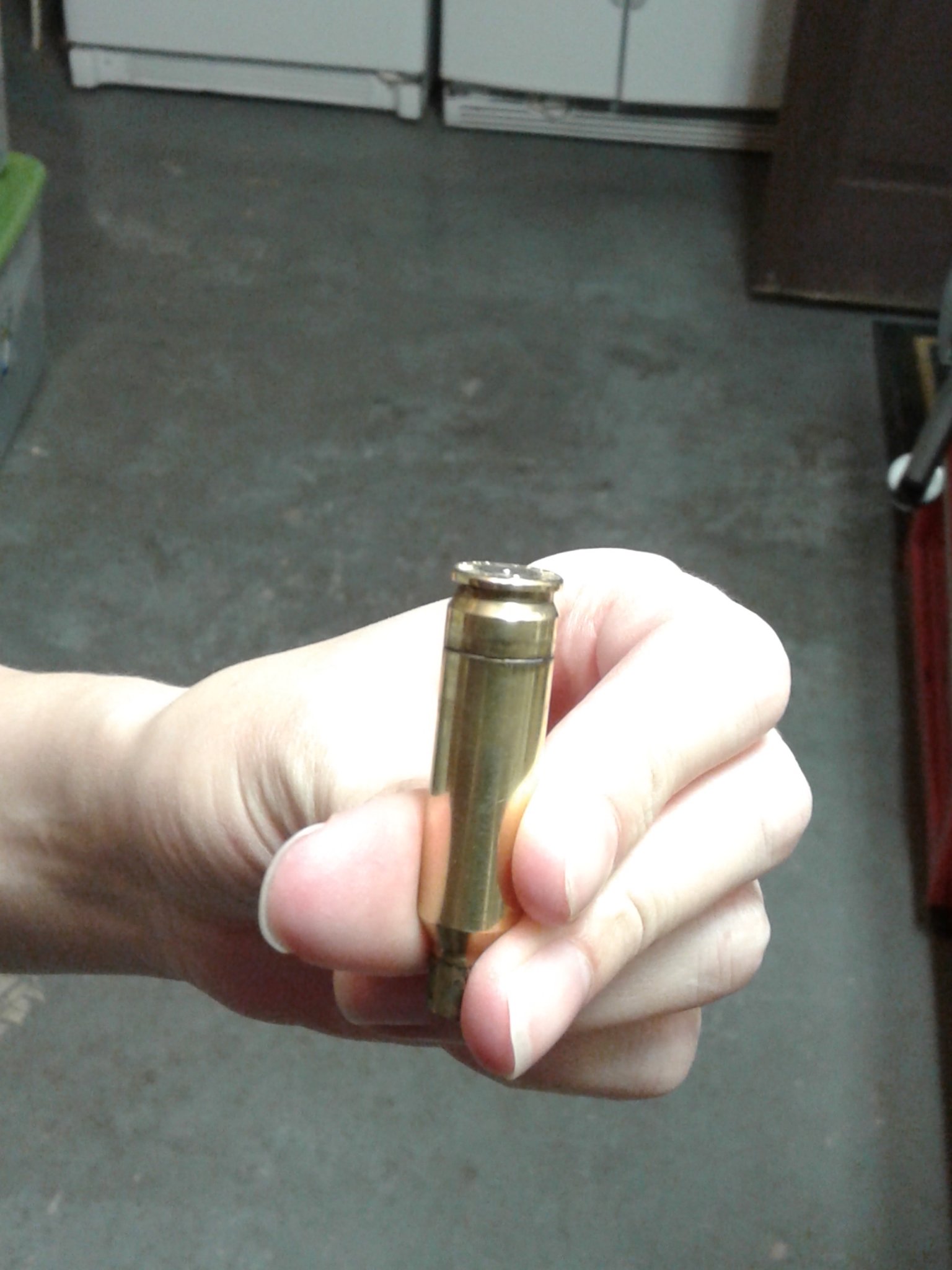

So I had a first @ the range today. I was shooting my 6.5 creed mpa rifle with my goto handloaded rounds. 40.4 gr of h4350 under a 140eld. Pretty standard load. I just loaded the rounds the previous night. This was the 5th loading on the brass.
I had shot about 20 rounds when this happend. Shot 21 kicked way harder than normal and the bolt was very sticky and the case was a bitch to extract.
Case had a ring around the web that could be felt with fingernail.
This was concerning and I chalked it up to thinking it was a fluke deal as I've never had it happen. The primer didn't show any signs of high pressure either.

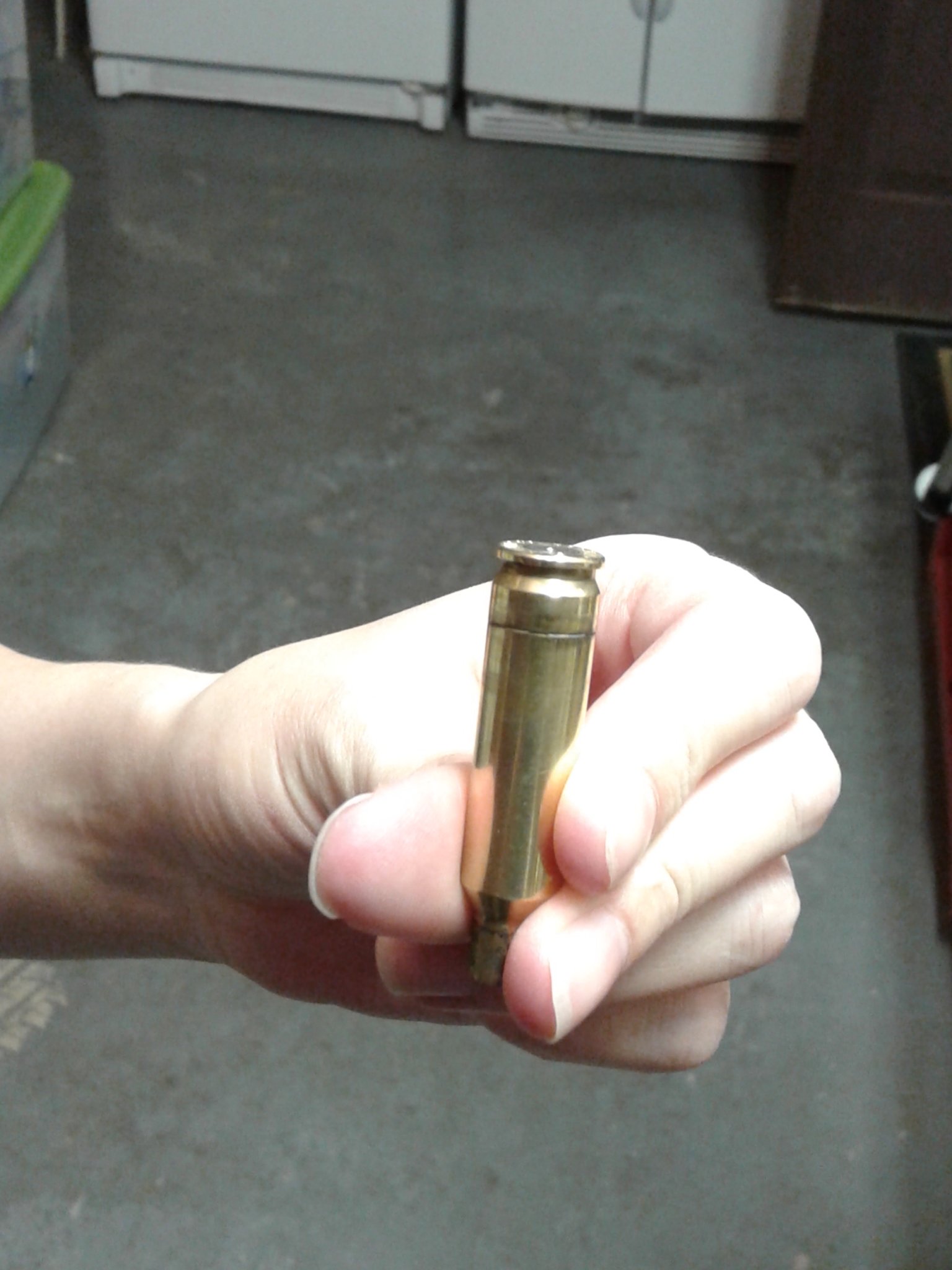

I proceeded to fire another 6 or 7 rounds and it happened again. Except this time I couldn't get the case to extract and had to get salty with the bolt to finally get it to extract (surprised my extractor didn't break)
This case had complete failure and exploded in the chamber. It recoiled twice has hard as normal. I knew the second I fired the shot something went wrong.
My question is this , what happened? The brass was only on it's 5th firing and hadn't really showed any signs of needing to be culled yet.
It's a pretty mild load I'm shooting so what caused the brass failure and massive pressure spike?
Again ,on the brass that failed the primer remained intact and looked normal.
With this happening could it have damaged my rifle in any way? I immediately stopped shooting when this happened,and am Leary of shooting my remaining 20 rounds I have loaded.

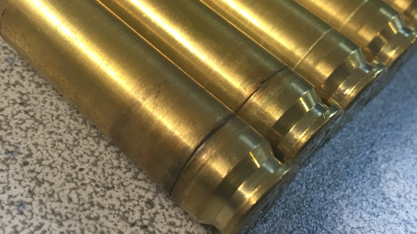

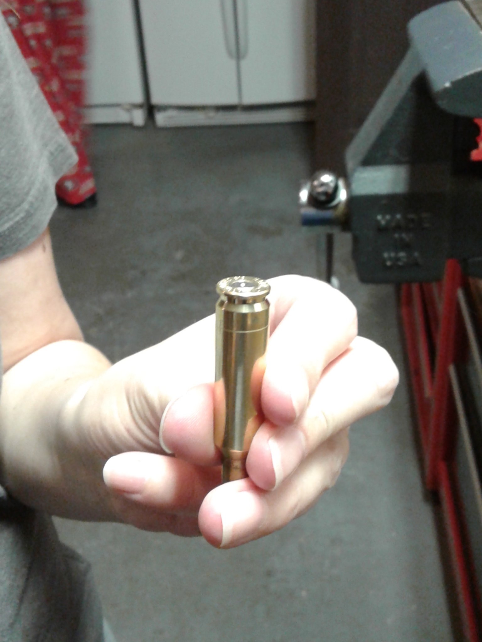

Like others have said; you might be pushing your should back to far when resizing.
Here is my Hornady 6.5CM brass after 12 firings. Classic case head separation.
If you are actually bumping only 3-4 thousandths that shouldn't happen in 5 loading unless something else is going on, like the chamber is way too big.
Yes the brass is trash, and probably worth pulling down the ammo rather than shooting it.
That actually makes perfect sense. Few days ago I tore down all my dies and cleaned them and when I was sizing I was bumping shoulders back 3-4 thou, and I usually bump 2 thou.
So next question...do I need to pull bullets and toss the brass ?

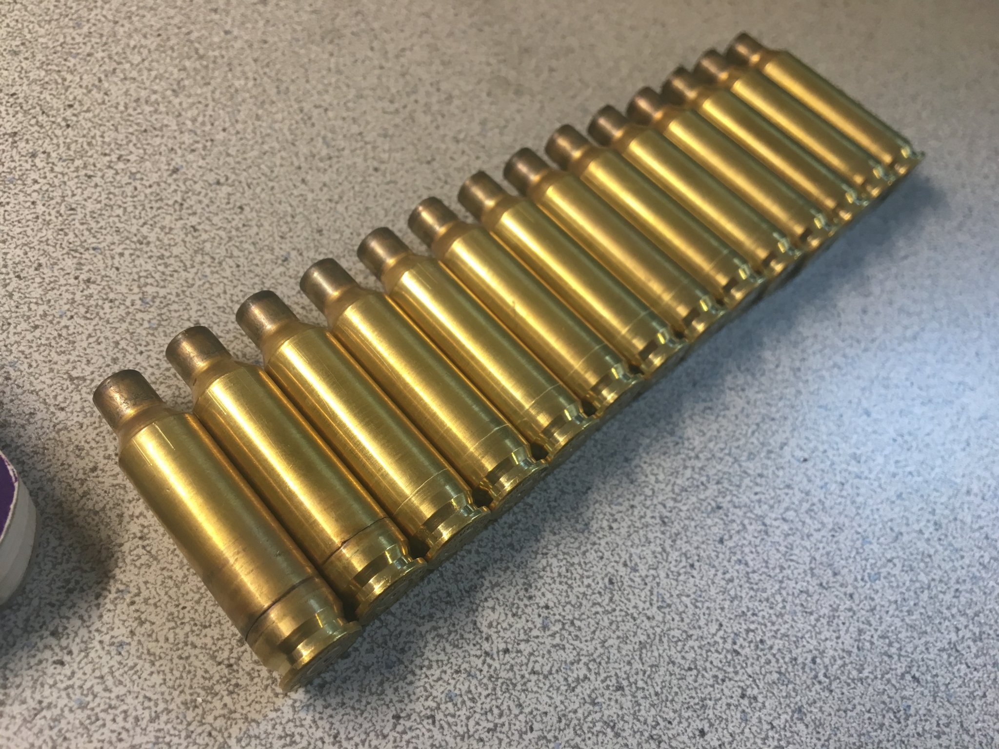

Separations usually aren’t caused by one cycle of oversizing, but several cycles. 3-4 thou really won’t do it. I’d evaluate your measuring technique/equipment. Something is likely off. You may also take some diameter measurements of sized and fired brass for comparison.
Look at that narrow strip of case just below where the separation occurred. That tiny ring of metal was continuing to seal the chamber, and the only thing that saved you from getting a huge volume of gas/shrapnel in the face. Yes, trash the brass.

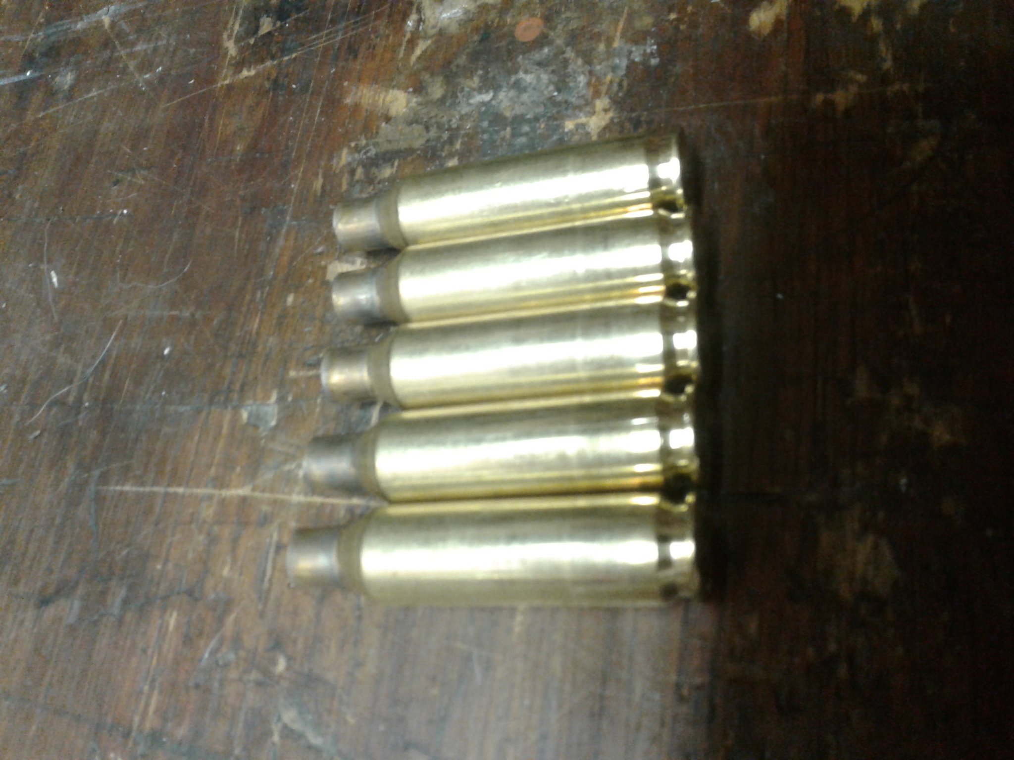

And yes once it's fired I store it primer side up in my ammo box like the pic I posted above until I decap and start brass prep.
And yes I do measure the brass after every firing when I'm getting ready to resize.
It's pretty much always spot on at 1.531 " when I measure before I size.
I usually bump it back to 1.529
If you store your ammo primer side up in the ammo box the rounds can swirl around in its hole causing a ring around the case from where it runs the plastic or other material as it spins. All my ammo boxes are not a perfect fit for the rounds i store in them so i see it fairly often. It leaves a little ring around my brass about halfway up the case.... not saying thats what you have going on but its worth a check.
This is insipient head separation and is the result of brass stretching due to excessive headspace. You must anneal often to prevent springback or absolutely gage every case. Always check for rings in the brass just above the base where the separation is occurring and keep a close watch on your firerformed brass measurements in case there has been a physical change in your chamber due to wear or pressure. I check every round with a bent paperclip slid along the inside of the fired case. If there is a catch, throw it away. I have seen a lot of talk here about how Hornady brass is inferior, but I have used all types of brass and if it is prepared correctly and examined as all brass should be, it's just as good as any. Just as in any other component in this sport, barrel, action stock, bullet, powder etc., most shooters will tend to have favorites and anything else is inferior even if it is superior. I have found that most reloaders don't anneal and just keep on using brass till it fails and then blame the brass. If you think you can't afford to anneal, go to you tube and watch salt bath annealing vids. It's cheap and accurate as the best computer controlled $K+ annealer on the market. Back to basics. Don't blame the brass.

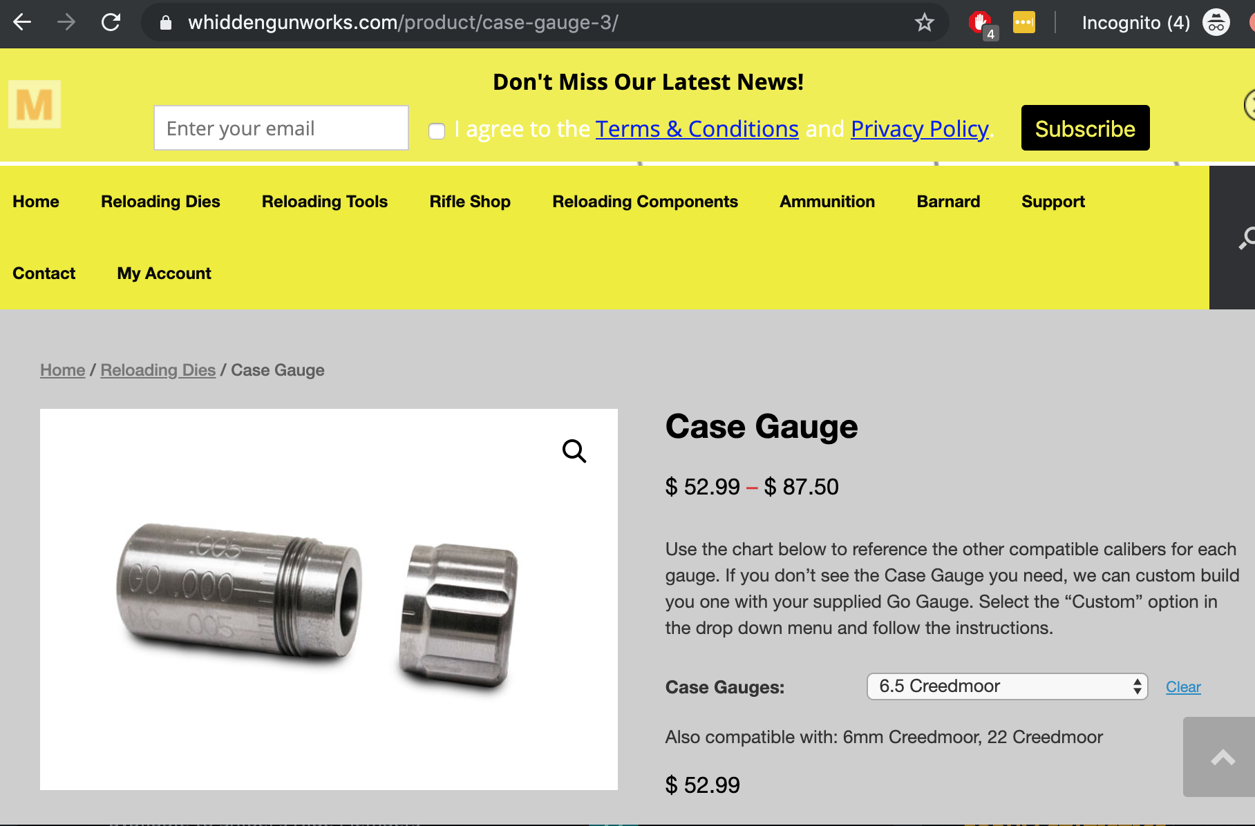

Fwiw, I use one of these. I've found factory rounds (Hornady, Prime) and virgin Peterson brass to measure -0.002 to -0.003 in it. Fired brass is +0.002 to +0.003. I barely move the shoulder, just enough (0.001-0.002) to know the size die touched the shoulder. Works for me.
