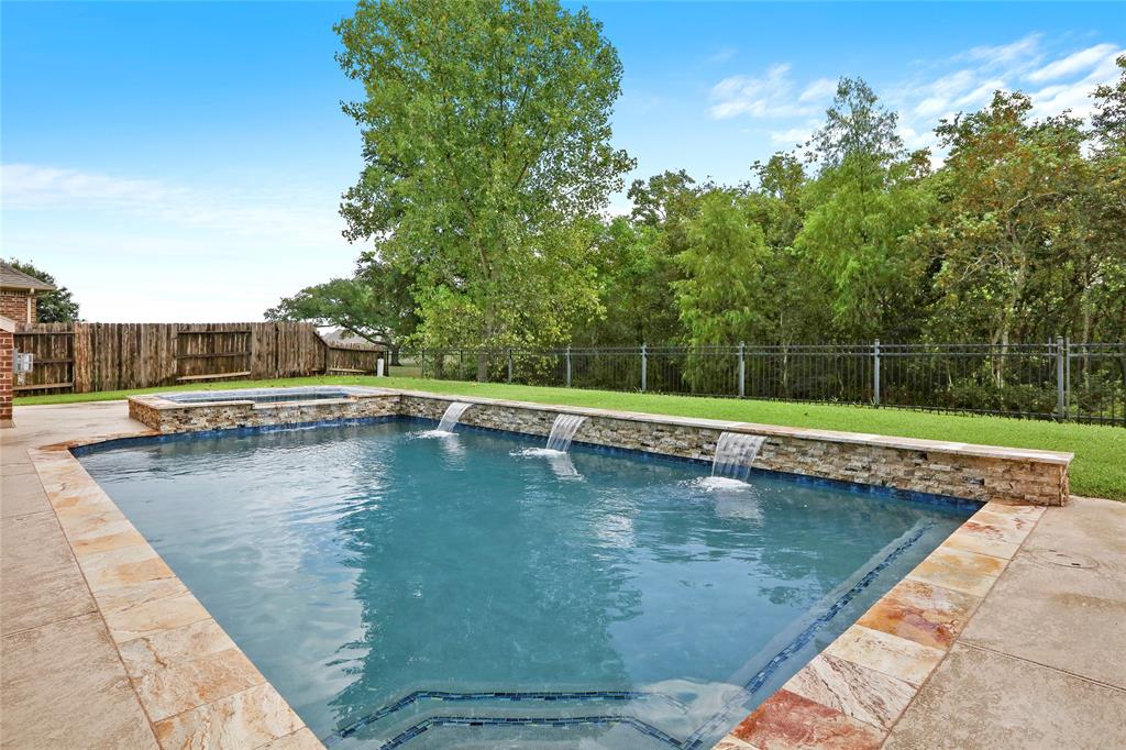

I'm no help on the cost, but 50-60k should be the ballpark unless you go crazy like my buddy and spend 165k on one.
Beautiful pool! Love the water feature and marble!

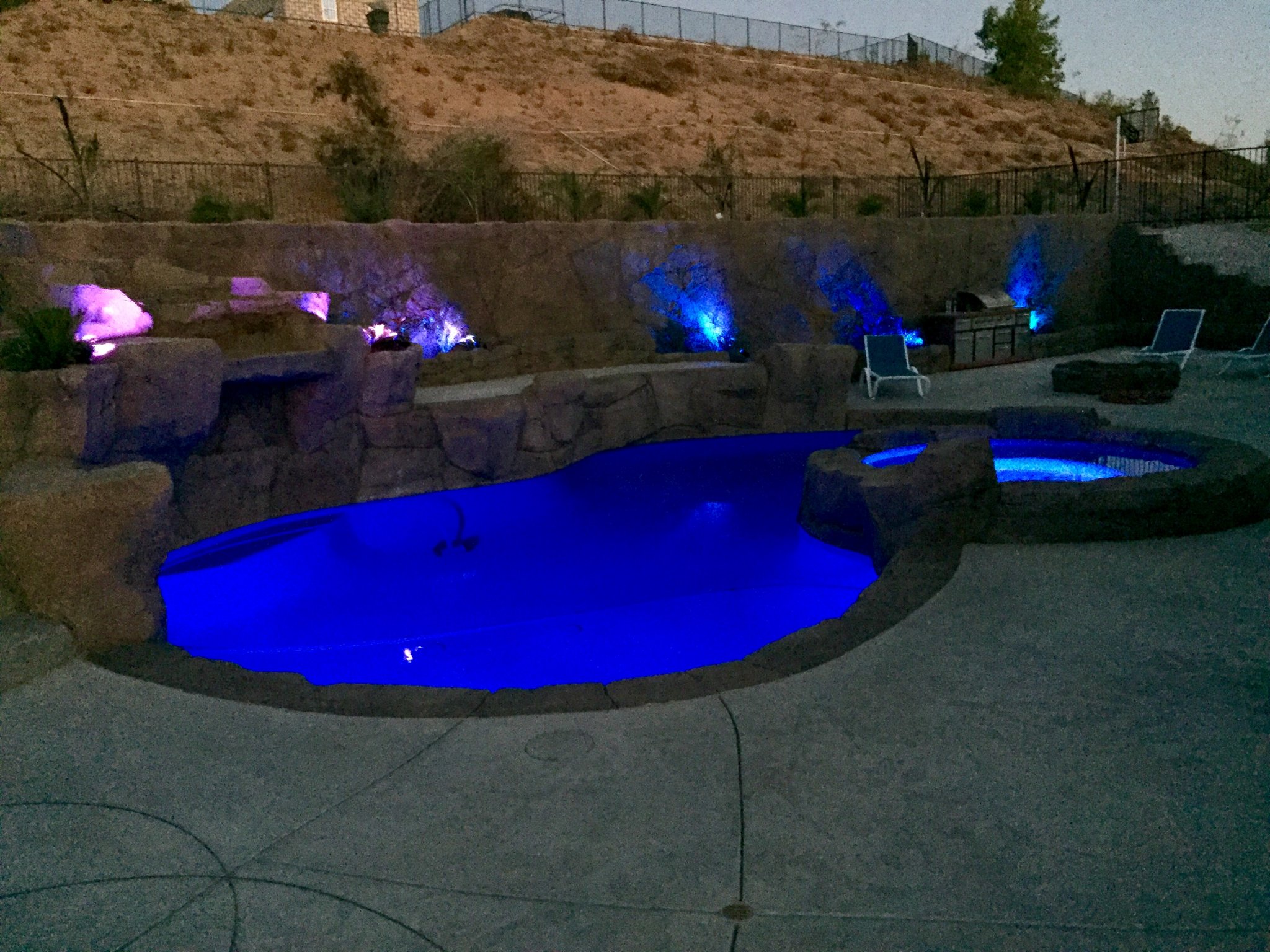

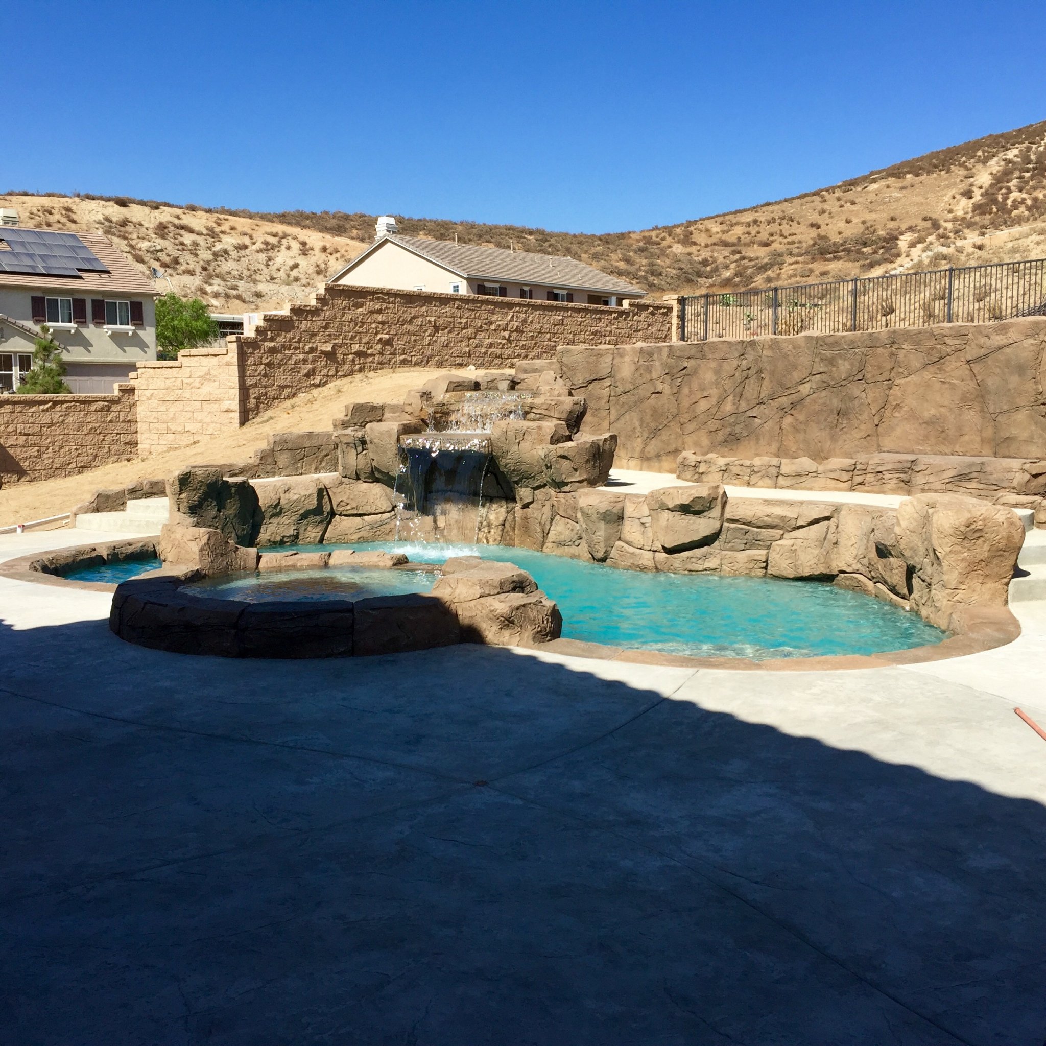

I paid $100 grand for ours, but we live in $Cali$ and pay the premium. It is a saltwater pool, and I highly recommend saltwater over normal chlorine water as it is much easier on the eyes and skin.
Thats what I'm looking for! Im looking for a setup very similar, in Houston that would probably run me $60k. thanks for the pics, looks great.

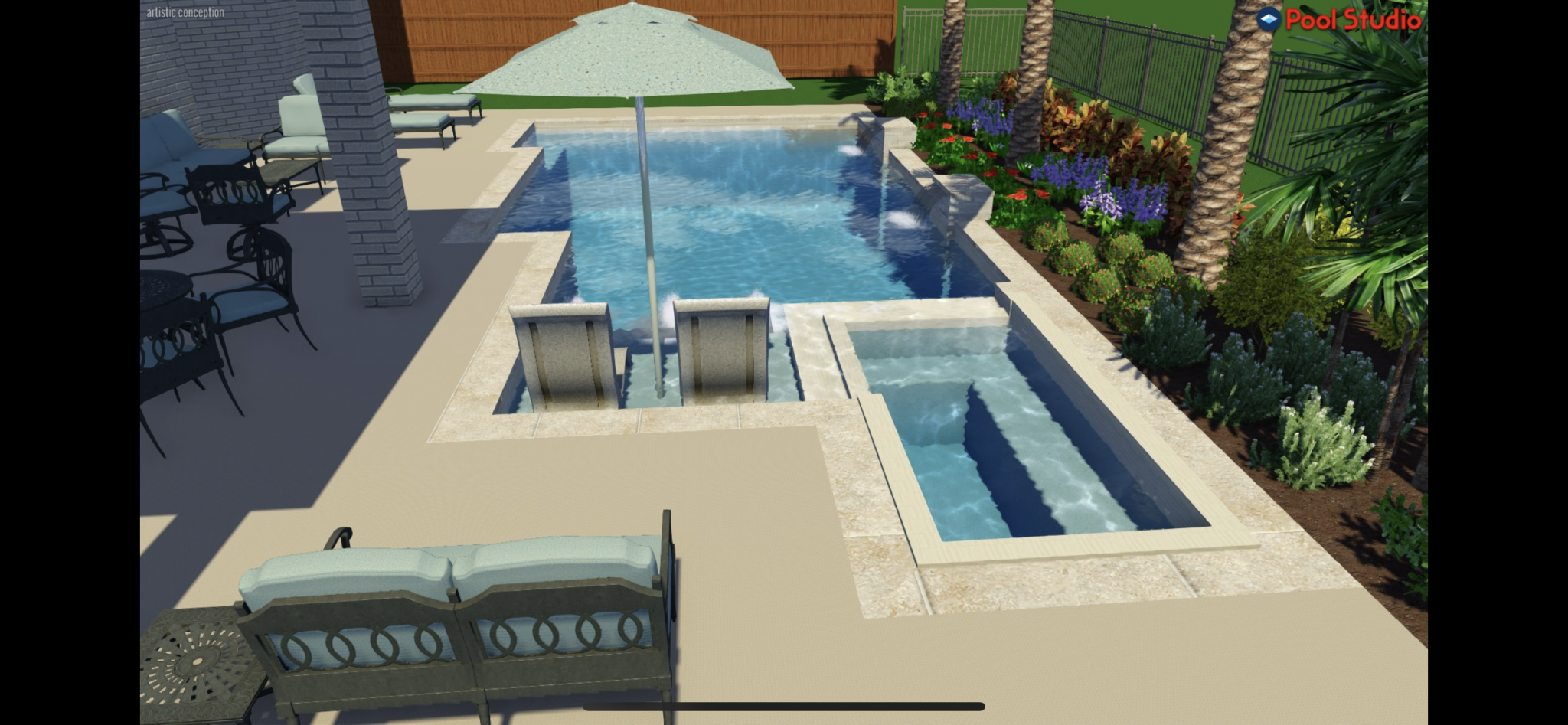

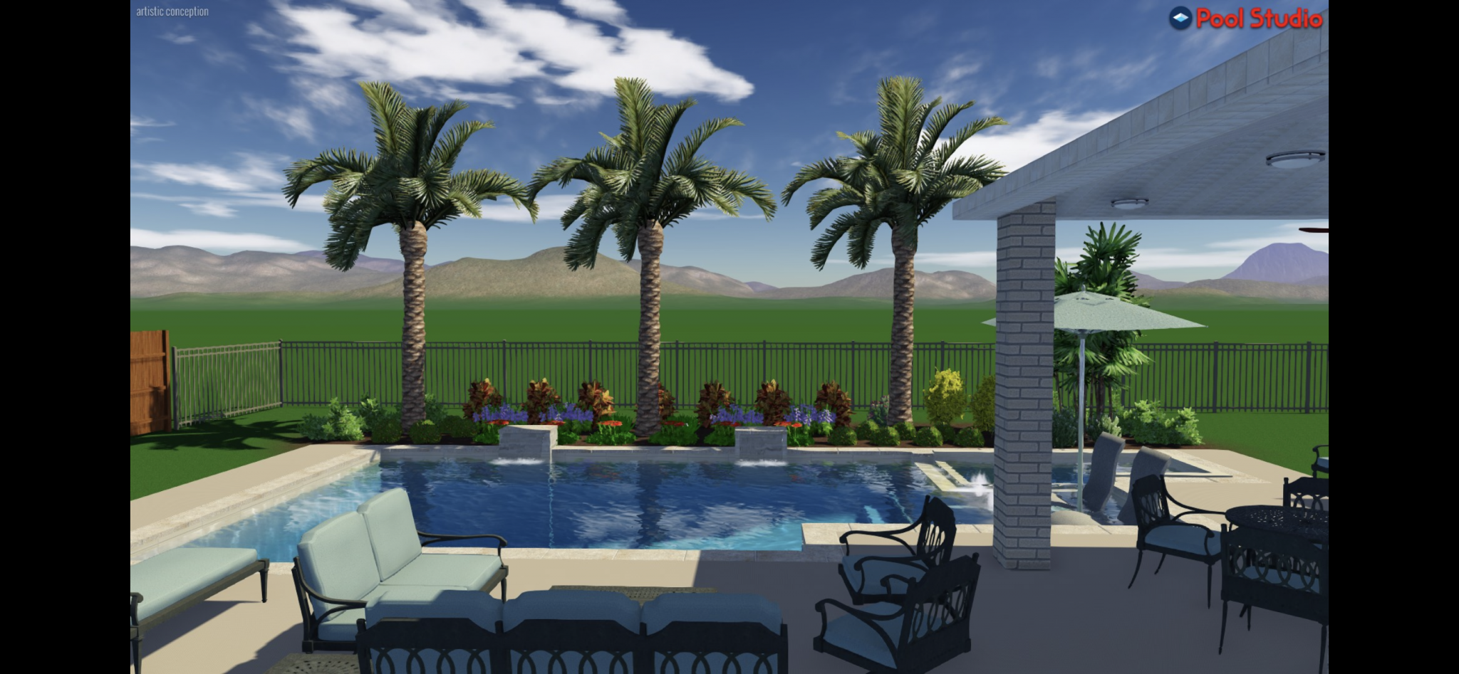

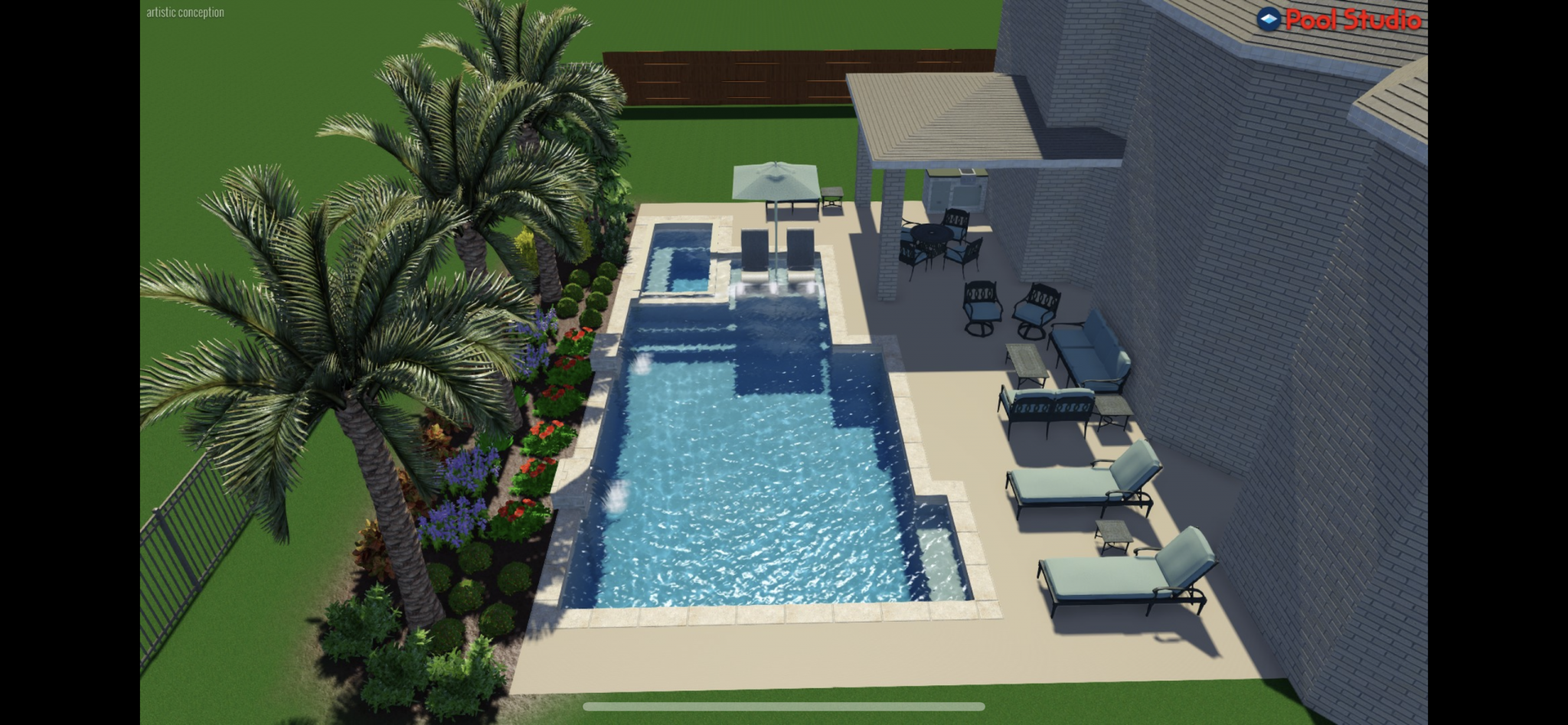

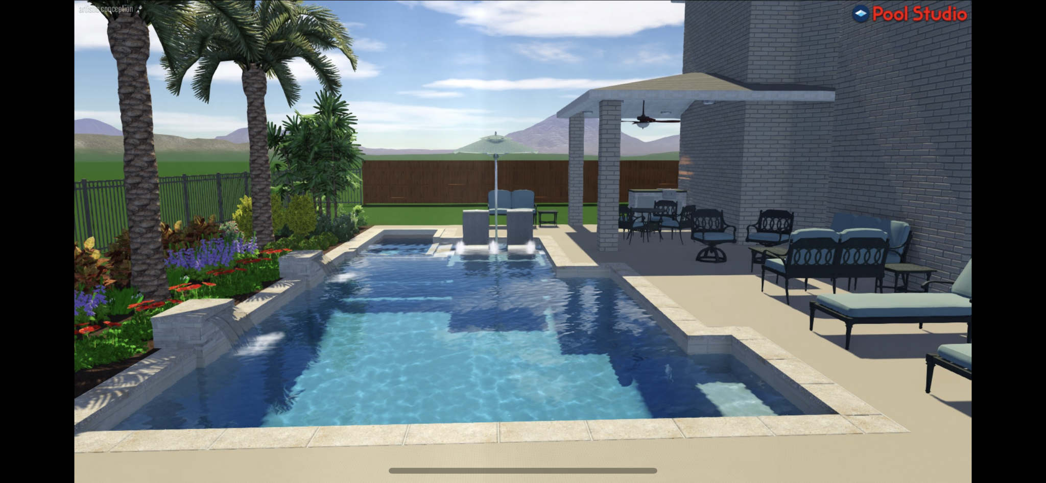

D587A83B-0BA6-4049-844C-3A730E2E0C4B.jpeg18041C8A-C29F-44AD-B556-2AA3CC3CCDA0.jpegA78BD280-360B-462F-A544-F50392DB80A1.jpeg

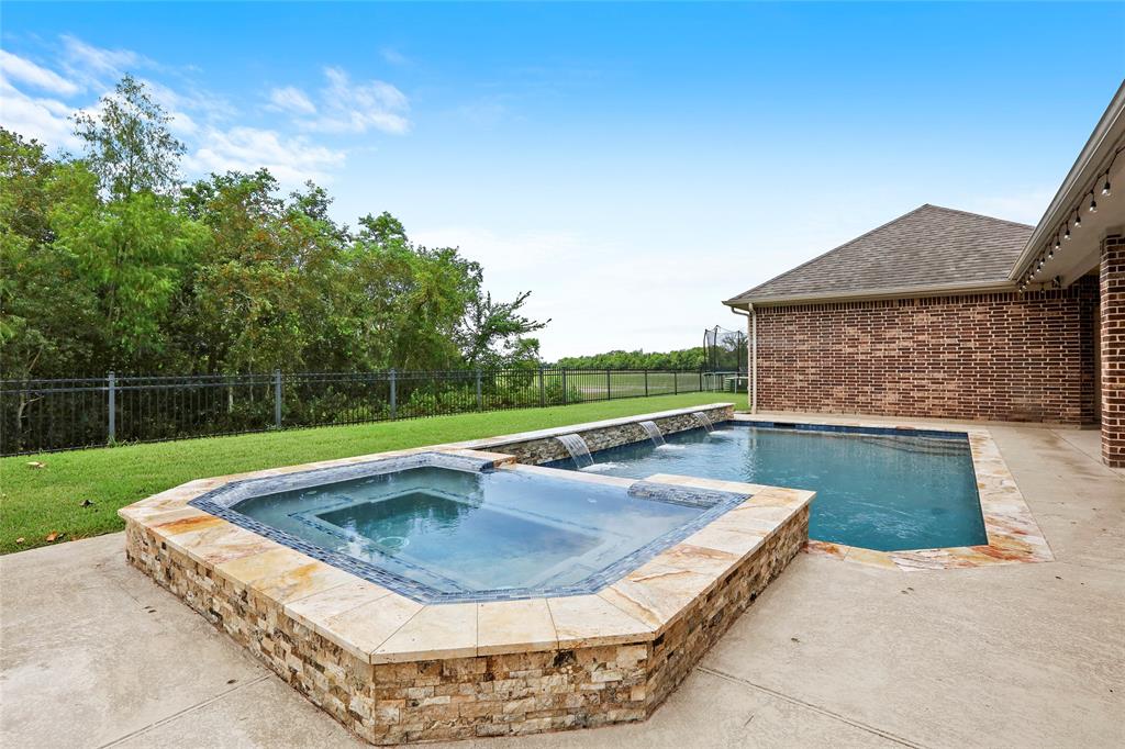

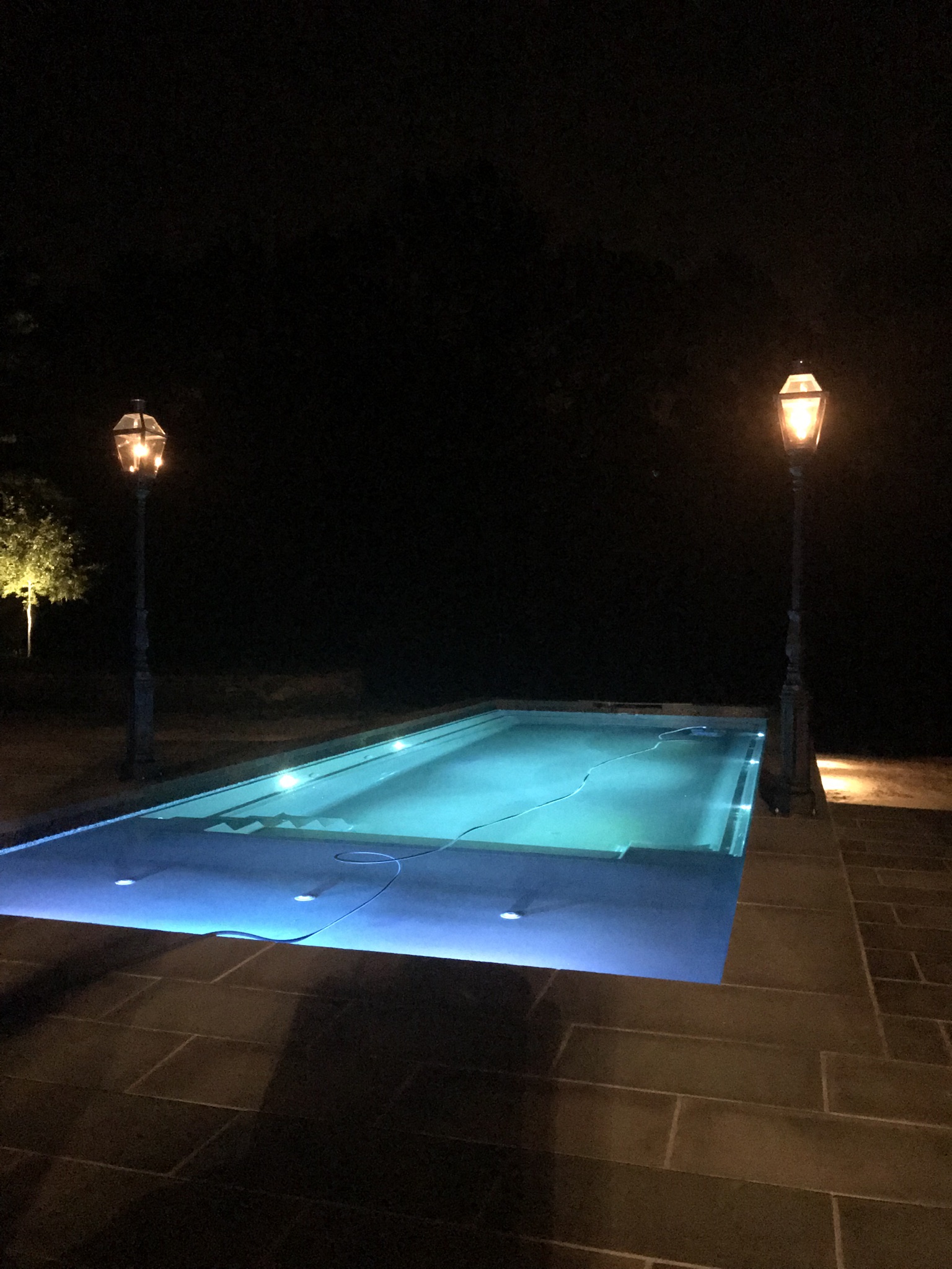

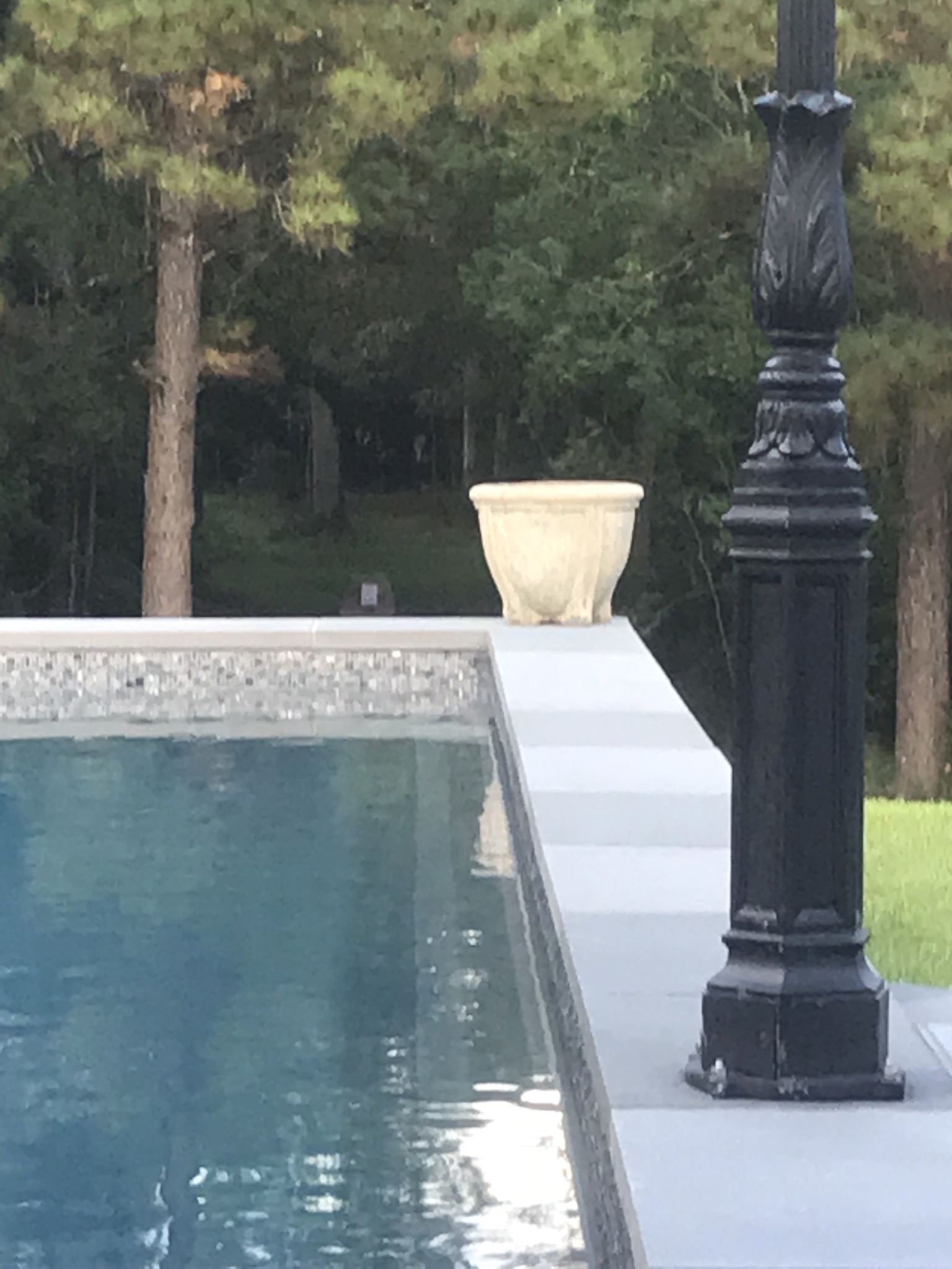

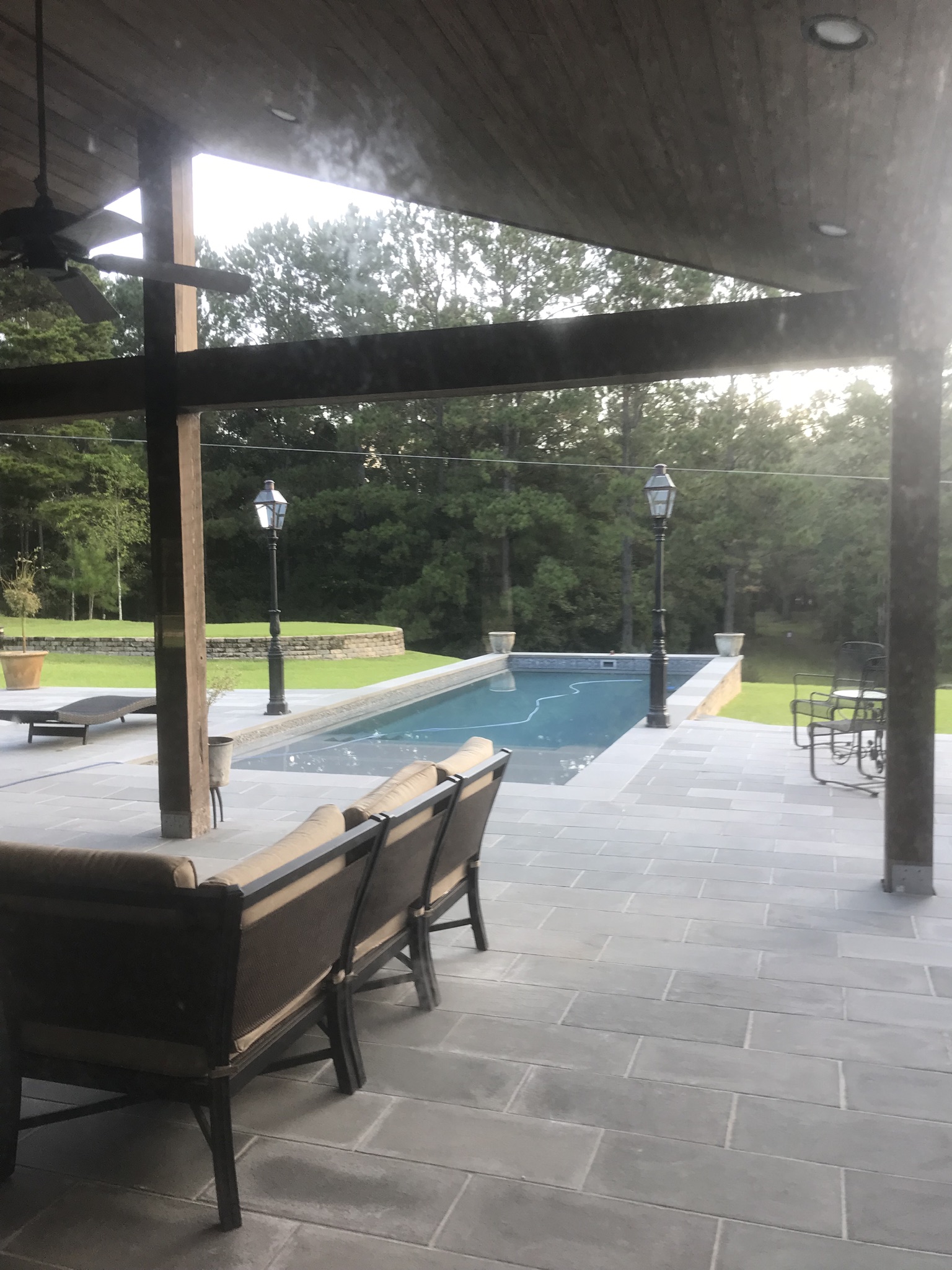

A bit over $100k here, including 1500sqft of Bluestone on the patio, gas lanterns, landscape lighting, etc... We went fiberglass, Jandy equipment with full automation, 3 water fountains, 5 spa jets, heat pump/chiller, SWCG.
My kids swim with their eyes open underwater with no issues. I check the chemicals on Saturday morning while drinking coffee and adjust a bit if needed. If you halfway keep an eye on it you’ll have no trouble.

View attachment 7138200View attachment 7138201View attachment 7138202

Damn that’s nice, that’s pretty much the exactly type pool I’m looking for and I might have to up the budget for some landscape upgrades, love those lanterns! Man this house and pool are killin me.... trying to stay at 500k for the house and pool but looks like gunna need to bump it up to 550

Thanks. The price I paid included the retaining wall and patio concrete, but I think the pool was going to be around $70k by itself. $60k sounds like a reasonable cost in this day and age.

Good choice with the bluestone. I installed a lot of it as a Stonemason. Beautiful and durable

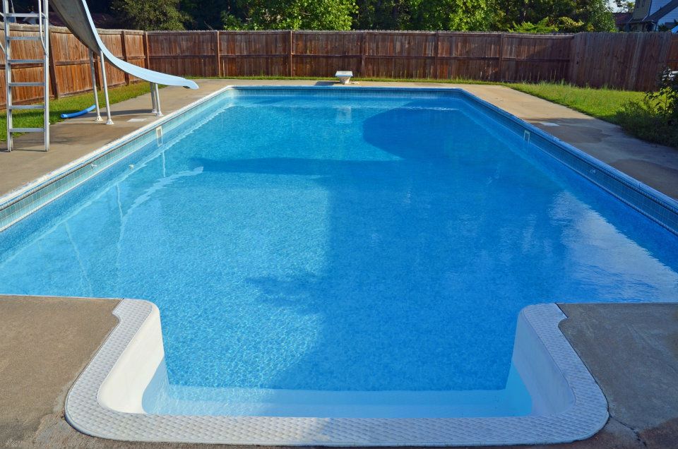

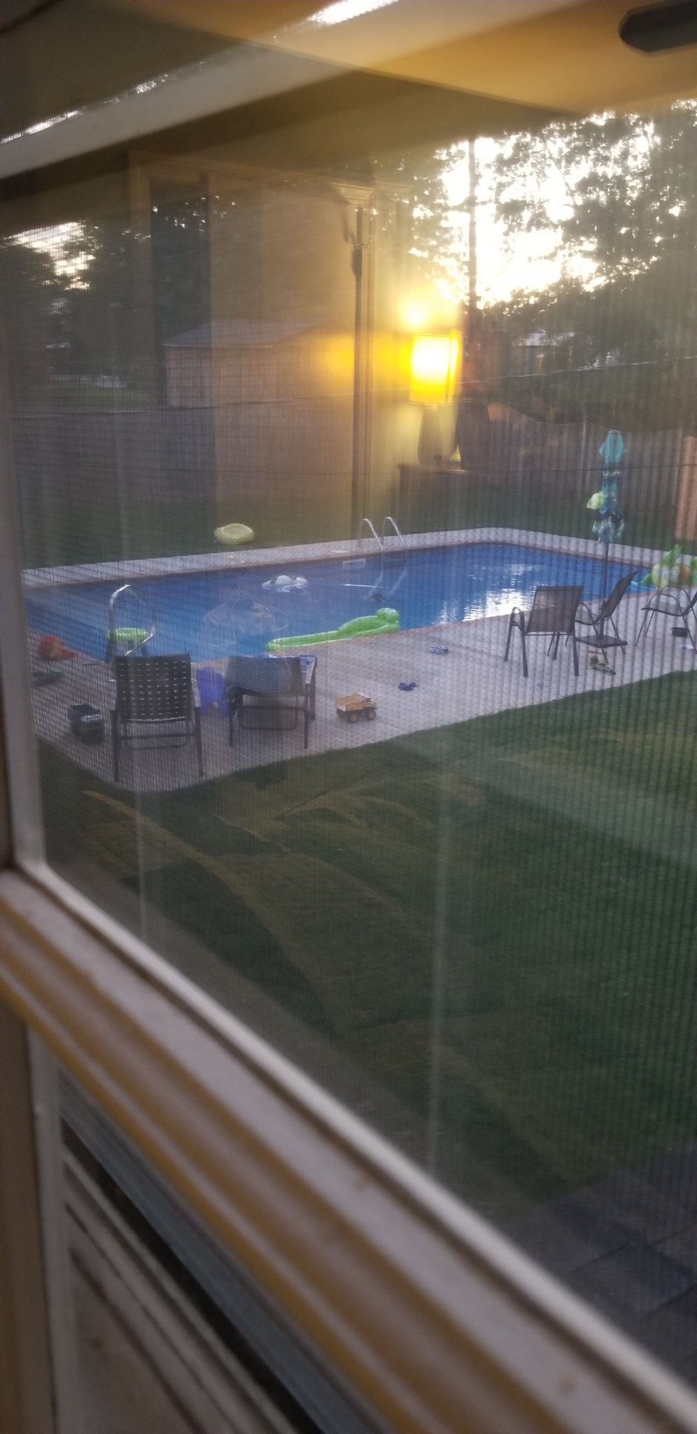

We just had one put in (dig started April 30th,was swimming June 20th)
Salt water,vinyl..16'x32' coping(sp?) And concrete decking around..ran us $40k.
I was on the fence about the salt water ,but very glad we did.
Quick pic from inside..nothing "fancy" but the family has been loving it!

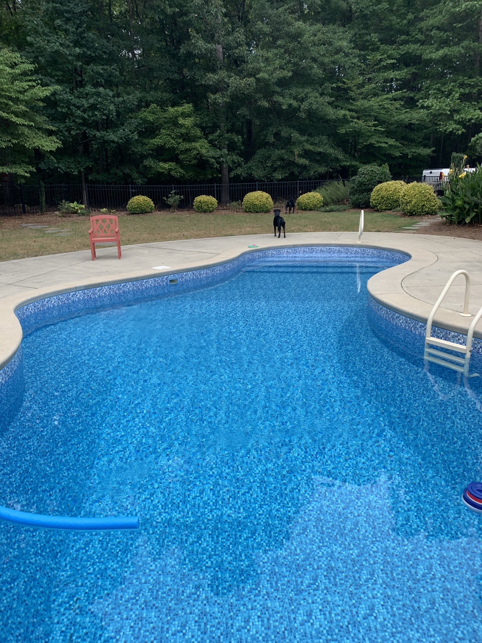

Ours is chlorine with a vinyl liner. 20x40', 30,000 gallons. I probably use 60lbs. Of 3" chlorine tabs per year and 25lbs. Of soda ash to keep the ph up. Get a chlorine feeder. Don't get a diving board. I could hit bottom in 8' of water doing a cannonball. I just removed the driving board. Get a slide, they're fun. Get the color changing led light. I think they now make steps with jacuzzi jets. Vacuum the old fashioned way your first year. Then get a Kreepy Krawley. Don't build over a spring. I think if I were building one, I would not have a deep end.

Is that patio cover already existing? One thing that is jumping out at me... More shade. I build tons of patio covers for people. In the middle of the summer it is completely unbearable to be on that deck or cooking out there without shade.
Yea, that’s the existing patio that there extending concrete from, I feel the same way about shad and temporarily we’re just gunna do canopy tables with chairs and eventually build a bungalow that extends off the patio towards the edge of the pool. The cost is too much to extend the patio roof.
