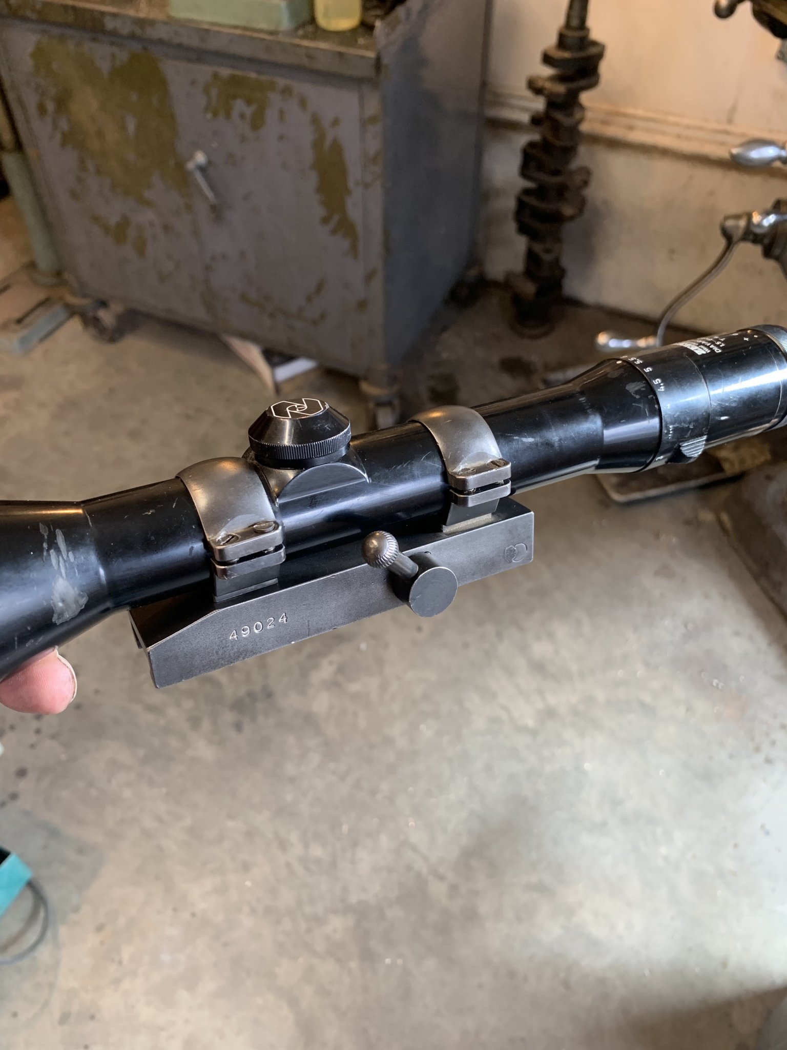

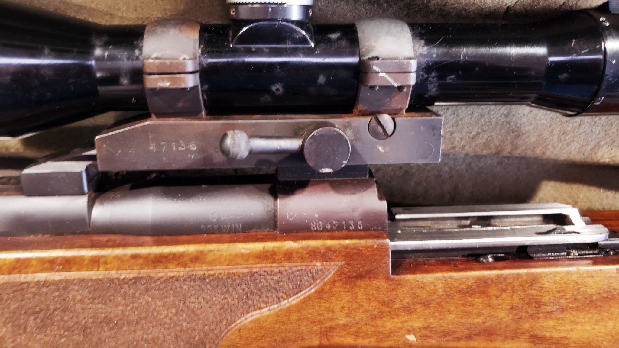

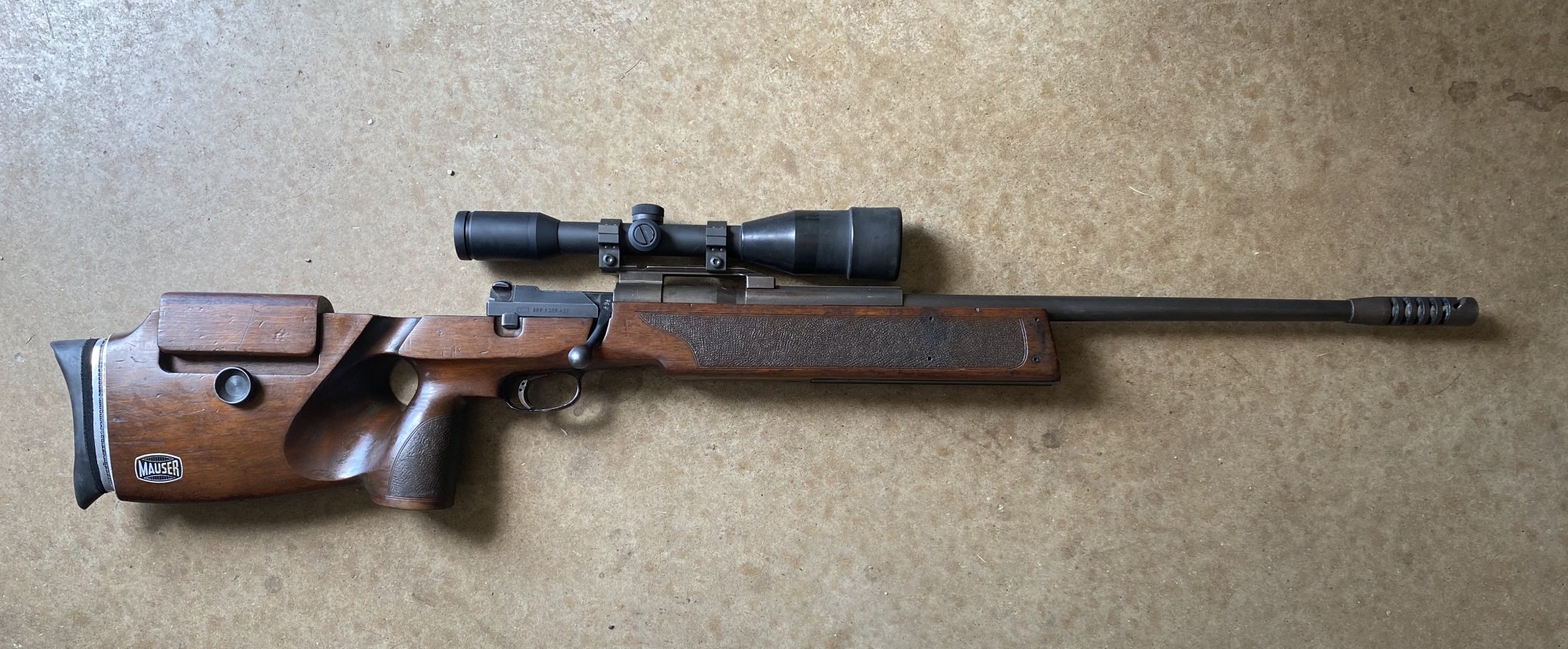

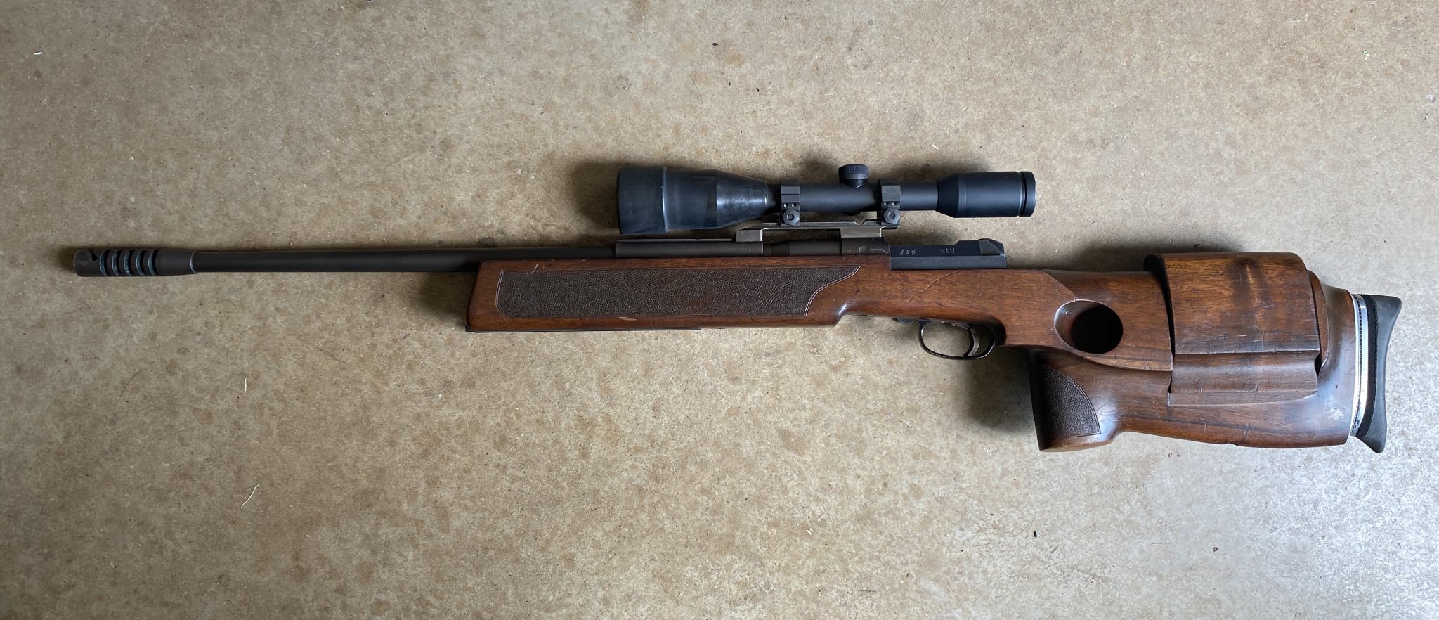

Thanks to Buffalowinter and Gol1…. Almost have the new mount restored.
More to follow… but thanks to both my friends!
(And if the scope is backwards in the mount my bad). It’s just sitting there until I mount it up. I’m not sure which way it goes until it gets on the rifle.
If anyone needs a restored photonics (see earlier photos) we can talk. Be happy to help someone complete their build!!
Sirhr

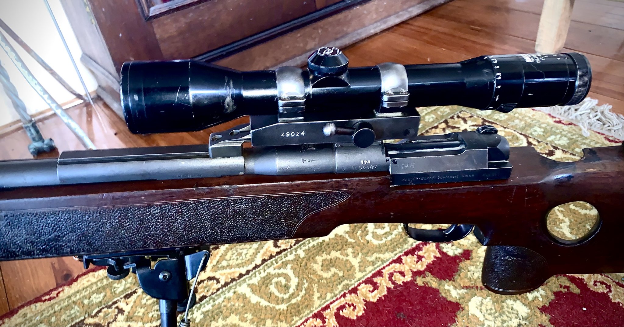

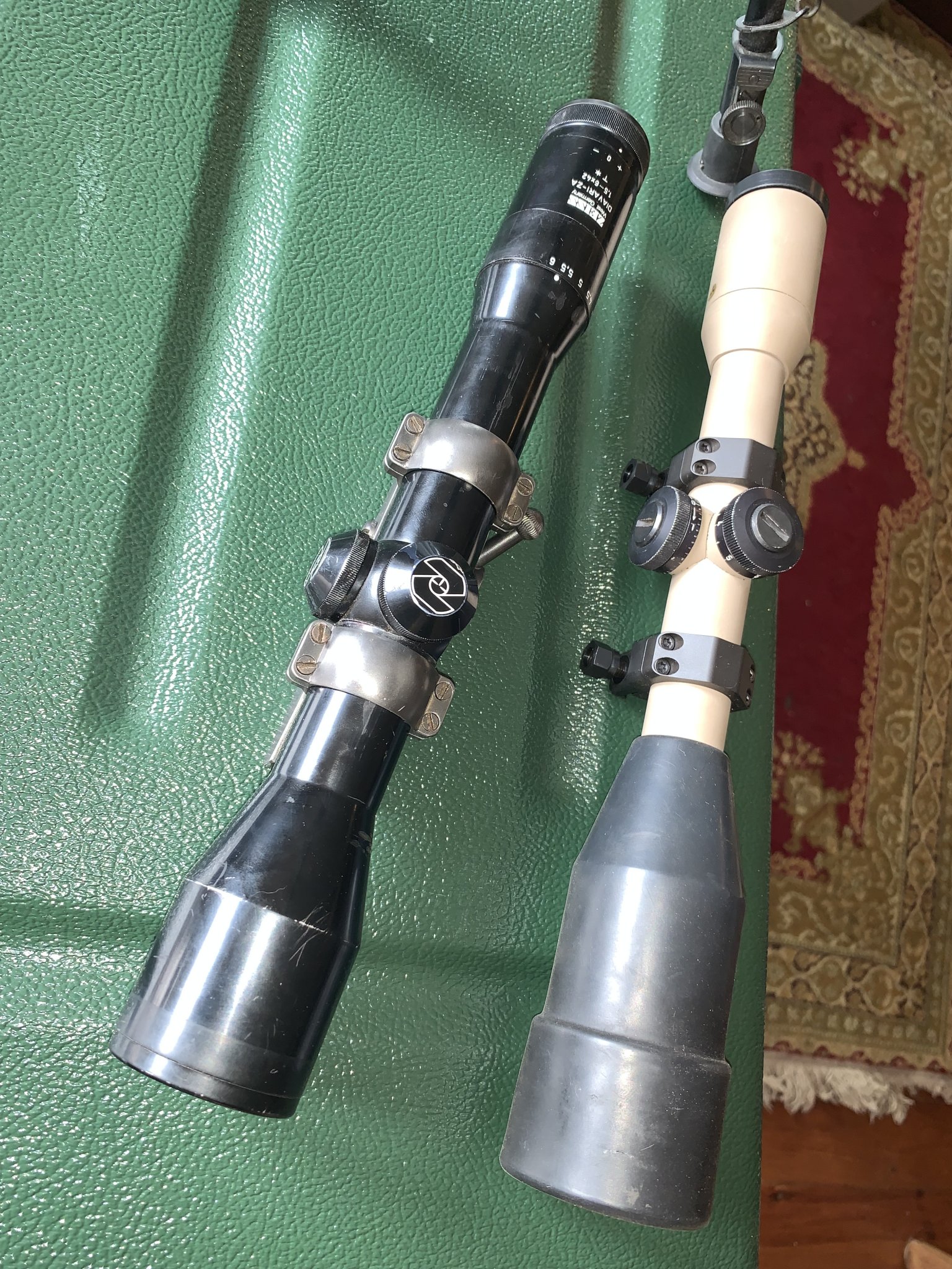

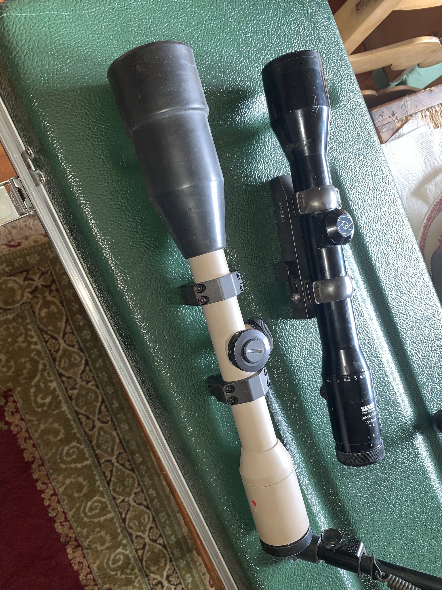

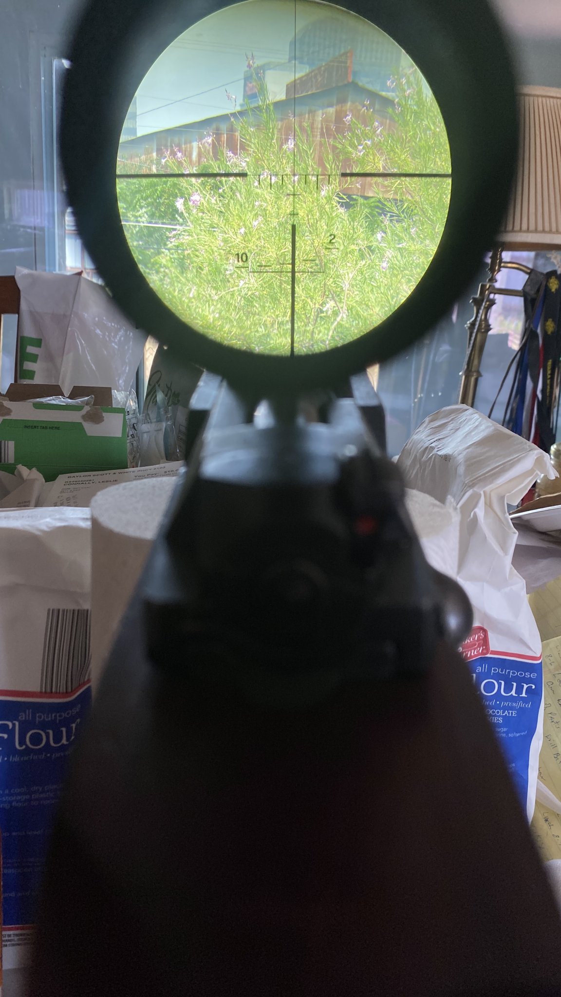

For anyone interested, Photonics vs. Diavari. Absolutely amazing glass in the Diavari. The Photonics has a very cool reticle with lots of drops. Almost an early Christmas tree. Pretty cool.
But with the mount and the Zeiss I have the perfect set up for this rifle.
Tomorrow I need to put it on the Mill for a very quick operation shrinking the thickness of a Cheesehead screw holding one of the mounts on. The original was missing and held in with some kind of Apoxsee. But I was able to make up a new one it’s just that the head is a little bit proud. Five minutes on the mill and it will lock right on.
So awesome what a restoration gets its final details right. Cheers

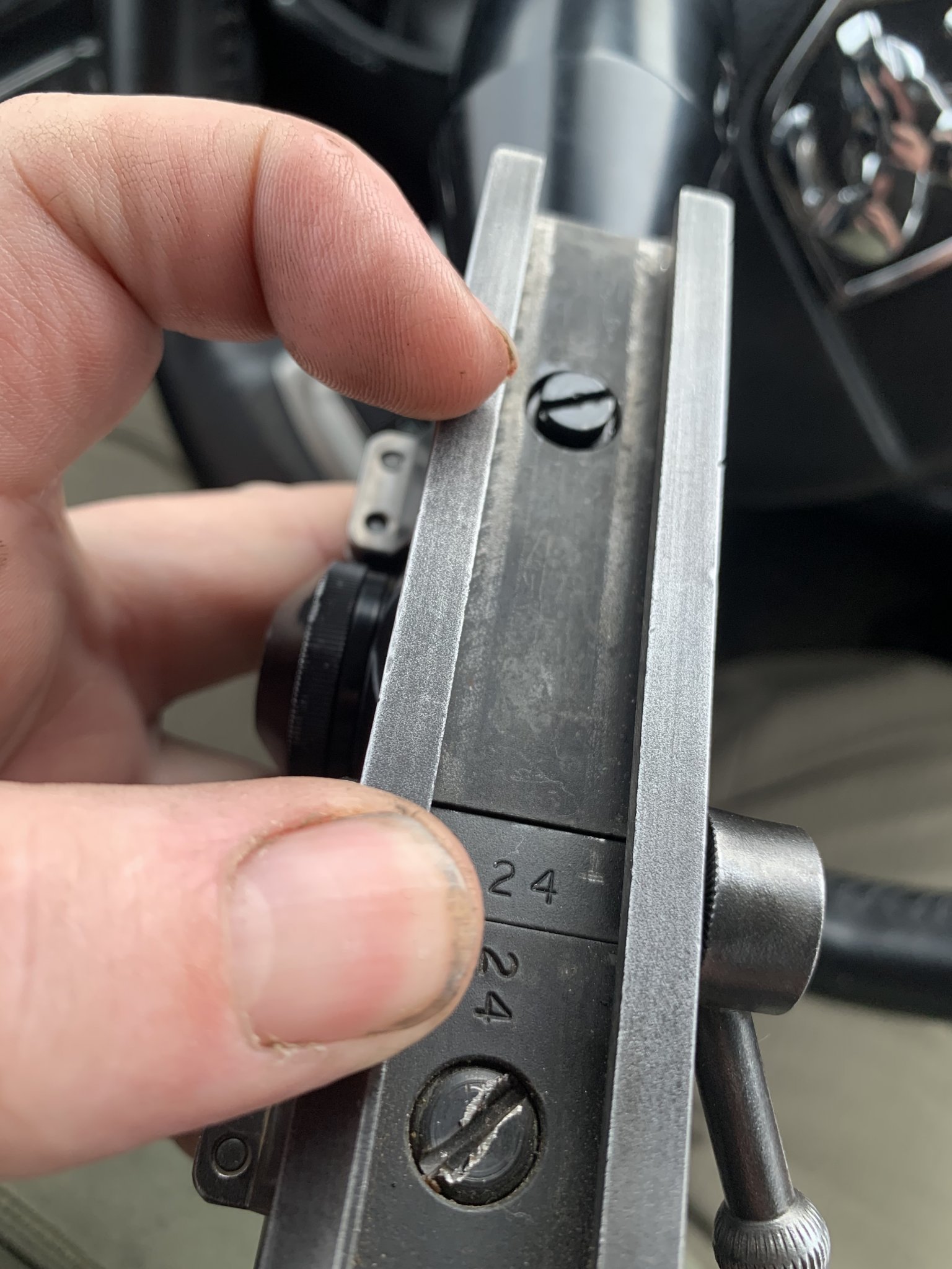

The mount I had from gol1, which he gave me, had one of the rings held in basically with epoxy. Which is fine because I just fixed it up and machined it. I was surprised to find it was a 1032 screw not a metric.
And the reason I am switching scopes is that the mount is 30 mm. The photonic scope is 26 mm. So Buffalo Winter found me a 30 mm Zeiss. Which combined with the 30 mm ex-IDF mount makes a period correct and gorgeous set up.
Cheers! Sirhr
Reactions: Troglodyte6
This is the screw I replaced. But in order to get it to work on the shoulder I needed to put a special washer I cut underneath it. Now the head is just a little bit proud so it won’t slide on the Picatinny type rail. So I just have to mill that screw head down about .050” and it will slide right on.
All easy stuff in a days work when you restore stuff!
View attachment 7831582This is the screw I replaced. But in order to get it to work on the shoulder I needed to put a special washer I cut underneath it. Now the head is just a little bit proud so it won’t slide on the Picatinny type rail. So I just have to mill that screw head down about .050” and it will slide right on.
I'm pretty sure that's a standard HK claw mount screw. https://hkparts.net/product/hk-german-claw-mount-screw-for-optics-rails-p17921.htm/
HK German Claw Mount Screw For Optics & Rails​
$3.95
HK German rail screw that is used on the HK claw mount to add an optic such as a Hendsoldt or Stanag optic to the claw mount. The screw is used German surplus manufacture but in perfect shape for use on all HK style claw mounts.

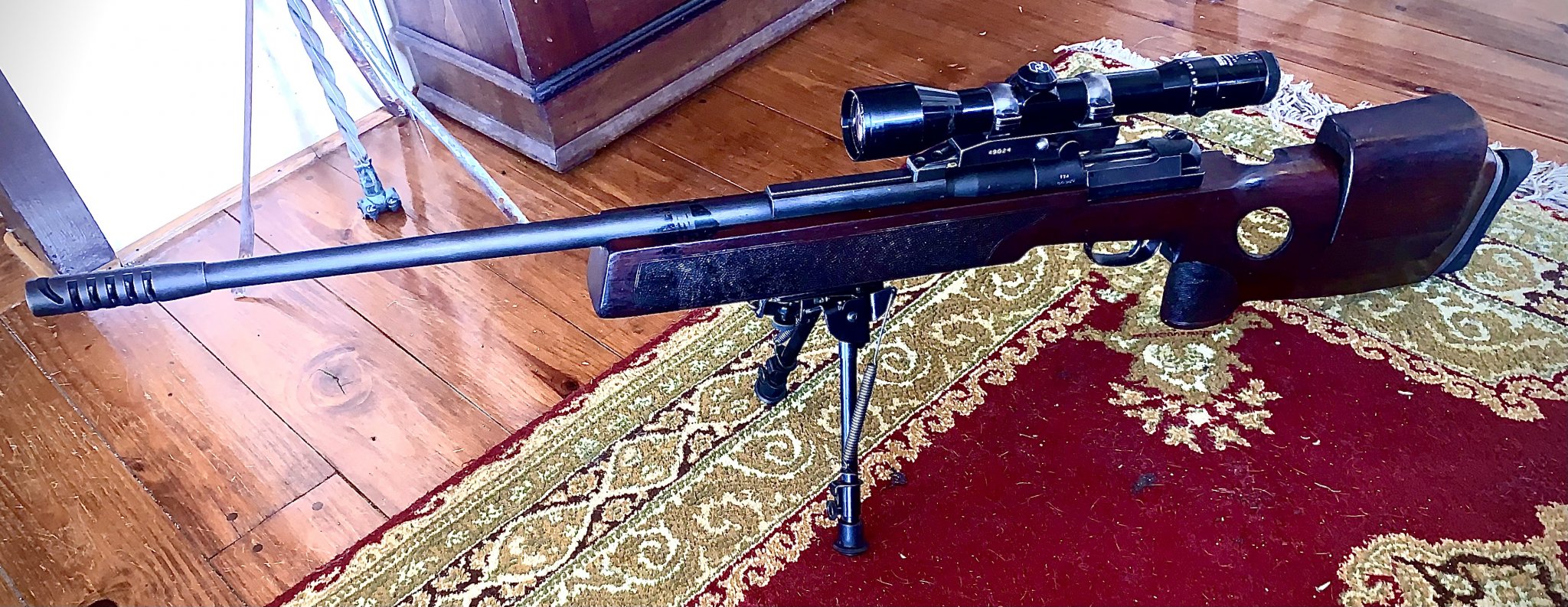

That's looking good. Now to get them sighted in.
I had the Photonics sighted in. Shot a bit above MOA with 'whatever' ammo was handy. I'll get this sighted and work on a load. It's not going to be a .3 MOA rifle. But I will get it under 1 for sure.
It's outstanding and such a great piece of firearms history and, well, quality.
All a testament to help from my friends here, too!
Sirhr

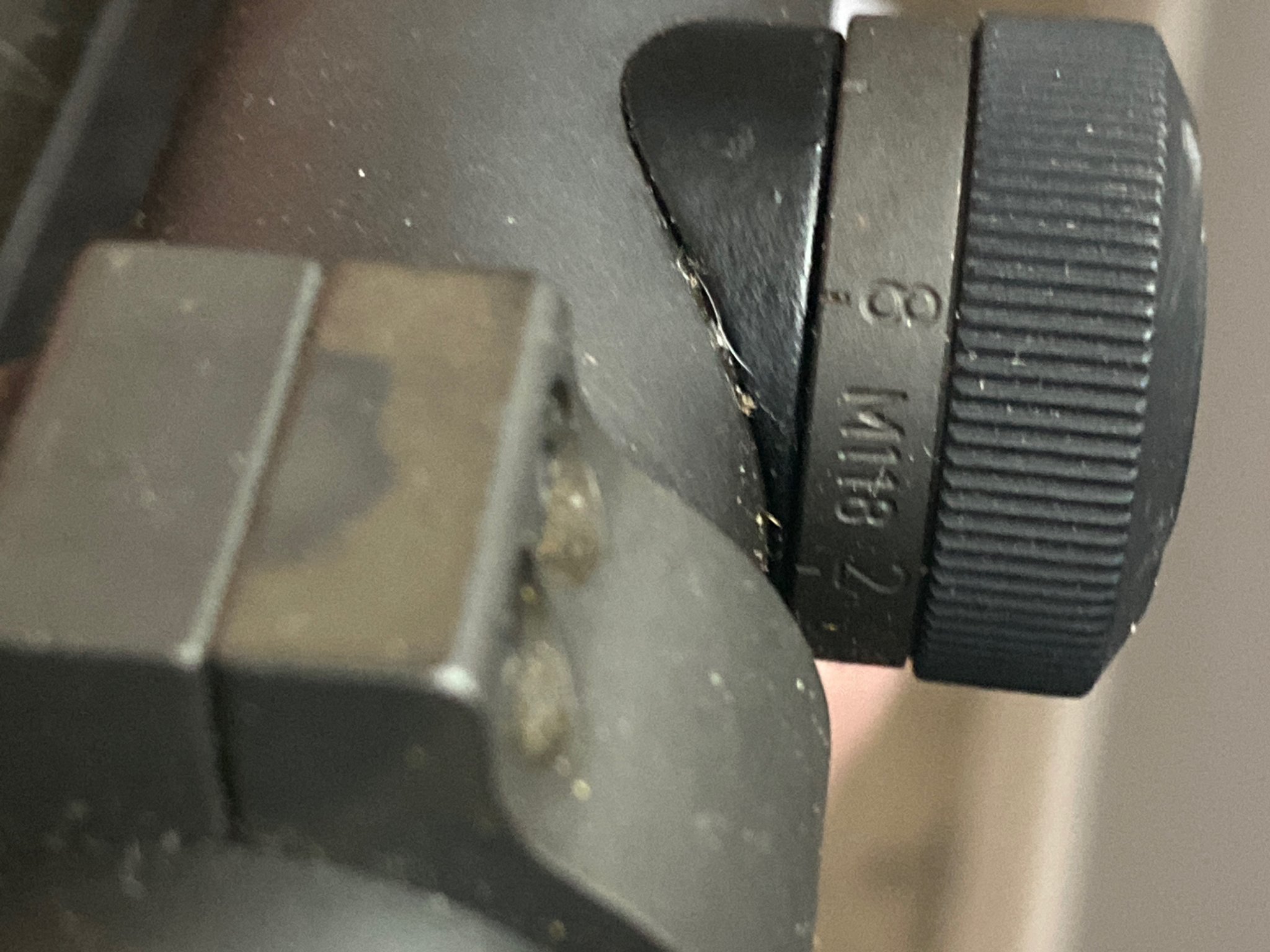

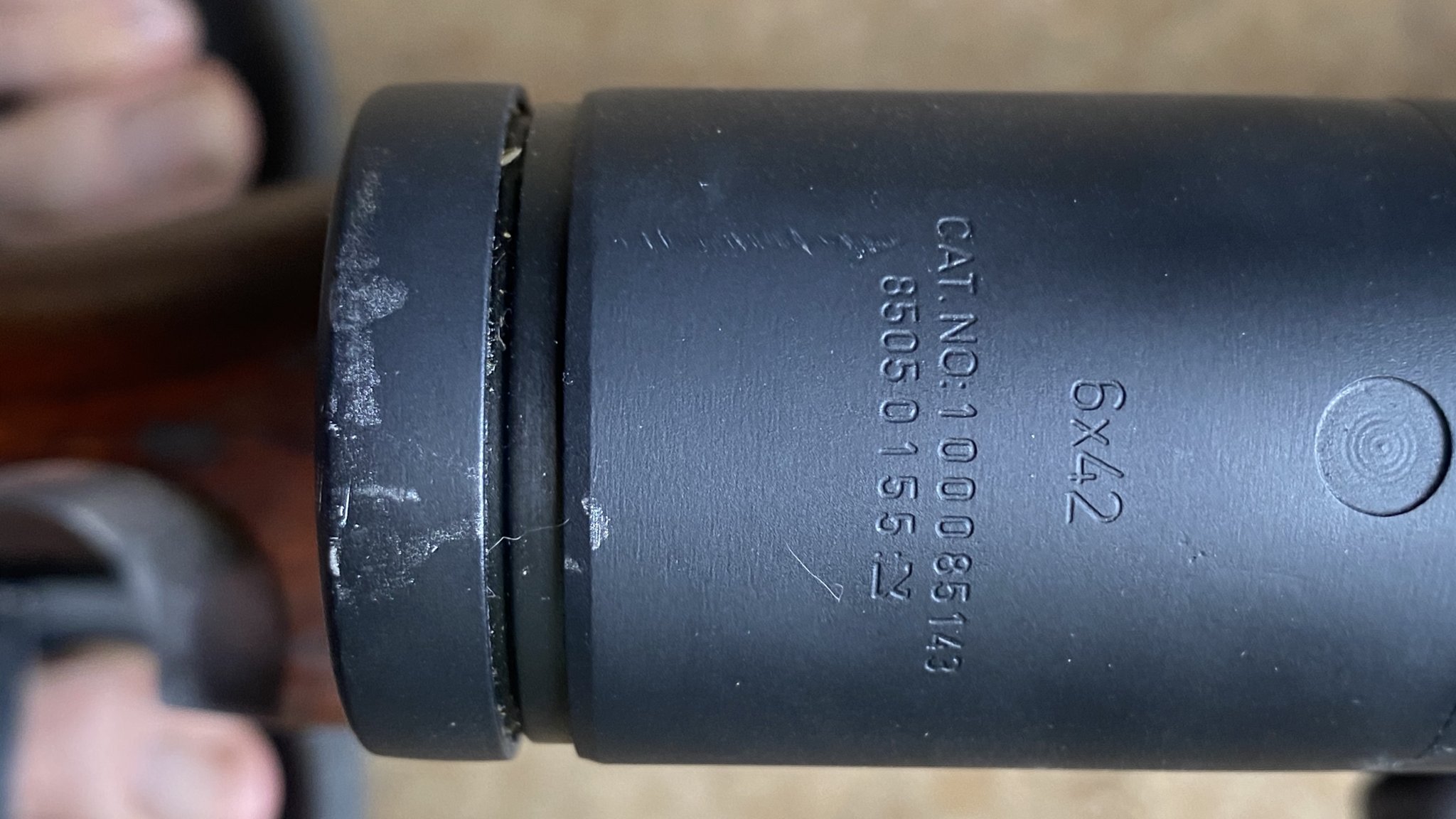

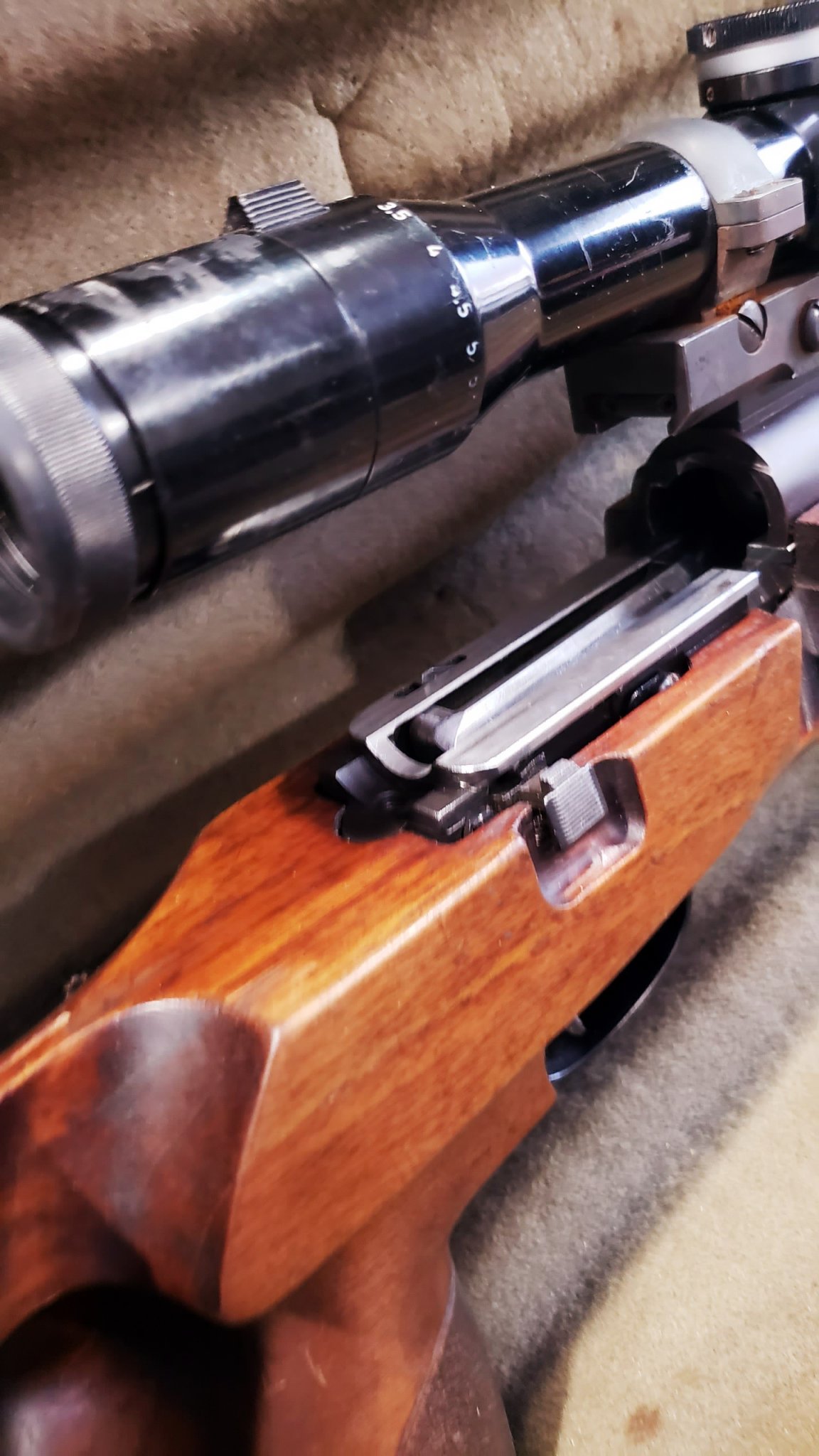

Got some good news today. He found the original scope and a bunch of magazines for the NDM, as well as a scope he thinks came with the Mauser, so I am waiting for some photos to confirm what it is and hoping to pick it all up tomorrow.
edit: Only got this crappy photo, but it looks like the correct Photonic scope.
Check the elevation turret. The one marked M118 is correct, the one with M14 isn't, but it's an otherwise identical scope and so will look the part. The former is for 175gr rounds, while the latter is for 168gr. Copy Sirhrmechanic's restoration technique described on this thread.

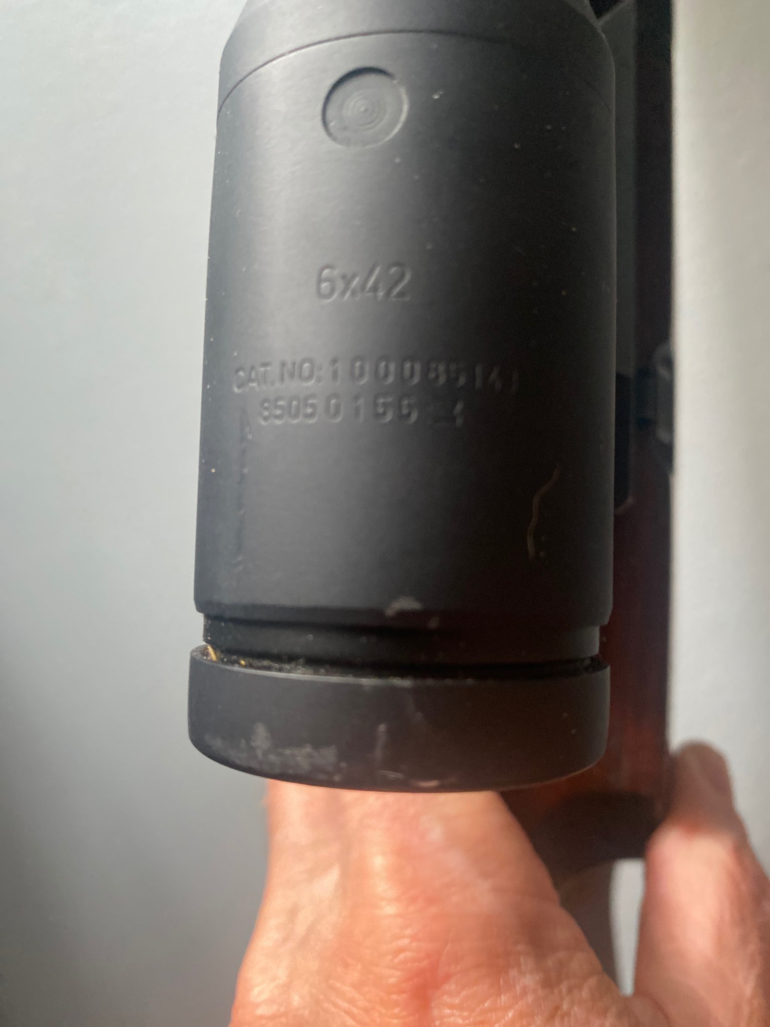

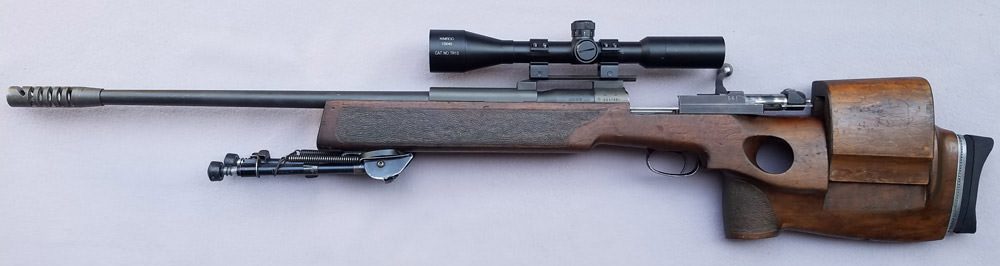

Quick note re chronology of the 6x IDF optics based on their M14 sniper rifles, which I think carried over to the M-66 as well.
1. The Nimrod was adopted in 1984 and used until about 1994. (attached is pic of one of a M-66)
2. The Swarovski Futonic (also 6x) was adopted in 1994, and I suspect used during the 1990s. It sounds like they were ultimately replaced with the S&B 2.5-10x on 'late' M-66 rifles, but I don't know what year though. It's possible that some IDF units used the fixed 6x, and others the variable 2.5-10x.
Many of the IDF scopes were refurbished and painted flat black at some point, but the 2nd picture shows what they looked like originally - note the little yellow 'radioactive' marking to denote that the reticle originally used tritium to glow, which likely stopped glowing 15 or so years ago. Just an fyi.

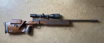

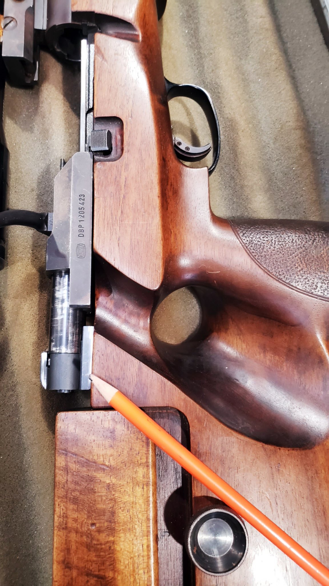

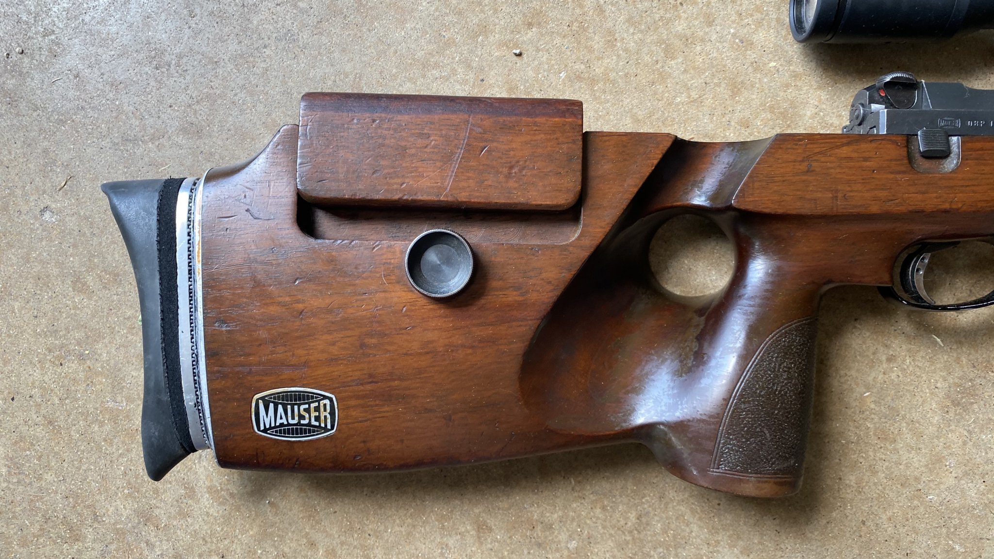

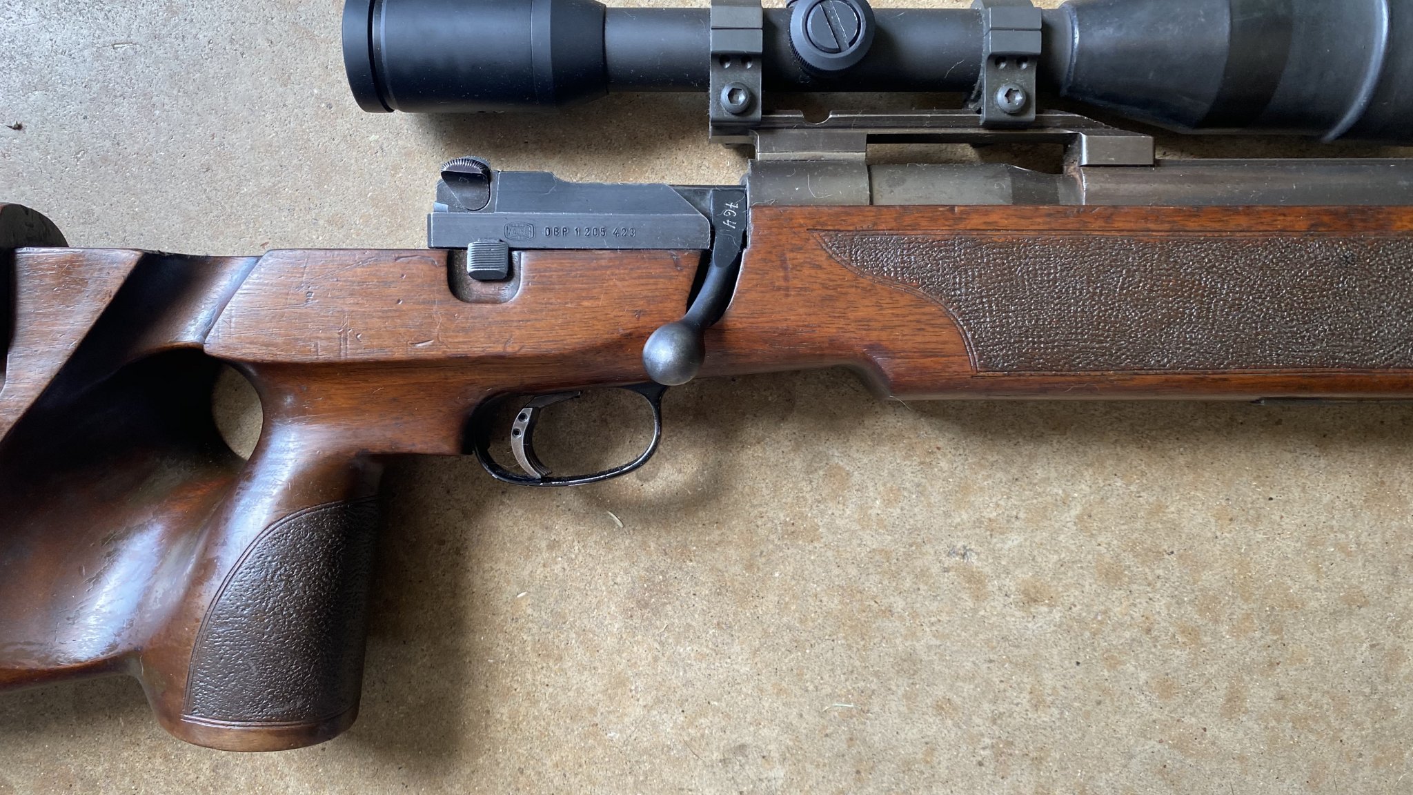

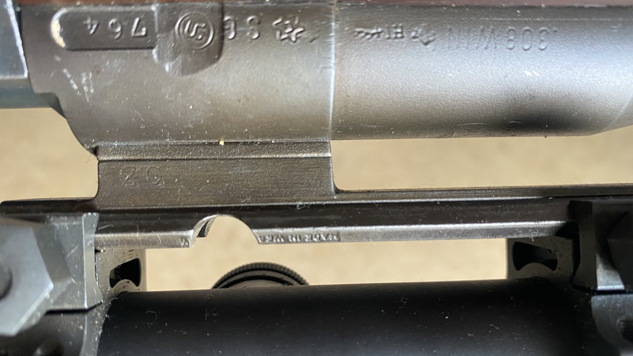

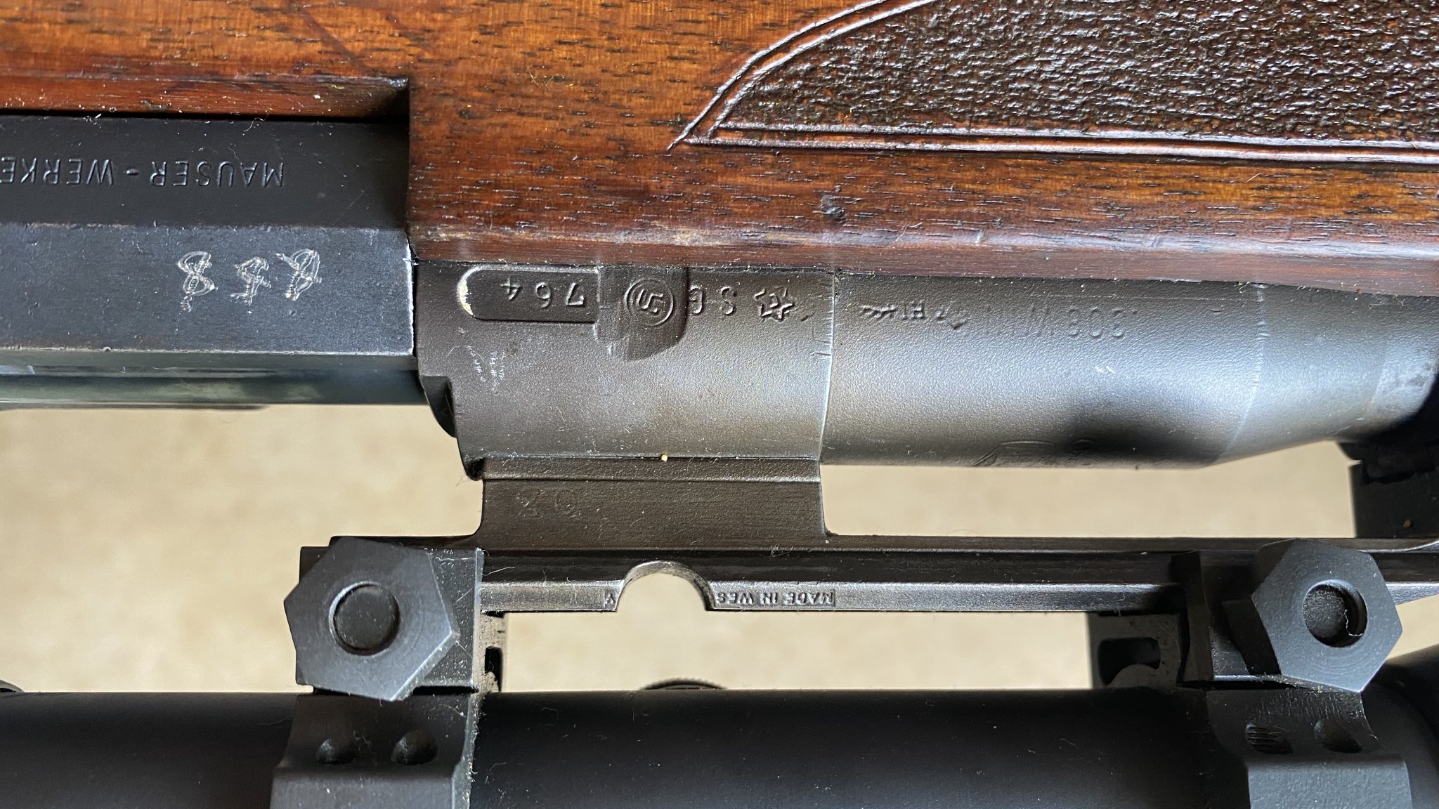

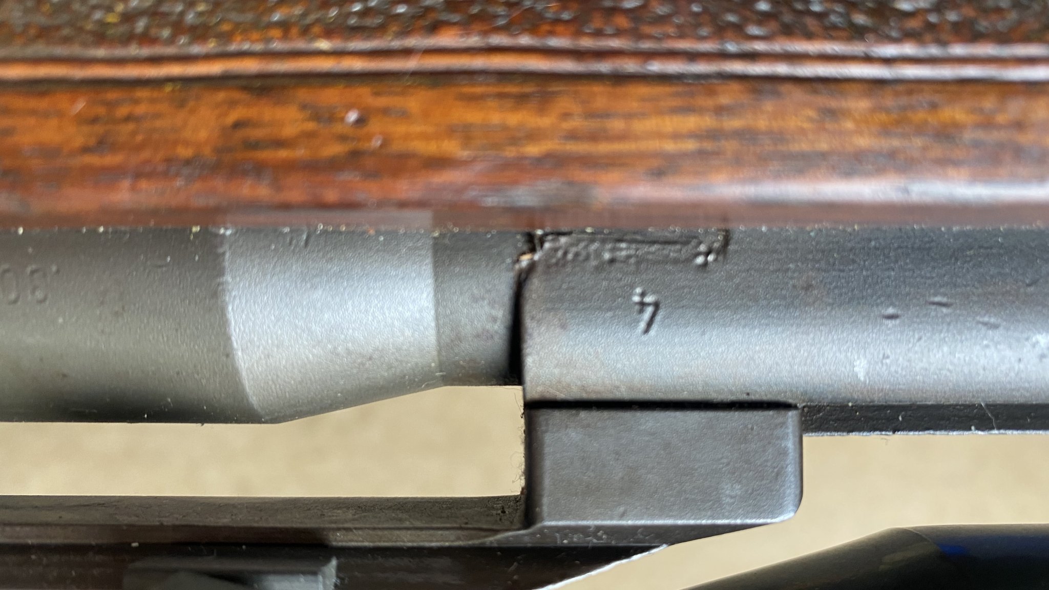

What a great thread here! I am yet another IDF Mauser SP66 owner here. I bought mine online from one of the gun auction sites back around 2005(?). Enclosed are a few pics. Seems to have the Photonic scope. Not the QR mount. 6x42 w Cat #. Etched component numbers.

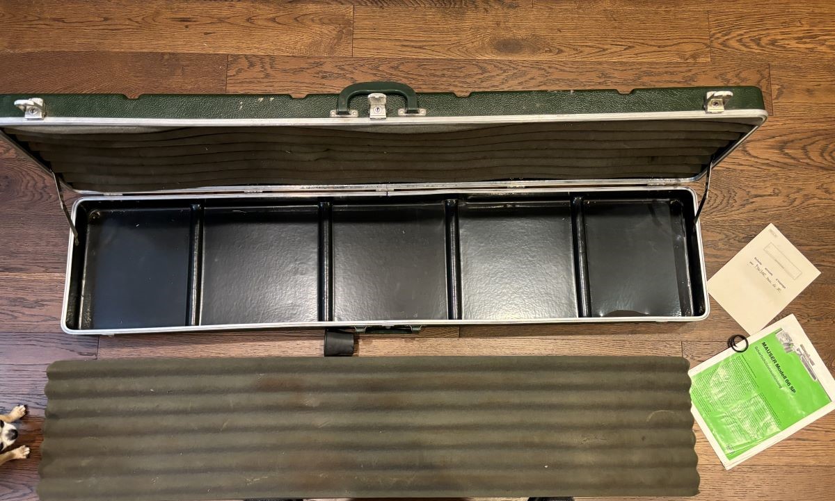

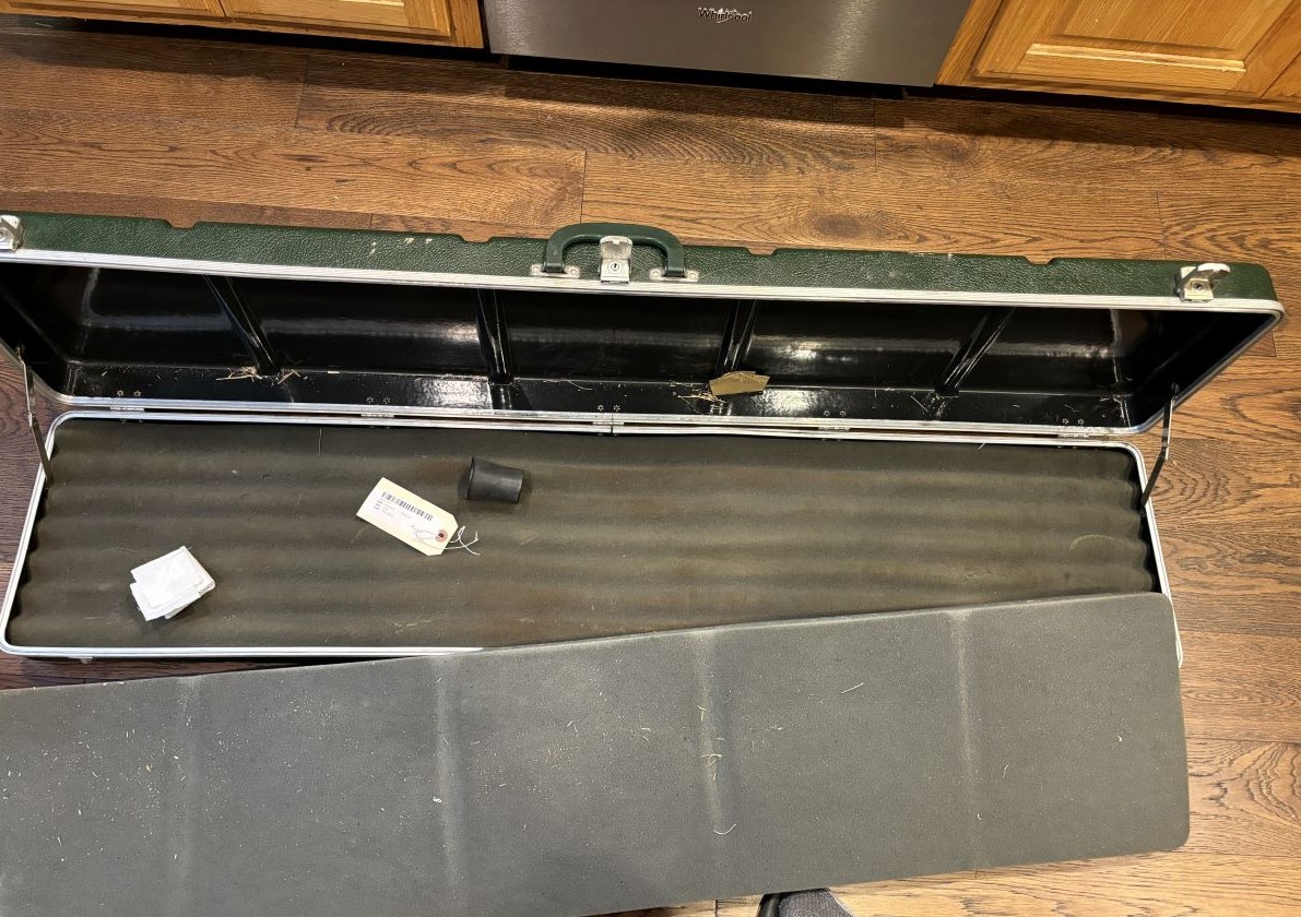

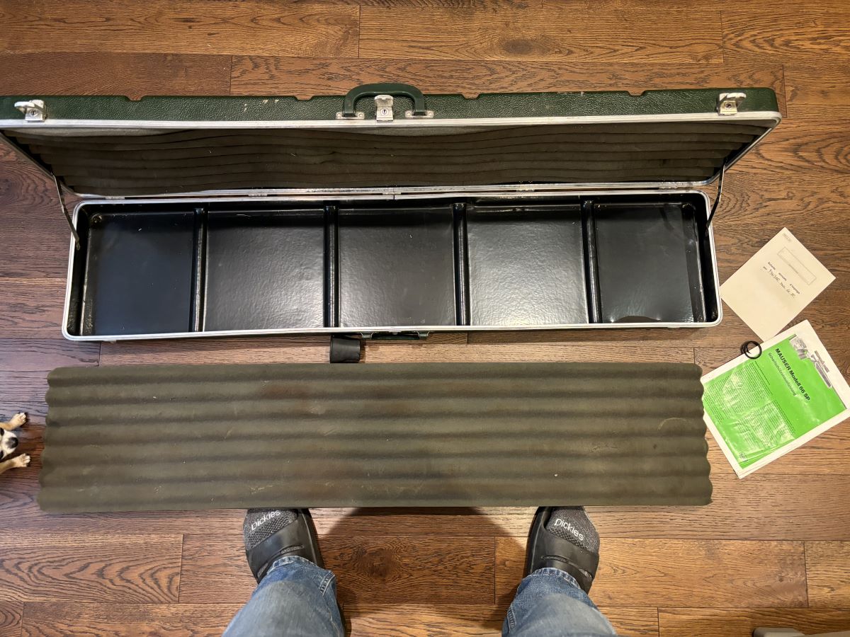

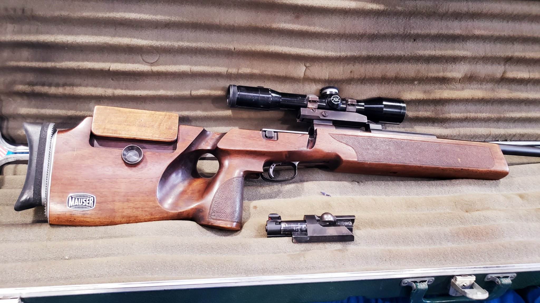

Hi Folks...
It's not marked, but I am pretty sure this is a correct Protect-O-Kaddy green case that went with the Mauser SP-66.
Looks in good shape, about commensurate with its age. The latches look right. For the price, this would make someone a nice addition to their Mauser!

Wow. It's almost been a year with no updates to this thread.

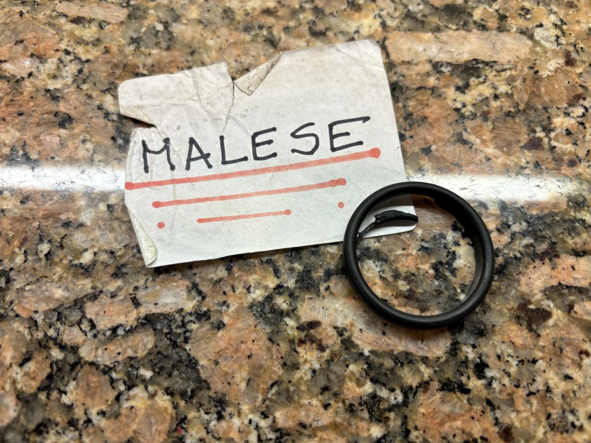

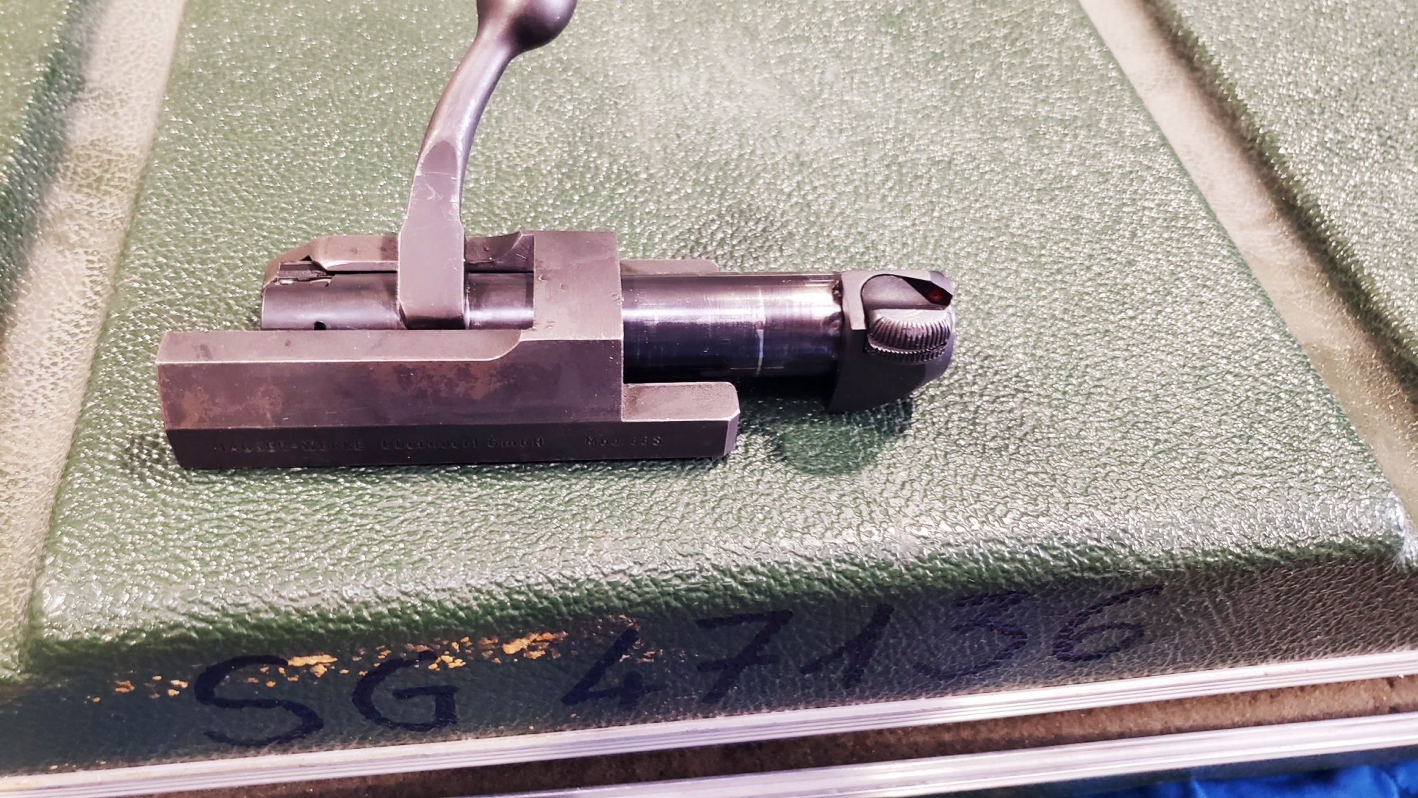

While taken some pictures of my sp66 case for Troglodyte6 yesterday, I found all this under the foam inserts.
Trash, cleaning patches, shot record log, sp66 description pamphlet, old scope rubber piece and an old name tag.
After some translation. It looks like this rifle was fired 225 times out of 6000 times in 1993. and 385 times out of 6000 in 94.

Good morning - hands down, this is the most informative source I've found on the Mauser M-66 SP. Prior to my simple NOOB question, I wanted to thank you all for your content. Difficult to source information for this rare model (360-500, in total).
Add me in as a grateful owner of this iconic former Italian Carabinieri rifle, from Atlantic Firearms, 4 years ago. It was in excellent shape, upon delivery, and only had a chance to oil it & store before I went overseas. Arrived home, and went to finally examine it closely. This was prior to finding this thread.
I easily removed the sliding bolt mechanism & it was well preserved (forgive me as I lack the proper technical terms).
I tried to reassemble it, unsuccesfully. I read the Mauser manual online and in this thread above. Figure #5 show armorer removing firing pin. As for assembly, it states to reverse the steps. That's it. I had planned to go to the range and waiting on someone kind enough to walk me through how to re-install the bolt carrier slide package. Any assistance would be greatly appreciated. Here are a couple photos, with bolt removed.
I am not sure if have to press in the firing pin (remain alert to spring tension) as I rotate the safety at rear, so it rotates the small fin pointing down. Fin is obviously blocking carrier from sliding forward. Yes, go ahead & say it, lol. I'm the numbskull that is dumbing down the gene pool. I Boy Scout promise I will educate myself further, take an armorer, find a local mentor and purchase proper tools. I need some help right now.
*Btw, I noticed the serial numbers were only 5 numbers away from the gentleman here that picked his up from the same source. I'm honored to be a student of this forum. Thank you.
YOU DISASSEMBLED THE BOLT?! You're a braver man than I. Angels fear to tread that ground.
Scan this thread to find the post @sirhrmechanic made about his work on his bolt. He's probably the only person around with the brains, skill, and (now) experience to do that correctly. If his post gives you what you need, success! And you'll be expert #2. If not, shoot him a PM, and I'm sure he can help.
Good luck! Please let us all know how it goes.
