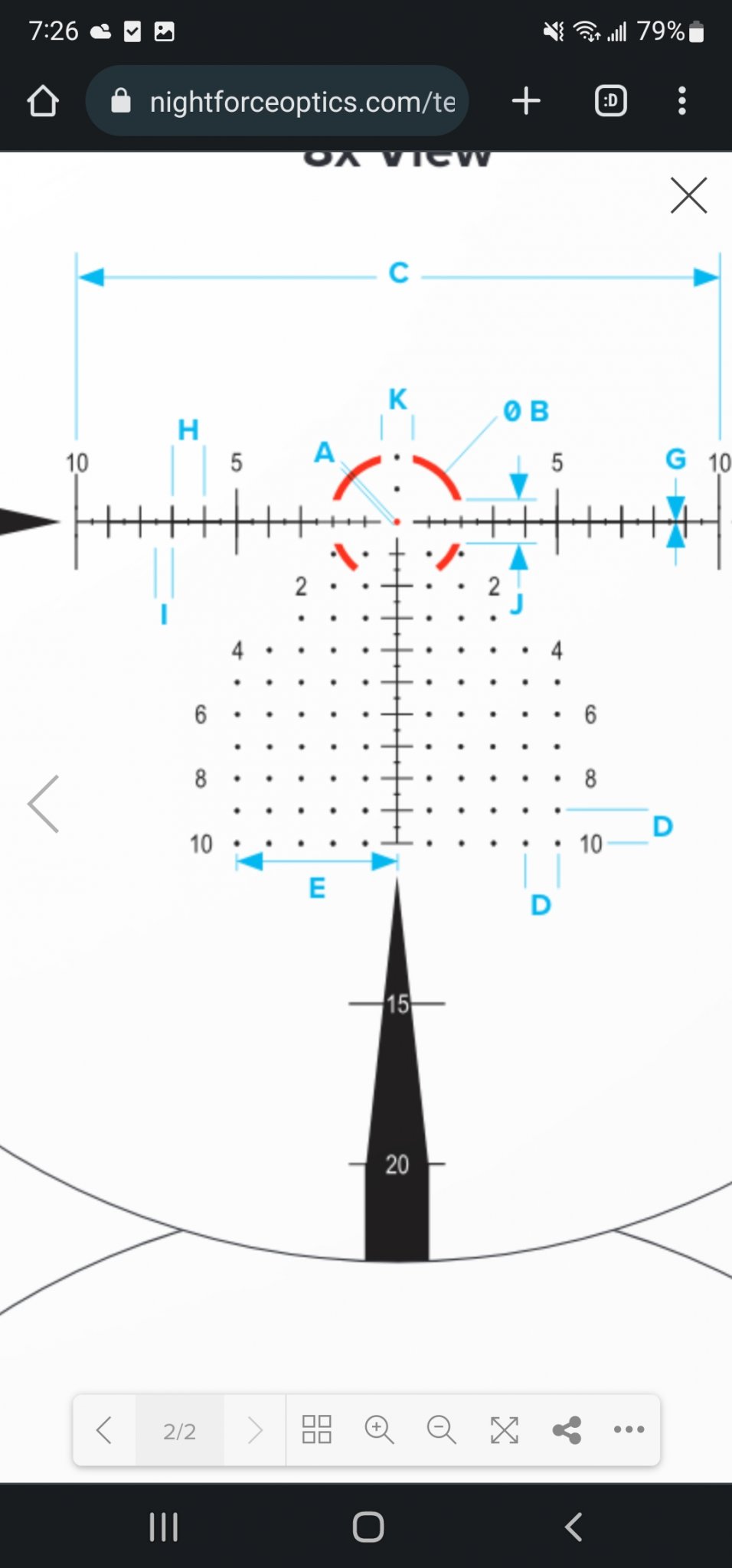

For me, I'd change a couple small things in the atacr with the fc-dmx
1-get rid of the hold under dots.
2-cut the thickness of the outer ring in half. Without illumination the circle dot isn't visible at 1x anyway and with illumination they are a bit too thick and can turn into a blob instead of a circle dot.
3-Get rid of the second mil Windhold at the 1 mil mark
4-Widen the fov. I'm not talking going from 95 or whatever fov to 150. But I think an increase to 100-105 houldn't be an issue. This is the most minor gripes though
Screenshot attached for reference
