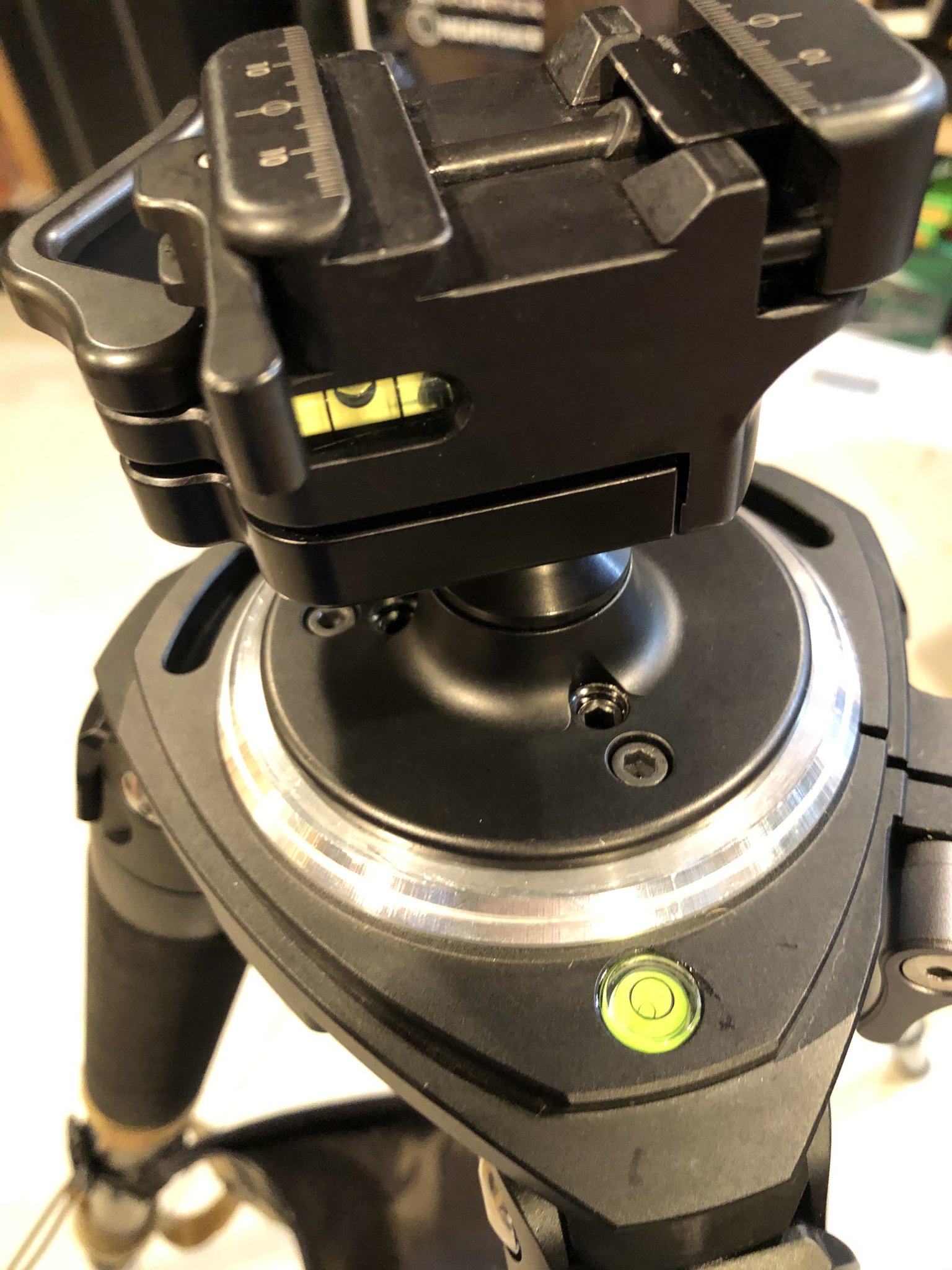

i added the leofoto long handle w/hook to my rt90c. Figured were so many people trying to fit numerous leveling bases. This one fits & functions great. Pics should show exact model number if anyone is interested.
Im curious who else tried this set up out? Pricing on the Leofoto head isnt bad.

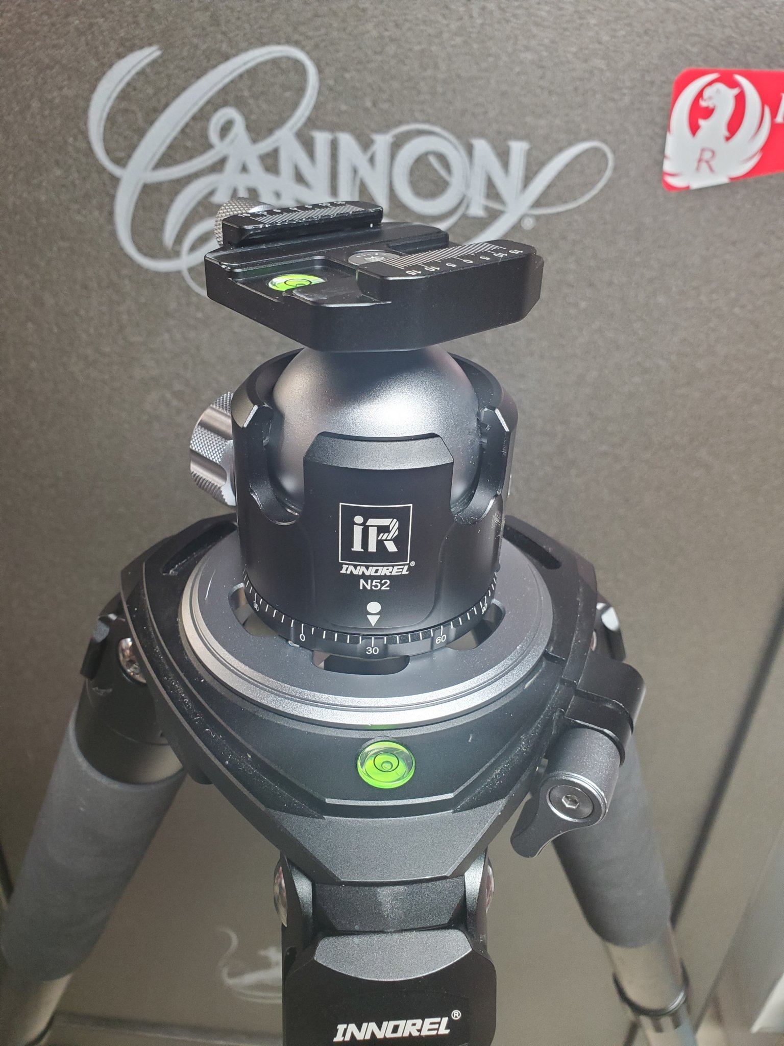

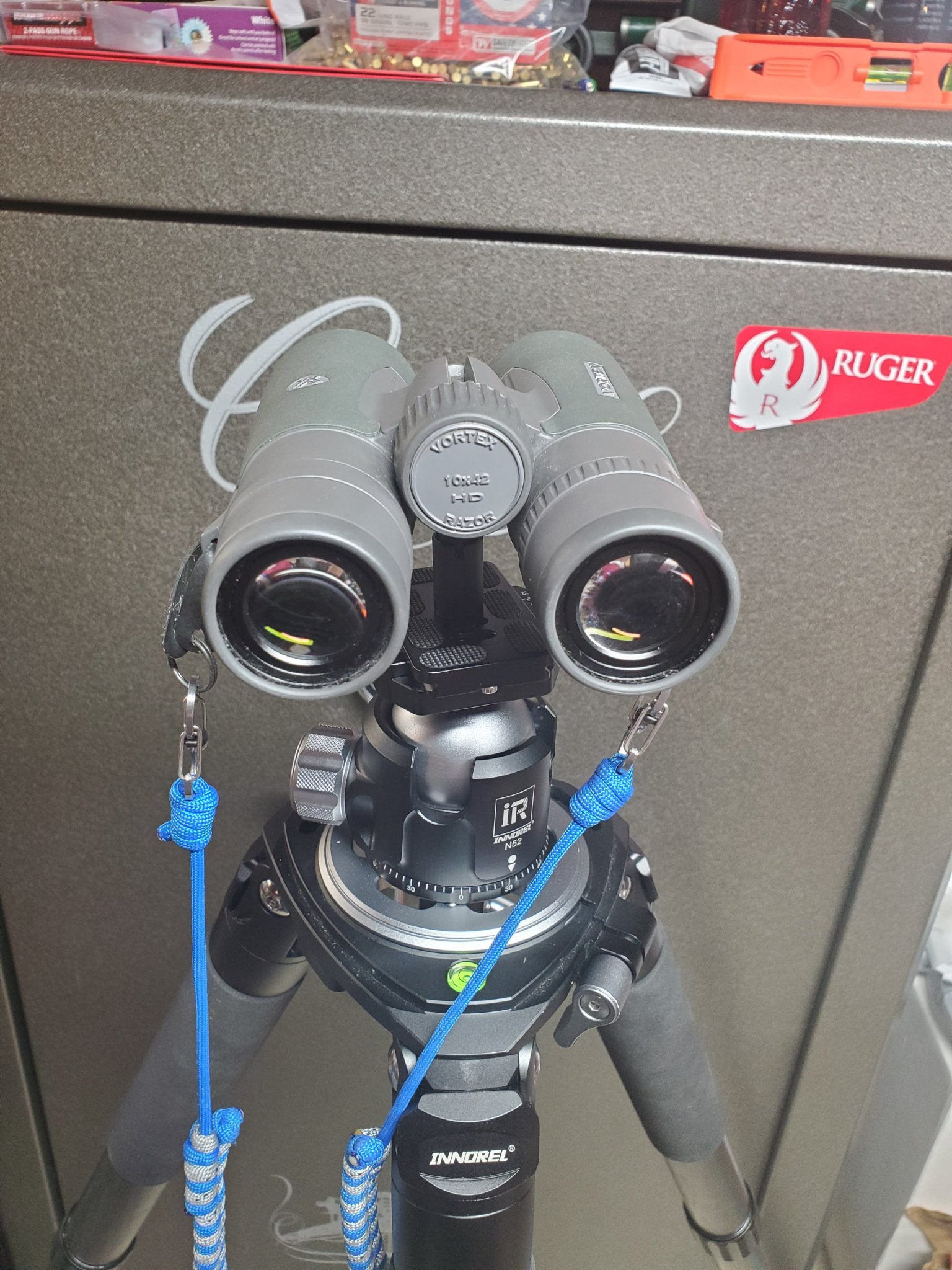

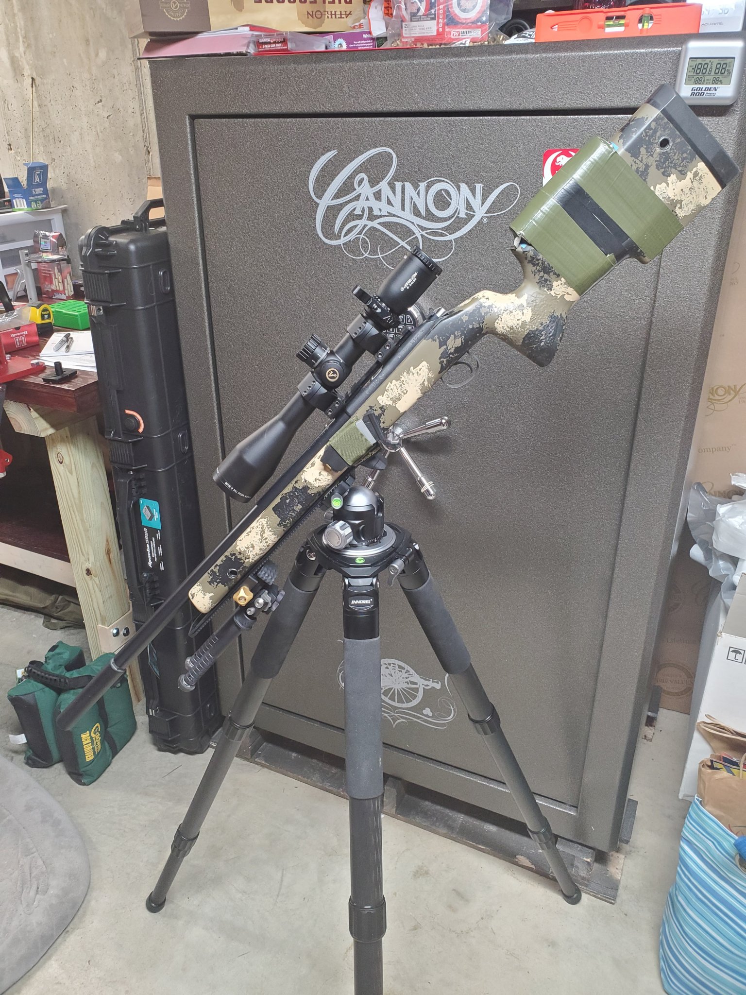

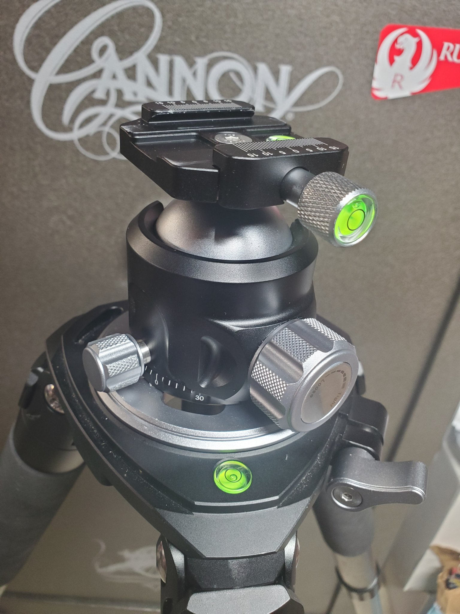

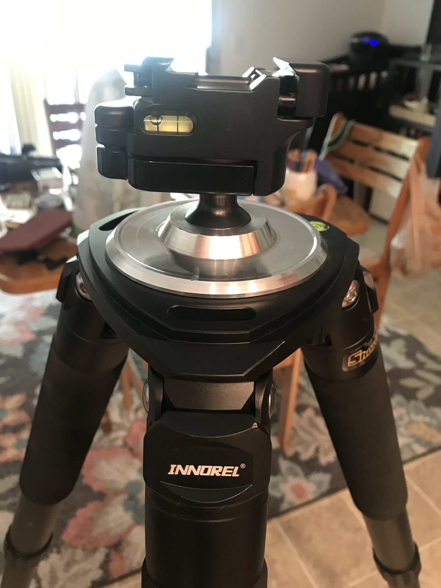

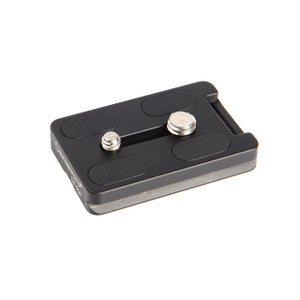

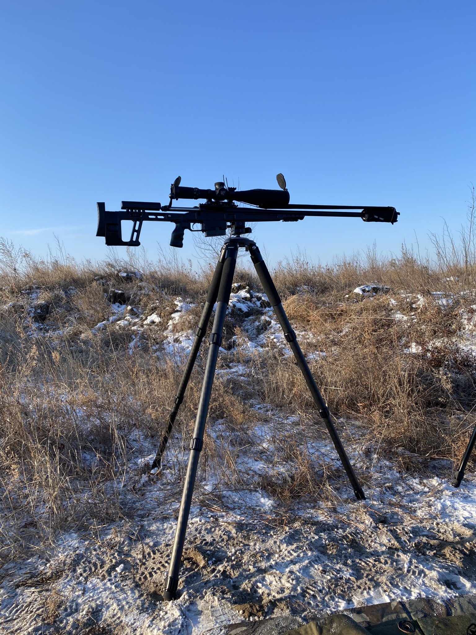

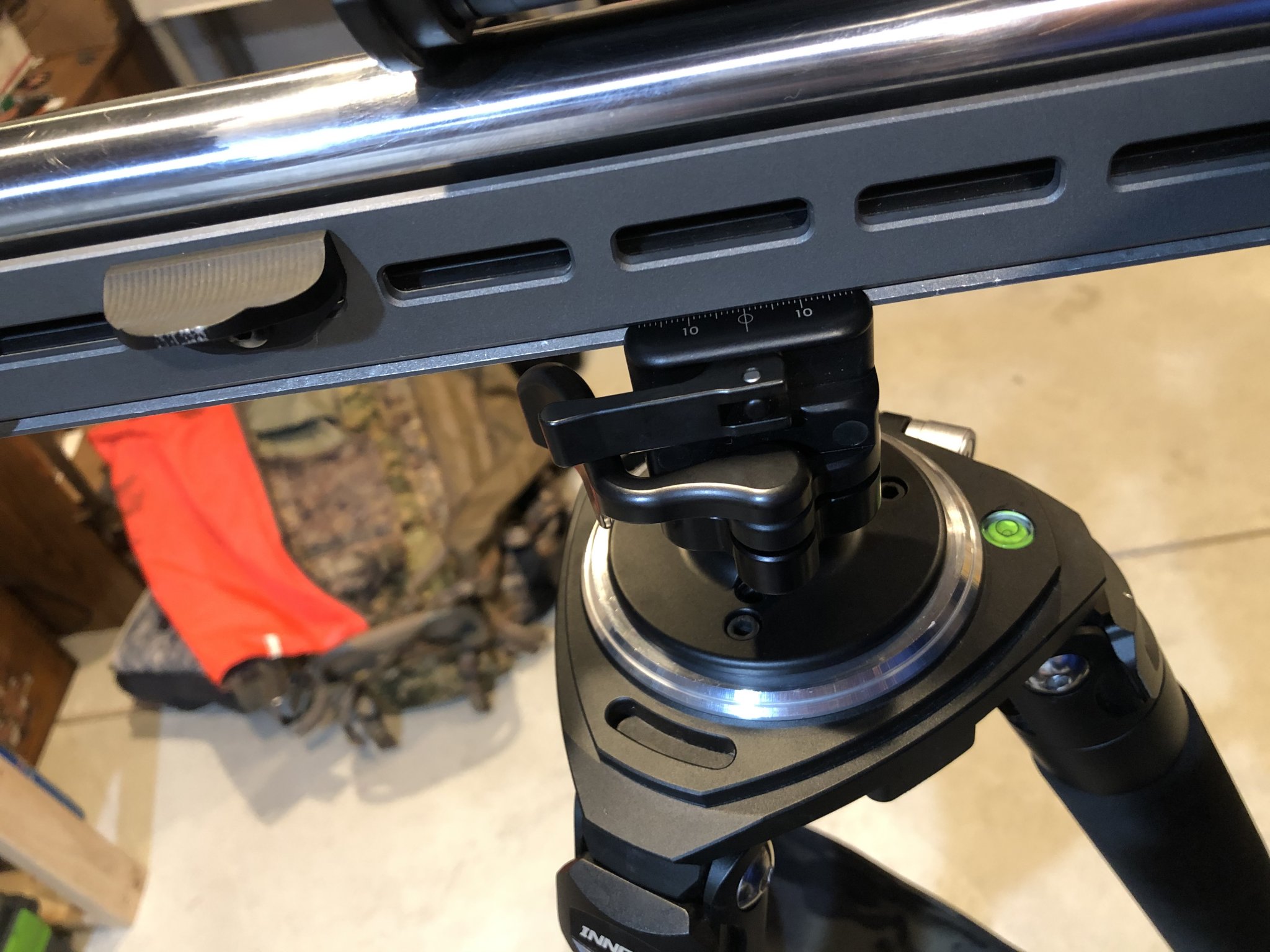

I ended up buying one of the Innorel N52 ball heads off of amazon to start with. Super impressive to me for less than $100, I paid $85 with a $5 coupon. Comes with two QR dovetail plates, you can kinda see one in the attached photos used with the bino mount.
Tension is adjustable from super loose to almost can't move the gun, and is over at least a full revolution of the knob so you can definitely set it where you can move it around to aim but it holds the gun in place when you let it go.
On my particular head the pan base knob did come off when trying to loosen it, looks like the glue came loose. But easy fix with red loctite, and I'm not super concerned with that as I'm going to leave it locked down (I can pan with the flat base of the tripod if I want to).

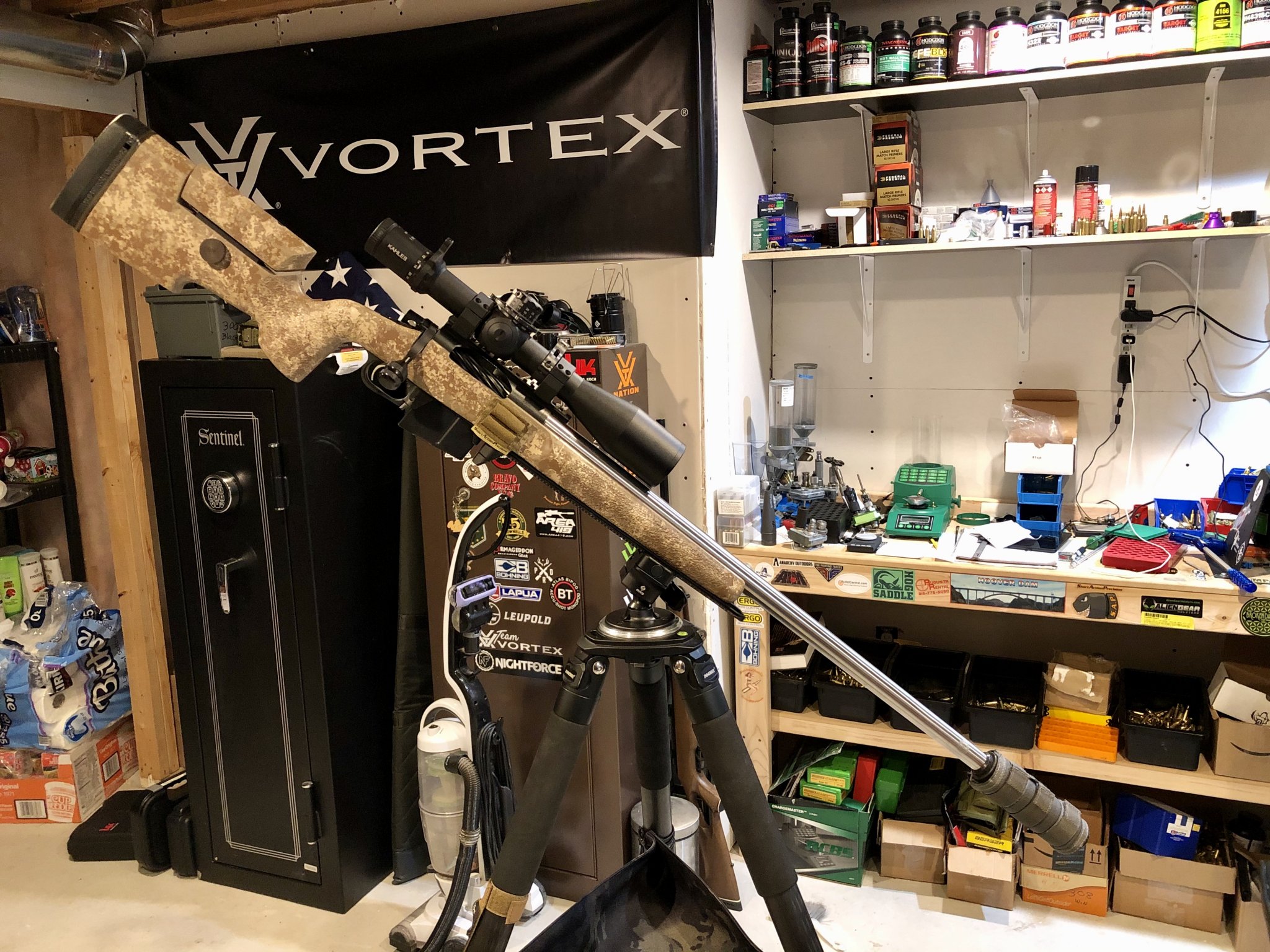

I have only shot off of it with my CZ455 so far as I'm still waiting for the chassis for my 6.5, but really easy to hit steel with a .22 out to 150 off of it. Ran a couple mock stages and did very well. Excited to get the big gun on it as soon as I can...

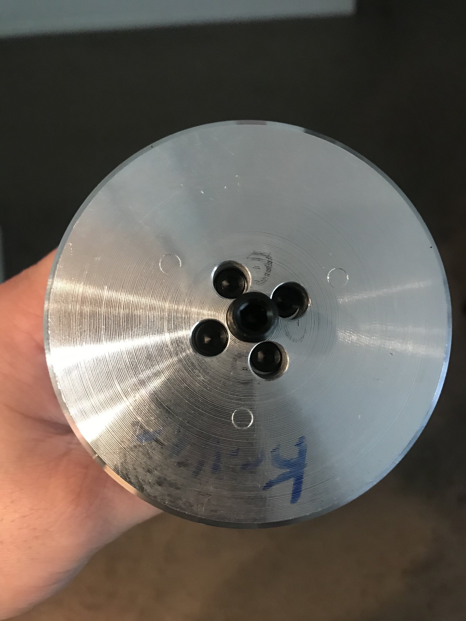

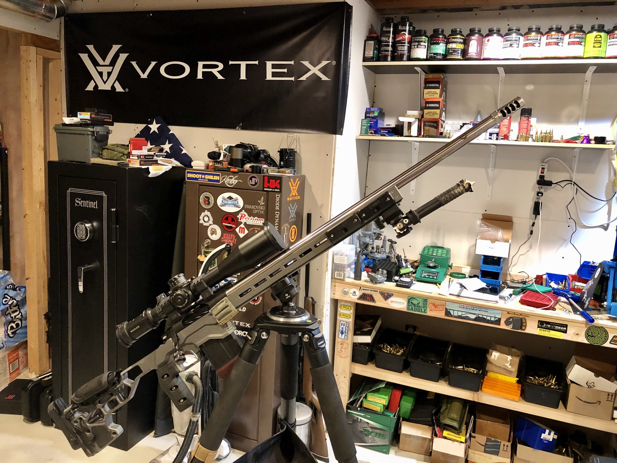

@midwestoffroad you absolutely killed it with the anvil plate. I’m so happy with how it came out. Everything fits like a glove. The cap screws you sent me are not the right size, but no big deal. Went to the hardware store and got some 8-32 x 5/8 and they fit perfect. View attachment 7233126View attachment 7233127View attachment 7233144
Looks great I'm glad this version actually worked out . This was a test to see if it would. But sorry on the screws thought they were the wrong ones lol when i mentioned it when getting you the tracking.

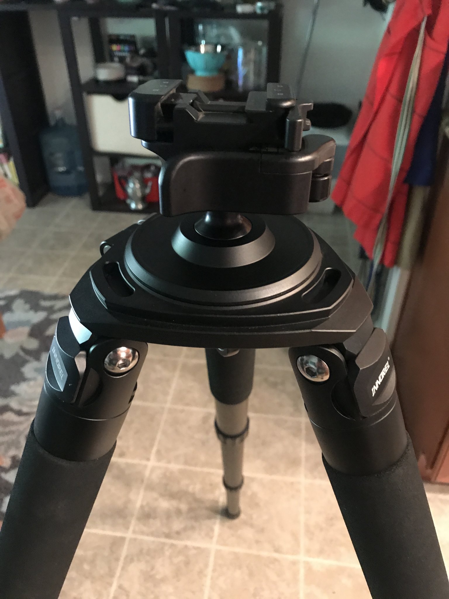

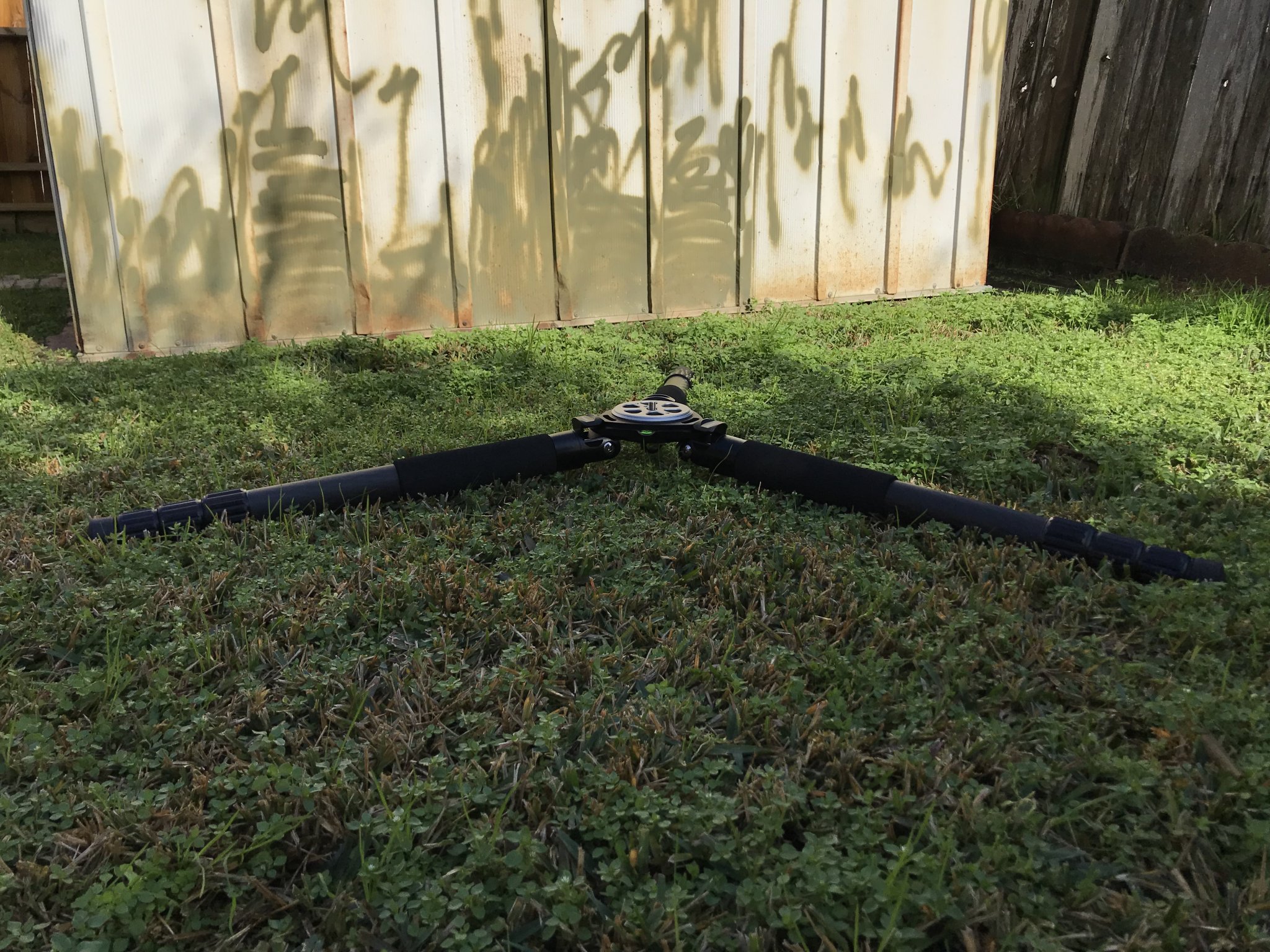

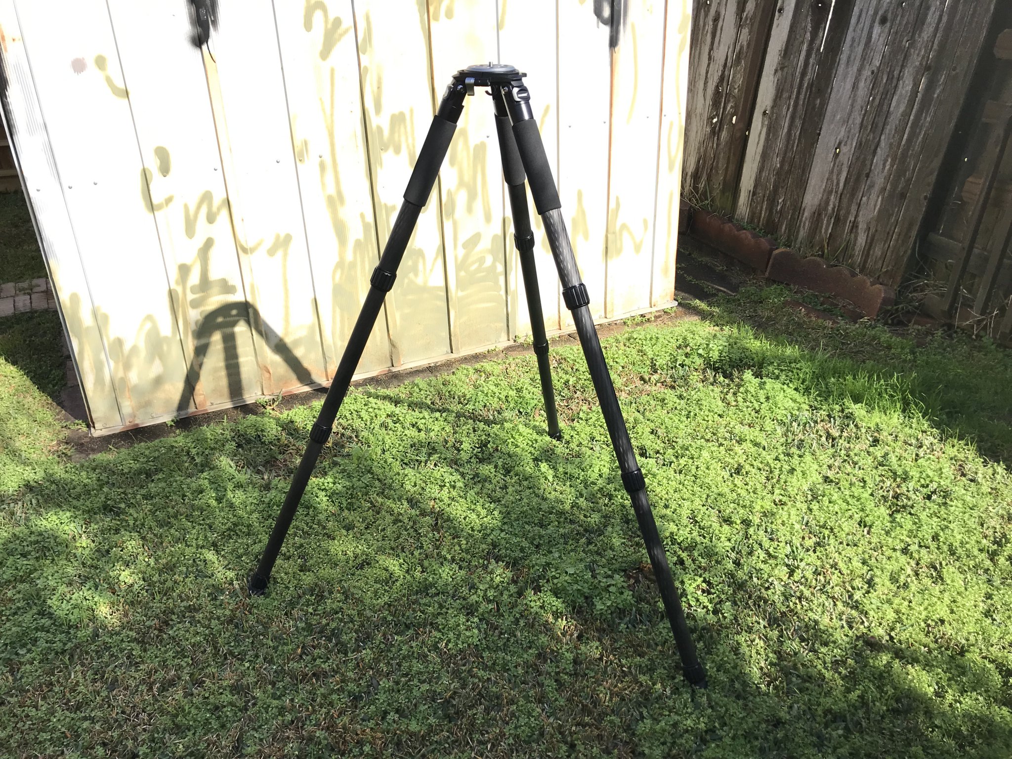

Quick overview.. Picked up the RT90C from UPS today and went home to mess with it. Immediate thoughts are that it is substantial and nicely constructed. The locking collars are smooth and don’t feel gritty when turning. The position/pivot locking tabs are smooth to push in and out. The anodizing looks even as well. I don’t see anything chintzy about this $300 tripod. Only thing I need to do is loosen the tension on the pivots so the legs can swing out easier. It’s super stiff right now. The main legs are 40mm. The included carry bag is nicely padded.
And yes. It can go LOW. I’m happy so far with the purchase from just messing with it.
View attachment 6992824View attachment 6992825

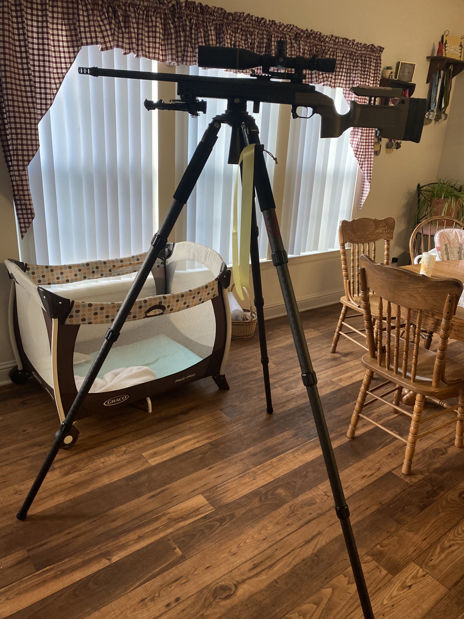

Not really attempting to bring an old thread alive, however, USPS just dropped off my RT90C. Now they you’ve had it for awhile anything new to report?
So far this has passed the living room test!

"i added the leofoto long handle w/hook to my rt90c. Figured were so many people trying to fit numerous leveling bases. This one fits & functions great. Pics should show exact model number if anyone is interested."
........look at post #511 and statement above. (set-up is shown w 3 pics) *huge thanks to Guiseppe83

Is anyone running the Innorel N52 ballhead? I just got one to see the quality and it doesnt open far enough to drop anything rrs related in(my mpa, mdt acc, misc rrs plates). I dont see any where to adjust the knob either. I messaged USA innorel through amazon but might just return it.
I have the N52 and both my ACC and 419 rails fit.

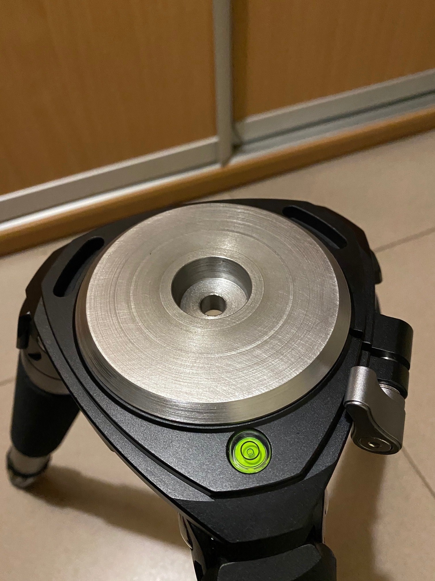

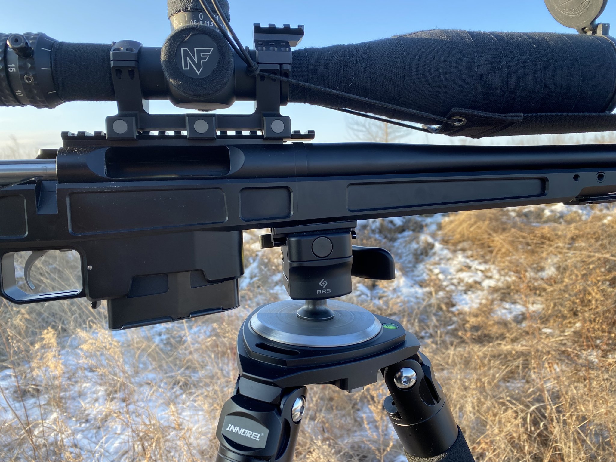

I'm trying to wrap my head around Anvil 30 working with RT90C. You can just get the Anvil 30 head only and screw it on the RT90C with some loctite and it should work right? Is there any benefit besides the potential of the Anvil 30 coming loose, in getting the Anvil30 with either Series 2 or 3 adapter and going the custom plate route? Will it be more stable that way?

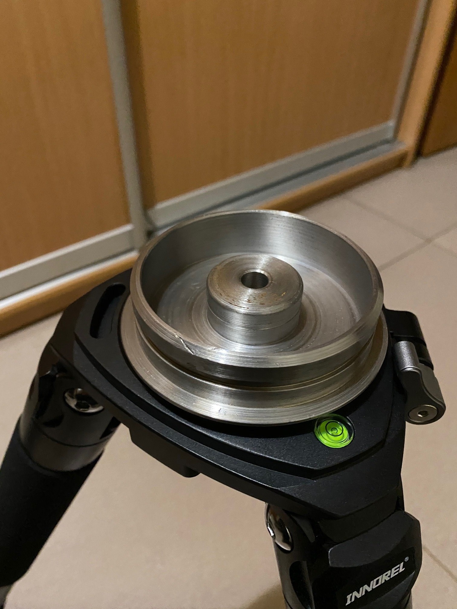

If put on the original plate RT90C, then I think that Anvil30 will turn even with loctite.
I took a different path - turned a plate for a tripod instead of the original.
The hole where Anvil 30 is mounted is made in the form of a cone.
Anvil30 is tightened with an 3/8-16"bolt and does not turn.
A few pics
Go back a few pages.
What plate is that? Did you have it made or you bought it? Thanks,
