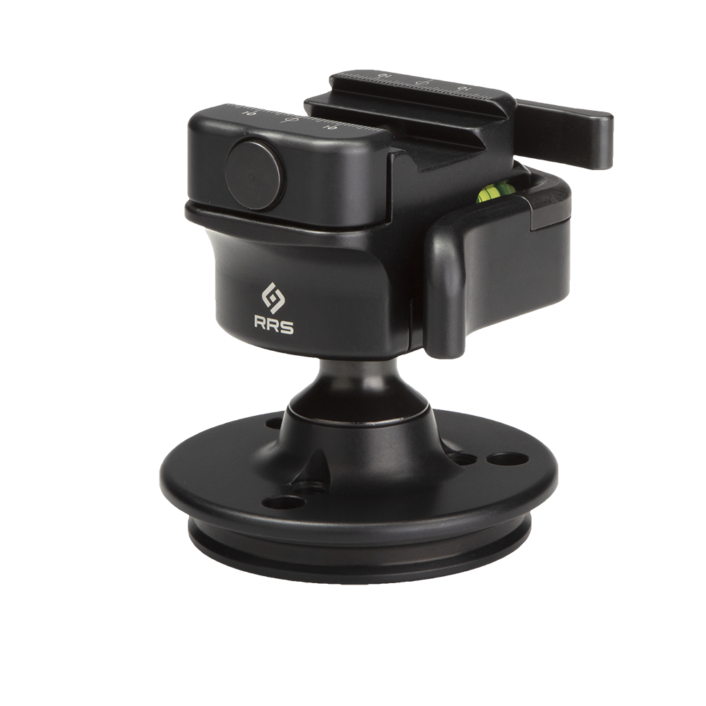

Guys,
Hoping you can help. Purchased a RT90C, I’ve read through these 9 pages but am still a little confused.
Haven’t got a huge amount of experience using them, had a couple before but where cheap & cheerful set ups.
I’m not sure which route to go down and hoping you can help me out based on all the experience on here. Regarding my shooting I’m looking to keep the set up a lightweight as possible but will accept heavier options if it brings considerable gains. I doubt I need the option for crazy angles as I don’t shoot in any mountainous regions.
I already have a hog saddle which will house rifles which don’t have RRS / Arca set up, and two AI rifles that have RRS plates attached. So my choice needs to have a QD function to swapping between the both.
These’s are the options that I think I have:
1) Direct threading the Hog saddle to supplied video bowl and Leveling platform that came with the tripod. Purchasing an additional ball head to sit on the factory metal plate.
2) Ballhead - Sunwayfoto XB-52DL GNN. Comes with a plate adaptor to attach Hog, and from what I can read a good ballhead but perhaps not as a slick set up compared with the RRS SOAR range. However being in the U.K. is easier to source.
3) RRS - Ballhead BH-55 LR. Direct thread on top to the tripod. Heavy & expensive. But no doubt the most capable.
4) RRS - Anvil 30. Correct me if I am wrong, threads direct on top without an adaptor needed? Only negative I can see is that the QD lever’s are very close together and could accidentally flip the wrong one. Lightweight, cheaper and accept pic rail as well as RRS/Arca.
5) RRS Leveling base. TA-3 from what I’ve read can’t be used with the RRS supplied video bowl, but can use the Tripod supplied video bowl. However it’s limited movement and “gritty” in the stock bowl and doesn’t allow a pan it’s either locked on or off? Is that correct?
Also TA-2U-SC. Screws directly on and uses it’s own bowl? I can’t figure out if it’s a better or worse option to those above.
Please help with the pros and cons of each and help me arrive at a conclusion. Value for money is important to me, also there is quite a few options above so don’t confuse matters with other suggestions!
Thanks in advance, Mark

The TA3 doesn't work without using the Tripods existing bowl (not optimal on my opnion).
However, RRS makes a TA4 for 100mm tripods and that "should" work. They are currently backordered on the long handle version, but as soon as B&H photo gets the long handle version in stock, I'm ordering one to test.
TA4 100MM leveling base back in stock at B&H Photo.
Order Placed! Will update the group when it arrives. I'm really hoping it provides a TA3 alternative WITHOUT having to use the RT90C's bowl adapter.
TA-4 100mm RRS Leveling Base arrived today.... going back to B&H tomorrow. Not even close fitting.
I'm still on the fence about using a TA-3 and the factory RT90C 75mm bowl... For the price of a RRS leveling base, I wanted all the buttery smoothness, and am a little apprehensive on how a modified TA-3 will feel.
I'm going to wait until Shot Show 2020 and see what RRS announces. I'd love to see a 75mm Anvil-30.

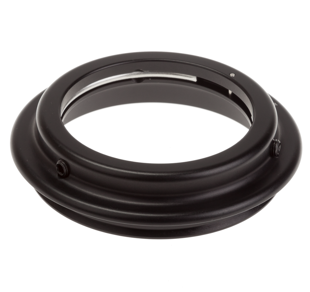

I don't think that will work with the RT90C. The RT90C is an oddball because the main opening is allegedly 100mm (even though it didn't work with the TA4) only the bowl adapter is 75mm.... unless I'm missing something.
For those of us that cheaped out and bought the RT90C, I think the only options are to run a RRS Ballhead, threaded Anvil, or universal leveling base.... unless you want to use a TA3 with the RT90C's 75mm bowl adapter.
Thank you for your response. Pretty nice of you considering we are talking about CHICOM tripod legs and trying to use RRS products with them.
I believe the default when you buy the package with the leveling base is to include the 75mm bowl adapter. However, you do have the option, depending on where you get it, to request the 100mm bowl adapter instead of the 75mm.
I did not get the 100mm bowl adapter but I understand that you still need the adapter to use the tripod with 100mm accessories as the tripod itself is not setup to accept 100mm accessories without using the adapter.

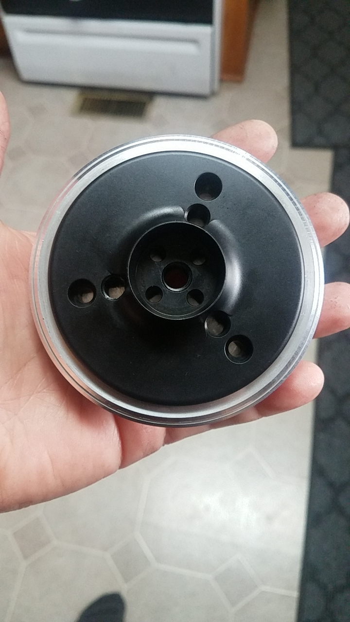

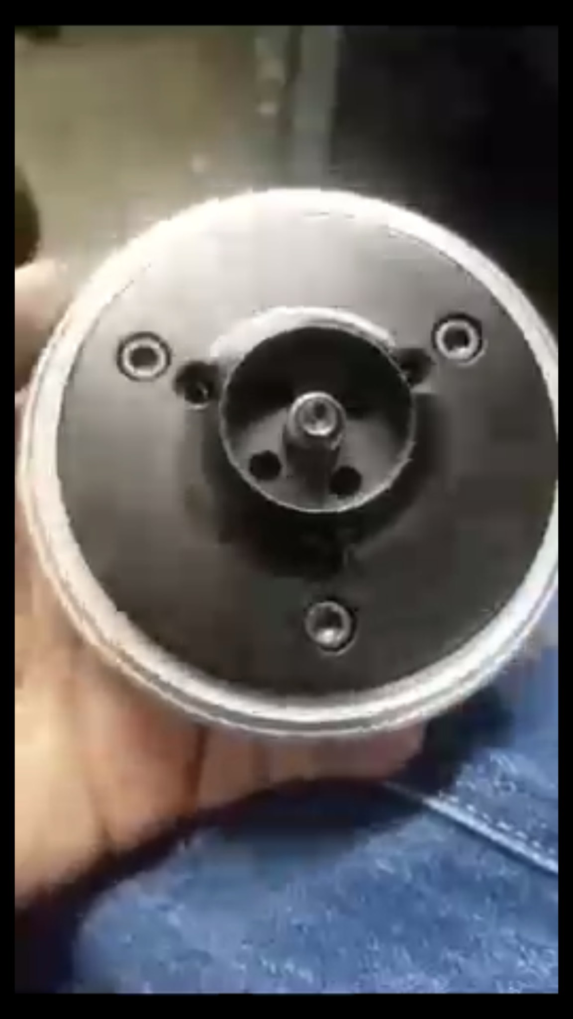

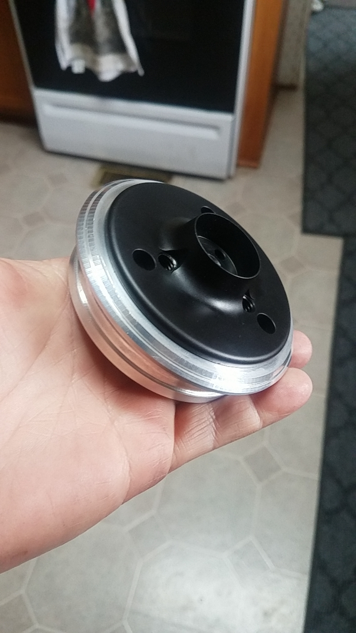

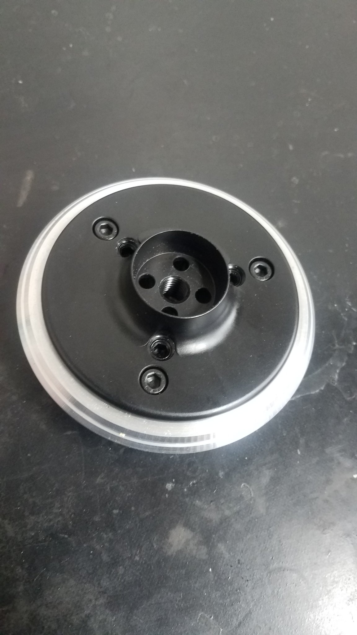

So. Drilled and tapped for it to fit. The bottom is drilled for the original hook that came with the tripod to hang a bag off of. That’s the adapter. I will use it and proof it out. And then if anyone else is interested in getting some made. Lmk.
split the two apart And add the 4 screws they hold the anvil 30 to the adapter plus the center stud.
scarily easy. I used to work in the mountain bike Industry many years ago. Back then it was Taiwan that could copy anything. Sent the dimensions over and they reverse engineer. There was an online trade book with manufacturers.
I worked in the performance Subaru world for a bit. My boss would send his competitor’s parts to a fabrication house in Thailand. They’d copy the design, add a couple “custom” features, and boom, new product with zero R&D.
