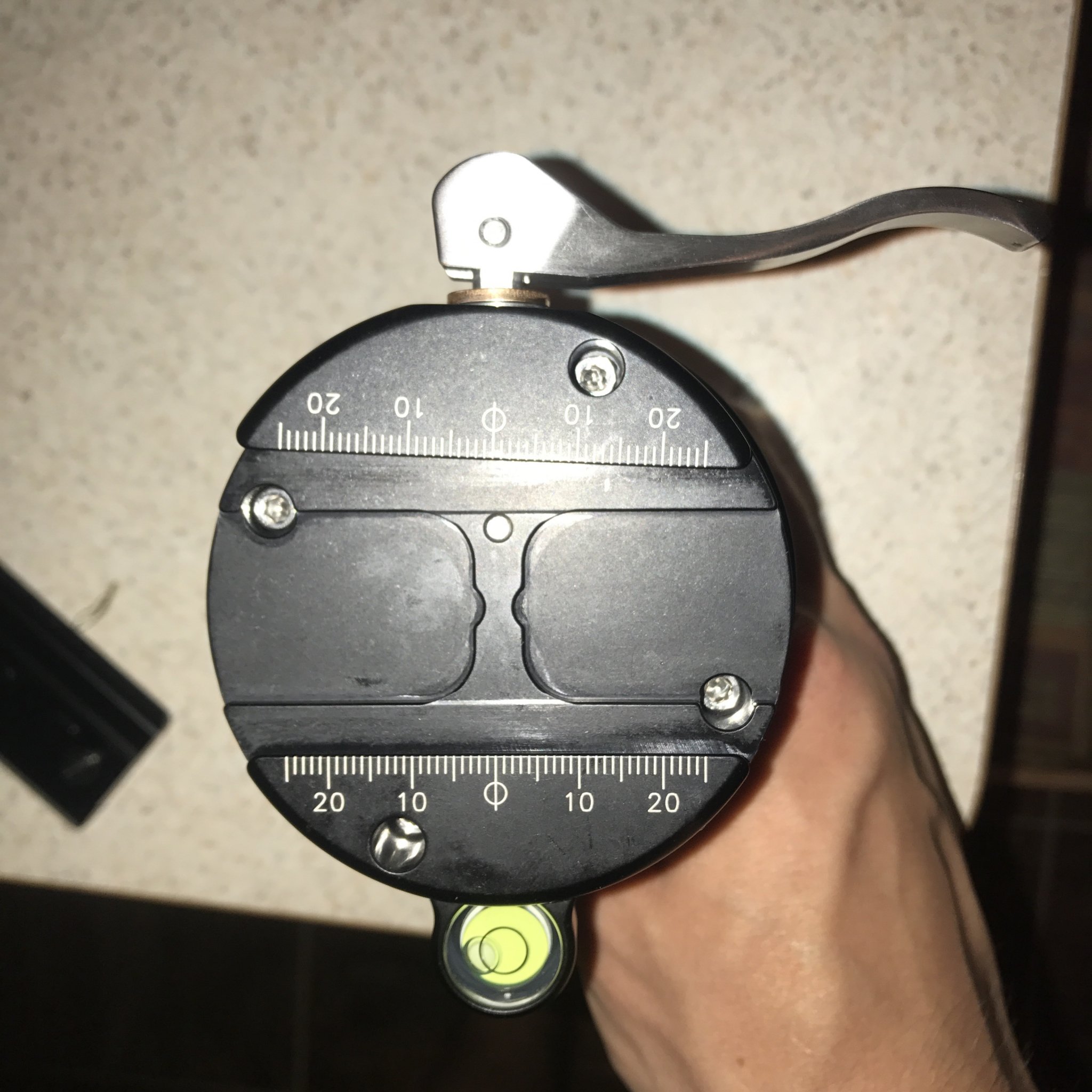

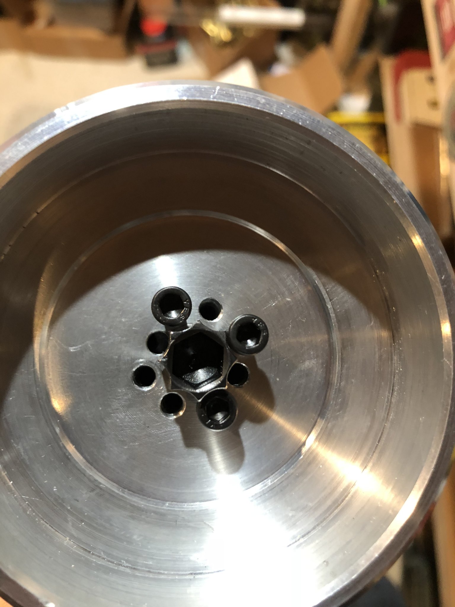

This isn't normal for the TA 3 is it? It can't be top loaded with the lever fully open and a plate won't slide freely with the lever half open. It will slide freely with the lever halfway between full and half open. That screw is clearly what's stopping it from fully opening.
I won't have acess to my Allen wrenhes for a couple days to see if it's too loose. Maybe RRS put too tall of a screw in that spot?
Man that blows! I do apologize on the behalf of RRS. Sucks you don’t have any keys available. It should have shipped with the necessary keys. Looks like the screw wasn’t tightened enough.

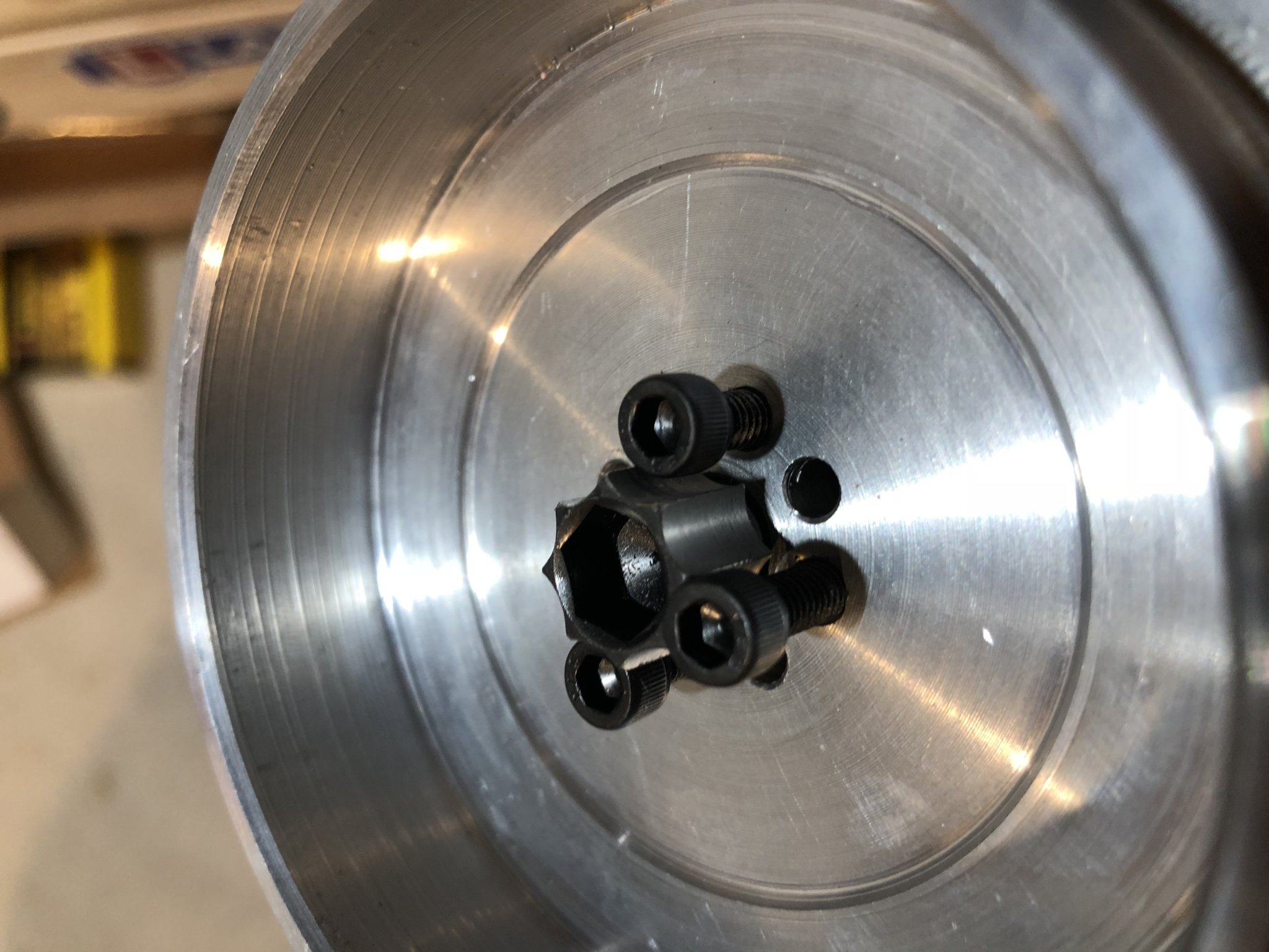

It was tightened all the way down, but it was still hitting the bottom of the screw hole. I trimmed the screw a bit and removed a little bit from the bottom of the screw head. Tightens up flush and works fine now.

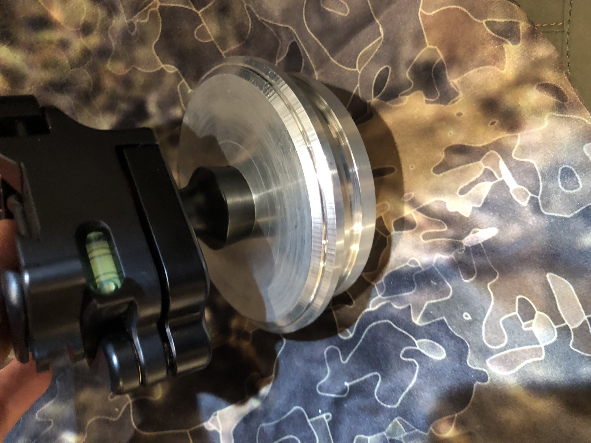

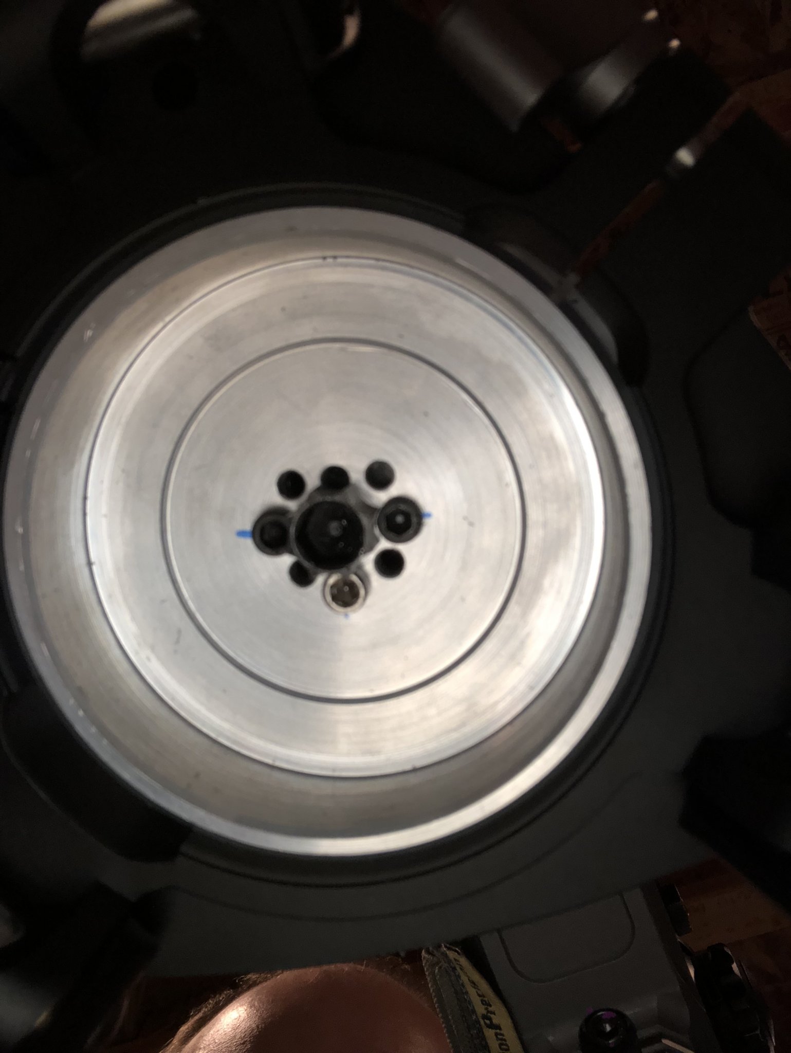

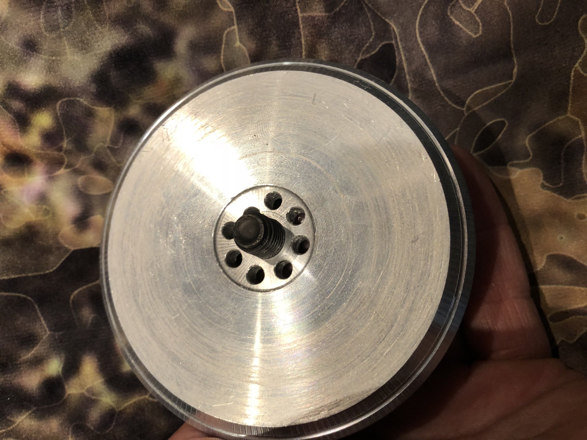

So here is the prototype mount for an anvil 30. Machined a new plate and then drilled. This plate is a first run so the one hole was drilled incorrect. So only 3 bolts are locking it in. But I can also use the other 3 that are not threaded for pins. With 3 bolts it stops any rotation solidly. The center stud is a bolt machined away for clearance of the anti rotation bolts.
Future refinement might include a larger step down for the center stem of the anvil 30 to sit into.

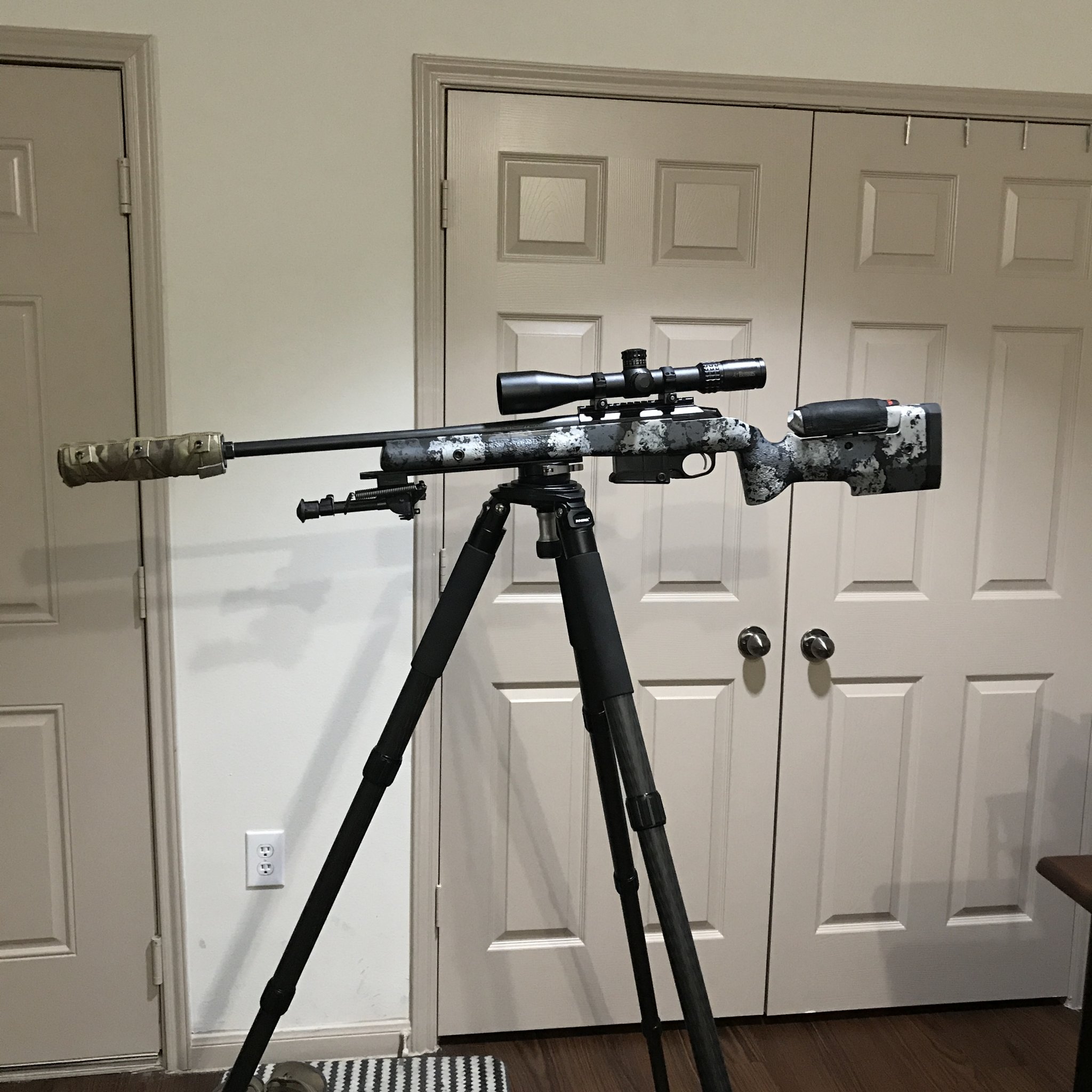

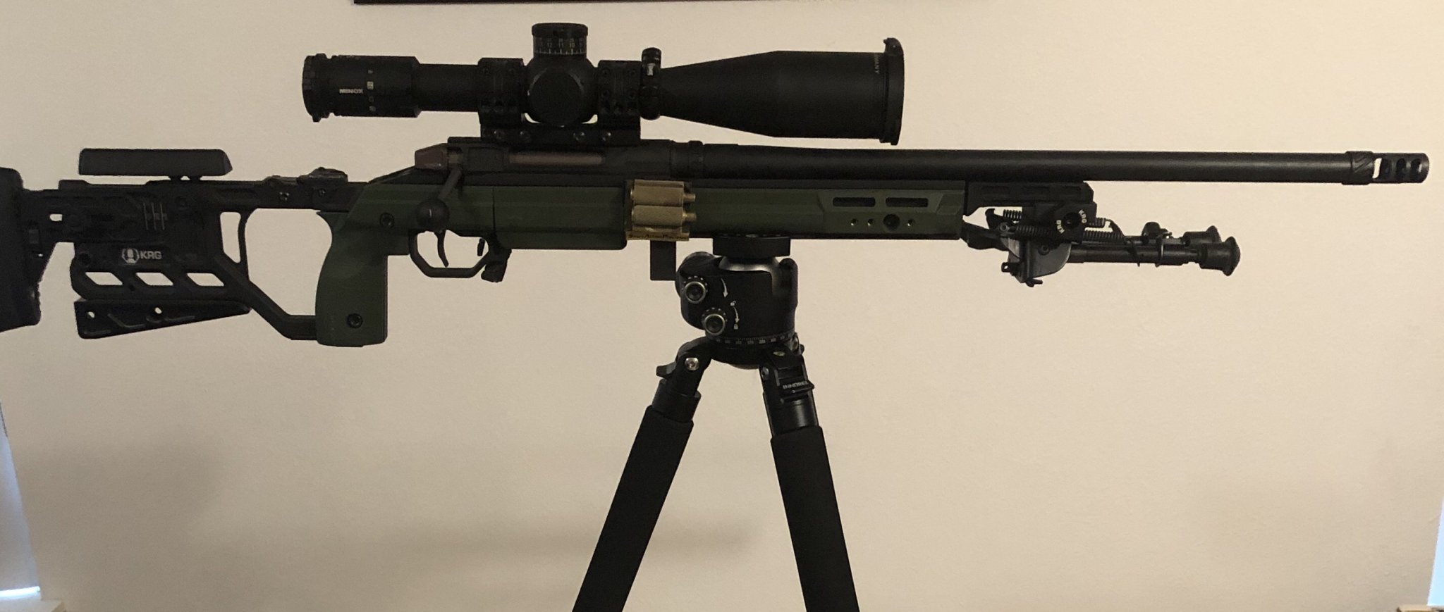

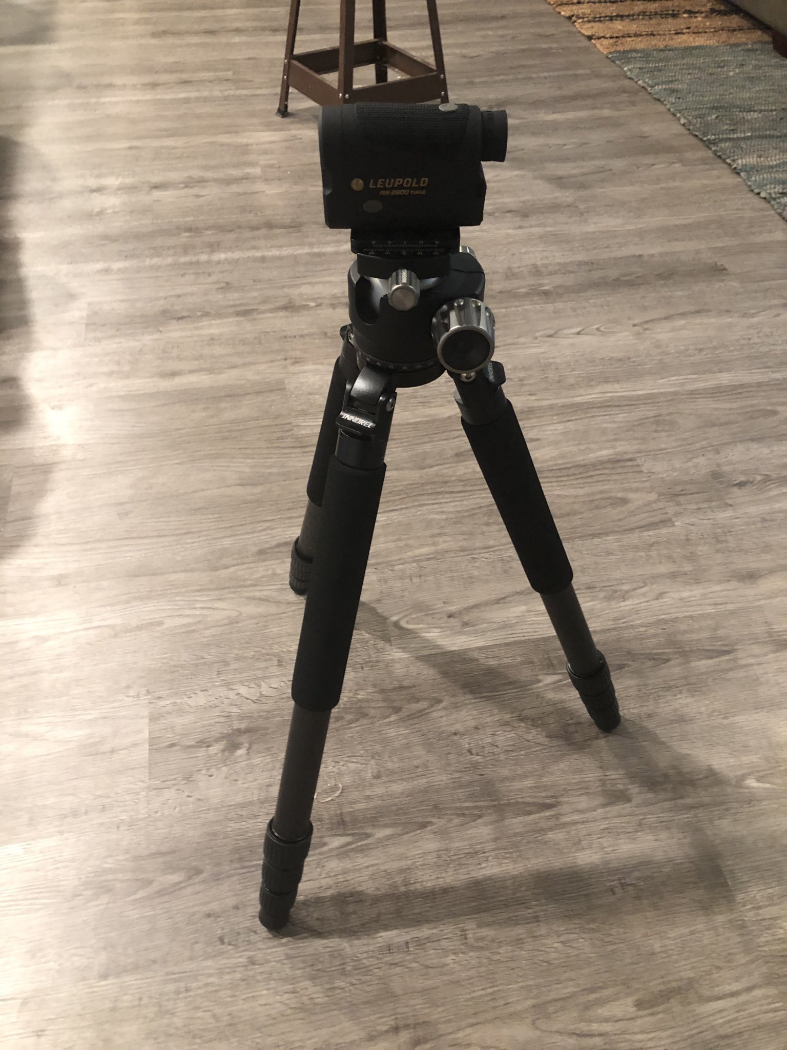

Got the rt-80c and lh-55 no neck ballhead. Seems pretty stable, haven’t shot off it yet. I’m pretty happy with it, going to be mainly used for spotting

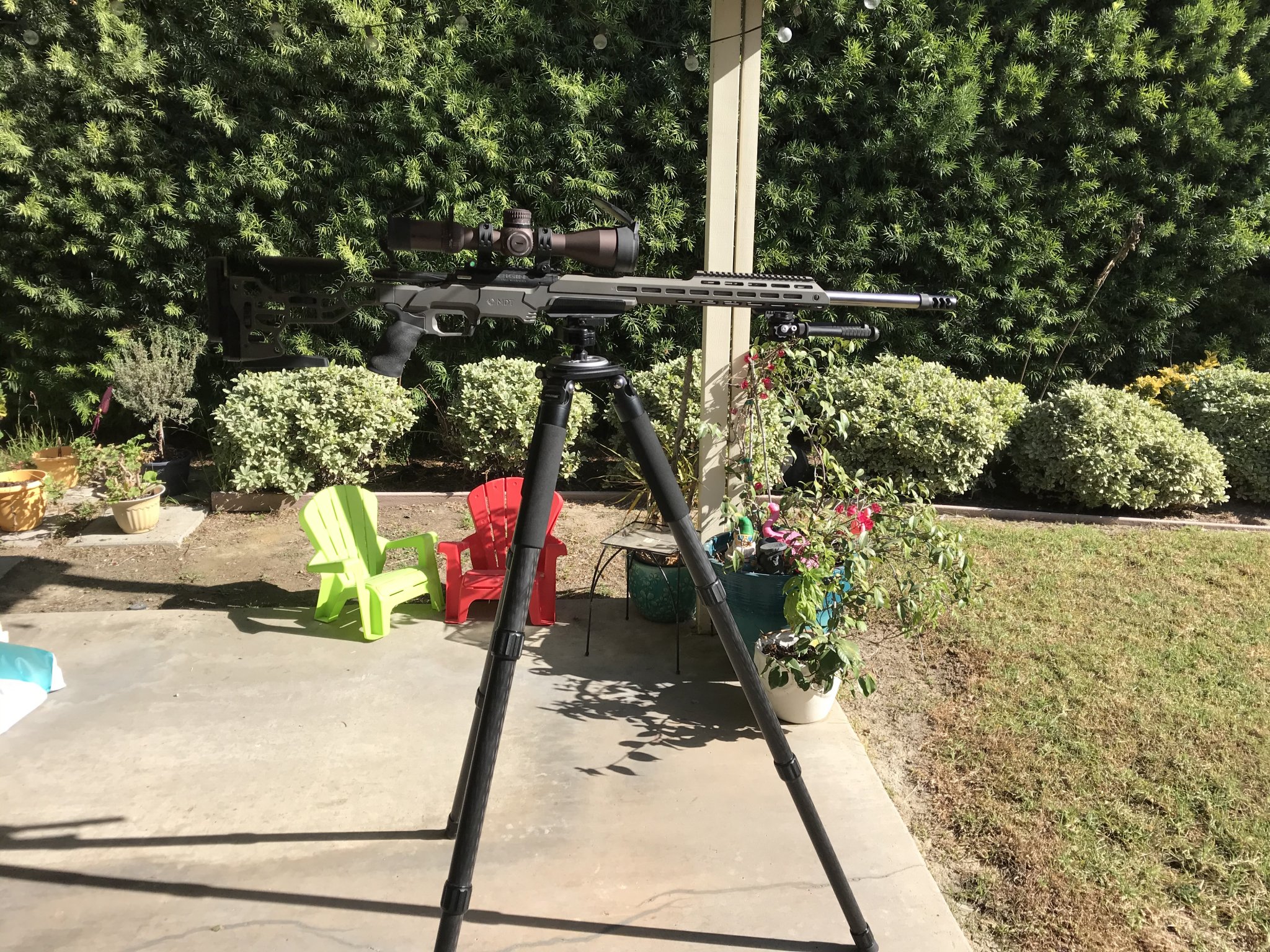

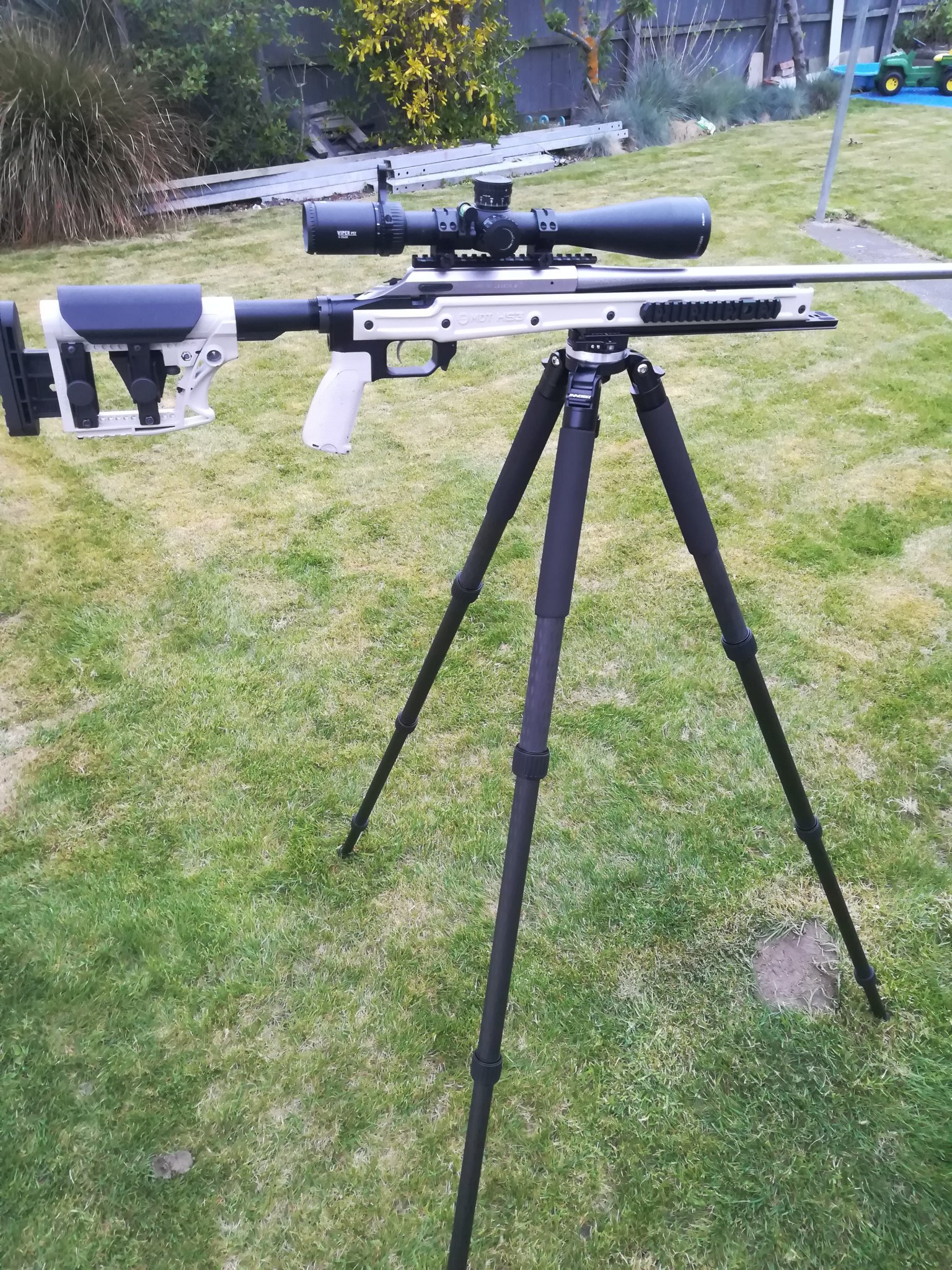

My anvil came in today. I gotta say it’s damn nice. Being that I’m short, two legs extended is perfect height for a standing shot.

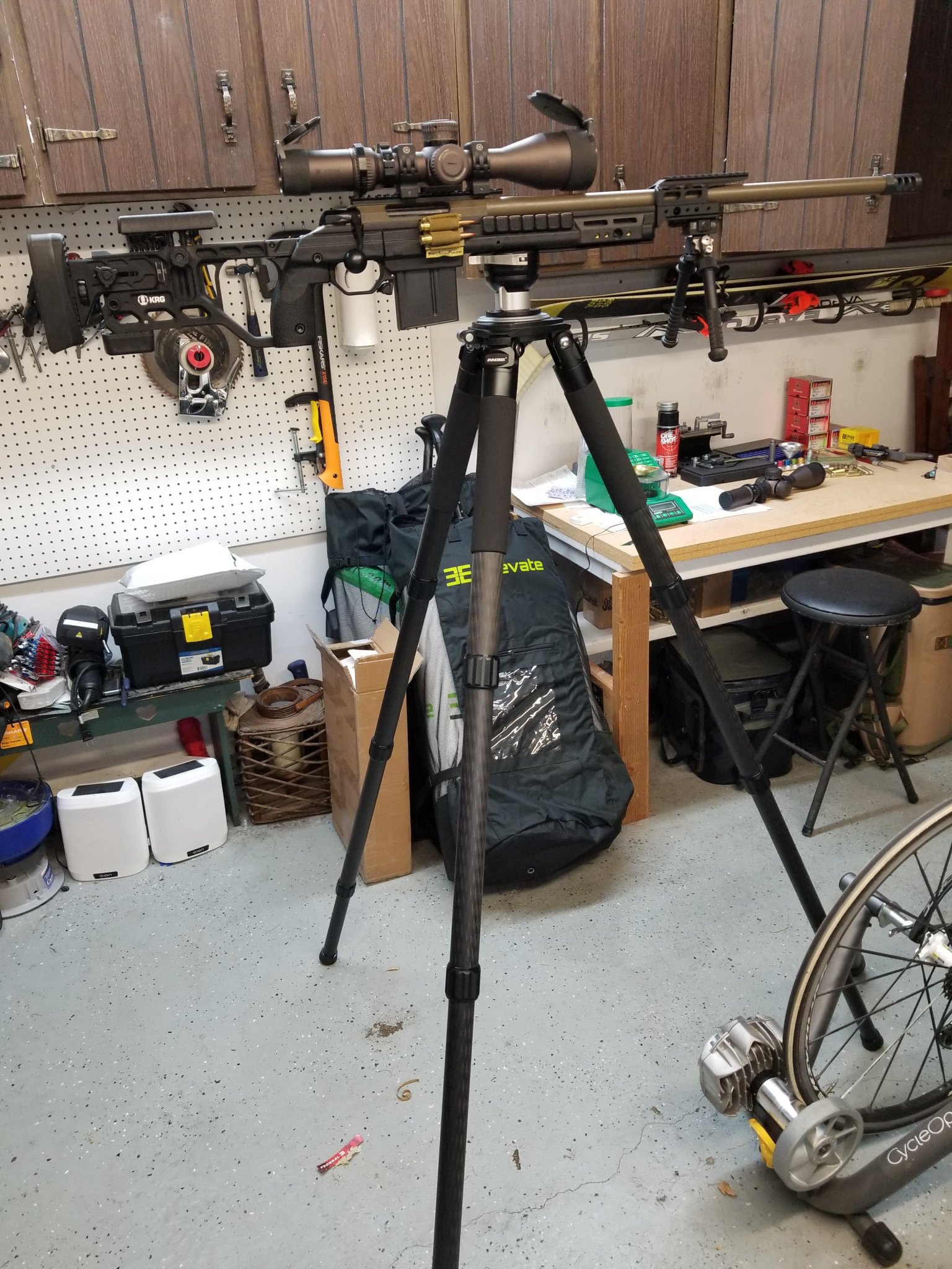

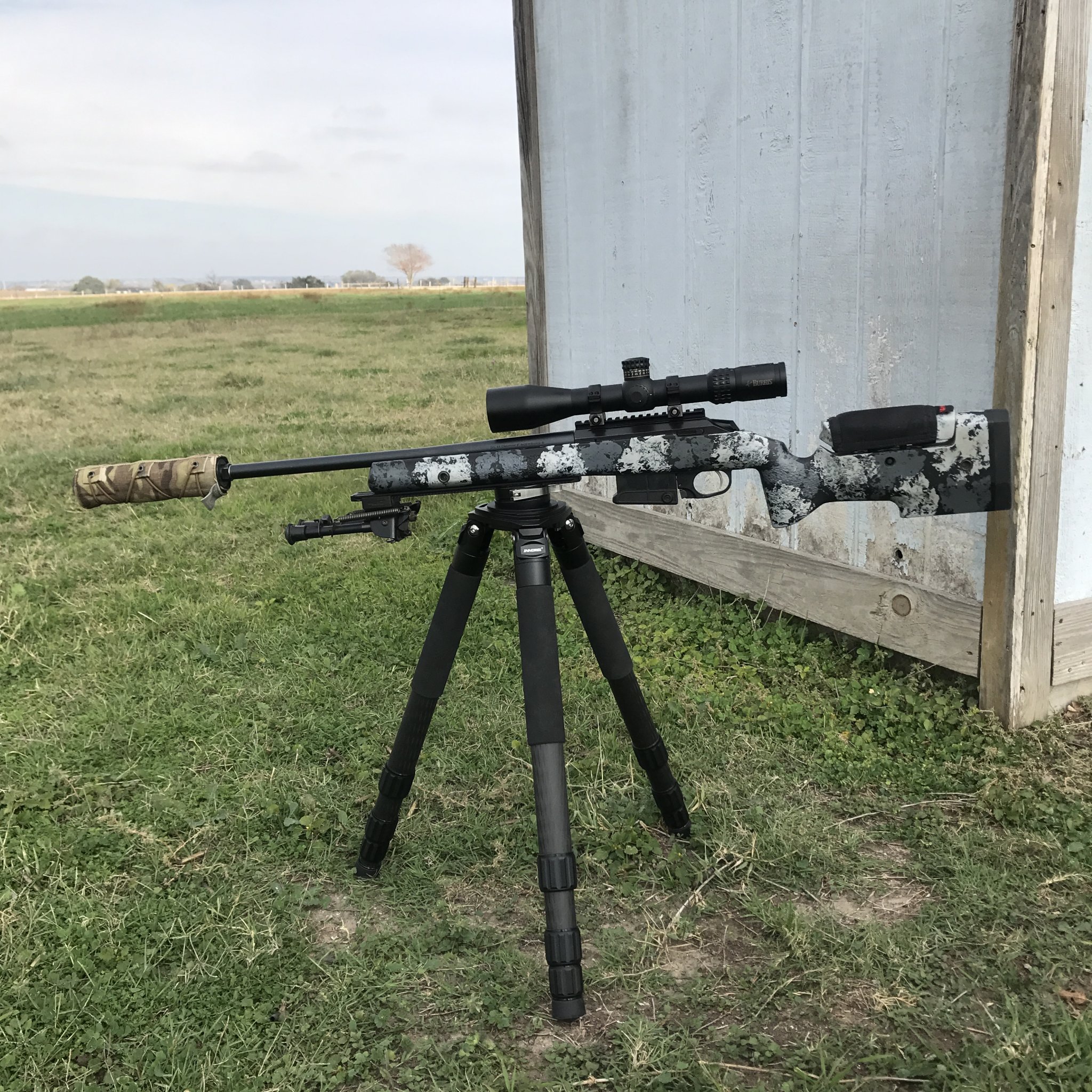

If you guys are shooting your tripods with the legs setup like this, I would encourage you to experiment. It is probably one of the worst leg configs for a standing shot, especially if you want to see your trace while minimizing your wobble.
You should easily be able to see the support issue in the images above. That said kneeling or siting, the legs for a much larger base so it doesn't matter as much.
Even when not set up as a direct mount you'll notice the legs do not for a monopod in the front..
Of corse I just shot this left handed on a right hander, is best with the right leg closer to 5 O'clock were as a left hand positon is nearer 7 O'clock

I edited the post to add more info. I am not saying you can't hit things like you guys are setting up. Clearly you can, but a bit of setup change and you can load the tripod less (less wobble) and have the tripod do some of the work.. You be faster and a better shot with just slight tweaks.
I’m having a bit of a hard time following your post. So if I’m understanding this correctly, I should kick out the legs at more on an angle to get a more stable position?
I 'think' he's trying to say that pushing on the front leg in a center position is NOT the best way. If you're right handed, shooting right handed, rotate the tripod slightly clockwise. You'll need to find the sweet spot practicing. At least, that's what I've found shooting from a standing position using a tripod. Sitting or kneeling is not as critical as the tripod is much more rigid and your center of gravity is much lower.

For a right hander, you need to rotate the tripod clockwise, making a bit of room for the shooter on the left side of the gun. Tripods actually shoot well 180 degrees to the images most of the guys post, but the rear facing leg gets in the way of the mag and shooter, hence the offset. As Jeff said low positions and wide legs are so stable any comfortable position works

Ok got it. Thanks so much for pointing this out. I’ll give it a go next time I’m out.

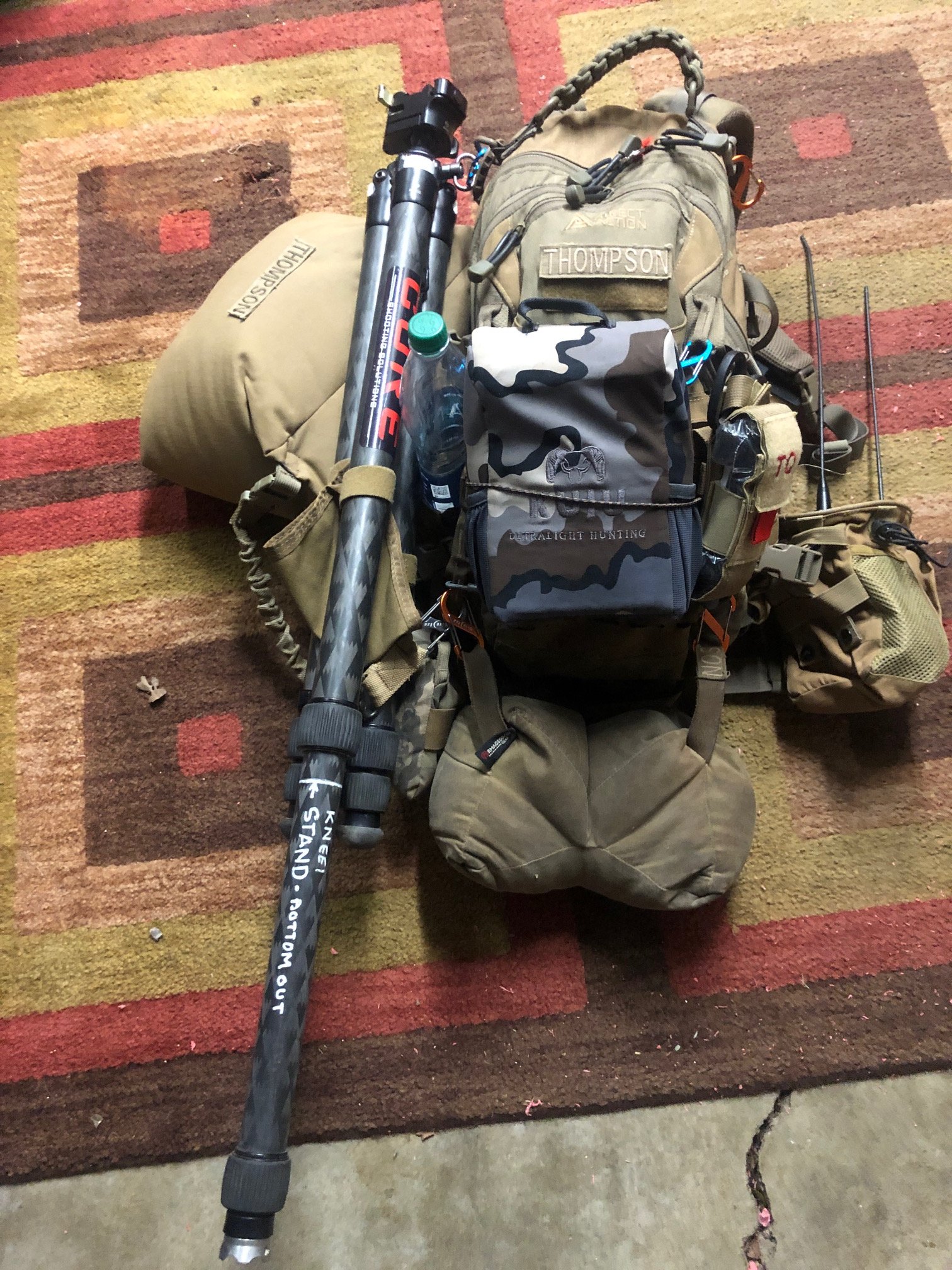

2. Use a silver sharpie and mark your upper leg with your standing position, setting and kneeling. That's my match pack in the image.. I just pulled one leg out to show the markings.. I actually used a white paint marker from ACE.
