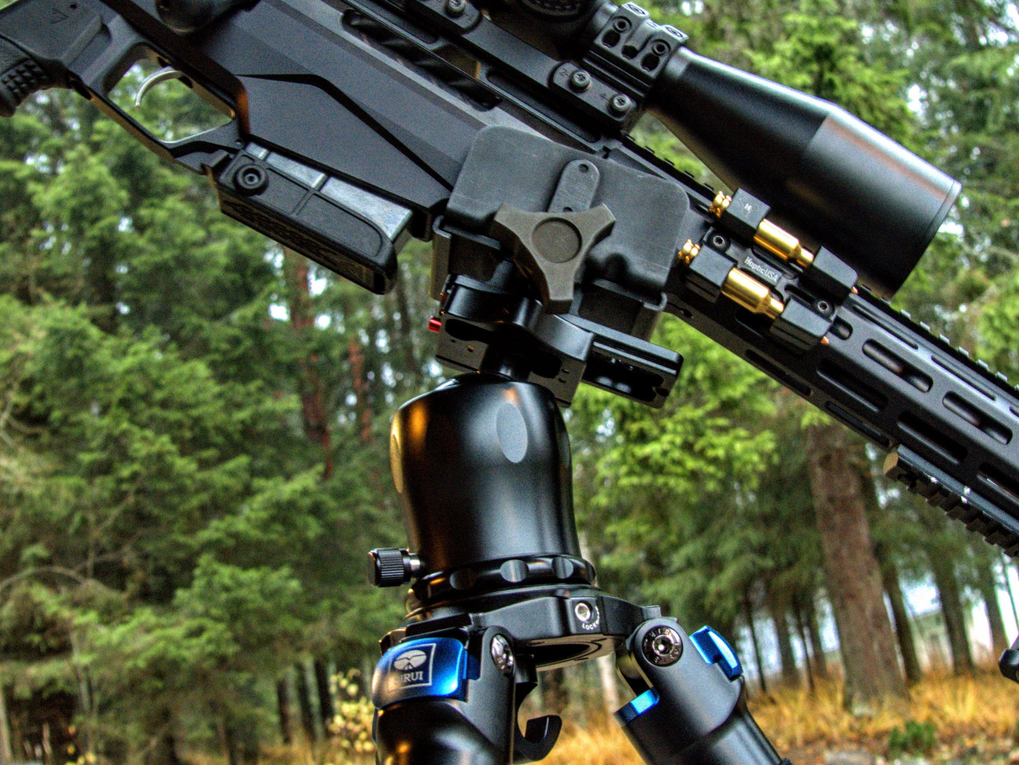

Sirui is company from China, but they do make a good stuff.
6 year warranty, models for all the user, alloy tripod all the way to handle to 20 kg, 44lbs weight, and then there is carbonfiber models.
Sirui US homepage.
I have 2 Sirui tripods, and ball heads, i can say with 100% from my hearts, that check these out guys.

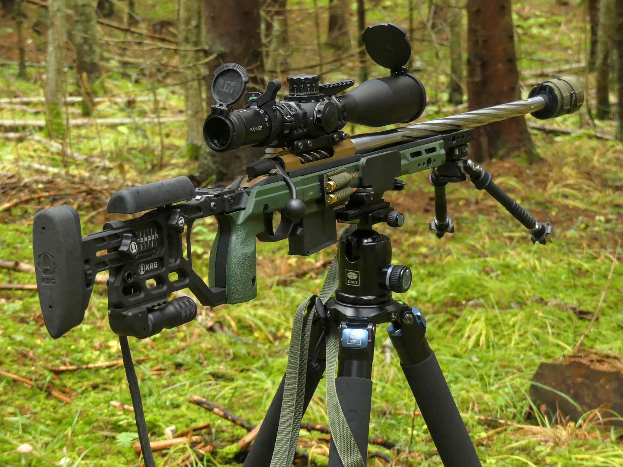

This is the flagship model, legs made of carbonfiber, can hold 30kg weight, i use Sirui K40x ball head, rated to 35kg.

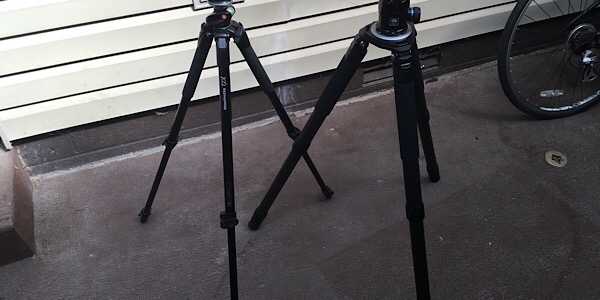

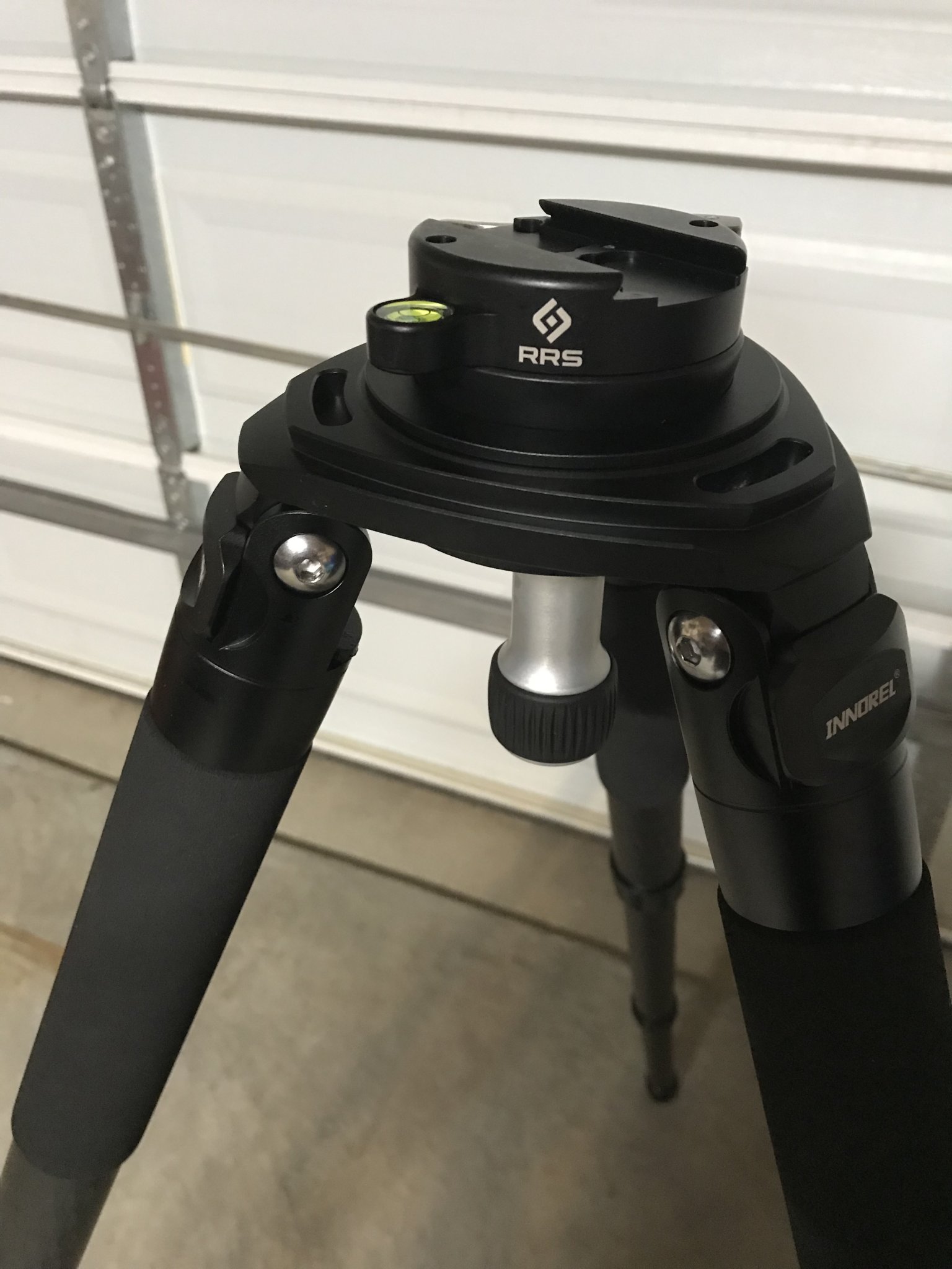

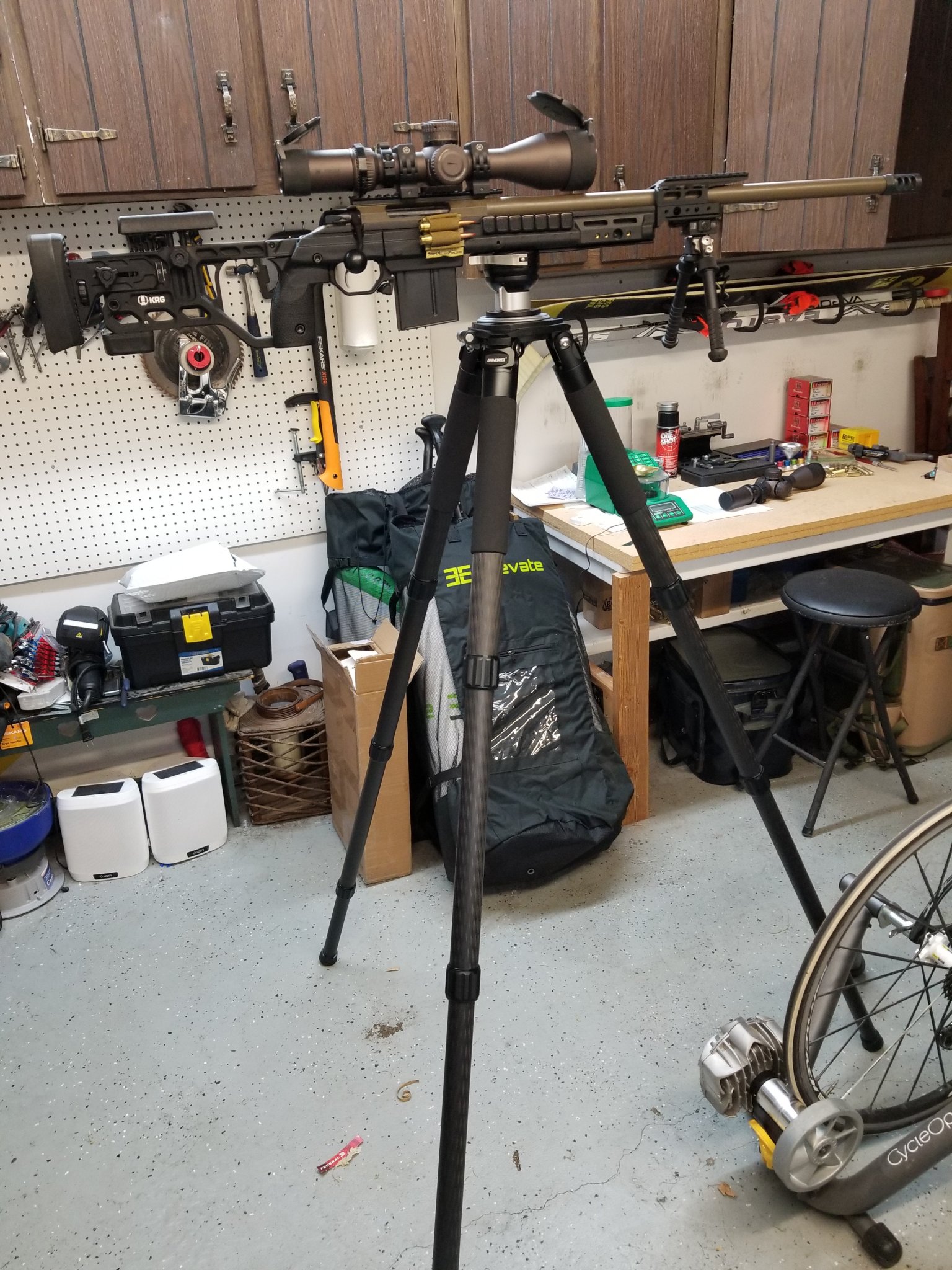

All I can say is wow. This thing makes a huge difference over my Manfrotto. Below are some pics. One shows the RT-90 next to the Manfrotto. I ended up going with the Sirui ball head. Amazon had a "reworked" head for $40 off so I tried it. The thing looks brand new and works really well.
I’m going to try to go out and shoot groups early next week. So far, it seems like a substantial upgrade.
My RT90C arrived today. Tomorrow my RRS TA3 arrives. Once I get it all together and play “special operator sniper” with it, I’ll give my initial impressions.

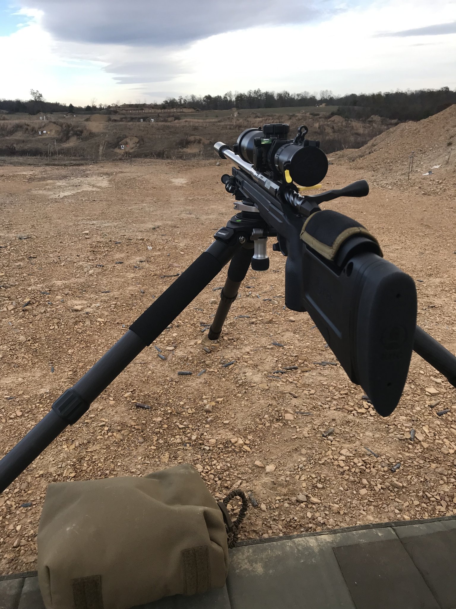

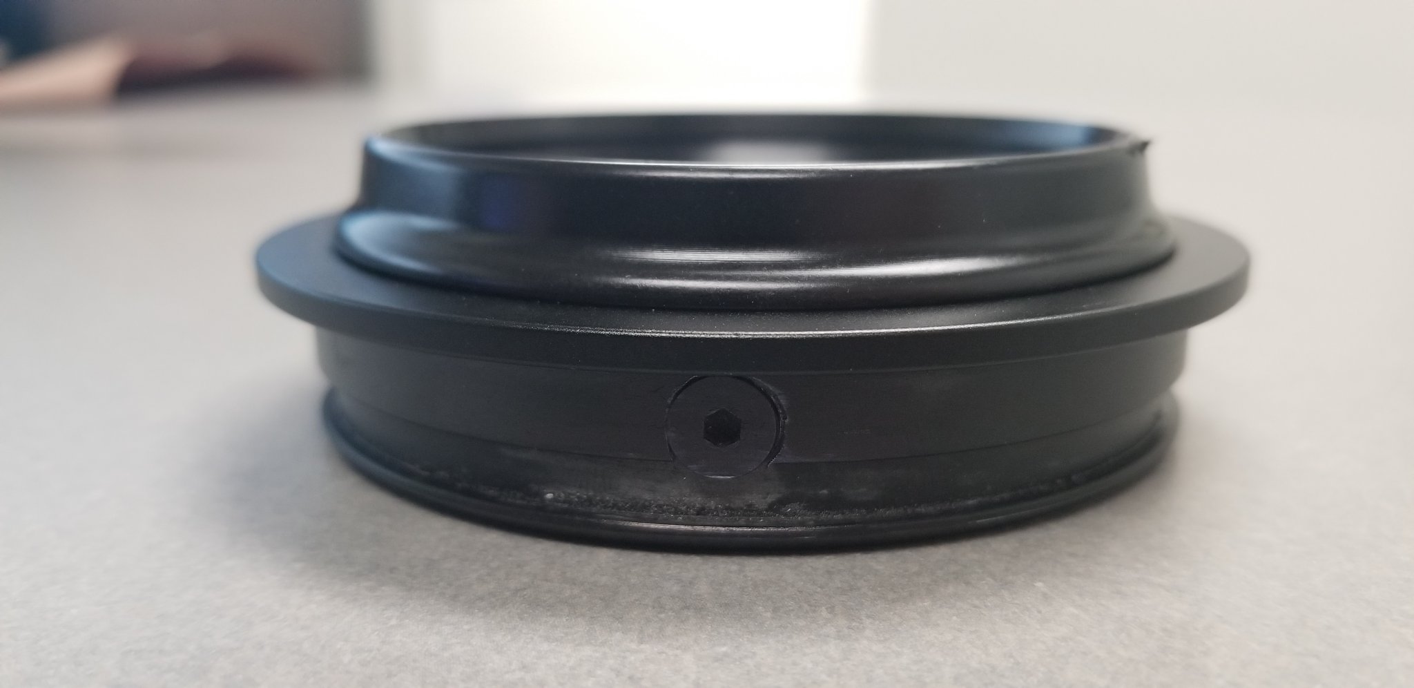

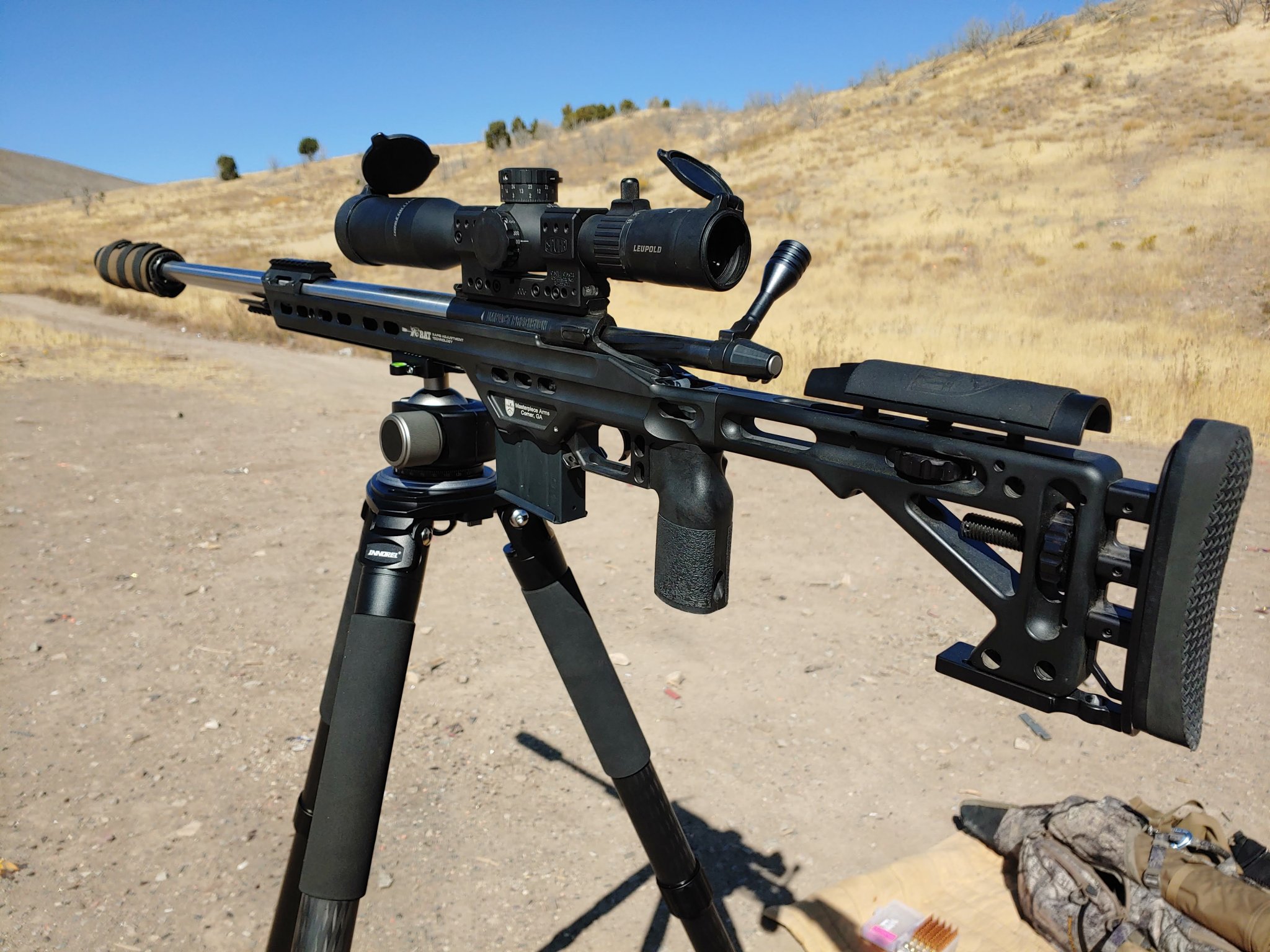

Been shooting .22lr matches all Summer using the RT90C and the DLOW55 ball head. Very pleased with the tripod. The ball head works well and is very stable.
The issues I'm having is it will rotate counter clockwise smoothly under tension but not counter clockwise w/o loosening it up quite a bit. You can rock it to get it to come counter clockwise but not ideal.
The plastic insert that holds the actual ball has begun to slide around in the pocket and I ended up chipping one of the corners of the plastic insert as it slid out into one of the gaps and I rotated the head and neck of the head broke the corner off.
I also am wondering what they use for lubrication for the ball as mine had a white powder that over time has dissipated and seemed to increase friction on the plastic insert causing it to come loose. If I knew how to disassemble it w/o breaking it, I could glue/adhere the plastic insert back in place as well.
I've done very well in all the stages requiring or allowing the use of a tripod. It is extremely stable once I'm sighted in on my target.
I would give the tripod 5 stars and the ball head 3.5 because of the plastic liner slipping. Would recommend both but researching other types of ball heads or similar. The ball head is very heavy. Not necessarily a bad thing, just thought I'd mention it.

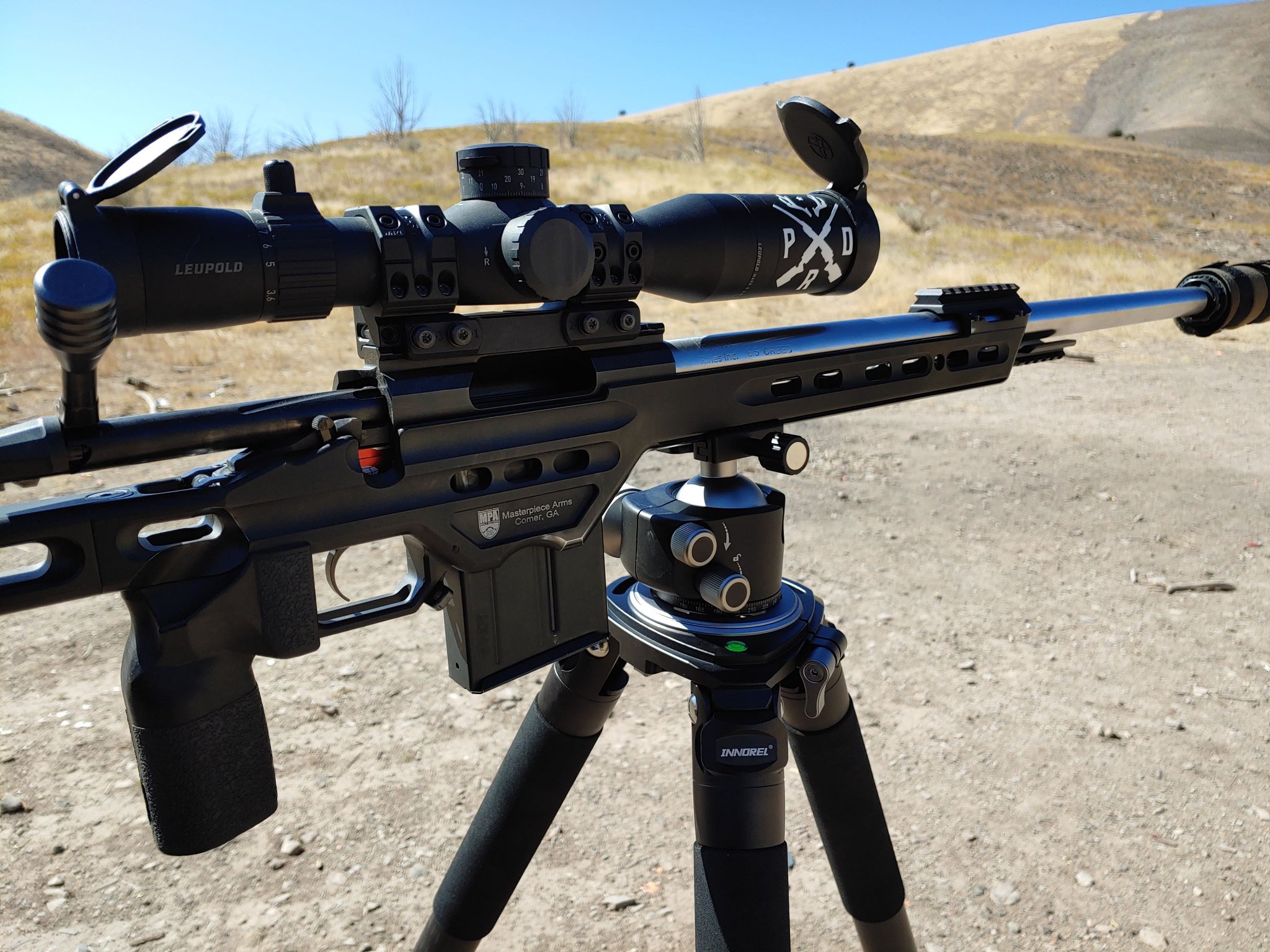

As a result of some research and this thread, I picked up the RT-90C and a Desmond DLOW-55 ball head. Both from Amazon, and I have to say I'm impressed. I've had it out a couple of times so far and I'm still learning how I like it set up in various sitting, kneeling, and standing positions, but it's worked great. First round impact set up in a kneeling position at 835 yds on a standard IPSC target. I also tried doing the free-recoil "demonstration" Frank does at his classes...just to see if I could do it, and I did. As others have said, it's an outstanding value for under $500. The Hide coming through again with solid info to make a buying decision.
tripod-2-jpg.7164375
how do u like that optic? im thinking about that for the SCAR 20S.

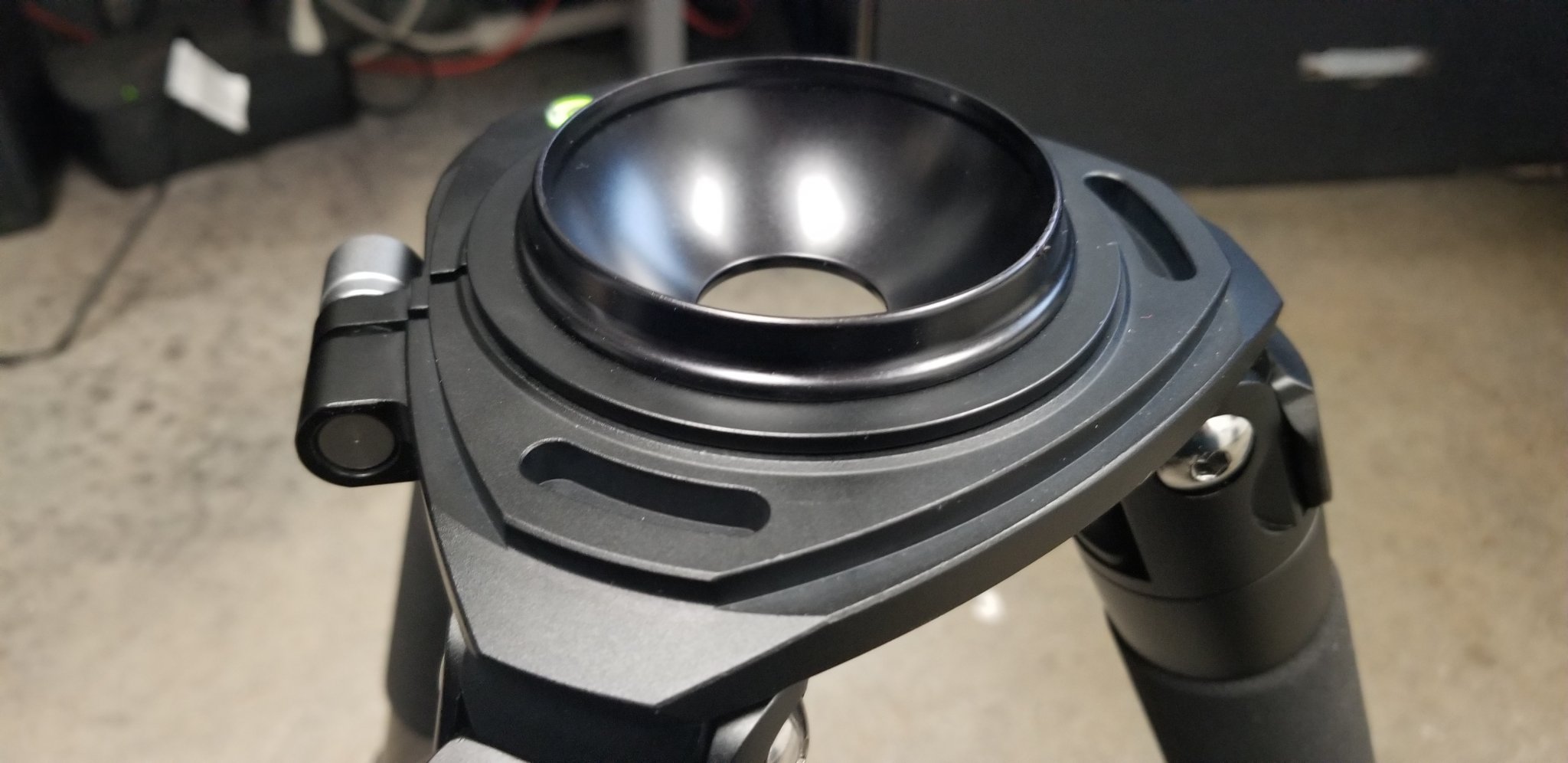

I got the RT90C and the TA-3. As others have said, the bowl that comes on the tripod can be used with the TA-3 but it just doesn't work as well as the RRS bowl does. That being said, if there were an adapter made to mount a TA-3 to the RT90C, would anyone be interested in such an adapter? What would you be willing to pay? Looking into feasibility of having it made and waiting on pricing.

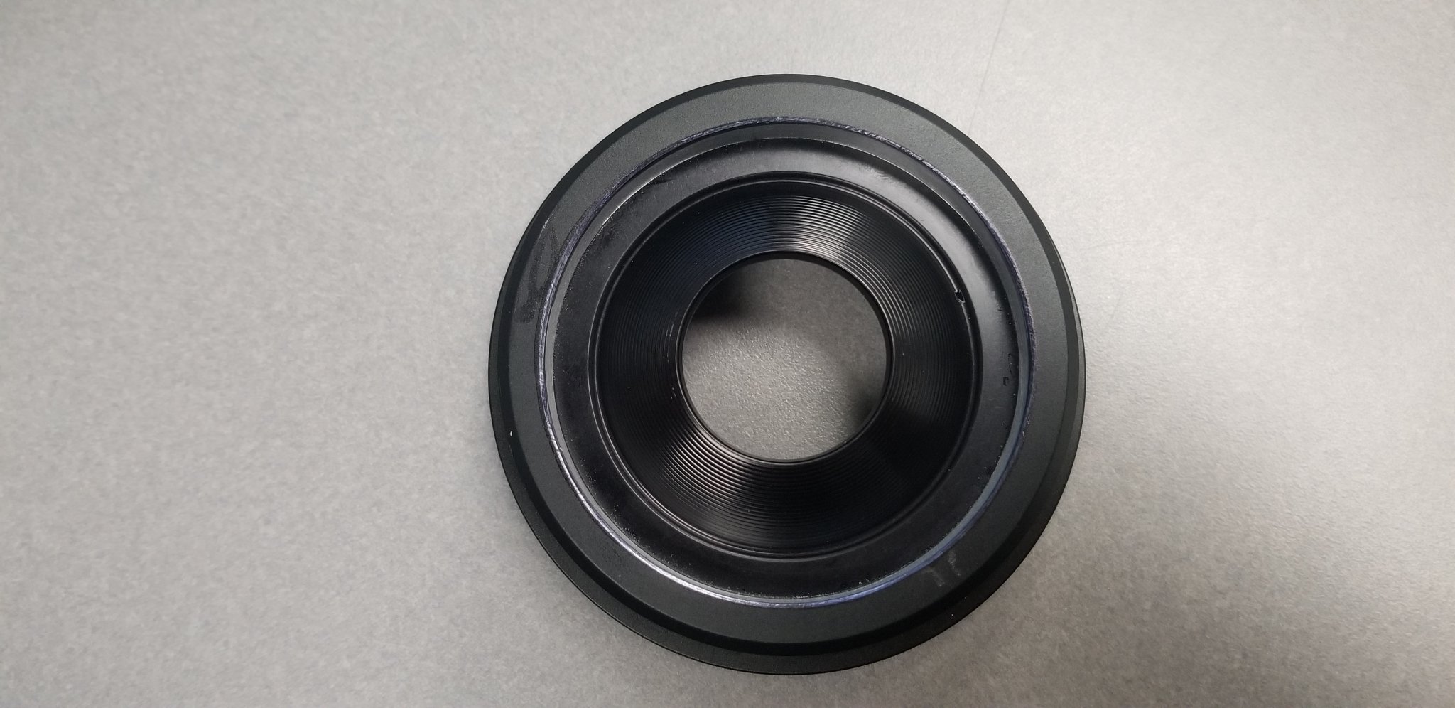

First one didn't turn out bad. Have to test it and see how it works. Milled the bowl that came with the rt90c down to fit the rrs bowl in it and added a set screw to secure it.

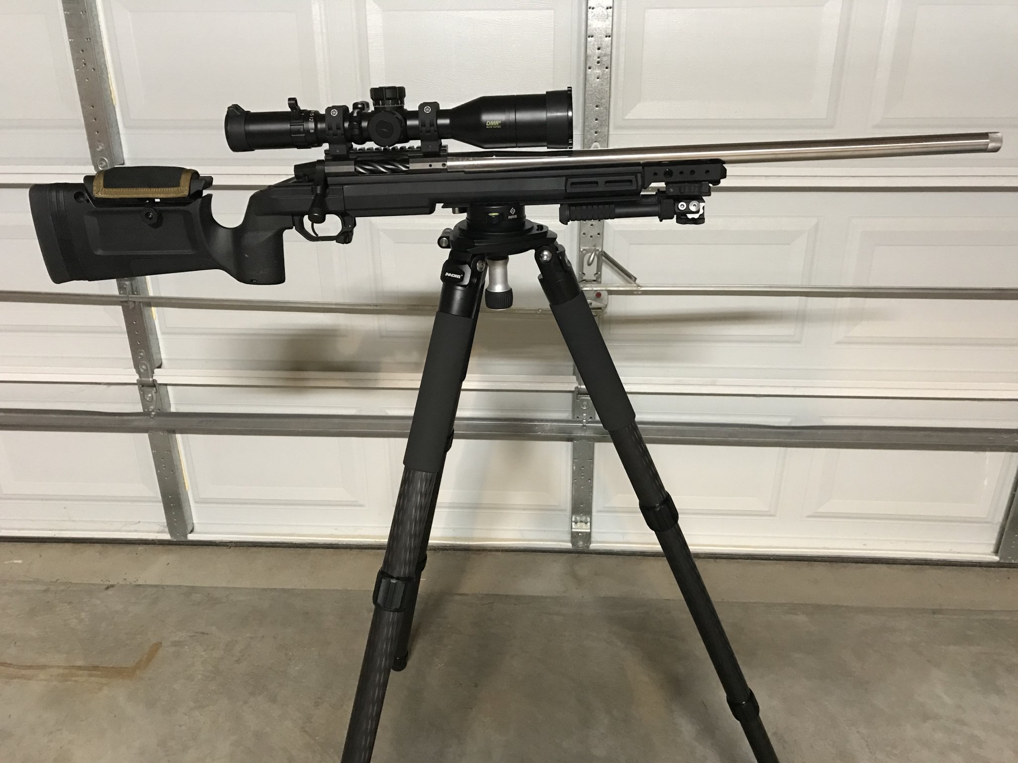

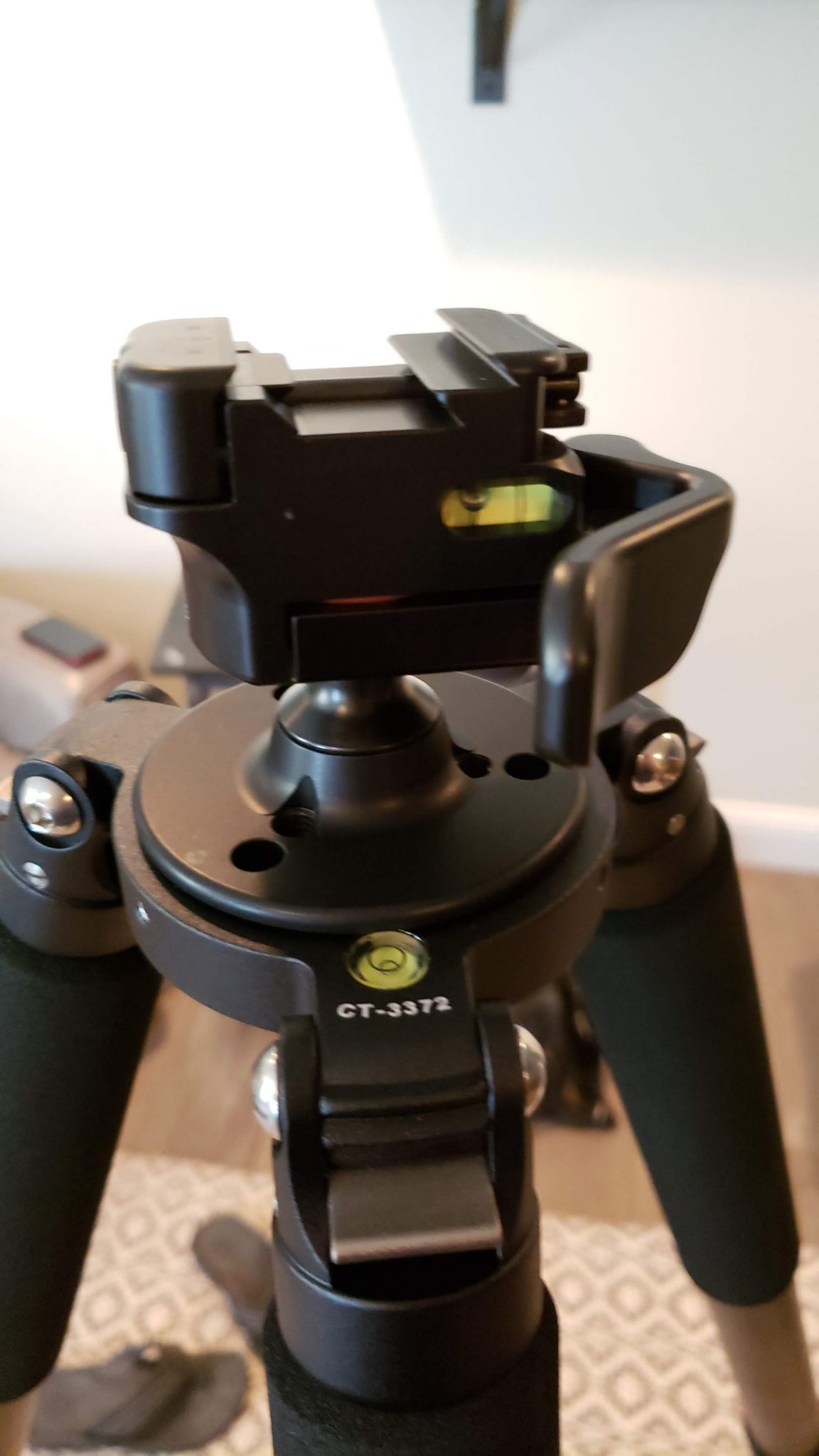

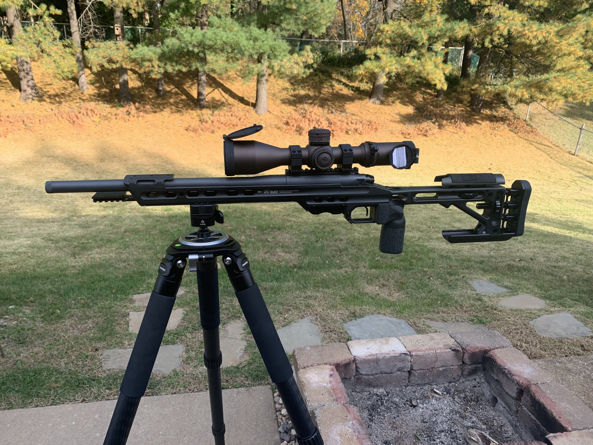

Got mine in and set up, and am very happy with it. I went two directions for the mounting options and I think it works great and lets you mount any rifle in any situation.
1) purchased an Anvil-30 from MH and direct threaded it on. Locks up tight, very solid with my AX.
2) Utilized the bowl that came with the tripod and picked up a used Pig Saddle which directly mounts on the 3/8" on the video bowl. The bowl itself isn't perfect as noted above, but I find that it works just fine with the pig saddle as it innately has a little more play than an arca/pic mount.
Total all-in cost: $732 (excluding tax)
A few pics below, will be headed to the range tomorrow.

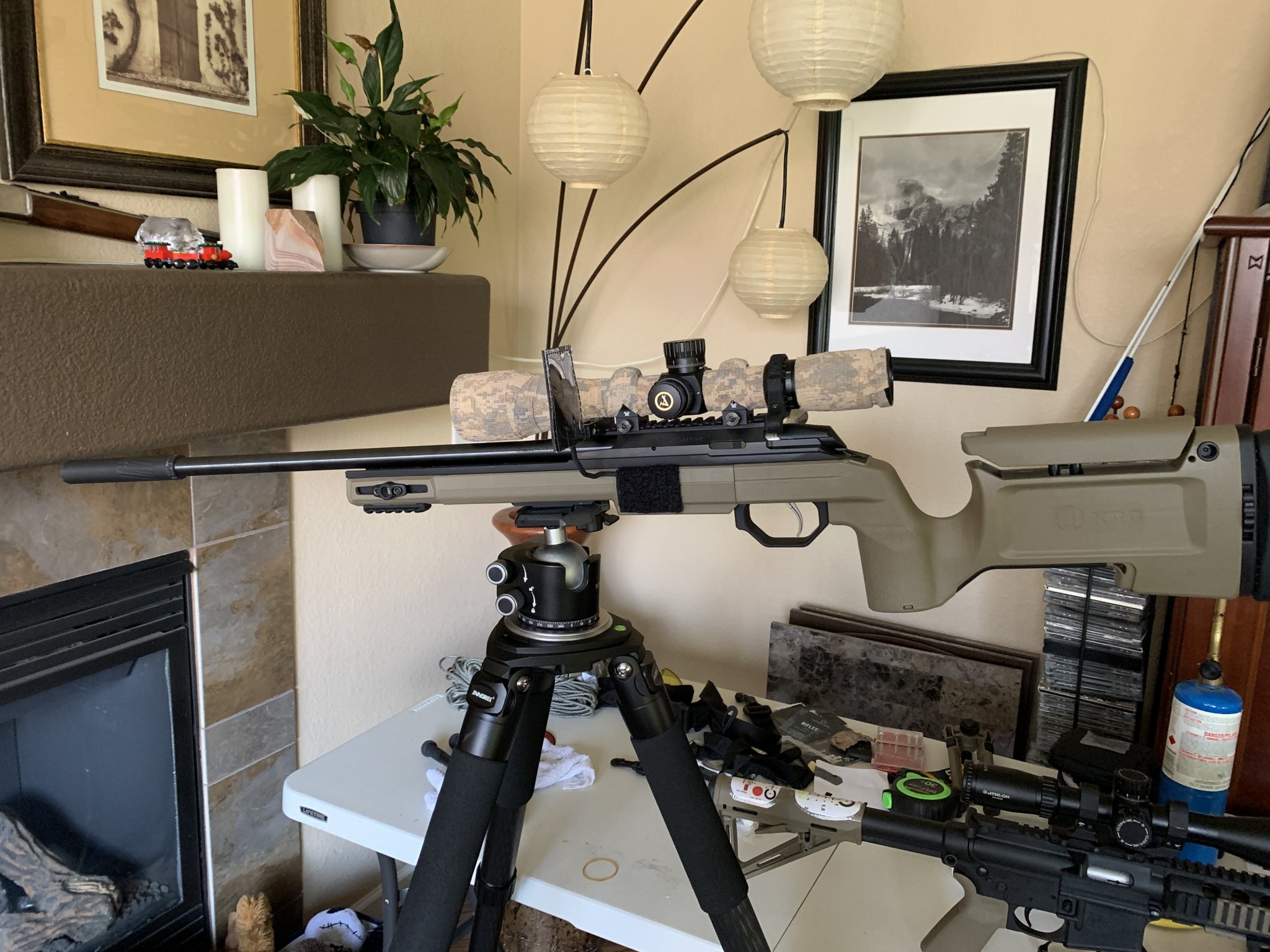

So after reading all the reviews I decided to pick up RT90c. I also picked up the Desmond DLOW-55. I haven’t seen as many reviews on this head but it looked like a knock off of the RRS anvil. Do you guys have any reviews on this set up for range work and hunting within a mile of the truck usage. I have a tikka 6.5 in a krg bravo w/ acra full length rail. Are there any other accessories I should pick up?
I have an RT90C with the Anvil 30 and used red loctite on the threads to prevent it from backing off. It has worked perfectly. I have only used it with my Vudoo to get hits on a 10" plate at 260 yards with free recoil and spot with my binoculars. I am extremely happy with its utility.
i've heard that term "free recoil" a couple times, but not sure what that means. do you mean letting the tripod absorb the recoil and not controlling the rifle/recoil?
The skirt/bushing around the ball on my DLOW-55 slipped and I decided to try and "fix" it. After a blind 'tear down' I was able to determine that there's a set screw that holds the skirt/bushing in place when you rotate the ball. In order to access the set screw you need to remove the largest knob. In order to remove the largest knob you need to access the Allen head bolt under the black disc covering the hole of large knob, all knobs actually, and it's not obvious how to do that. Nor is it easy to get even a razor edge under the edge of the disc to lift it out of place. I ended up heating it in an attempt to figure out how to remove it. So, if you're skirt slips... You're welcome. :geek:
My ball head performs much better than new. Must've been loose from the factory. There was no thread lock on that set screw. On everything else though. Thought I was going to break something while blindly destructing my ball head.

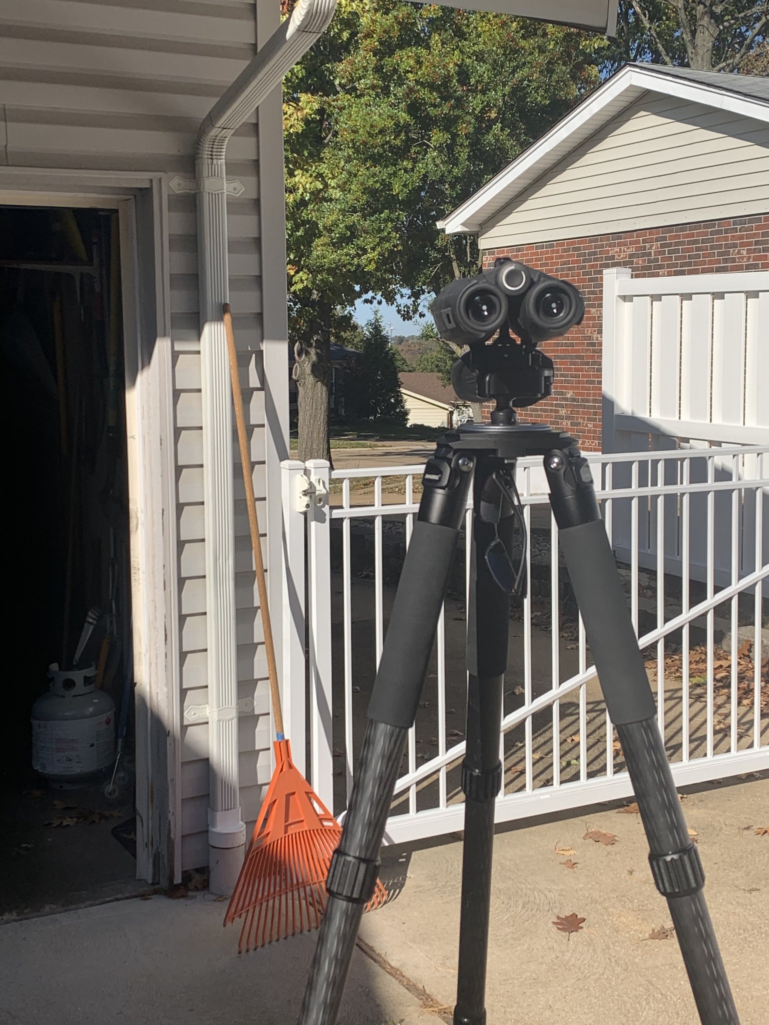

Just got my tripod in. This thing is a beast! I put a shitty little ballhead on it so I can spot with it this weekend, but damn it’s a beefy tripod. I can’t wait to get my anvil on Monday.
