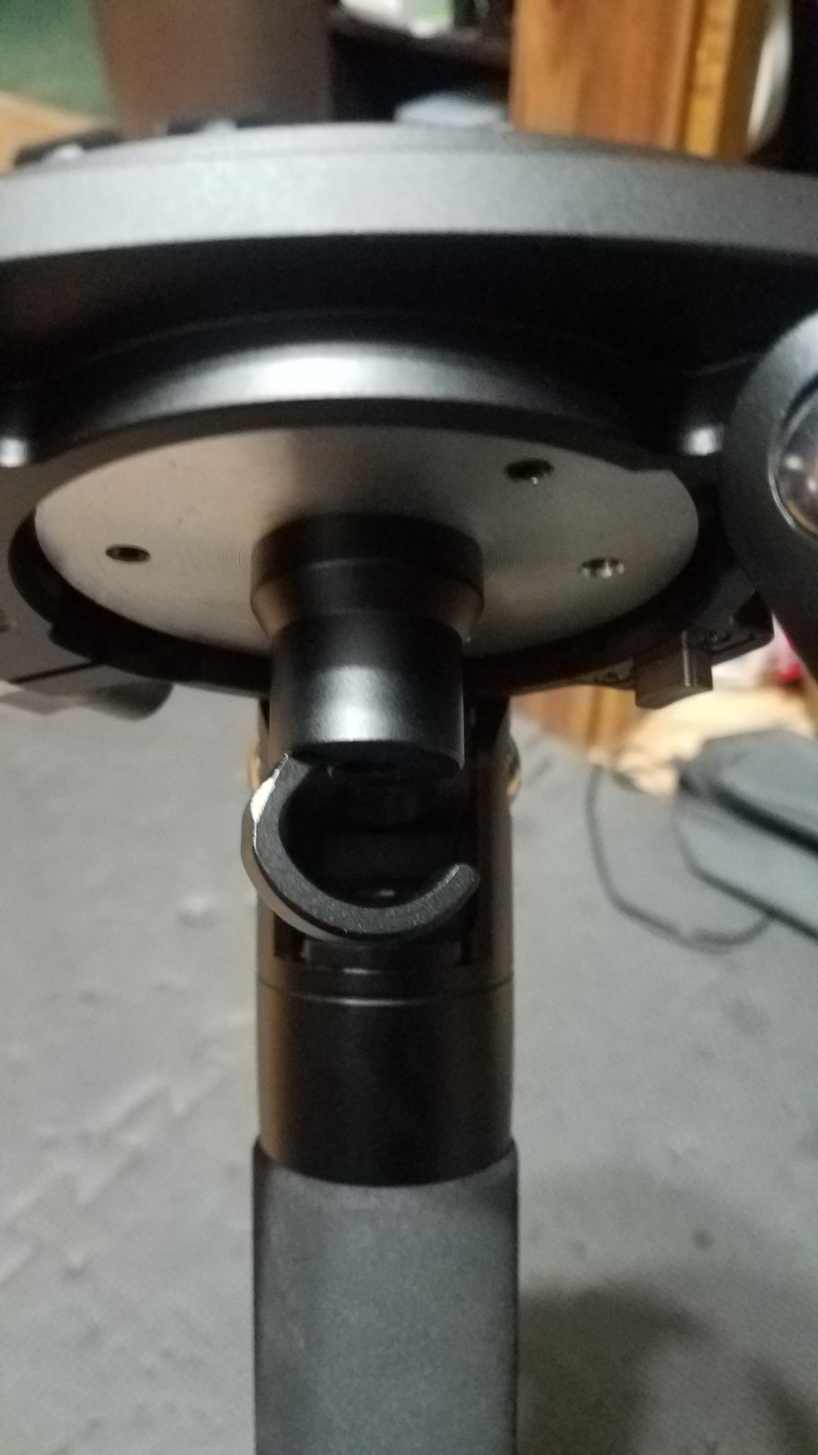

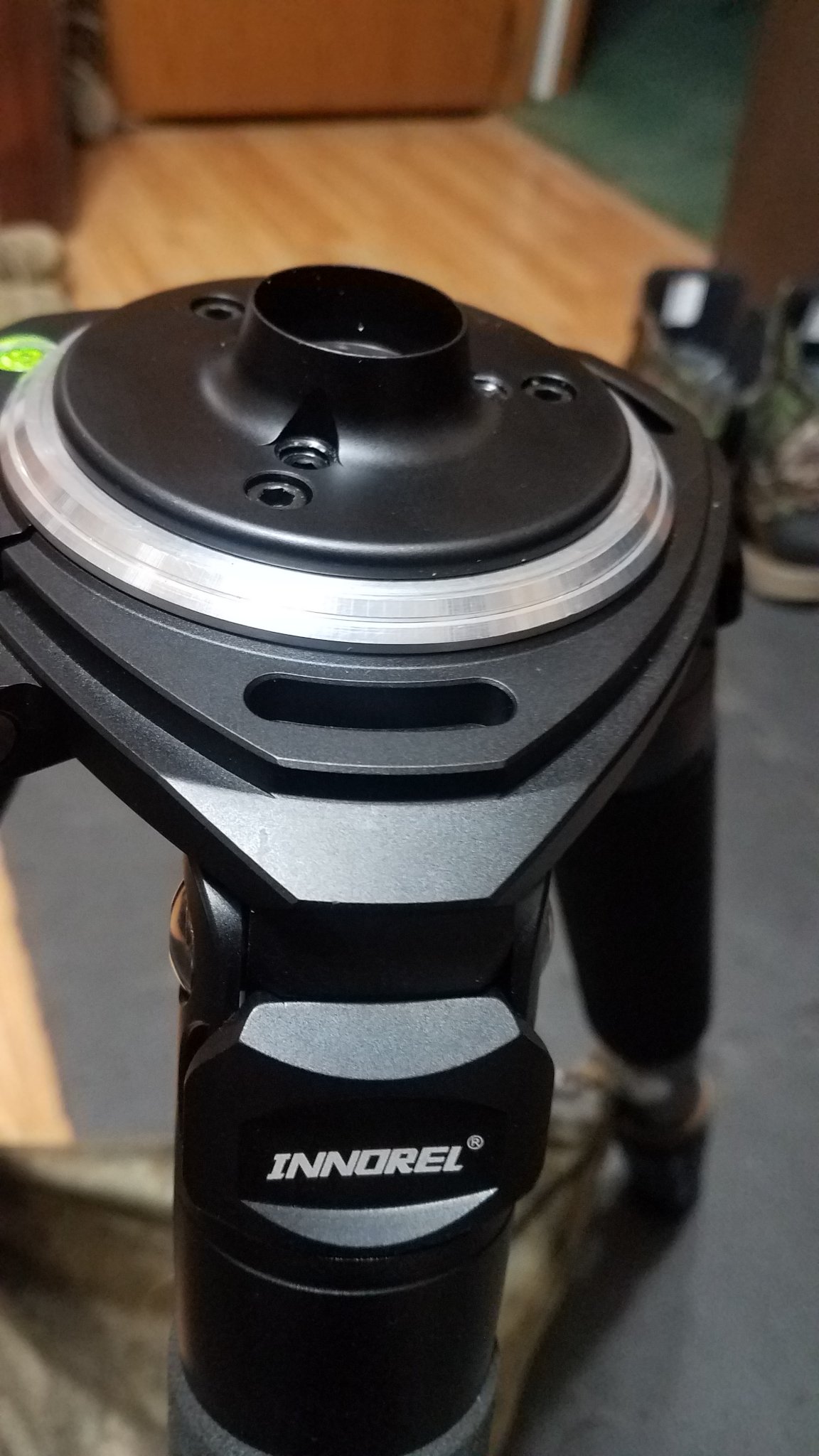

So if both look At the mounting stub portion of the Anvil it actually has a taper to it and then there is four tapped holes and then four non-tapped holes and then there's the center 3/8 screw . Like a snowmobile clutch the center bolt along with the taper should lock into place and adding any 1-4 of the cap screws,will prevent the stub from rotating so you have 5 points of fasting from RRS.
That s were using there plate keeps that integrity.
My first mock up I milled the center cap screw like a star so I could use the 4 other screws yet and they will prevent the 3/8 screw from .rotation. ideally a complete adapter with the tapered bore would be the best but I only get 1 hour of free time to work on stuff a week. . So I try to sub up a few At a time. .

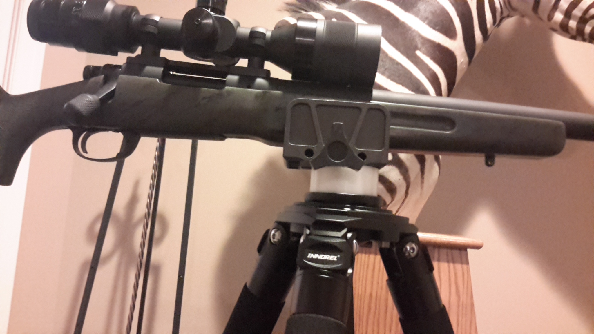

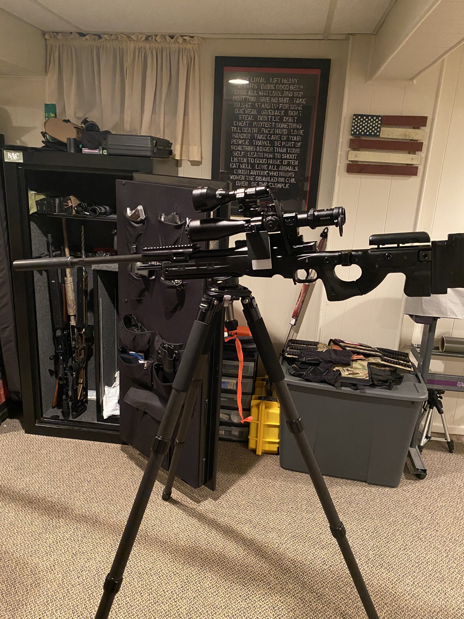

Just got this tripod in the mail a couple hours ago. Initial impressions are great, this thing is a tank.
Standing dry fire with an anvil-30 on top is easily as stable as any other RRS tripod I've used in the past. I'm using the direct thread anvil, so hopefully some red loctite on the provided base will do the trick. I mounted a pig saddle to the 75mm adapter/leveling base that's included, and it is useable, but the adjustment wheel of the saddle hits the top of the tripod unless you cant the rifle/base while tightening it. Not a huge issue, but an issue nonetheless.
I'll try and get some pictures/video of some positional stuff at the local match this weekend.

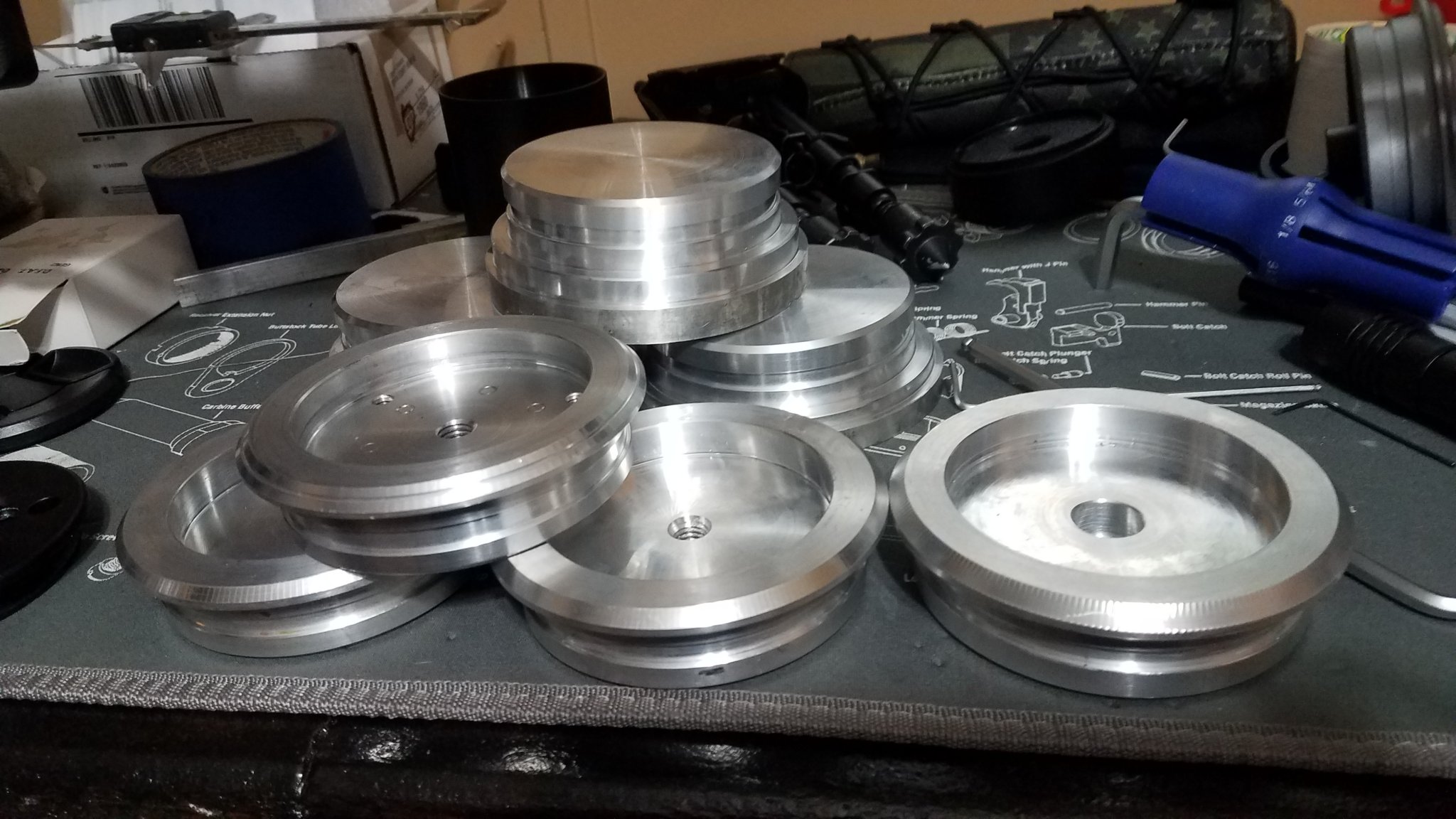

I have 3 that will use the RRS plate I just need to drill and tap .
the other 3 are only finished on the tripod, side so there whichever I need to make . .
I would want one that uses the plate, PM me once you are ready to get more info.

As of right now I have reserved what I have interest from
kriller134 stud mount
* Itleknots plate mount
86Alaskan
* Jefes dope plate mount
Arrow22 plate mount
CavReconScout
I will have the plate mount ones ready Tuesday to ship and krillers by the end of the week .
So no rush on PayPal till there ready unless you want to. But I don't have plans on more till I source materials and have time after these initial 6

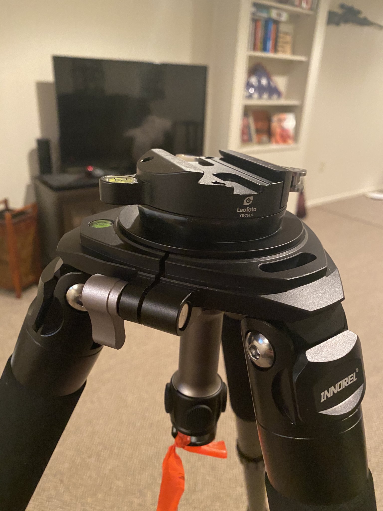

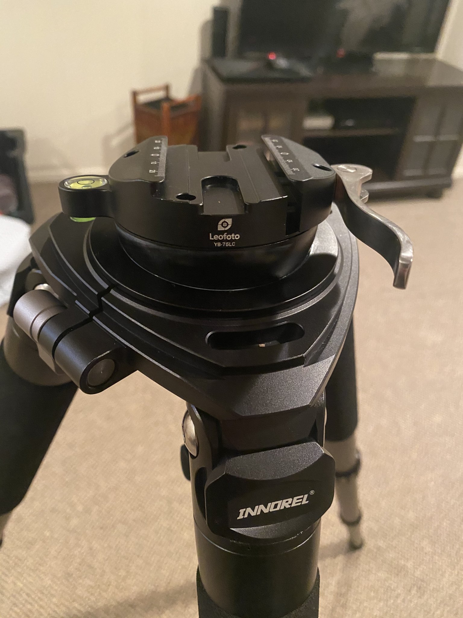

i added the leofoto long handle w/hook to my rt90c. Figured were so many people trying to fit numerous leveling bases. This one fits & functions great. Pics should show exact model number if anyone is interested.

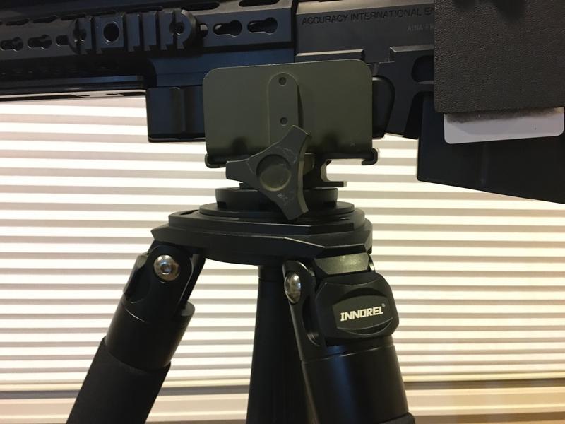

So on mine I just added a lever clamp to the included leveling base. Any reason you want to the lefhoto vs a 30$- lever plate
not at all. After having all pieces in hand I wish I would have saved the $120 and just purchased a lever “qd” lock plate. I assumed the included leveling base would be plastic or cheap substrate. I had seen the leofoto bases and knew were CNC and nice quality. So ordered at same time as tripod. When everything arrived was very impressed with the Tripod and leveling base. Two days later leofoto base arrived and short of the clamp included- its same material and quality. The base is a little larger height wise but does not seem to add any more stability as they both lock down super solid.
Good to know. After adding the clamp.plate I did make a,steel knurled handle to replace the triangular plastic one .
