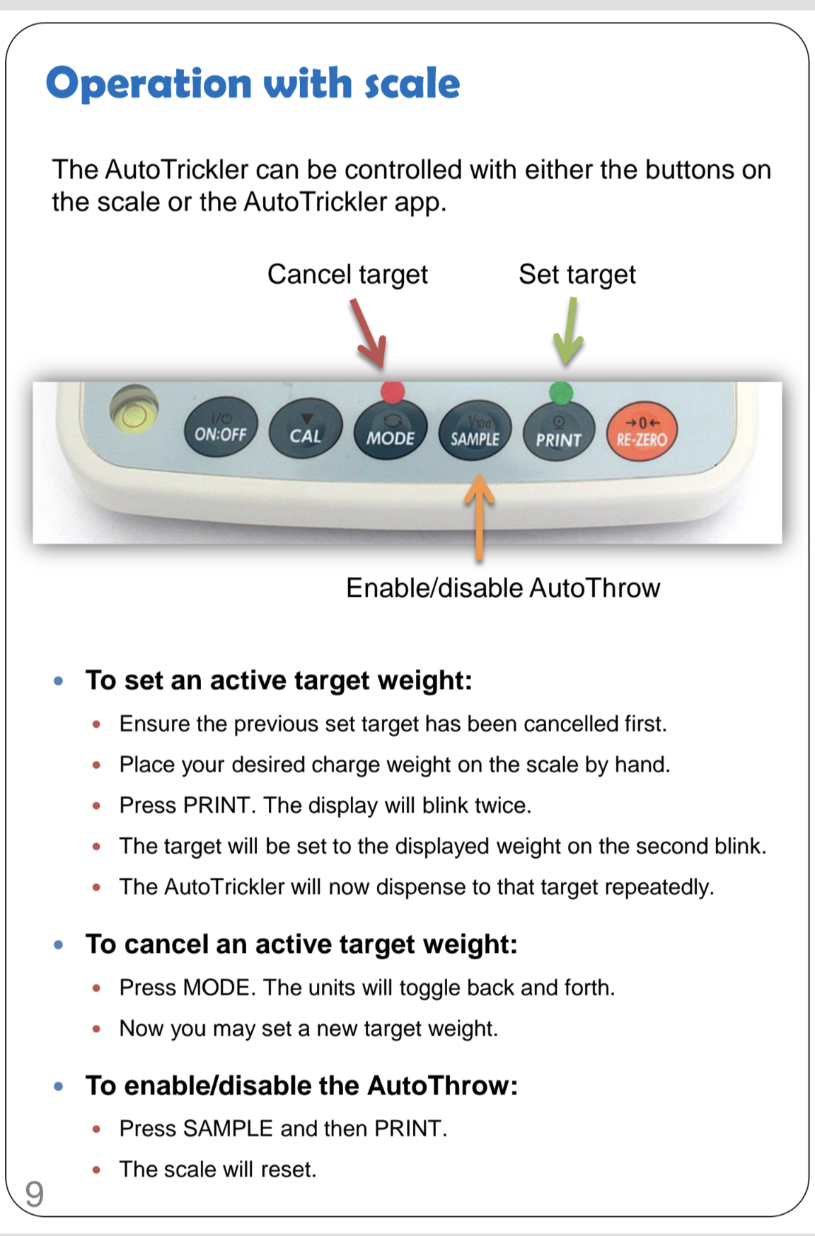

Learn something new every day. How does it know to throw vs trickle, and how do you set this?The ATV3+IP does NOT need the app to run. Therefore, full speed.
You can set charge weight and have it throw thru the scale itself.
I do this myself when I don't feel like booting my spare Android phone up.
What I do is set a bulk weight by pouring powder or by spinning the IP super faster then trickle to my desired weight. Then, follow these directions...Learn something new every day. How does it know to throw vs trickle, and how do you set this?
I doubt anything is pushed to the control board at all. I have 2 ATV3+IP setups and they both run equally fast, one of them never connects to the app.But the code that may have been changed the behavior would surely have to reside on the small controller that is installed in the scale. I don't know how Adam's updates work, but I imagine this is going to depend on if new code was pushed to the control board or not?
The scale and the app are both just control devices for the AT controller board. I don't see how using one vs the other would change its behavior unless Adam forked the code in to two different paths. That would probably cause other issues like not being able to go back and forth between scale and app control in the same loading session, etc.
Now, if you never updated the control board via the app then you would still be on the older version and still at full speed....unless the app forces you to update the board.

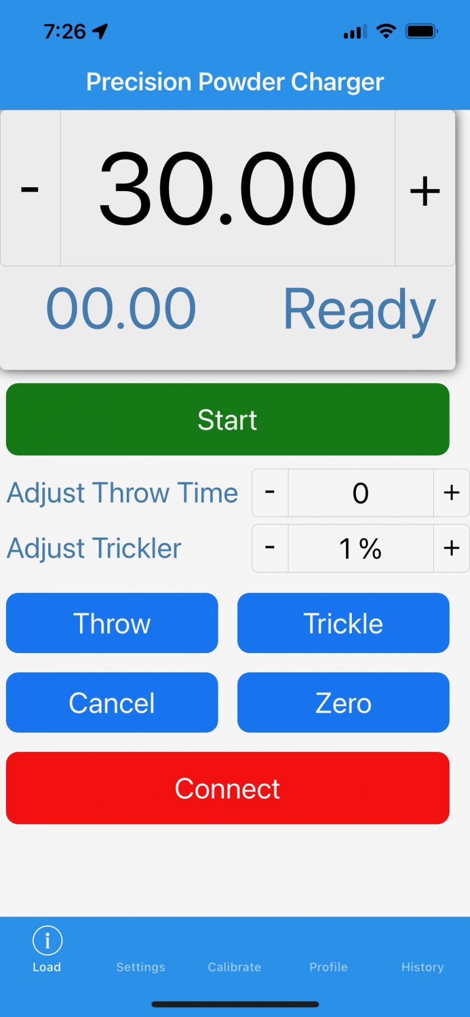

Just actuate the dropper by hand until you get it where you want it, then activate the trickler and system.Here’s a question.
Is there a way to make the trickler not turn on during the initial throw for the powder dump?
If so I could really speed it up
Like this
Oh boy, now you are really going to get it..... I'm definitely going to hit you up on this topic later.Send me a pm. I know how to make that run itself and you won't have to hit single cycle every time.

I hope you aren't getting rid of the touch pad as an option.For the naysayers that don't like the touch pad controls.
Never, comes with both. Run it as you wish. They both can do same thing but the app does give you multi touch capability, like naming a saved load vs assigning it a numberI hope you aren't getting rid of the touch pad as an option.

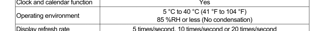

1. Will the thrower/trickler be affected by temps (hot or cold). Users have seen issues with other designs locking up or changing performance in temp extremes.

The thrower and trickler are not affected by temps to date, but I’ll make sure to put one in the freezer and one in the dehumidifier to make sure as I’m sure somebody will try it. Lol

I reload in my garage so temps could be 25 in winter and 105 in summer so if it’s not going to work in those ambients, I’d like to know in advance.The thrower and trickler are not affected by temps to date, but I’ll make sure to put one in the freezer and one in the dehumidifier to make sure as I’m sure somebody will try it. Lol
