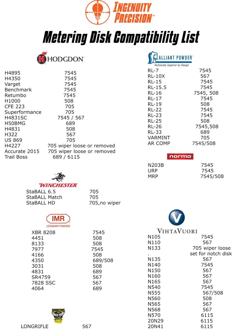

What I don't get is, why Retumbo? It's a pretty basic stick powder, not physically much different than H1000, H4350, etc. It doesn't have the huge kernels of say, N570, so why is there a problem with Retumbo and not the others that are physically very similar?
Beause recent lots of Hogdgon powder have been shit. I've had clumpy Retumbo, H1000. Nothing has consistent burn rates similar to the same powders made 2 years ago. My new H1000 and H4350 are 1.5-2 gr slower than stuff from few years back. That can be a problem with smaller cases. They sell it so fast, they don't care if QC is poor, get it on the boat and get it sold.........
New lot of XBR is doing the same thing, clumping a bit, needing extra charge weight etc.
I do think some of the discs will need a revision for certain powders, using the same 7545 disc for H4350 and Varget is fine, but XBR and AR-comp... is maybe a stretch.
Good news is disk cutting a modified geometry sould be pretty easy and seems pretty basic. The harder part will always be finding time for the R&D for some of the harder to get powders and testing them...ADI seems to only put certain things on a boat once every 2-3 years...
Uggggh, that's really disappointing. I do have some jugs from recent lots, but I haven't opened them. I still have quite a bunch that is from pre-Covid and I'm still loading it. I really hate to hear that my recent stores are going to be crappy when I get to them.
Retumbo when it sits for a bit gets clumpy. Not an issue when you first pour it in. Let it sit for a bit and you can see some clumping issues. It has not affected performance in testing but because someone might leave it in the hopper for an extended period, Paul is making some changes.
So just cause some dumbfuck cannot be bothered being non-lazy the whole thing gets pushed back? Want my money back! /s
In all seriousness: How long do you think will this push the schedule further back? Just a rough estimate.
Reactions: Herb Stoner
Ah. Well, I never ever ever leave powder in a hopper any longer than I have to. When I’m done with the session it goes back in the jug right then. I guess that’s why I haven’t seen it happen in the hopper. In the jug - yes. When you open a new jug there may be some clumps that need breaking up initially but I’ve never had any form in the hopper. Thanks for clearing that up!

That’s been Paul’s or my experience. The benefit of these changes is for those dropping big charges of a 100 grains or more this makes the bulk dropper more consistent.

How does it do with ball powder?
Excellent for most. The dropper works great with ball powders and even the finest pistol powders. Dropper alone in testing was able to drop as little as 5 grains of pistol powder consistently. The powder meter with the ball powder disk works great with the Staball powders. Once you start to get powders as fine as CFE223 the powder meter has issues due to clearances required for the disk. Now Paul does have some ideas for a disk that will work with all ball powders but expect that to come out after the first batch of the new units ship.
Thanks I use a lot of 2000 MR.
The new setup will be faster. Is it enough to justify the cost is up to you. Why I’d recommend buying is that AutoTrickler is not doing anything for older systems. With the new IP setup your getting a better system that does away with the week points of the AT V2 and V3 setups and you’re not gonna need to worry about hardware upgrades any time soon.
Well, yes...but it won't do any of those wonderful things until he releases it.
Personally, I'll wait...but I'm getting old...so tell Paul to hurry! haha
With staball, A 2520, and TAC the trickler does absolutely fantastic. I can actually drop a single "ball " more if I want to by a single click on the top of the trickler by hand. It's not ever needed, but if you want to get that .0xgr the exact same reading each time, you can. I added a little piece of steel rod inside that tube that holds the ball bearing that detents the disk to add some weight to it. Others have bought a small spring to fit in there to do the same thing so the click is a little more tactile but even without any mod, you can release a single ball if you want to.
The trickler works Excellnt for those ball powders as well as 4350 but they are different disks that it uses.
Reactions: Jrb572 and Baron23
would be nice to have a list with 3 categories:
  1. tested extensively, works with but a rare hiccup
  2. untested/unknown/preliminary results
  3. known issues (CFE223, etc)
Paul once told me that if it is not on the list then he has not tested it. Hopefully he has tested more and needs to update the list, but that is what is listed on his site as working with the trickler. No idea if any of these have intermittent or ocassional issues. And this is ONLY for the trickler piece. We have no idea what has been tested with the bulk dropper.
You just trying to be funny now? I’d expect you’ll get it much sooner than that. Once everything is in full production then the next batch will be produced much faster.
Not really, but sorry, I placed my order (actually two as I had no idea how to change the first one as I bought a scale (A&D FZ120i)) about a month ago and with that many orders I was guessing about 15-20 a month ship (small business, not a huge staff) with some ramp up and a 30% cancellation rate I figured 2-3 years.
