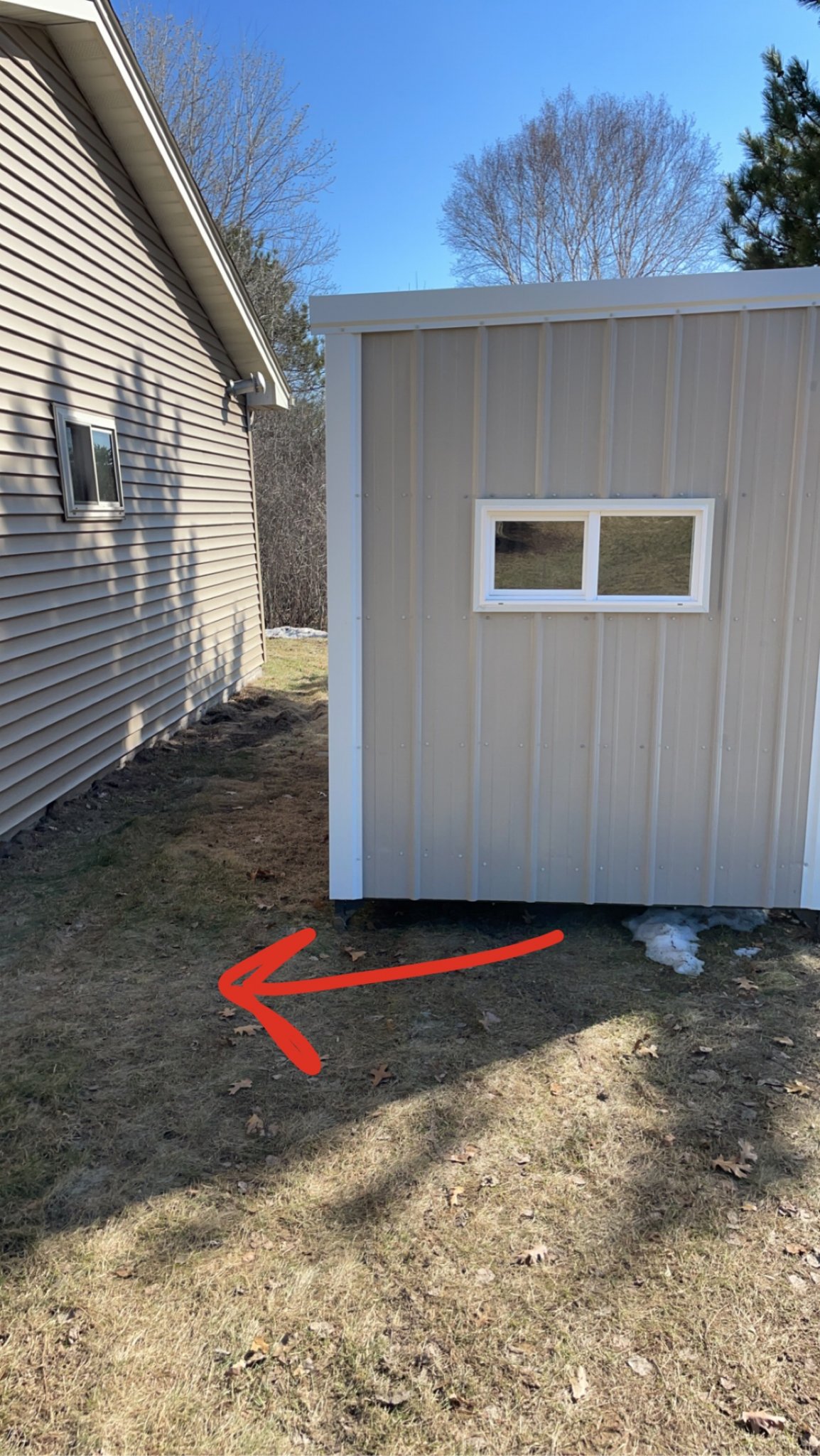

    Now that Mother Nature is done being a sobbing baby, and the temps have warmed, our ice is gone and I’ve no more need for a fish house. At least for another six months.
    I’ve got it off the lake and have it behind my garage.
    I was able to pull it into place with the truck but wrecked the lawn, and a lot of it.
    Now I need to get it closer to the garage to clear up another 4 feet of yard.
    I’ve got a trailer tongue jack to lift it, and some other misc stuff, tie downs, come along, four wheeler, etc at my disposal.
    What says the hide?
    Any good ways to move this thing without destroying the rest of my yard?

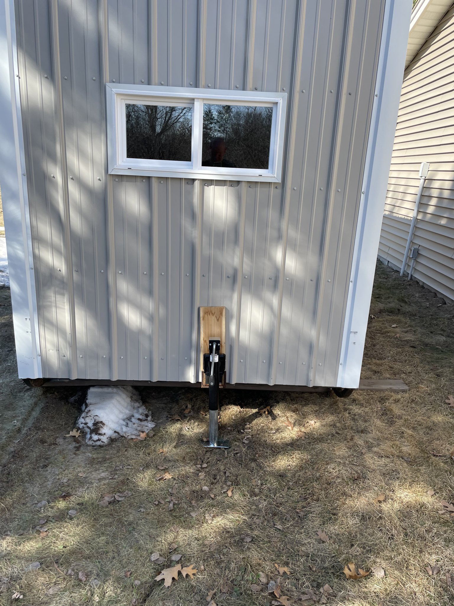

    Here’s the jack. We’ve modified it to lift the house.
    Jack it, block it, lay timbers under it, set it down on said timbers and slide it into place.

    Looks like the skids are parallel to the house which makes this more difficult than it needs to be. 😂 Just put a couple 2x8s under it and push it with an atv with a 2x12 on the front to distribute the force.
    In your second picture, you've already got a plank underneath that the skids are sitting on. Raise it higher, and put another plank underneath the first one, as well as some round items of similar size between the planks. 1/2" black iron pipe, or ANYTHING like that. By yourself, you could easily move that shack with very little effort. (after you put a pair of planks under the other end, too)
    This is how equipment gets moved, daily.
    Reactions: PinesAndProjectiles
    We move bigger and heavier mills at work on 1" pvc pipe(when we cant use the crane)... the bigger stuff doesnt hold as much weight, but rolls better on rough floors or dirt.
    Pvc is smooth enought to use as a "track" too... two pipes long enough to get it to its destinat I on and it will slide like its on rails....maybe help it along with a 2x4 as a lever.
    It works.

    I like this. I can get some pipe. Good idea!

    This right here.
    What does it weigh? Get a few lads and a couple of straps to carry it.
    You have it jacked up seemingly without issue, so it's likely not that heavy, or the ground is hard enough to not worry too much about rollers
    Get a cake pan, fill with water and freeze, repeat 4 to 6 times. Jack up the house and slide the frozen pucks underneath. They will glide pretty easily and as they melt provide their own lubrication. When you get it where you want it walk away, The sliders will "magically" disappear!
