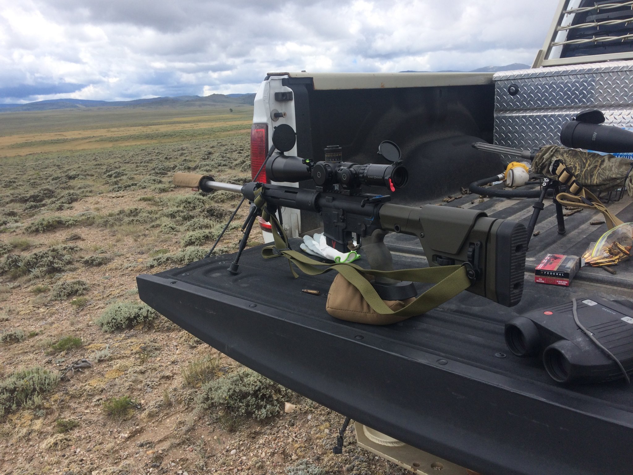

Mine is a 24" 6.5 twist shilen and its doing well with the 90s. I took it to Wyoming last weekend for prairie dogs. My longest first round hit was 670 yd's. I shot it on a steel range out to 1015 yd's and it grouped about 10", I didn't have a tape. It shot a 4" group at 800 on a 10" plate. It's a lot less wind sensitive than my 223 A.R . The 90s don't kill as quick as the light weight bullets, some I hit twice to finish them off. The wind was 15- 20 mph all day Saturday, so the Valkyrie was working way better beyond 500 yd's.
Mine is a 24" 6.5 twist shilen and its doing well with the 90s. I took it to Wyoming last weekend for prairie dogs. My longest first round hit was 670 yd's. I shot it on a steel range out to 1015 yd's and it grouped about 10", I didn't have a tape. It shot a 4" group at 800 on a 10" plate. It's a lot less wind sensitive than my 223 A.R . The 90s don't kill as quick as the light weight bullets, some I hit twice to finish them off. The wind was 15- 20 mph all day Saturday, so the Valkyrie was working way better beyond 500 yd's.View attachment 6916139
