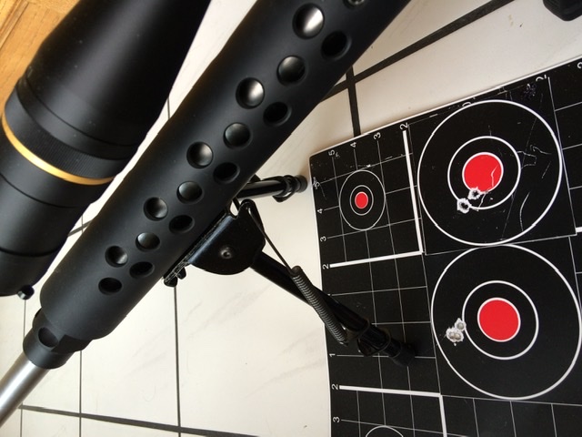

OK ... here's the update. Got my 22" 6.5-twist .224 Valkyrie upper from White Oak Armament ... and it's shooting half-MOA right out of the box with 88gr Hornady ELD Match ammo. That ammo was consistently shooting 3+ MOA from my 18" 7-twist Pro2A upper. Switched the 18" Pro2A 7-twist upper to lighter rounds (75gr Hornady Black) and the 3+ accuracy went to pretty much 1 MOA. (WOA 1/2-MOA group attached below.)
Lessons-Learned:
  1. Heavier .224 bullets need smaller twist rates ... 6.5 seems optimal.
  2. Lighter .224 bullets need larger twist rates.
  3. Longer barrels are better than shorter barrels when group size is the priority.
  4. White Oak Armament makes screaming cool uppers.
  5. In this game ... spend less - expect less.
Here endeth the lesson.

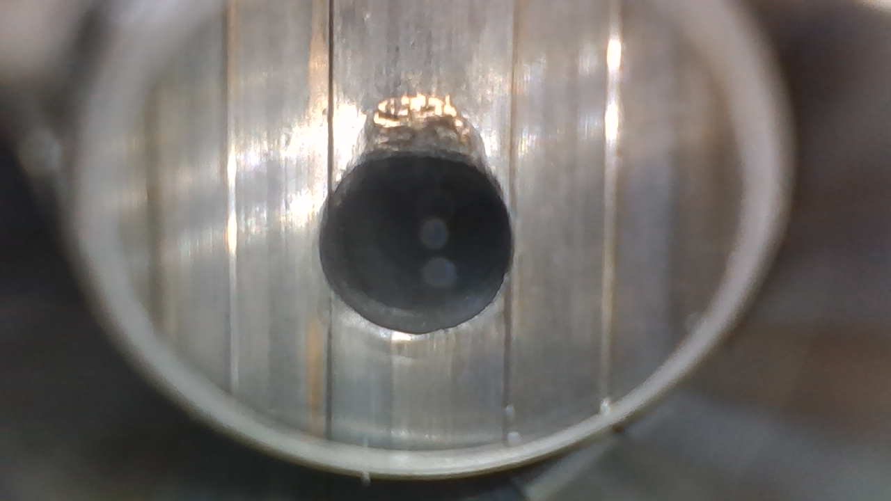

What's your perspective on WOA barrels? I got this one, and I'm still struggling with accuracy.
Still searching to solve my .224 Valkyrie "3-MOA-Mystery" ... used an endoscope and saw something I've never seen in my limited experiences. Gas block holes are always pretty "crisp" on my other rifles, but this one looks different. The imperfection is on the bolt side. Rest of the barrel looks fine. It's on my relatively new WOA barrel ... only 40-ish rounds through it, and after solid barrel break-in cleanings.
Should I be concerned about this? Or is it a "Nothing-Burger"?
