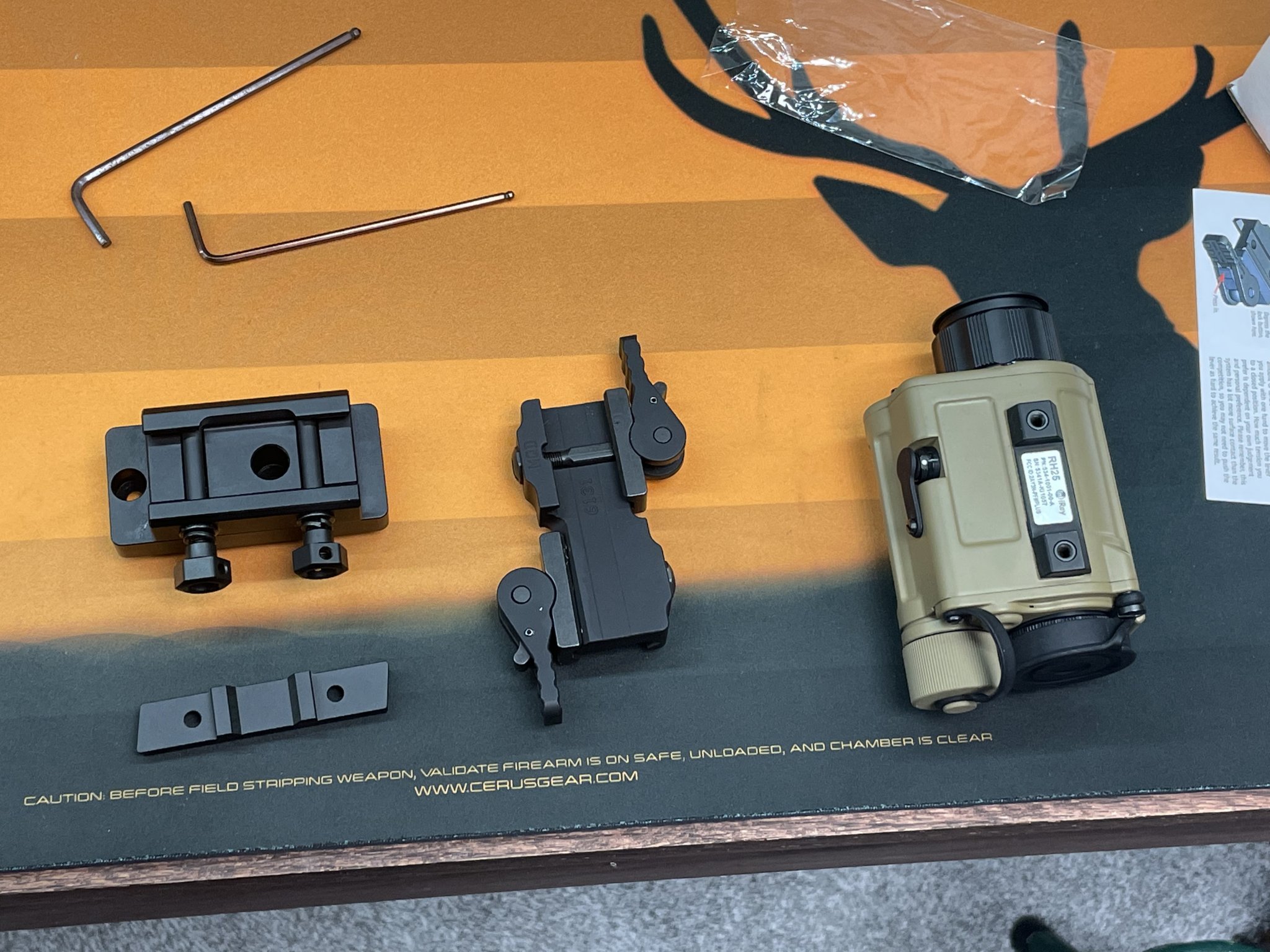

I’ll update once I get the Obverse mounts and hope to have better news.
