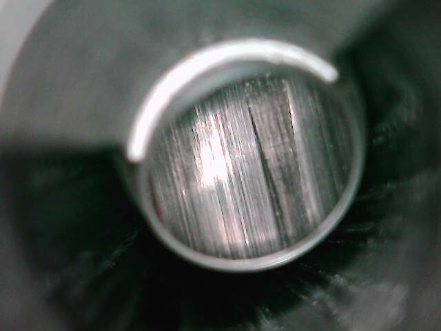

I finally got out my bore scope for one of my semi autos with a Criterion nitrided barrel after some accuracy degradation, and holy cow is this thing stuffed full of carbon (100% suppressed shooting). I clean all my stainless barrel with JB to get hard carbon out but am hesitant for nitride. I know nitride is hard as hell but something about scraping it with an abrasive gave me pause. Saw some anecdotes here and there about rubbing the nitride coating off down to the bare metal, but as I understand it nitride is a hardening treatment, not a coating.
Unsure. Just want to check before I go do anything stupid.

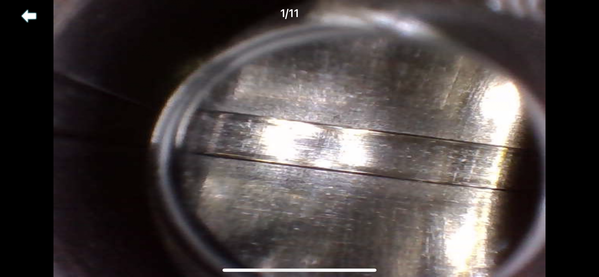

Hi guys! So I used JB compound with Kroil on VFG pellet to clean this barrel. I’m new to seeing carbon and copper fouling so I’m not so sure what the condition is on this barrel after cleaning. Give me your expert opinion if more cleaning is required. The barrel does look a tarnish color as seen in the picture. TIA!
Whatever you do, do not use it on a nitrided barrel unless you don't like the nitride coating. JB's removes the nitrided surface and leaves it bare metal again. I did it to my 11.5" ARP 5.56 barrel after I saw a strange "ridge" down the bore. Afterwards, H bore scoped it for me and confirmed I had removed the nitriding. The barrel shoots good, but there is no more protective nitrided layer.
That's more than enough, like Full Retard Mode. If you're cleaning your barrel on the regular like that you're definitely over cleaning. In my experience taking your barrel to high polish increases copper fouling and seems to take longer for your barrel to settle back in.

You haven't disclosed what barrel blank this is, but regardless JB should only be used a couple times in the entire life span of your barrel. Basically maybe once after your first 100 rds, and then maybe once more somewhere in the mid life of your barrel IF NEEDED
it doesn't matter that you follow the instructions on the JB cleaning process you have to use common sense, it's a tool you use maybe once or twice in the lifespan of your Barrel not a regular cleaning regiment.
Yes you're definitely over cleaning your barrel, and you only need 3-5 5 stroke passes with JB at max.
The polish/finish inside your bore has absolutely nothing to do with how clean your patch comes out, I honestly don't even understand why you would connect those two??
Inside the throat of a Bartlein barrel after its first 100rds utilizing the below cleaning regiment... as you can see not a mirror polished, and they all shoot Sub Half MOA.
This is the same barrel I used this weekend at a local Precision Rifle Match in one of my Custom SP10's I built, after the match (86rds later) I had two shooters from my squad that wanted to try out my rifle.. both of them shot 1/2 MOA 5rd groups off a bench at 200 yards.
I use a few sprays of Hoppes Black Cleaner on a ultra soft nylon brush, spray it on the brush and make 5 passes removing the brush before pulling my rod back through the bore and this is only to ensure I have the bore thoroughly coated with the cleaning solution inside the bore and to remove any debris. After that I let it soak for about 30 minutes while I clean the BCG and everything else. Once it's had its soak time I start pushing patches and by the 3rd or 4th patch its done! The 4th patch is spotless, maybe some slight blue from residual cleaning solution left over in the throat area or inside the Gasport.
