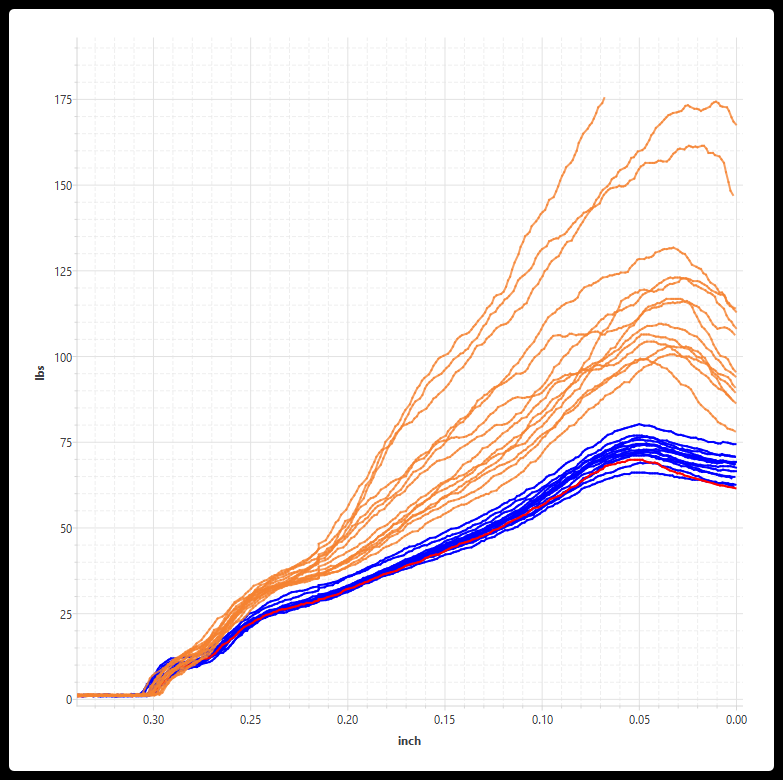

I've done some fairly extensive testing on this. I compared neck lube (neolube) vs. no neck lube in my 300 PRC over nearly 100 rounds for each modality.
With neck lube, I got, and still get, low 6s for SDs over large sample sizes. Without neck lube, SDs were in the 8.x range. Again, this is over close to 200 rounds of total testing. I also saw a noticeably larger group size for non-lubed necks (all shots at 500 yards), but I can't definitively attribute this to the fact that I wasn't using neck lube on those bullets due to the fact that using neck lube changes the pressure profile. I can't say for sure that I couldn't have tuned the non-lubed rounds to get better groups.
For reference, here is a plot on my amp press showing seating forces of the two. Guess which color is the "no lube" group.
I have also done extensive testing on seating force consistency and the correlation to muzzle velocity SDs.

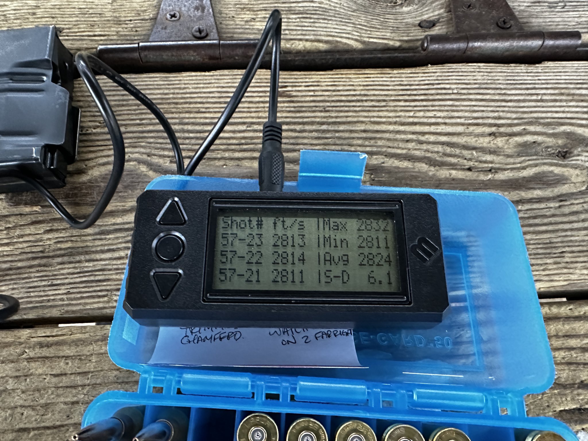

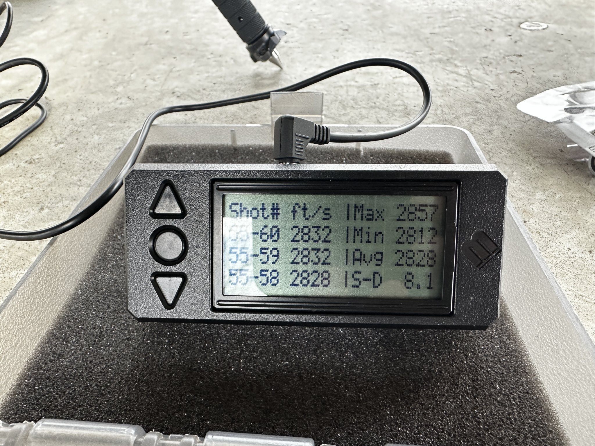

I've tried thousands of rounds both ways and the ones where I lubed the inside of the neck before seating bullets consistently yield lower SDs and smaller groups. I can make ammo that has single digit SDs without lubing the inside of the necks, sure, but I don't anymore, because the extra step only takes ~2mins and I know the ammo will come out slightly better and the SD number will be smaller, so I do it.

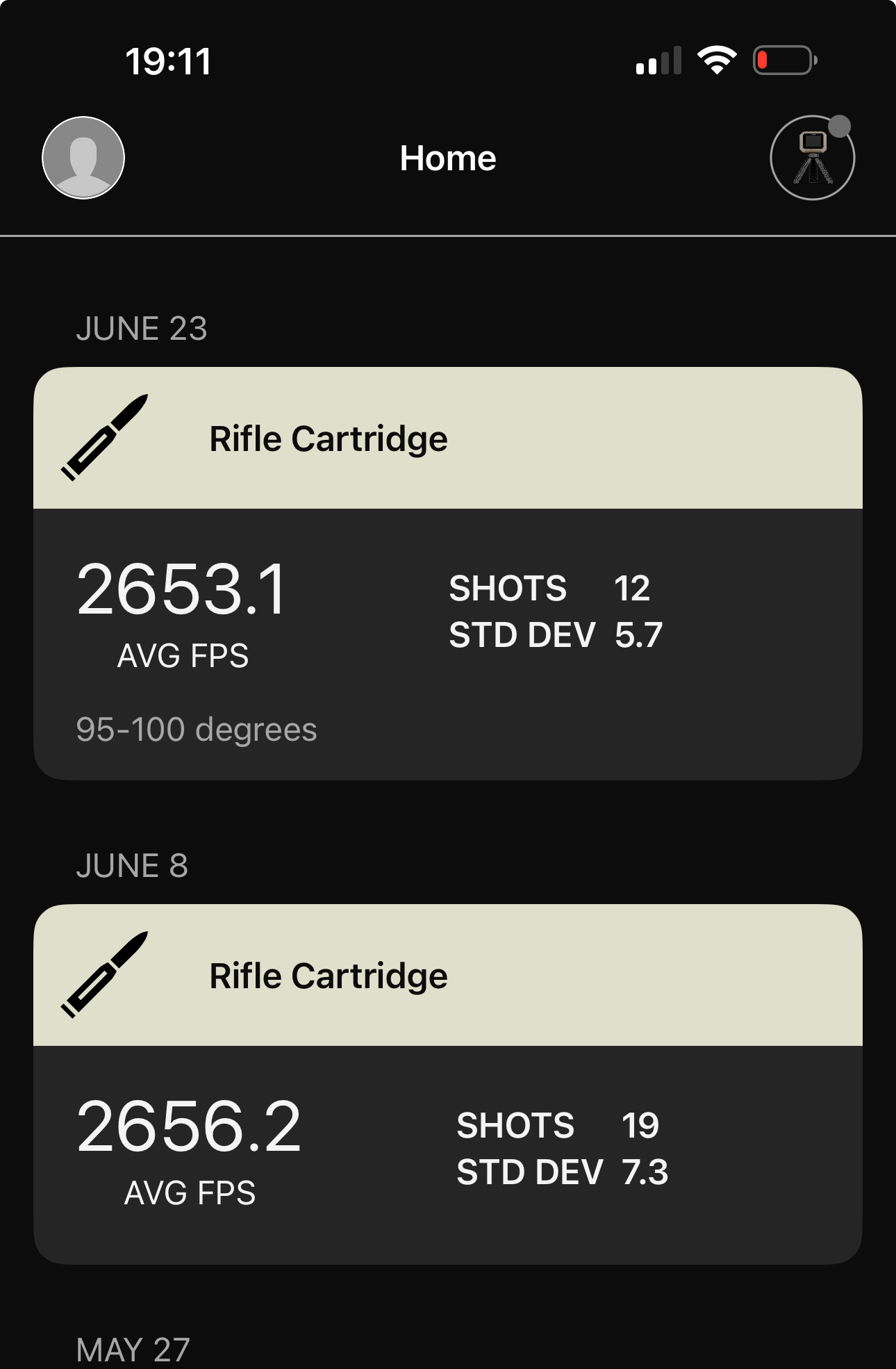

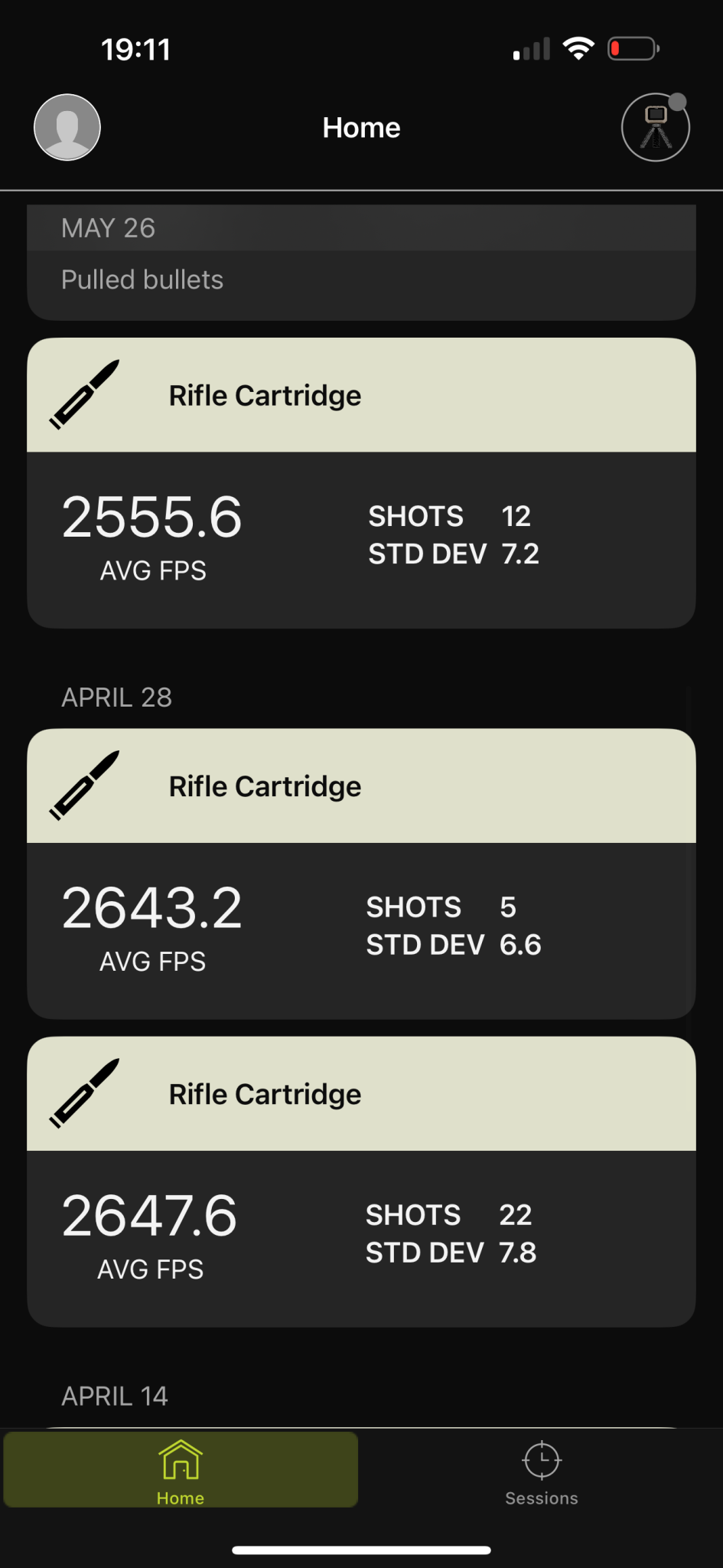

I tested neck lube in the case and found it to matter zero to SD/ ES. I also clean my brass extremely well every firing but did not see a change in SD/ ES and found it very easy to shoot 5-7 SD with just a rub of alpha sizing brass on the outside. That said, I don't go out of my way to avoid the inside of the case; I just don't swab it, either.
Everything you do always seems to be contrary to the rest of the world, yet there’s never any data to support your anecdotes.
Yet somehow when I post my groups those also aren’t good enough for you?
It’s almost like people are doing a bunch of unnecessary steps that just add more variability and don’t lower sd/es…… if only I had spent years shooting f class and testing this stuff.

You don’t have any actual data there. 12 shots may as well be none, and the Garmin will always display a lower SD because it uses population rather than sample. You should lube your necks.
There’s 19 and 22 shot groups and I just pulled right off my Garmin as I sat here. Not your cherry picked bs from last year.
