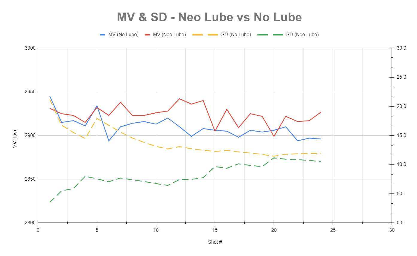

Okay, I finally conducted my test of lube (Neo Lube) vs no lube.
For this test, I used my .300NM. Exact same load for each, one had no lube in the neck, the other was lubed with Neo Lube after scrubbing carbon from the necks.
This was my load:
- Berger 220 LRHT
- Norma brass, once fired
- CCI 250 magnum primers
- 83.0 grains N570
Each set had 25 rounds. I would shoot 5 rounds from the no lube set, followed by 5 rounds that were lubed, over the Magnetospeed. I took my time shooting to not let the barrel get too hot, conducting this test (50 rounds total) over ~3.5 hours.
Here are the results:
24 rounds (last shot didn't read over chrono) with the set that wasn't lubed:
Max velocity: 2945
Min velocity: 2894
Average: 2910
SD: 12.0
ES: 51
25 rounds with the set that was lubed with Neo Lube:
Max velocity: 2942
Min velocity: 2899
Average: 2924
SD: 10.5
ES: 43
Throughout most of the test, the Neo Lubed set was a clear winner. SD's were solidly single digit, being almost half of the non-lubed set in some cases. But as the test went on, the non-lubed data set started to "settle in" more on velocities, with a reducing SD. Meanwhile, the lubed set was getting more volatility in the MV, leading to an increase in SD's. I've attached a graph that plots the muzzle velocities and rolling SDs for each data set, its somewhat intriguing and I can't say I've made total sense of it yet.
ETA: New cleaned up graph
In conclusion, the Neo Lube data set was better for MV stability, however I can't explain the phenomena that occurs on the last 10 shots, when there appears to be increased volatility. Especially since the other data set seems to settle in at that stage. Another thing to point out is that the Neo Lube set had consistently higher MV's by about 15 fps.
ETA: after more thought and reflection, the two data sets are so incredibly close that it's hard to draw any strong conclusions in regards to one being better than the other. I was monitoring the SDs after every 5 shots for each set, and there was initially a pronounced difference for the first 15 shots between the two sets. I think that introduced a bias in my perception, but after reflecting on this more it appears that the data sets are in actuality closer in performance than I initially concluded. The "phenomena" is within the statistical variance for each data set.
I should also add that two factors that I couldn't really control was the barrel temperature and the temperature of the ammo.
Throughout the session, both would inevitably heat up. Both would be affected by the ambient temperature, which was 95*F, and about 85*F in the shade from where I was shooting from. I took my time shooting these 50 rounds, which occurred over 2.5 hours. The barrel was slowly getting warmer throughout the session, from a combination of ambient air temp and combustion.
These two external factors were pretty much out of my control, and surely had some influence on the outcome of the test. What I can't make sense of is how these two factors may be involved in the phenomena in the last 10 rounds of each set, in which both factors would be in play the most, and how it seemingly benefitted one set(no lube) while adversely affecting the other (lubed).

There is no statistical difference in SD of both groups
It's pretty much negligible. Any perceived difference just seems to be statistical noise from what I can tell.
I edited my conclusion, as upon further reflection I agree with you. My initial analysis was biased from the smaller data sets that I was looking at that ultimately made up the total data set.

The F stat is 1.3 and it would need to be around 2 to be significant. Also, if it did turn out to be significant, we would need to ask if a 1.5 difference is worth it for the people not already lubing necks. For ELR, I’d say yes. That being said, I’ve lubed my necks since the days of the KM press, so I’ll keep lubing necks regardless.
Initially as I was shooting the two sets, the Neo Lube set started off with half the SD as the non-lubed.
I was getting pretty excited, as my SDs haven't been great in the .300NM. I thought perhaps this was a step that could really help - and at first it showed a lot of promise. 5 round sets showed SDs of 5-7, compared to the 10-14 of the non-lubed.
But hey, that's the typical folly of reloaders. We shoot 5 rounds, collect the data from that, and we are biased into thinking that's reality.

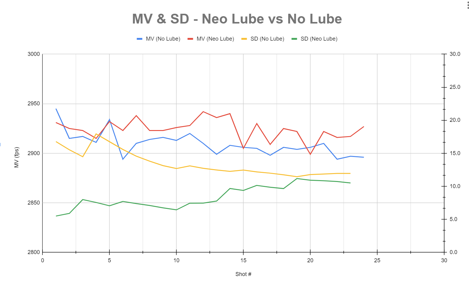

This was my load:
- Berger 220 LRHT
- 83.0 grains N570
Max velocity: 2945
Min velocity: 2894
Average: 2910
SD: 12.0
ES: 51
Max velocity: 2942
Min velocity: 2899
Average: 2924
SD: 10.5
ES: 43

The first 5 shots tell a much different story.
Not lubed had an SD of 14.5 and the lubed data set had an SD of 8.0. Almost half.
Back when I was on the FB precision rifle group pages, I would constantly see people (a lot of jersey shooters specifically), post up 3-5 round chrono shots to brag about their low SDs. The self gratification levels on those group pages were off the charts, and the newbies to the sport would just eat it up.
5 round SDs can be so much more satisfying than 25-30+ round SDs. But they don't necessarily tell the whole story.

5 shot strings can be pretty misleading.
I did a 34 shot string with my 6BRA, and the SD was around 4. But I can't replicate those results with my 6.5 cm or .300NM.
My SD with my .300NM is pretty high as you can see. I would love to get that down. Perhaps it will settle in when the grass gets another firing. Or not
I expected the neolube to pretty much cut the SD in half.
My testing has shown nothing close to that. Mine was in the range of low 8s to low-to-mid 6s on my 300 PRC over 90+ shots of each lubed and non-.
As others have mentioned, if you're not doing ELR, it's likely not worth it. I primarily shoot ELR, so for me it is.
