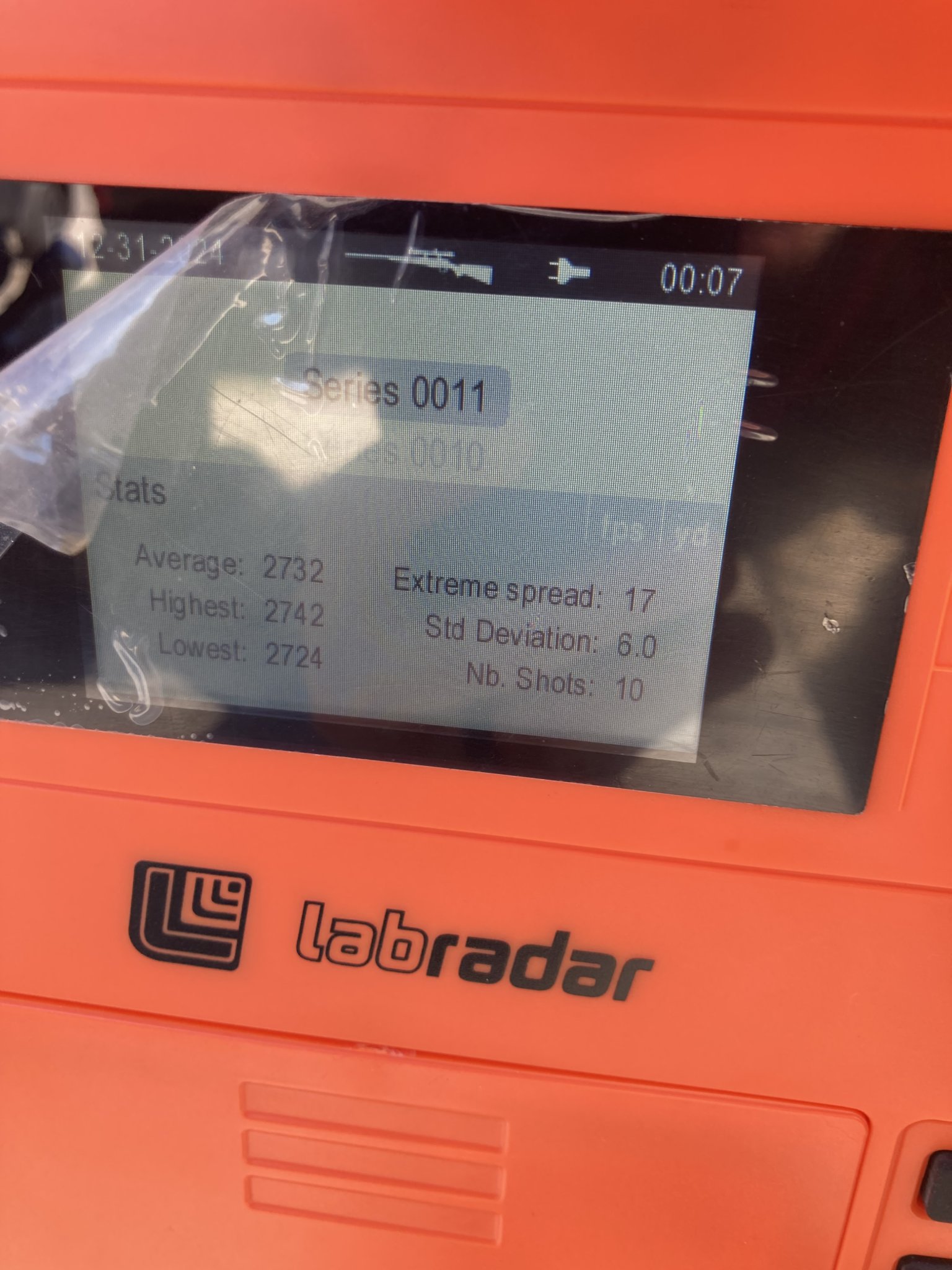

Resurrecting with additional data…
I had changed brakes on this rifle and finally went to rezero it again…same left over ammo mentioned above from when I stopped shooting comps at the end of 2020
fired 2 rounds, adjusted, next 8 punched out the 1/2” dot
it was cooler for south tx around 60°
The old trued velocity I had in kestrel was 2740 fps
Still where it should be…

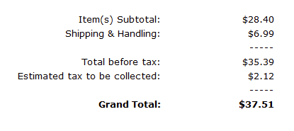

From Amazon, this was my cost:
Wow...if you order it from Huron (the manf) the price of a pint is very, very good compared to 2 oz from Amazon. Basically 16 oz from Huron for a pint for the same price as 6 oz (three 2 oz bottles). But look at Huron's hazmat and handling charges before they even get to shipping. Whoa Nelly!

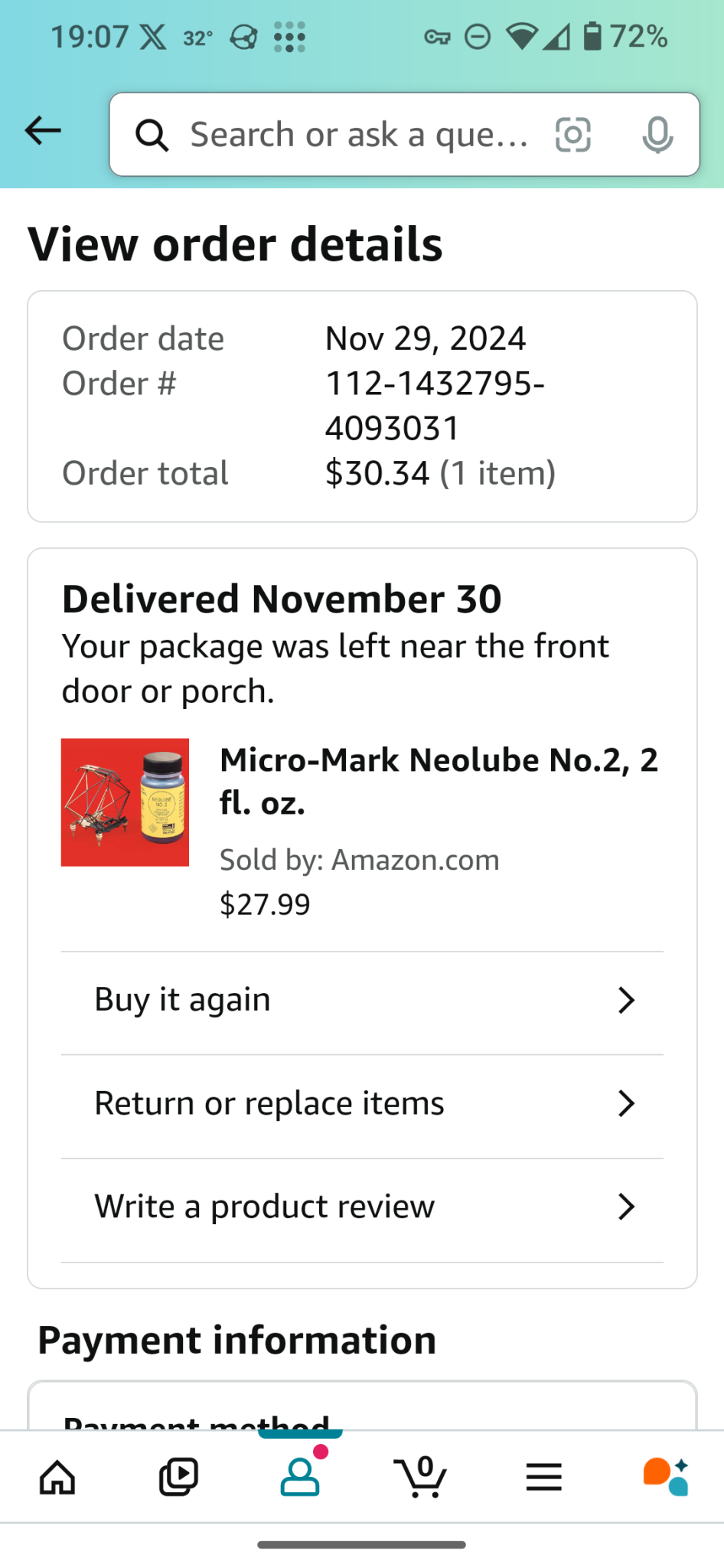

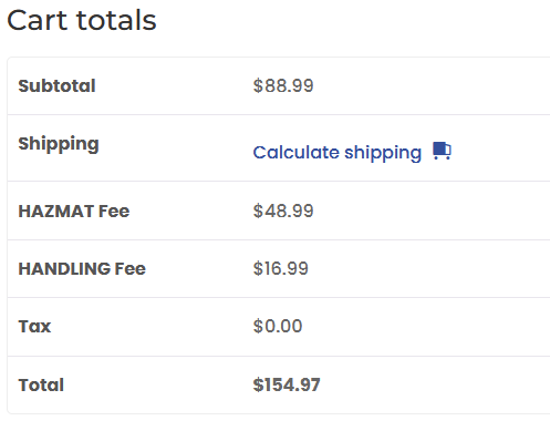

Oh oh contraire (I think)....the last image above was my test cart from Huron for a pint...and they are charging $48.99 Hazmat.
Am I in error?
Looks like you're right. When I bought it a month ago there was no HAZMAT on pints and smaller (even if you bought 10 pints). I thought I was getting screwed with just the handling fee. I sent them an email and they blamed the high shipping on UPS. The pint container arrived in a 12 pint carton filled with cardboard.
