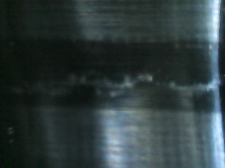

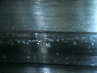

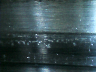

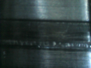

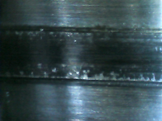

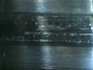

Is this a carbon ring or other issue in my barrel?
tsu45
May 15, 2011
783
291
111

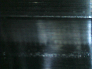

This barrel only has 250 rounds on it but I started getting more erratic velocities. The timing also coincides with the brass now being once fired versus virgin, so there is another variable there. At first eyeball look into the bore I thought it was pitting, but I started getting some small chunks out while cleaning. The bore-scope pics are in the first couple inches of rifling.
Have my first ever two day match in OK next weekend, worried I have issues with barrel going into that.
A carbon ring is just as it sounds. It's a literal ring around the barrel pretty much right at the end of the chamber. This isn't a carbon ring.
Literally the only good use for a borescope in my opinion is checking for a carbon ring. Don't look any further. Id investigate your now once fired brass as the culprit to your velocity issues.
View attachment 7404213View attachment 7404214View attachment 7404215View attachment 7404216View attachment 7404217View attachment 7404218View attachment 7404219

Once fired brass will change things up. Some rifles and chambers more than others. Some rifles I got very little change and on my 338 EDGE i had to lower the charge weight .5 to get the previous FPS and then it was the same accuracy and single digit SD spread.

To answer you OP. You do have a bit of hard carbon in the barrel. It looks thin and not problematic to me and does not look like the dreaded carbon ring. I expect your erratic velocities have more to do with reloading the once fired brass than the barrel. You might have an issue where you not getting a consistent even lube application on your resizing and perhaps you are getting too much variation in the sizes of your cases after resizing or some other reloading issue. I don't think it is carbon in the barrel.
Now for my rant. It seems to be popular to bash bore scopes and those using them. Cheap, functional bore scopes are new and it is obviously going to take a while for the knowledge base to catch up and help people process what they are seeing. There aren't a whole lot of good pictures, videos, etc. yet to help people process what they are seeing so they often make the wrong judgement and do stupid things like polish their barrel until it looks smooth and then the bullets stick to it and copper foul something awful. Eventually, borescopes will be close to ubiquitous and there will be enough good articles on interpreting the images that people will not freak out over a bit of crackling or try to polish things smooth. Long range shooters are a mostly intelligent, informed, and prone to tinker crowd. A leave it to the professionals attitude is not really in keeping with the spirit of the community.
When it comes to carbon and cleaning. I frankly disagree with a lot of what you might call the consensus thinking around here and think that it contributes to the prevalence of carbon build up problems. Sometimes I get the impression reading here that you should only clean every 300 rounds at the most and then should really only do a few passes with patches around a plastic brush. Fuck that. You want a recipe for carbon problems, shoot small, high velocity cartridges with lots of powder like maybe 6CM and then clean them rarely and with a worthless plastic brush. We are press fitting metal projectiles out the barrel 65k+ psi and 3kfps but people are worried about a flexible bronze brush at 1fps. Ridiculous. You are not going to wreck your barrel cleaning it with a bronze brush every hundred rounds or even more often than that. You are also not going to run into carbon problems if you do because bronze brushes are pretty good at scraping it free before it gets super super hard when you regularly clean with them. It is easier to ruin a barrel with harsh solvents or abrasive cleaning products especially if you are doing long soaks than it is to do so with bronze brushes. I say clean with bronze brushes, patches on spear jags, good ball bearing cleaning rods, rod guides, gentle non-abrasive solvents, no extended soaking, and do this pretty often to prevent problems from getting started.

Can you define "erratic?" Are you sure it's not just your rounds speeding up now that the barrel has a couple hundred through it?
